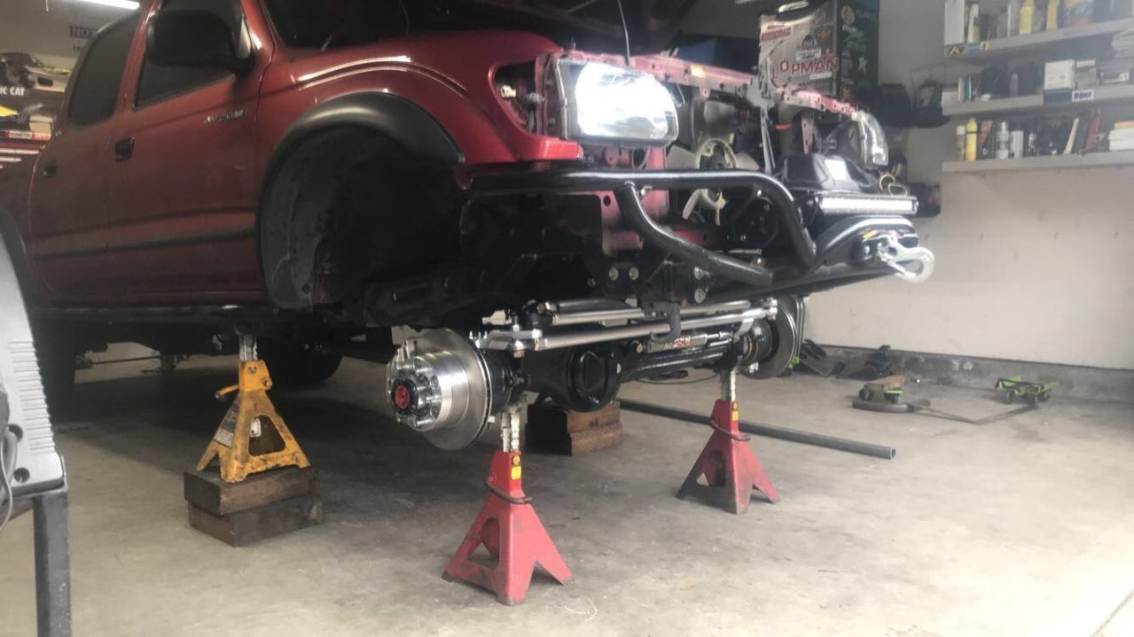

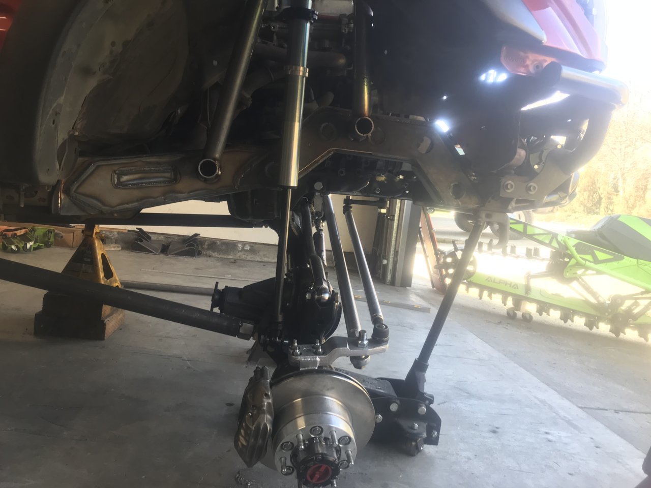

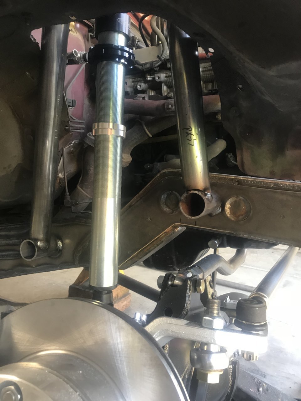

    Made more progress today hoops installed, need too charge coils still but have 2.5” shaft with no preload! Happy with the ride height 18” under doors at frame

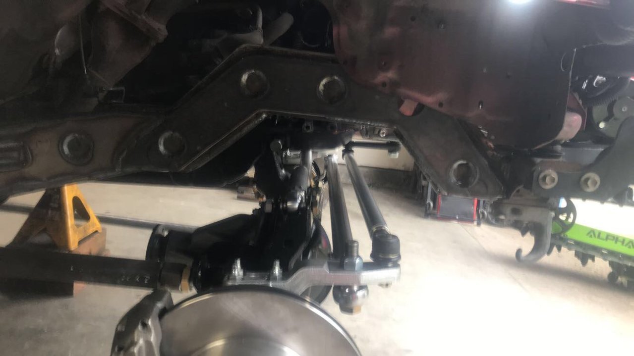

    Gotta clearance frame for axle swing

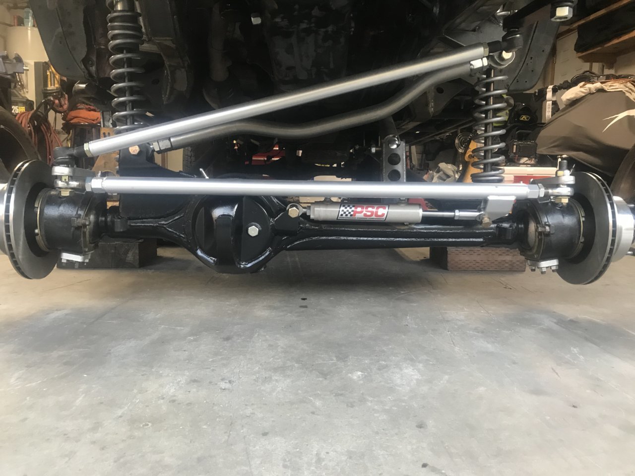

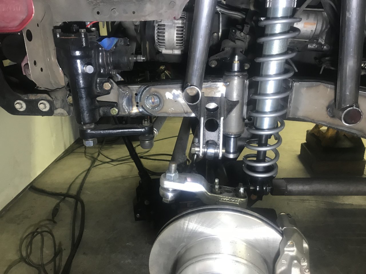

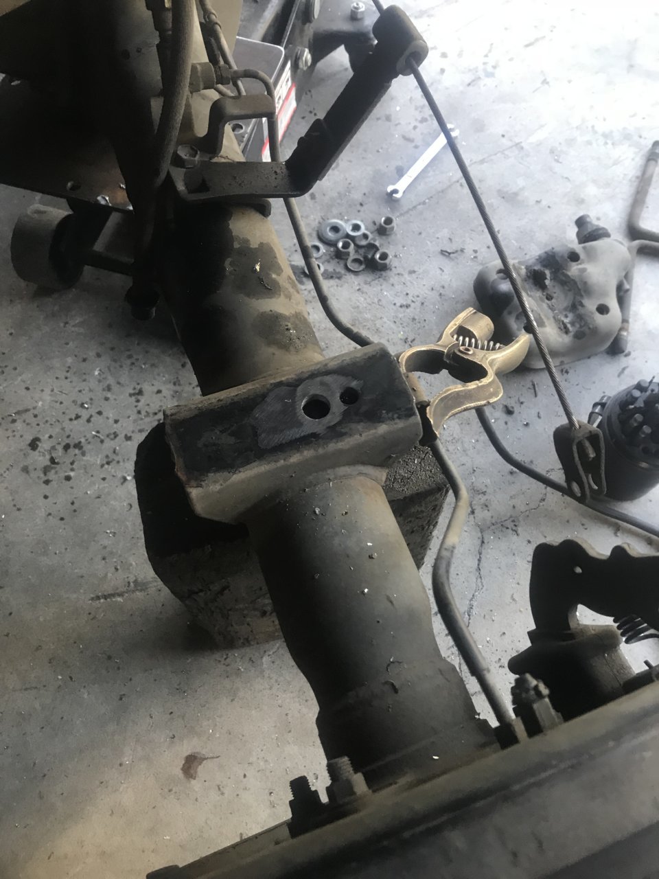

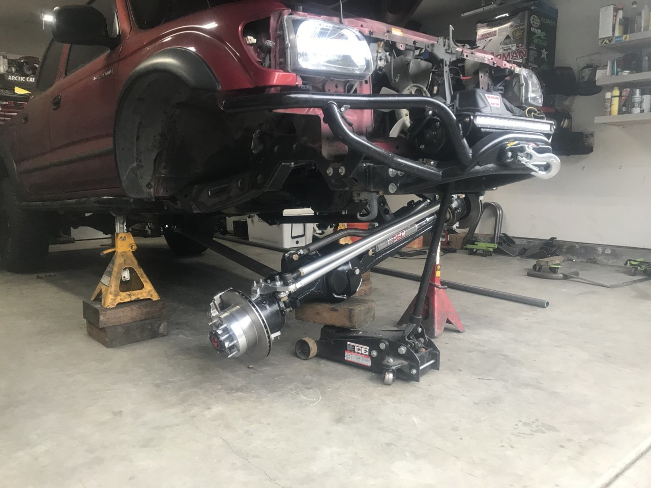

    Finally got a chance to French in one side of frame for c/o clearance and Cut in air bumps, hoping for a drive in a couples days

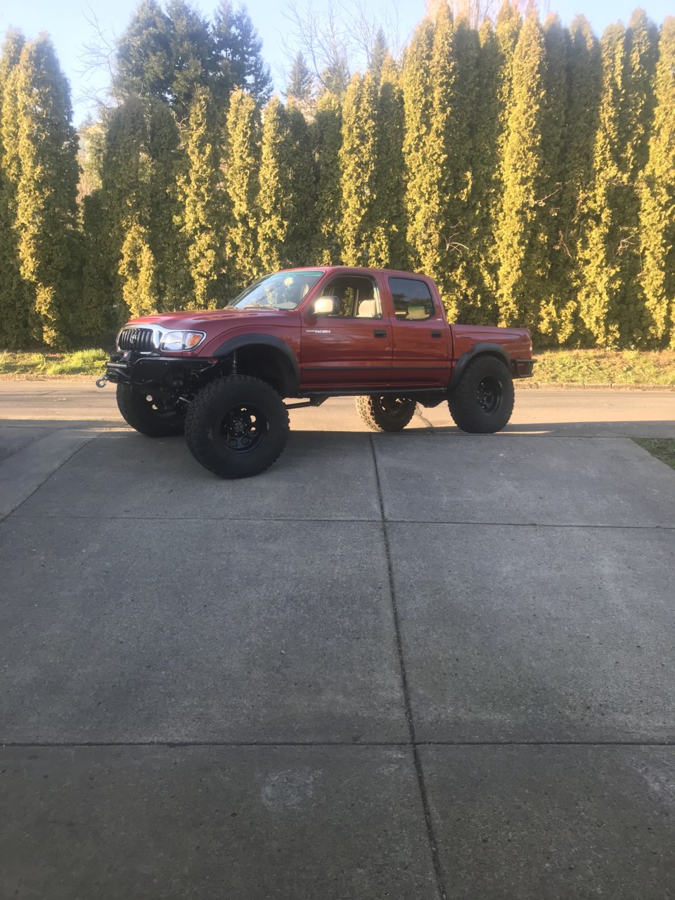

    Finally wrapped up the front and put like 20 miles on it, drives awesome!!!! Brought it back home and slapped my 37s on and rear shackles, it rubs pretty bad so I welded centerpin holes on axle perch then redrilled and moved axle 1/2” forward

    Loving this thing, highway cruise✔️

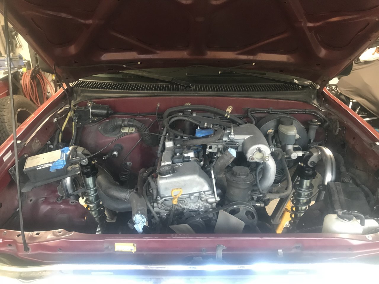

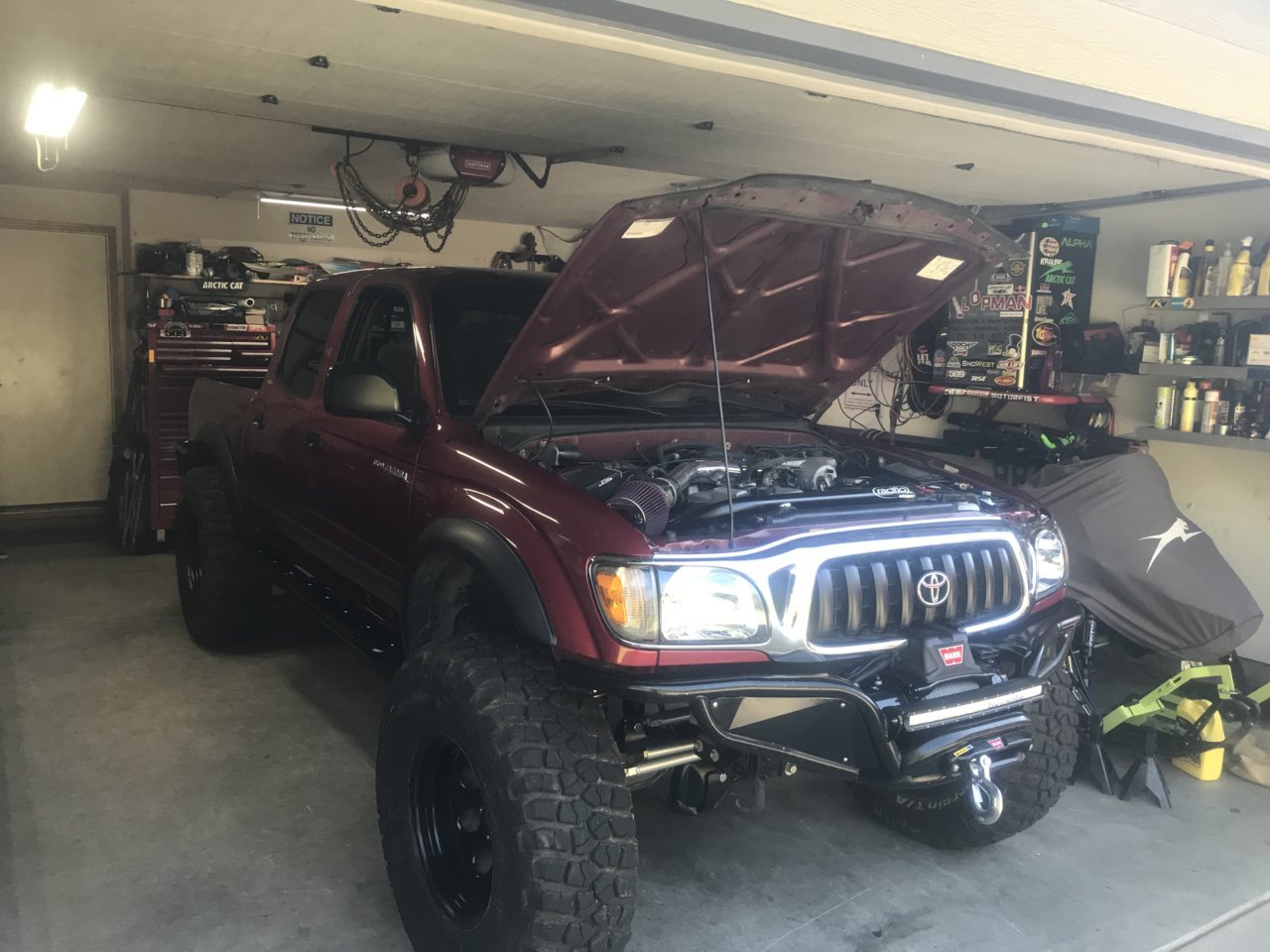

    Looks awesome! Nice and low! Great work!
    How does it look under the hood all put together?

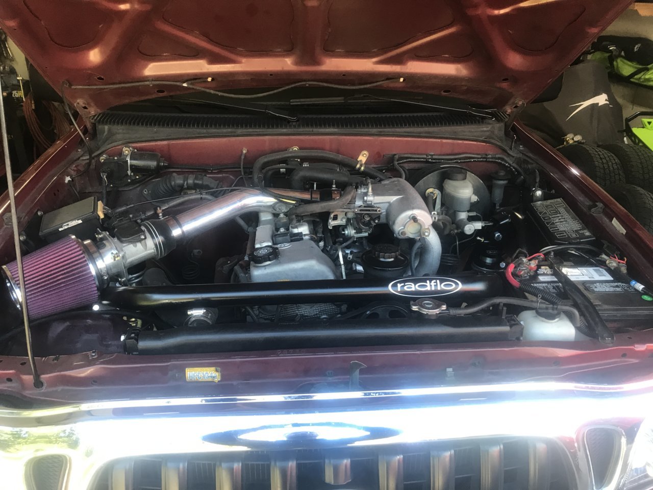

    Someone educate me, what is the radflo system seen in this picture?
    I suppose I could google it and wade through pages of crap, but our taco community is usually more trustworthy and concise.

    It’s the make of coilover shock!https://www.radflo.com/i-68-off-road-2-0-coil-over-shock-emulsion-7-8-shaft.html?ref=category:16

    ......WOW!!!!! That is so clean and i cant get over how nice those welds are! Super amazing im trying to learn to weld and get to the point where i want to show off my welds haha.

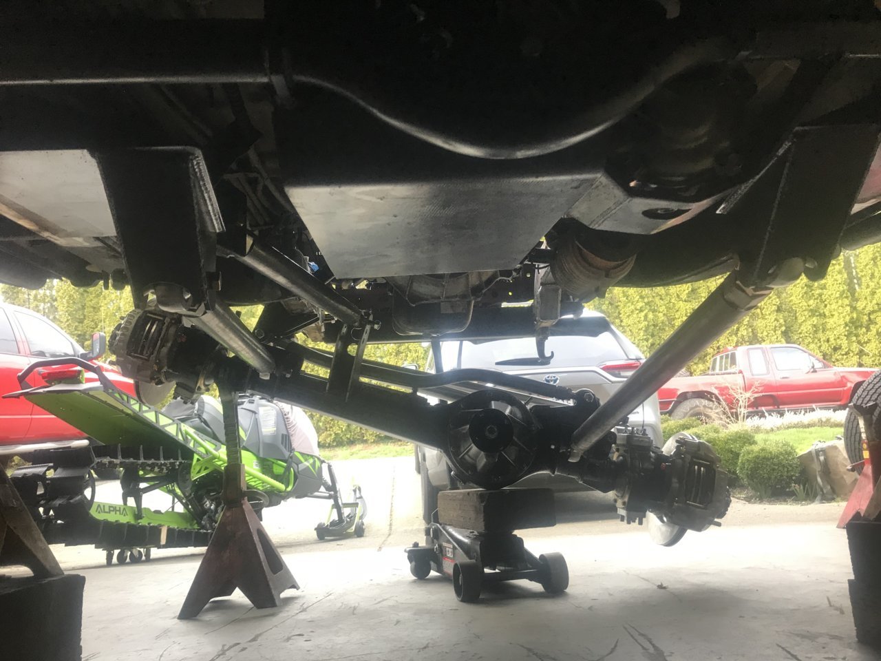

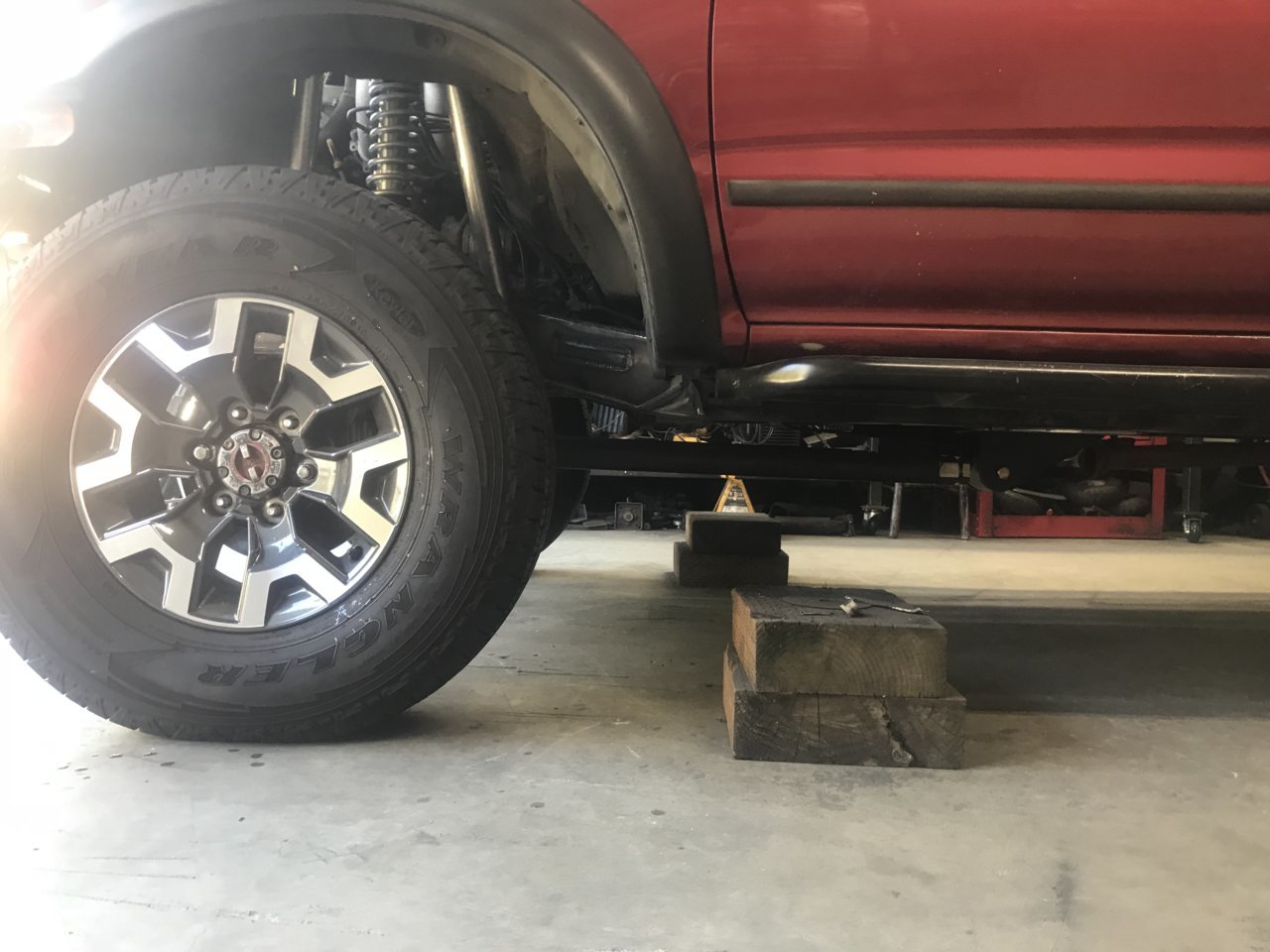

    The next part of project is going to be notching rear frame for c/o and boxing it in. Need to start gathering parts for 3 link build out back,(wanting to keep gas tank) For the time being I ordered some 10” bilsteins so I can daily this
