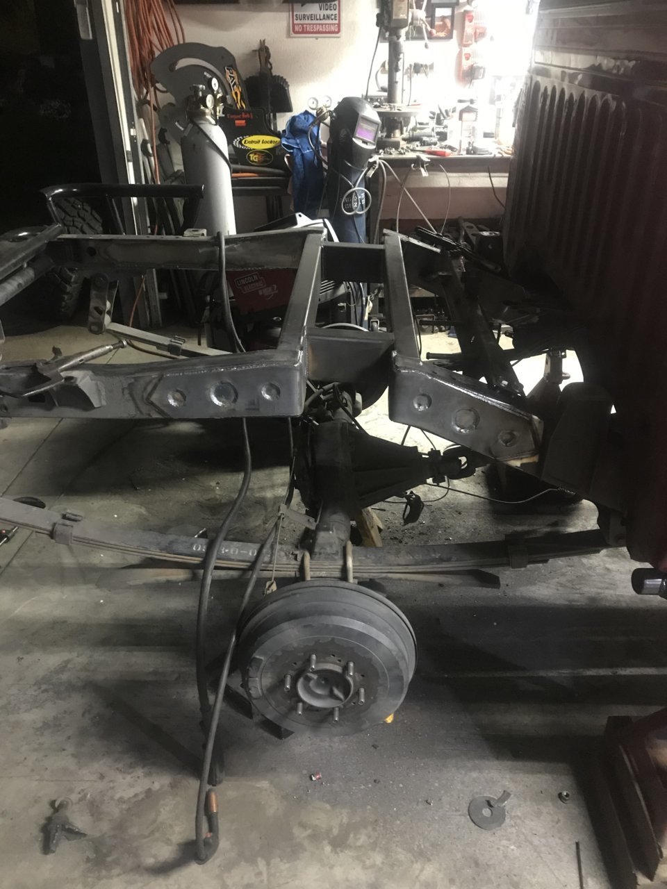

  1. Apr 15, 2020 at 9:20 PM
    #101
    Kkrause09
    Kkrause09 [OP] Well-Known Member
    Jan 20, 2020
    #316705
    171
    Kyle
    Tacoma sas

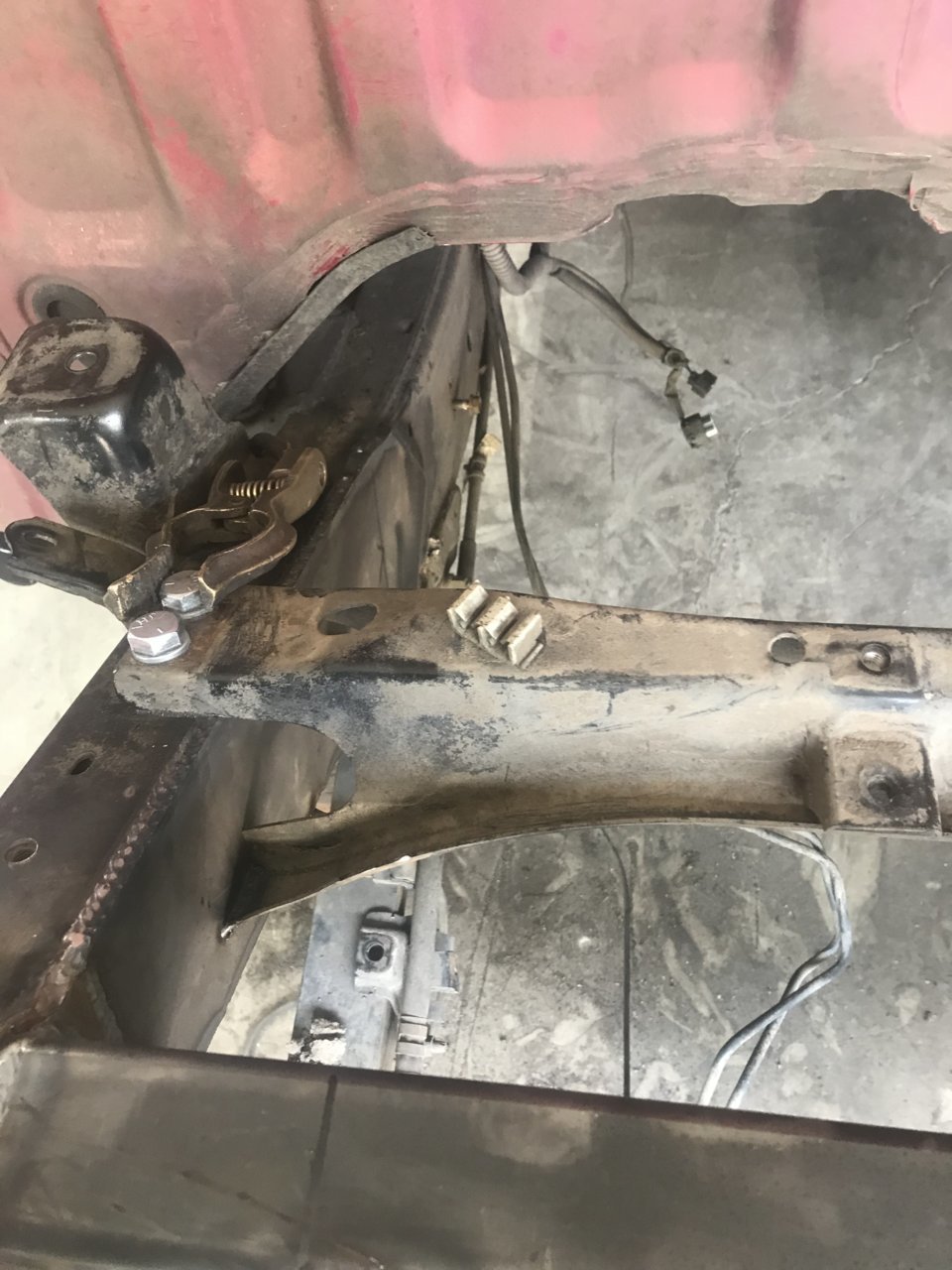

    Started boxing frame on the rear, stupid how the frame plates are only 2/3 of the rear so I made it full length

  2. Apr 15, 2020 at 9:21 PM
    #102
    Kkrause09
    Jan 20, 2020
    #316705
    171
    Kyle
    Tacoma sas
    I also moved fuel tank bracket to top side of frame giving 1” added tank belly clearance

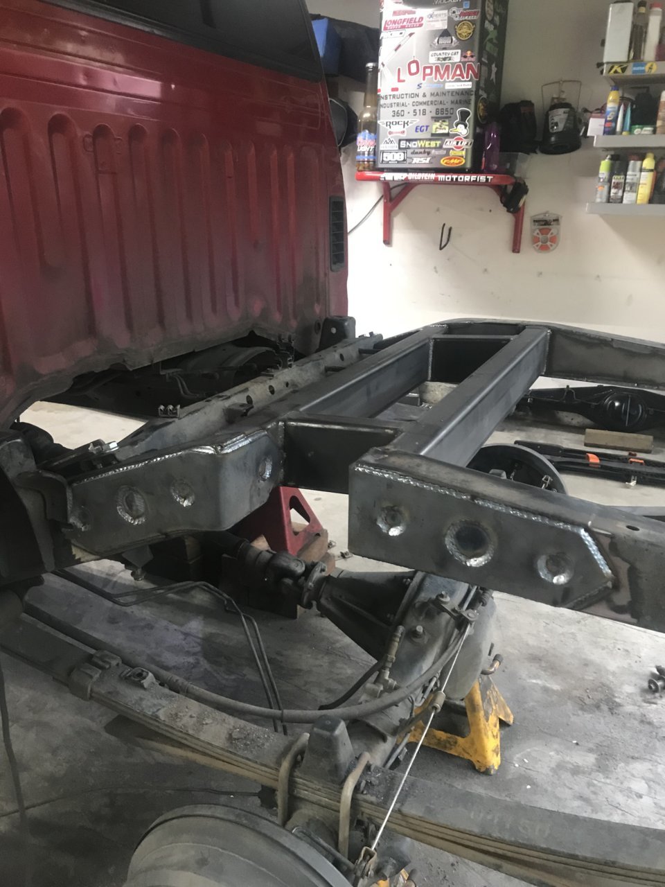

  3. Apr 15, 2020 at 9:24 PM
    #103
    Kkrause09
    Jan 20, 2020
    #316705
    171
    Kyle
    Tacoma sas

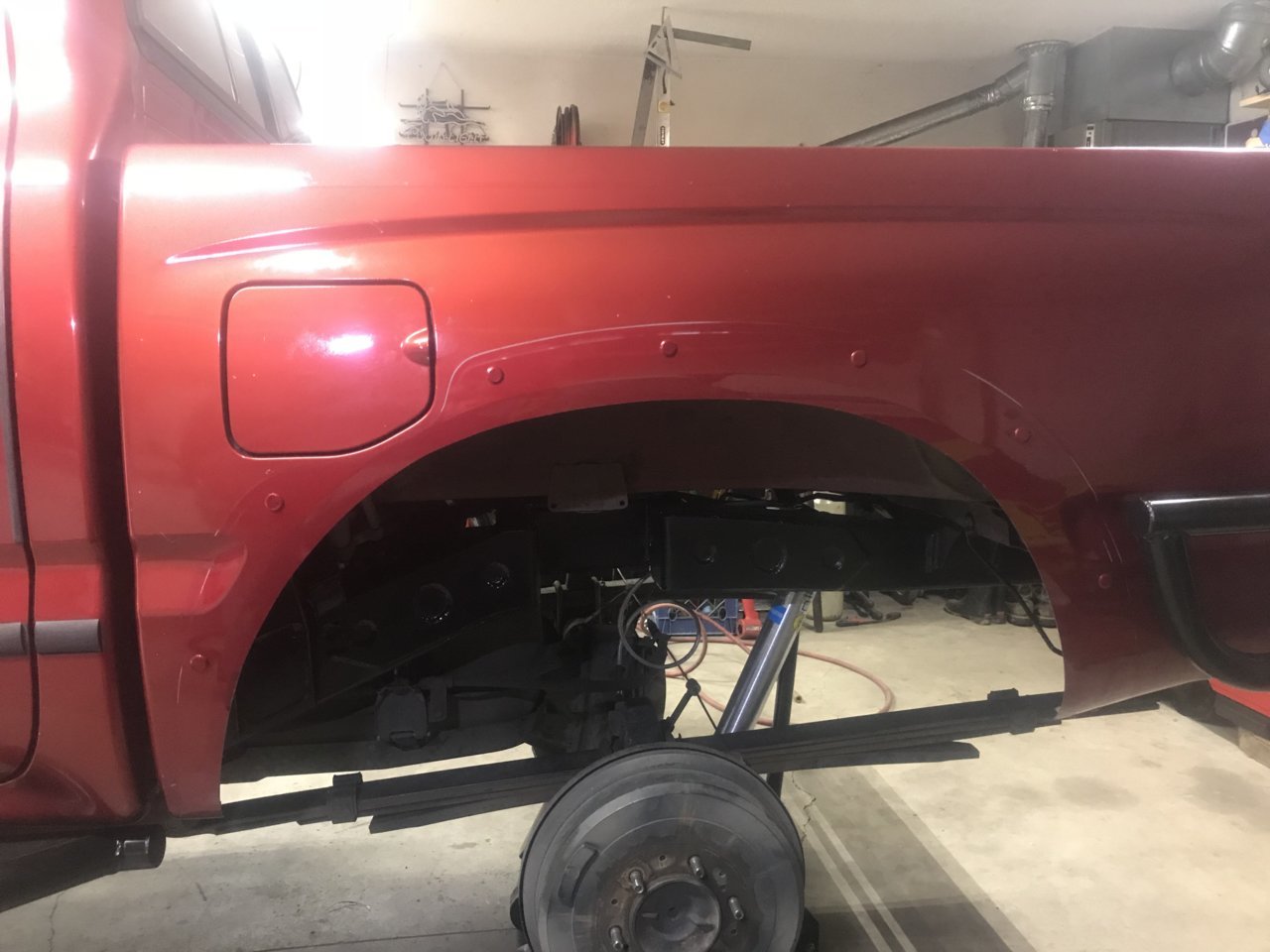

    Got the frame notched for coilovers to run in the pocket, should sit straight up/down tilted forward 5*

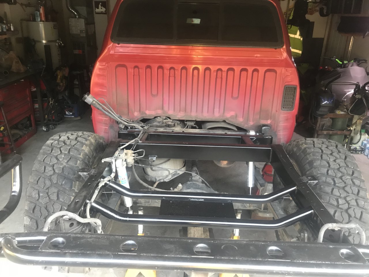

    Jan 20, 2020
    #316705
    171
    Kyle
    Tacoma sas

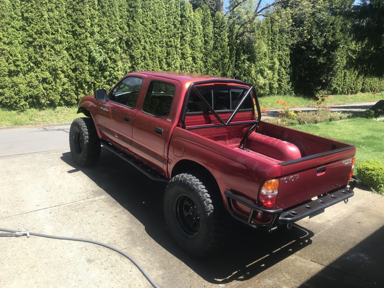

    Finished up the rear for now, built a rear winch cradle. The cable will burn inbetween top and bottom of rear bumper tube and be hidden behind lisence plate. Gonna mount the solonoid box in the bed with wireless remote

  5. Apr 16, 2020 at 9:34 PM
    #105
    Reh5108
    Reh5108 Well-Known Member
    Feb 18, 2013
    #97832
    5,766
    Idaho
    2004 SR5 4X4 2.7L Extra Cab
    OME lift, 4x sliders, Demello rear bumper, custom front bumper, Engo 9000lb winch
    I'm hoping to do this shortly. I've lost 2 gallons of capacity to smashing the tank.
    Kkrause09[QUOTED][OP] likes this.

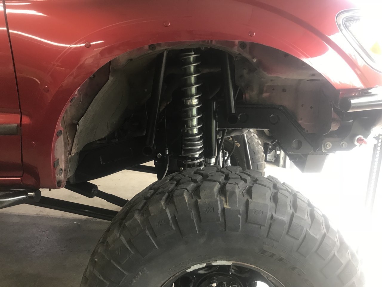

  6. Apr 18, 2020 at 7:30 PM
    #106
    Kkrause09
    Jan 20, 2020
    #316705
    171
    Kyle
    Tacoma sas

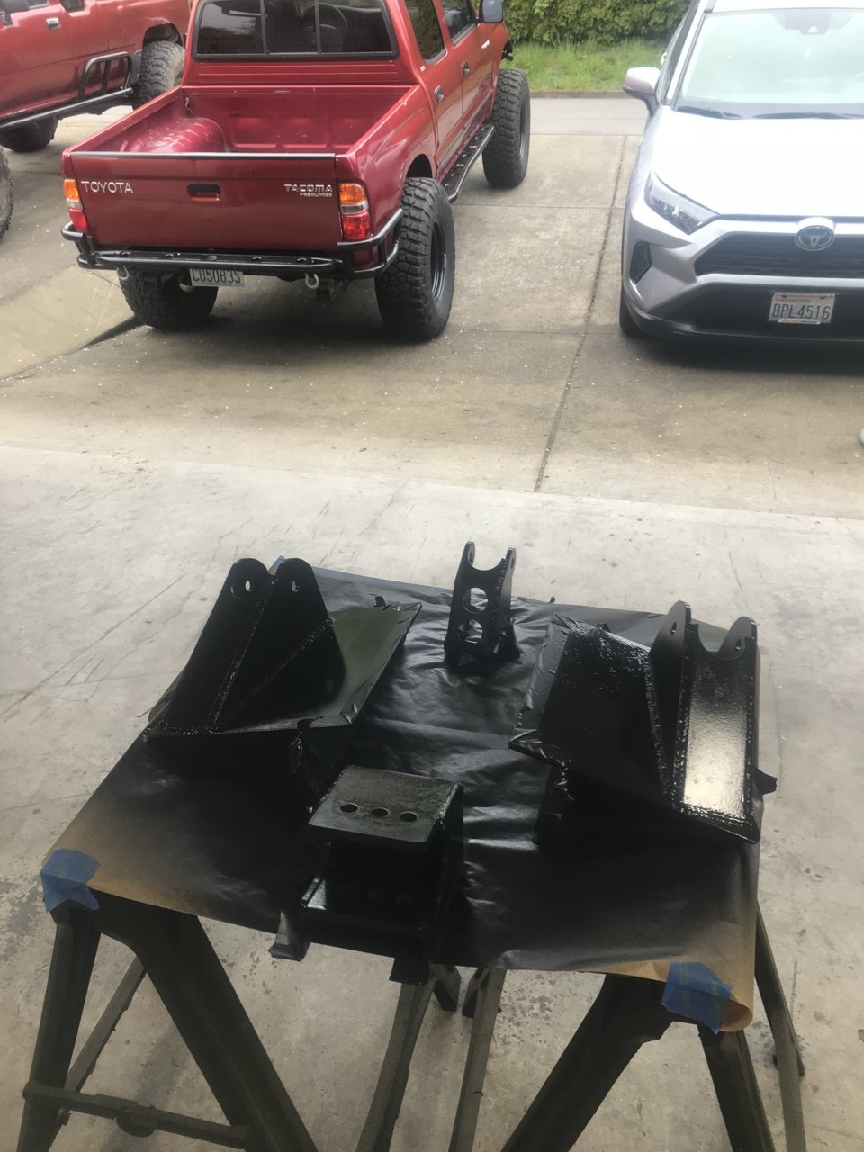

    Did some more fender trimming little by little , finished up the rest of my link brackets! All handbuilt here in the garage pretty rewarding knowing this is a one off build with my own geometry:) can’t wait to get this shit together I see the light now at end of the tunnel! All the hard work is behind me✔️

    You could probably sell that frame notch. This whole build is beautiful.

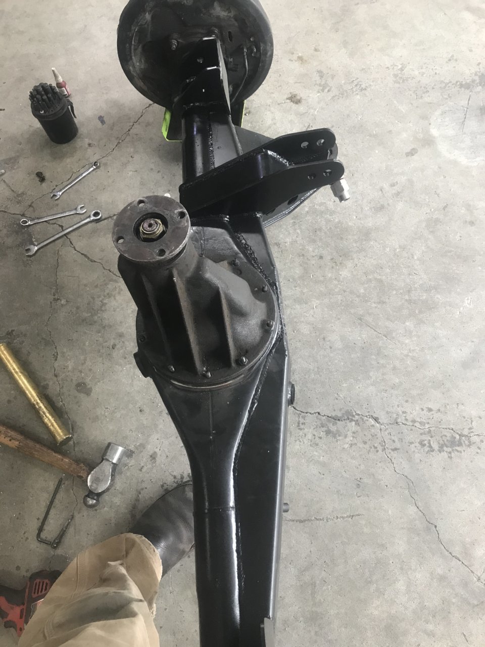

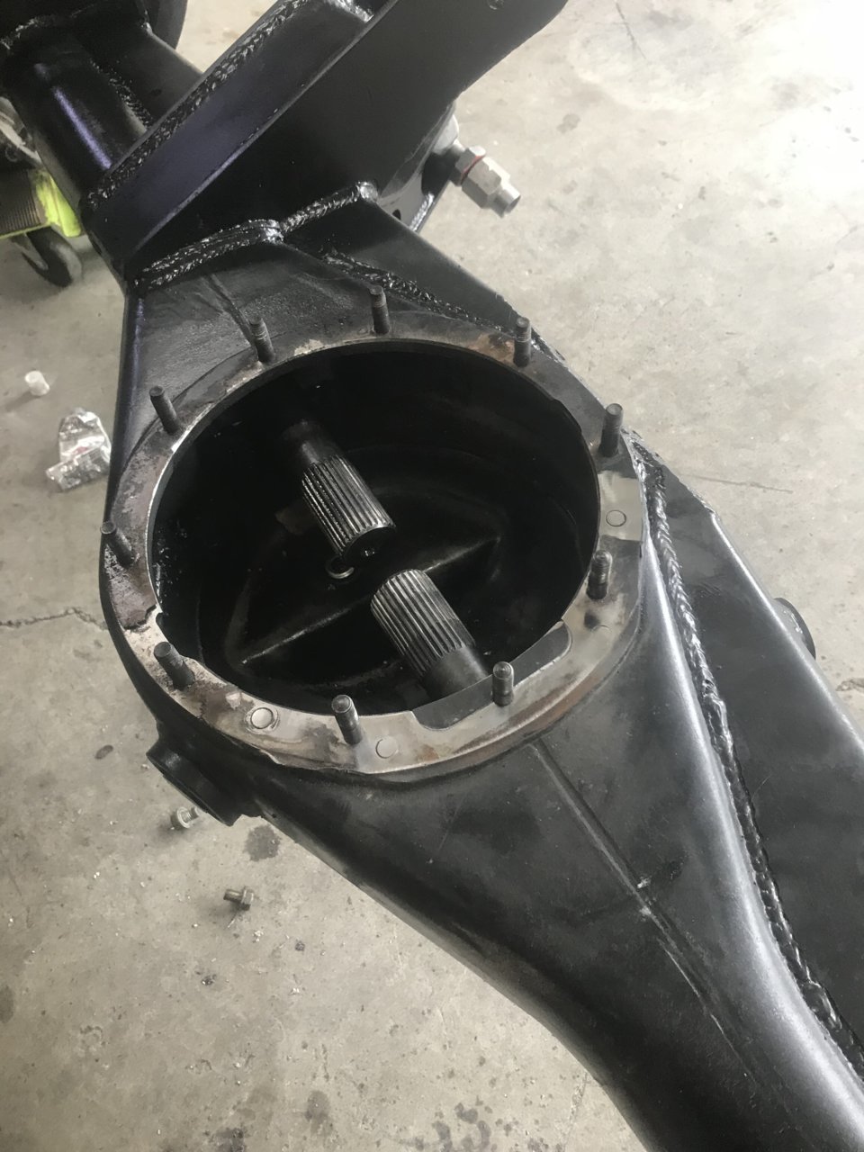

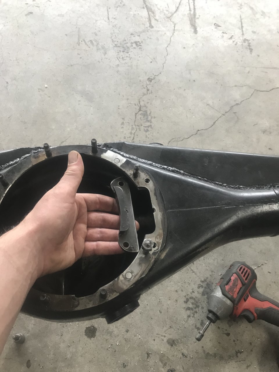

    Well I’m having a hard time finding e-locker with 4.56 gears so I made a bolt on adapter to run a standard 8” diff with Detroit locker as I already have a couple. Easy enough to switch on and offAllen cap screws on interior for factory plugs!

    COMAtized99
    COMAtized99 Well-Known Member
    Nov 10, 2009
    #25746
    1,893
    North Carolina
    99 DCLB v8
    The Bed is stock...ish
    Wow... that's clean!

    Reh5108
    Feb 18, 2013
    #97832
    5,766
    Idaho
    Awesome idea! There might be a handful of people interested in that if it's something you'd be willing to make.

    COMAtized99
    Nov 10, 2009
    #25746
    1,893
    North Carolina
    99 DCLB v8
    @Kkrause09 idk what you do for a living, but you could absolutely make a buck or two making thinks...

    slander
    slander Honorary Crawl Boi
    May 10, 2013
    #103909
    8,964
    Hickory, NC
    02 Tacoma, fixed with curse words.
    That plug is pretty damn cool! I always read this could not be done, way to give the middle finger to the internet toyota know it alls!!

    Kkrause09
    Jan 20, 2020
    #316705
    171
    Kyle
    Tacoma sas
    I’ve always wanted to try this, yrs ago I did the elocker on my brothers ifs width rear end and had an idea of what it would take. Really only took me a couple hrs. I saved my templates

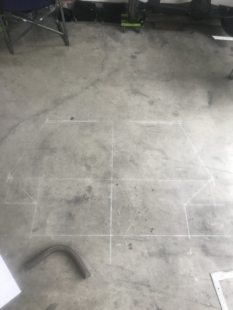

    Bored and bent up a b pillar , think I’m gonna come off this to shock hoops for coilovers

    I ended up welding to top of frame then using 3/8 plates as flanges, drilled 8 holes tapped to 1/2x13 so i can remove for keeping fresh paintNow to incorporate rear shock hoops

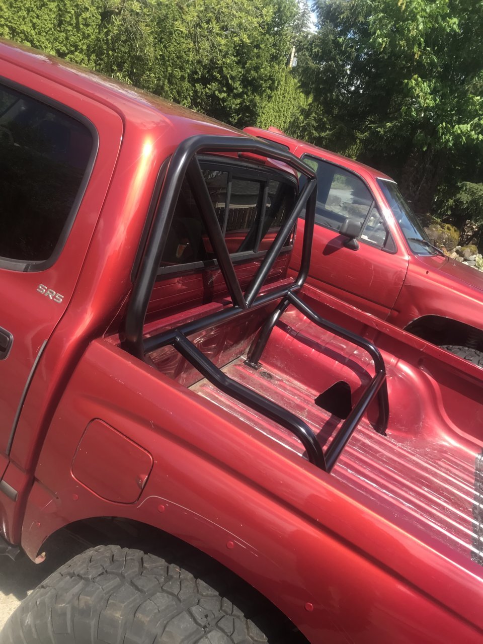

  16. May 3, 2020 at 3:09 PM
    #116

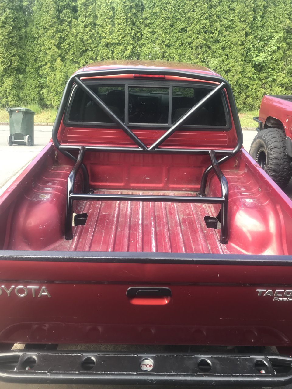

    Kkrause09
    Jan 20, 2020
    #316705
    171
    Kyle
    Tacoma sas

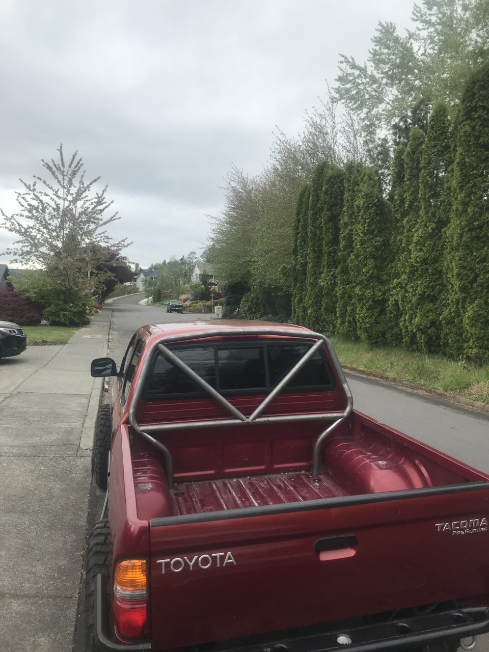

    Shock hoops added and bed cut out, I used interlock tube clamps at back of hoops to keep this removable so the bed can still come off

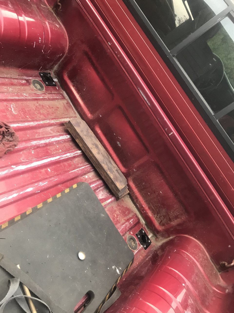

  17. May 3, 2020 at 3:14 PM
    #117
    Kkrause09
    Jan 20, 2020
    #316705
    171
    Kyle
    Tacoma sas
    Ordered a UWS chest toolbox to squeeze between coilovers

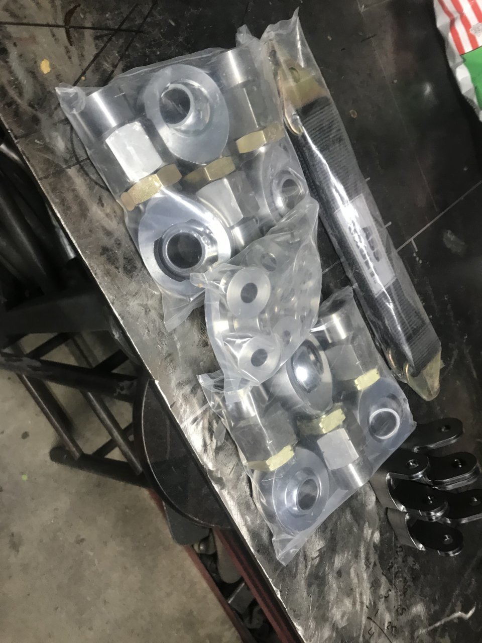

    More parts coming in daily
