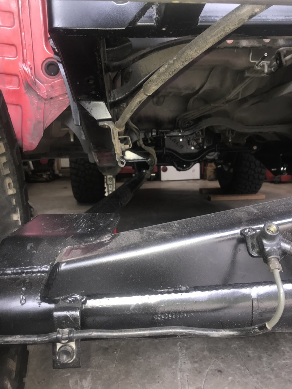

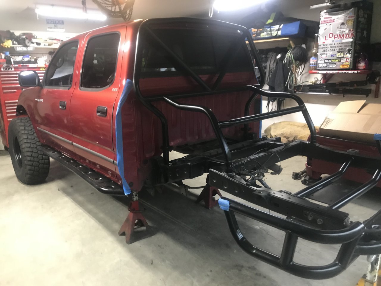

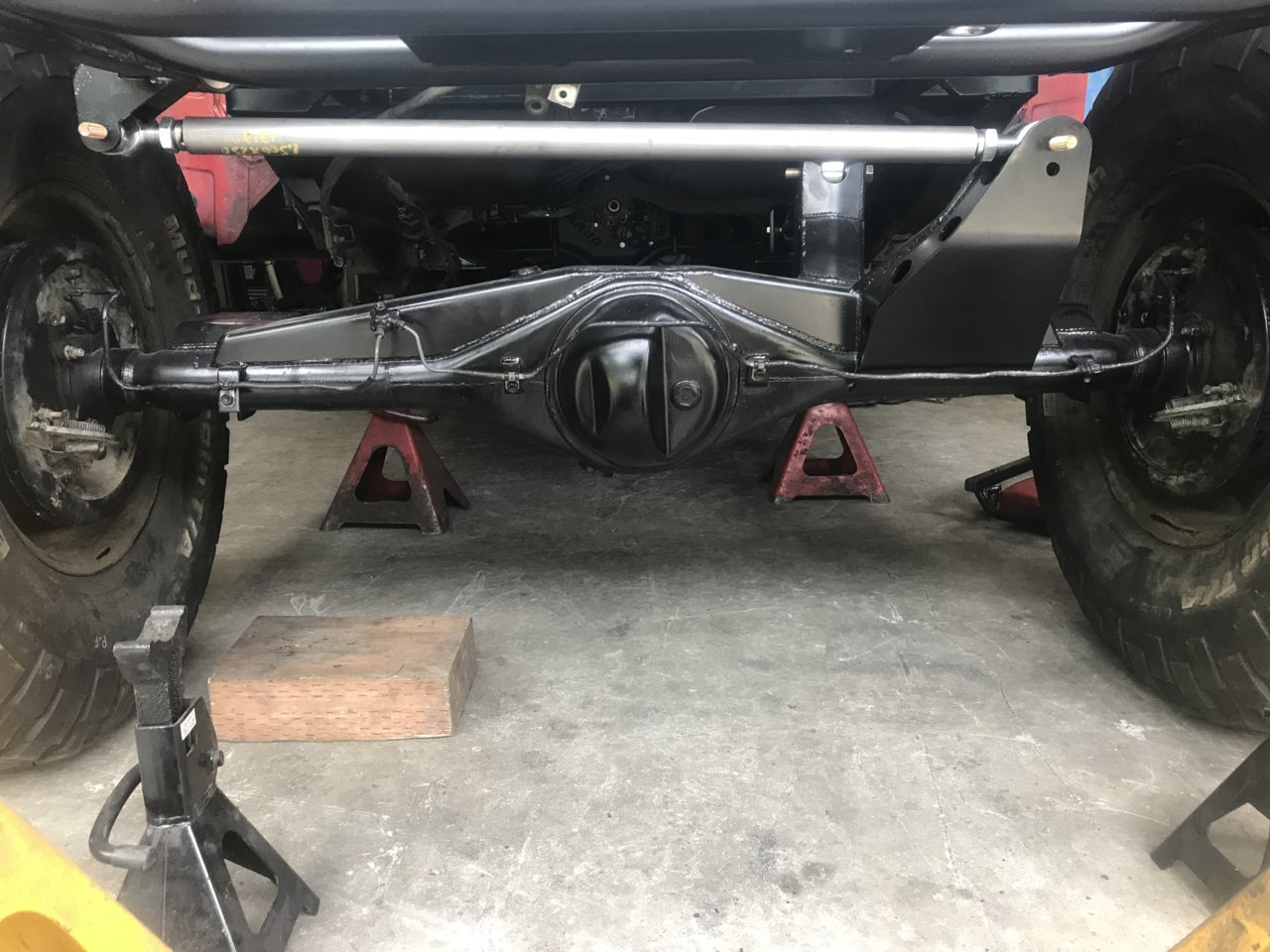

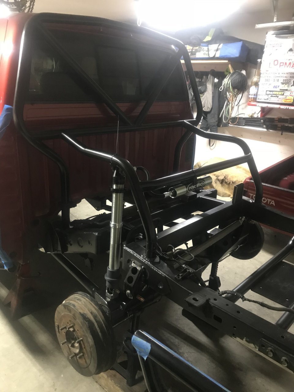

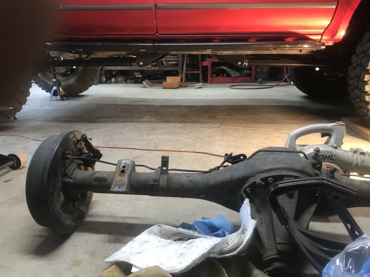

    I went ahead and got a jump start on the rear. axle out, tank set aside and bed removed for ease of mock up. Hoping to have brackets cut off and links in place by tomorrow, coilovers show up Friday

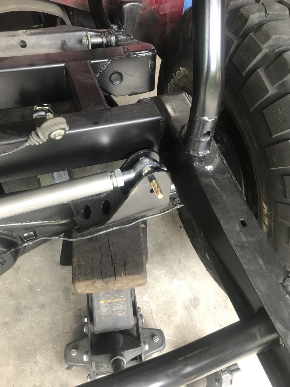

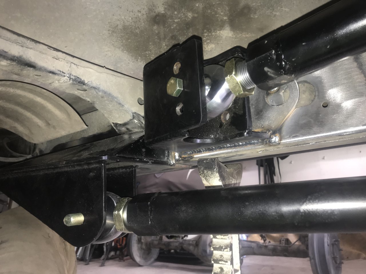

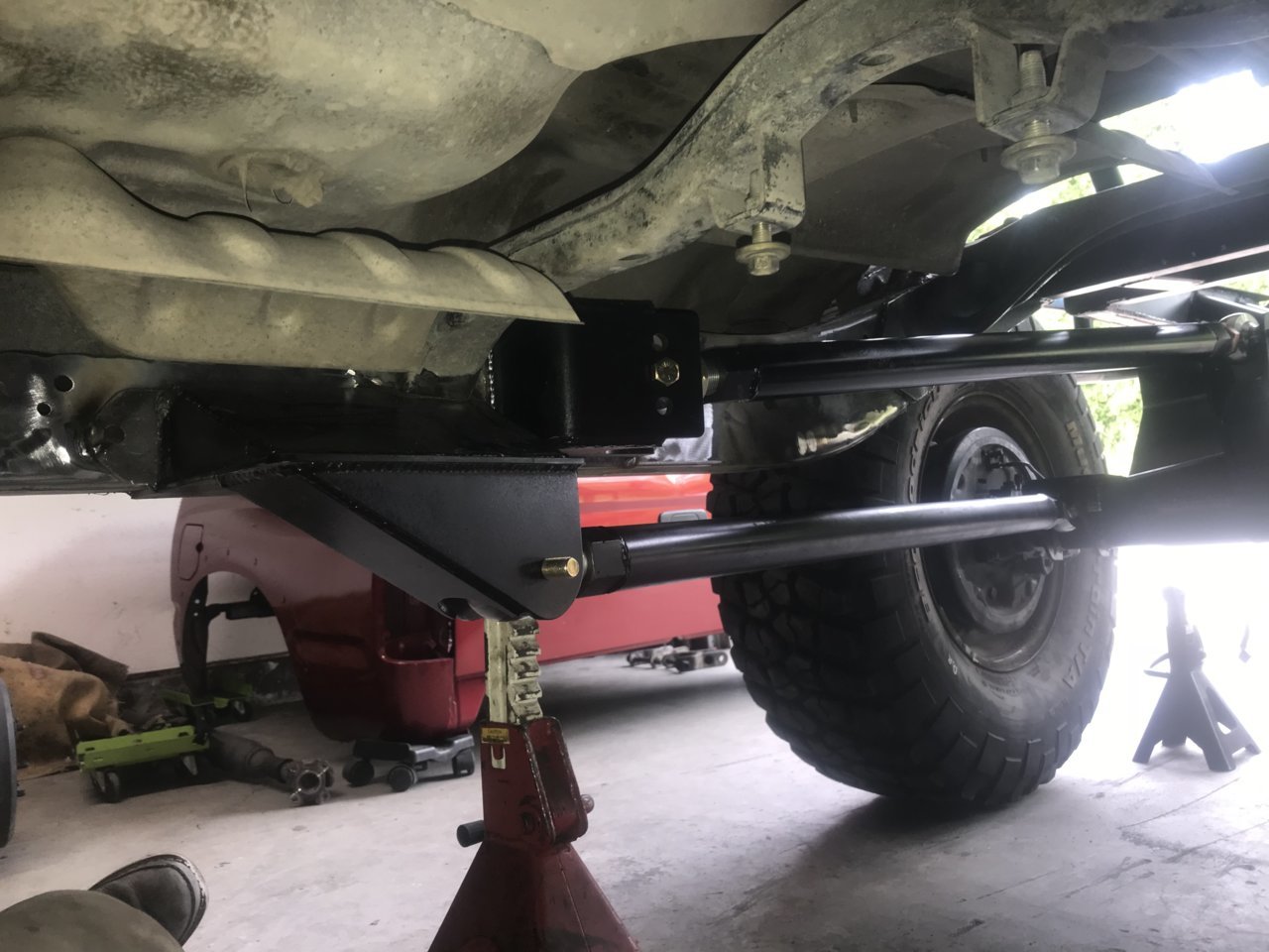

    Tacoma sas

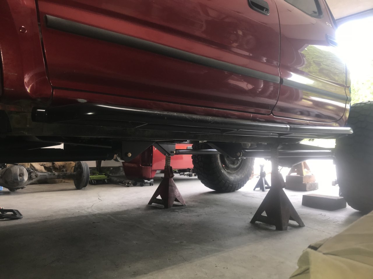

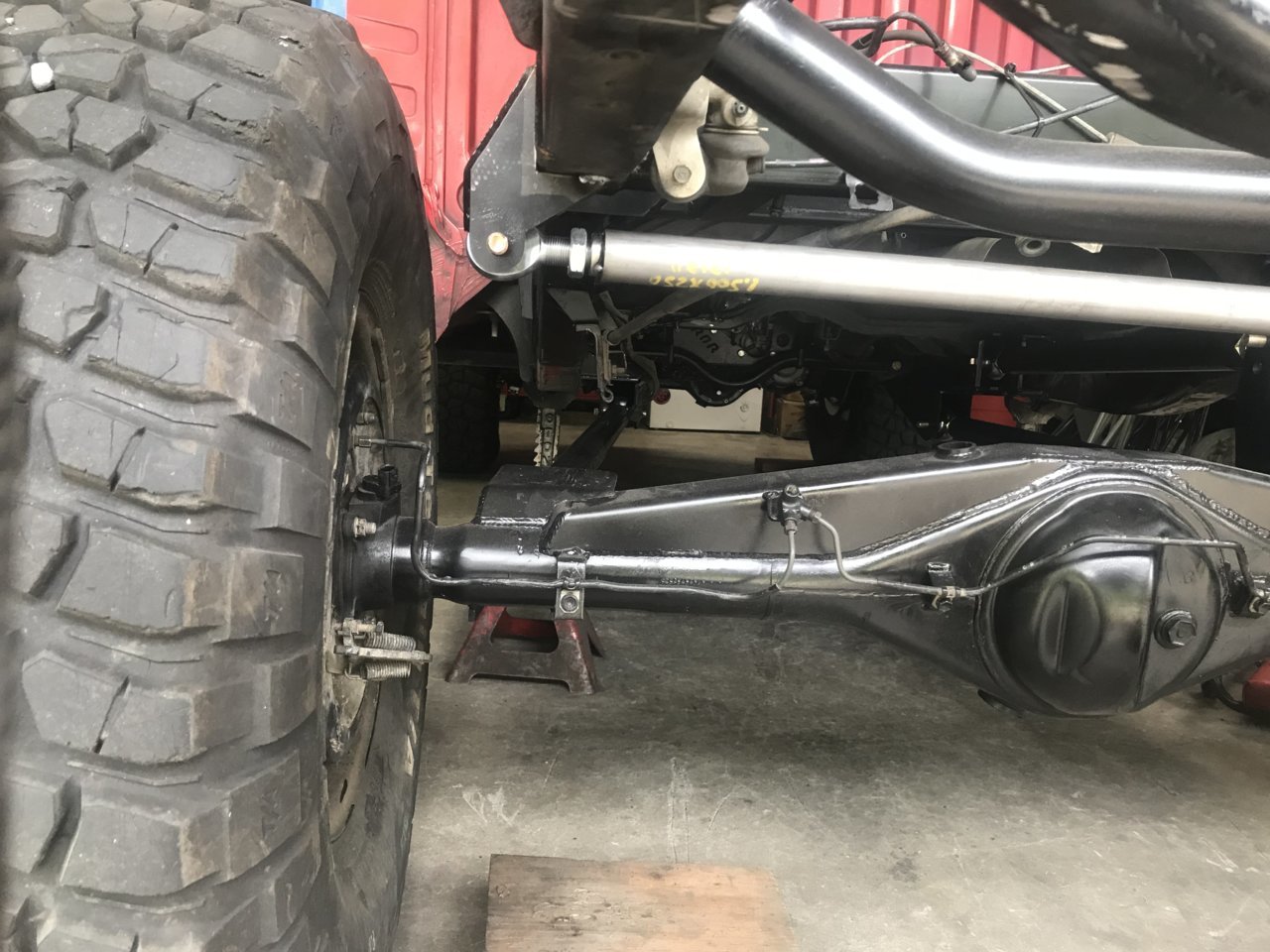

    Everything set in place, heavy tacked. got to notch the box tube 1” for max bump! My 3rd link on axle is contacting!!! Looking like 4.5-5” bump hoping the rate I chose is good lol. Links are at 2* at ride height front/rear back to work tomorrow

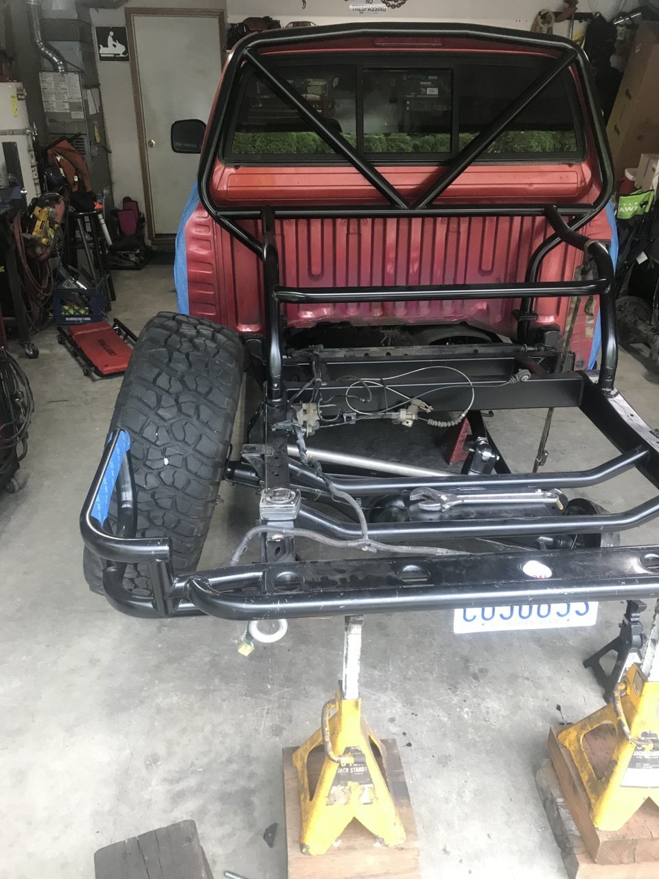

    Some goodies arrived:)

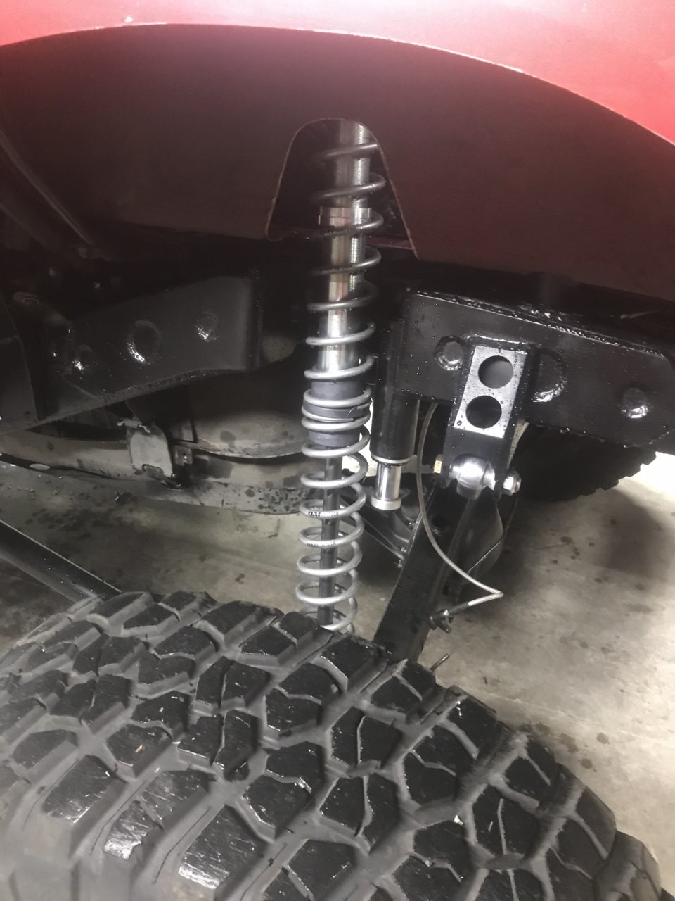

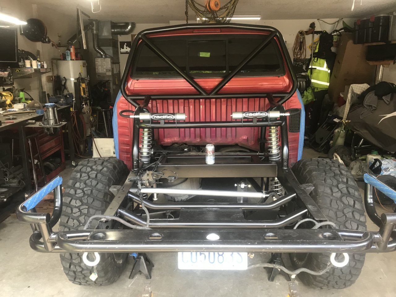

    Tacoma sas

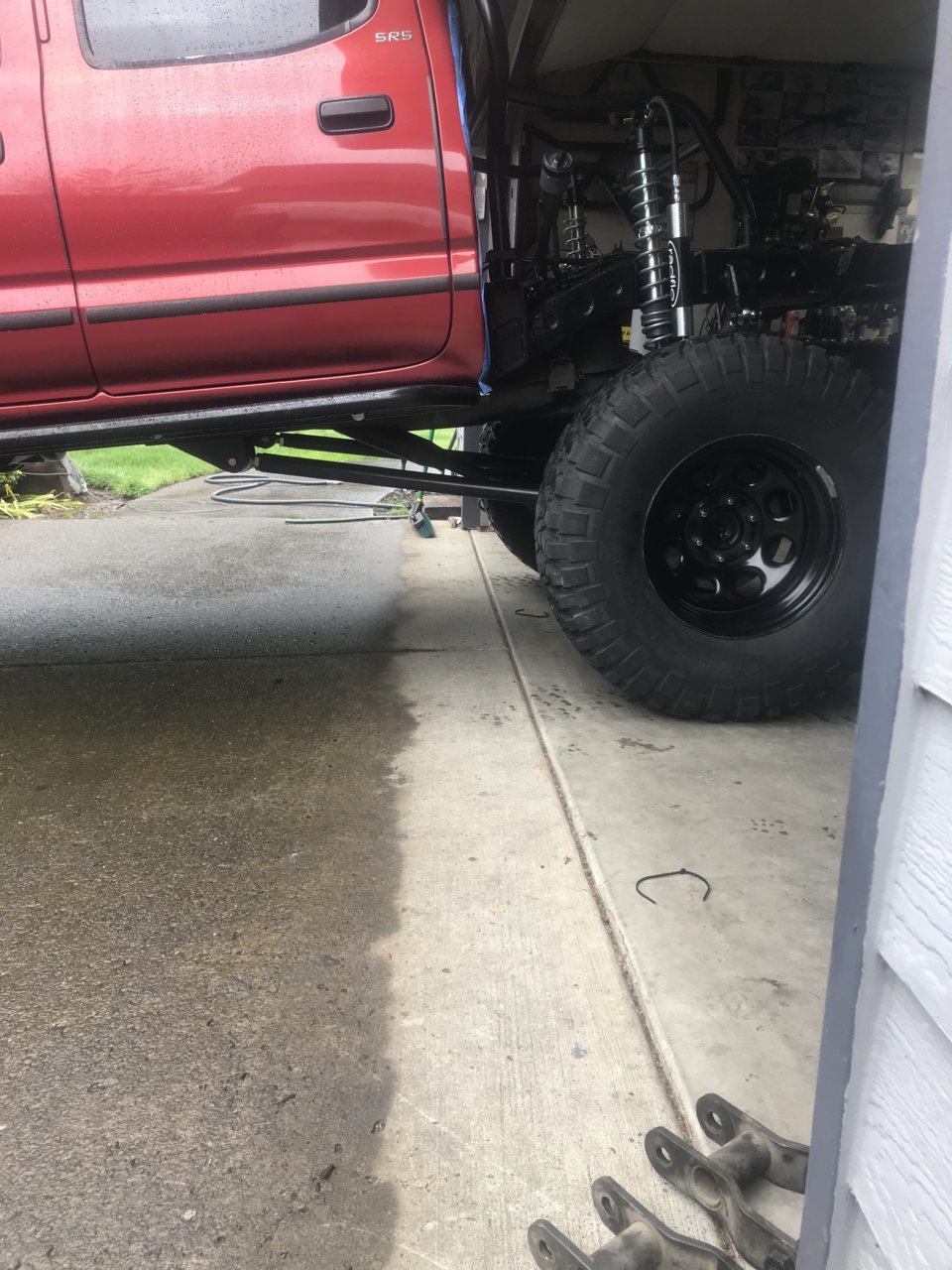

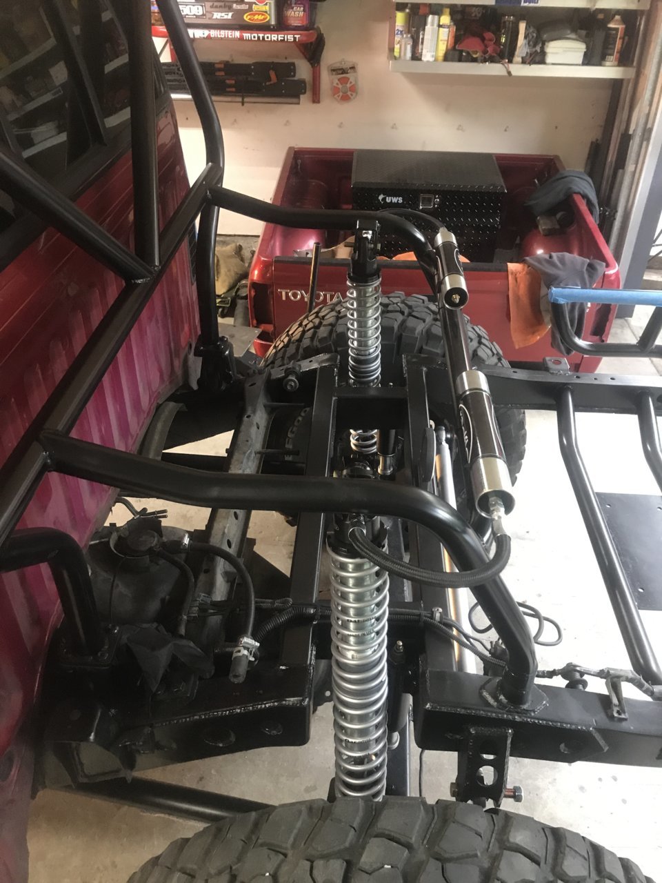

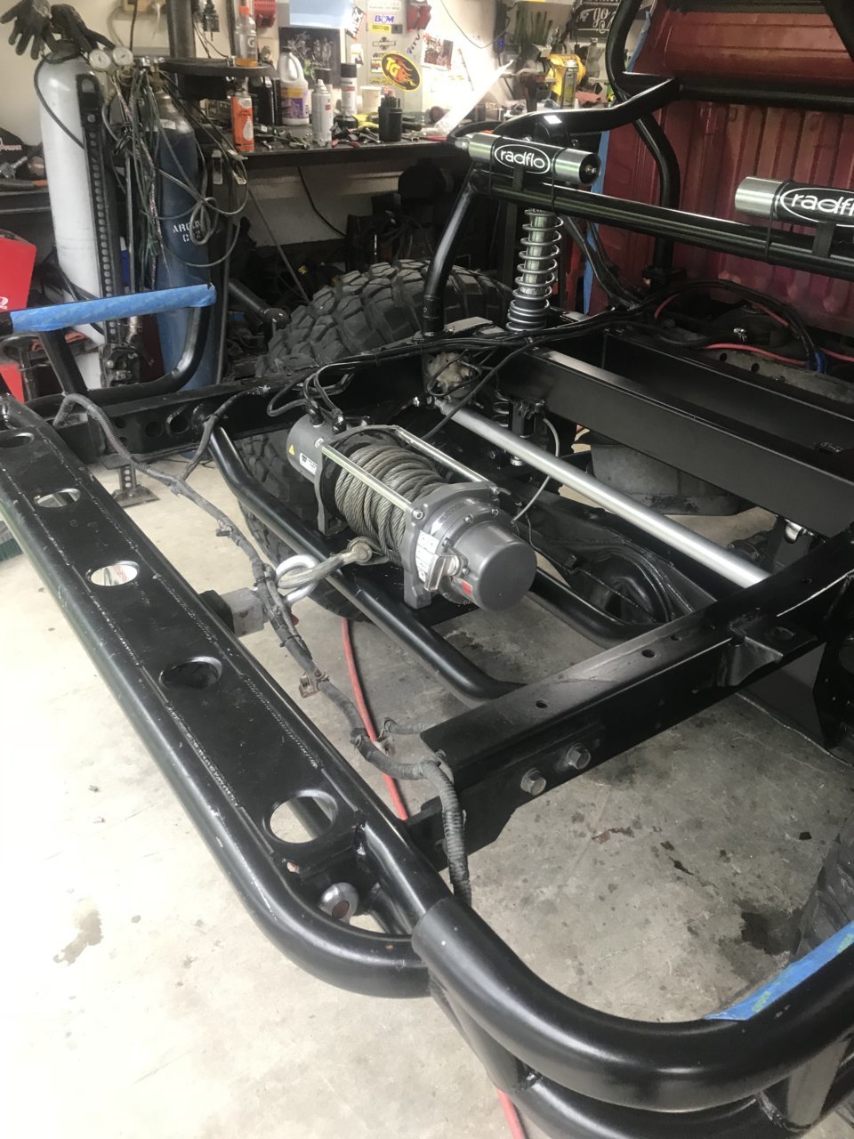

    Well everything worked out better then expected:) 5” shaft without the bed and tool box winch tools etc... I have zero preload on coils so when I add that 1.5-2” she will be perfect! 200psi nitrogen..... frame is right at 21” with the 37s

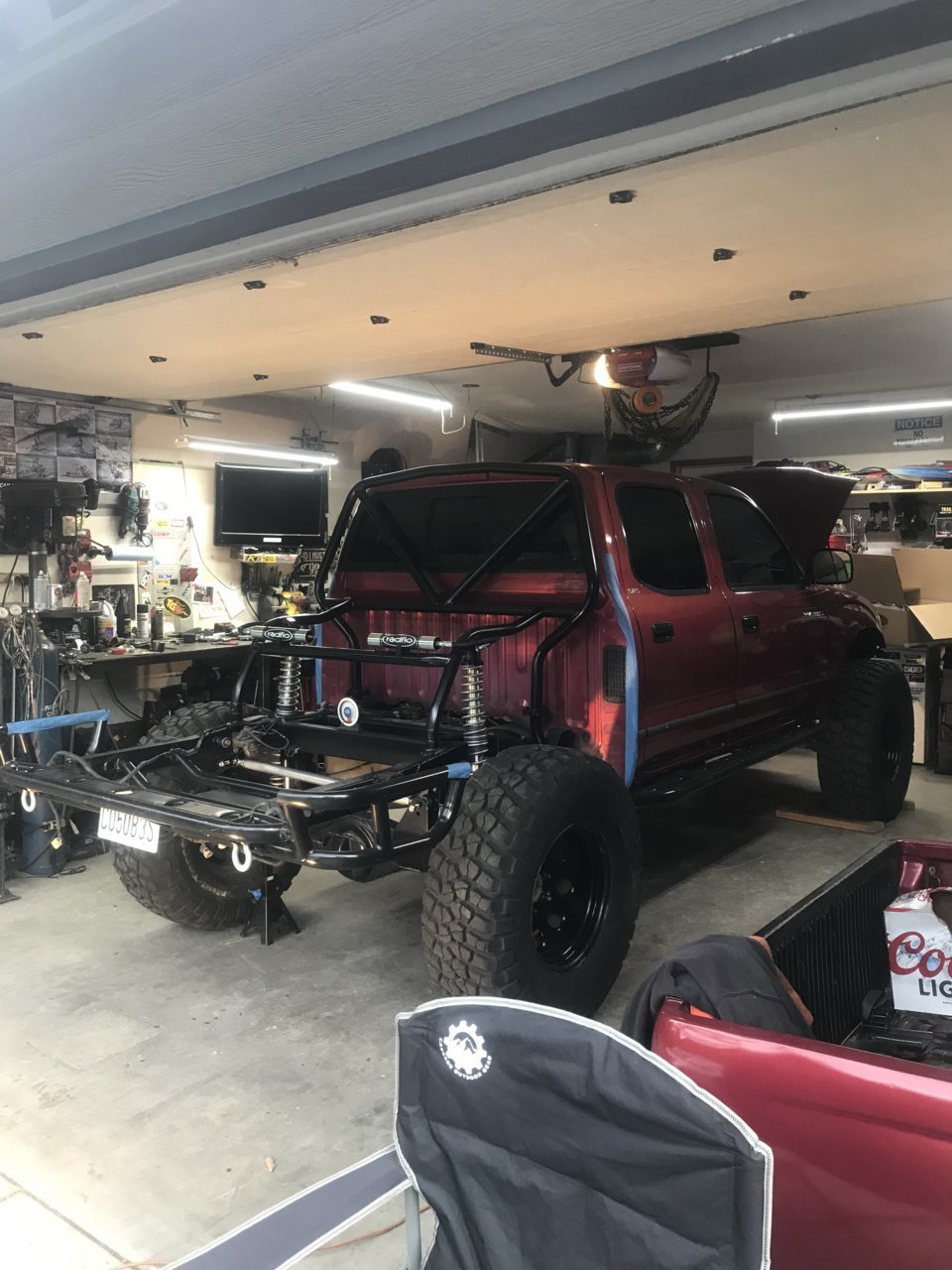

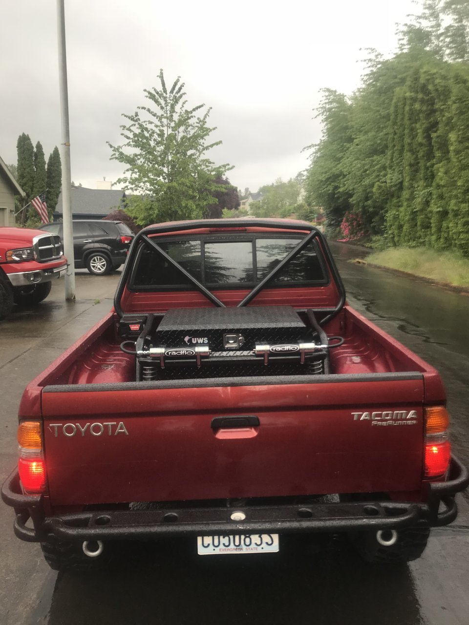

    Tacoma sas

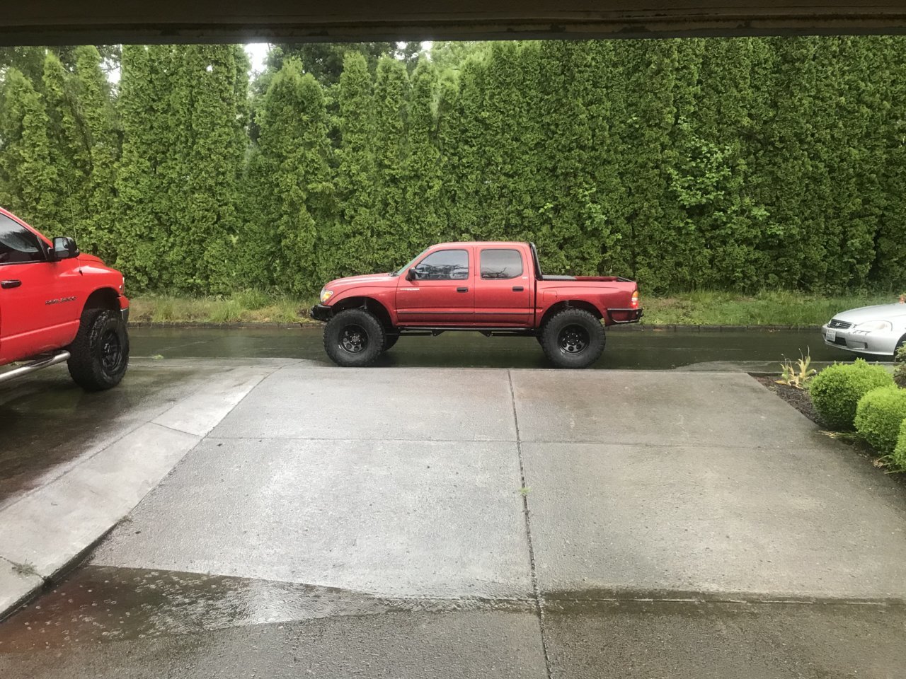

    Test drive was good, need to dial in ride height still but very happy with results

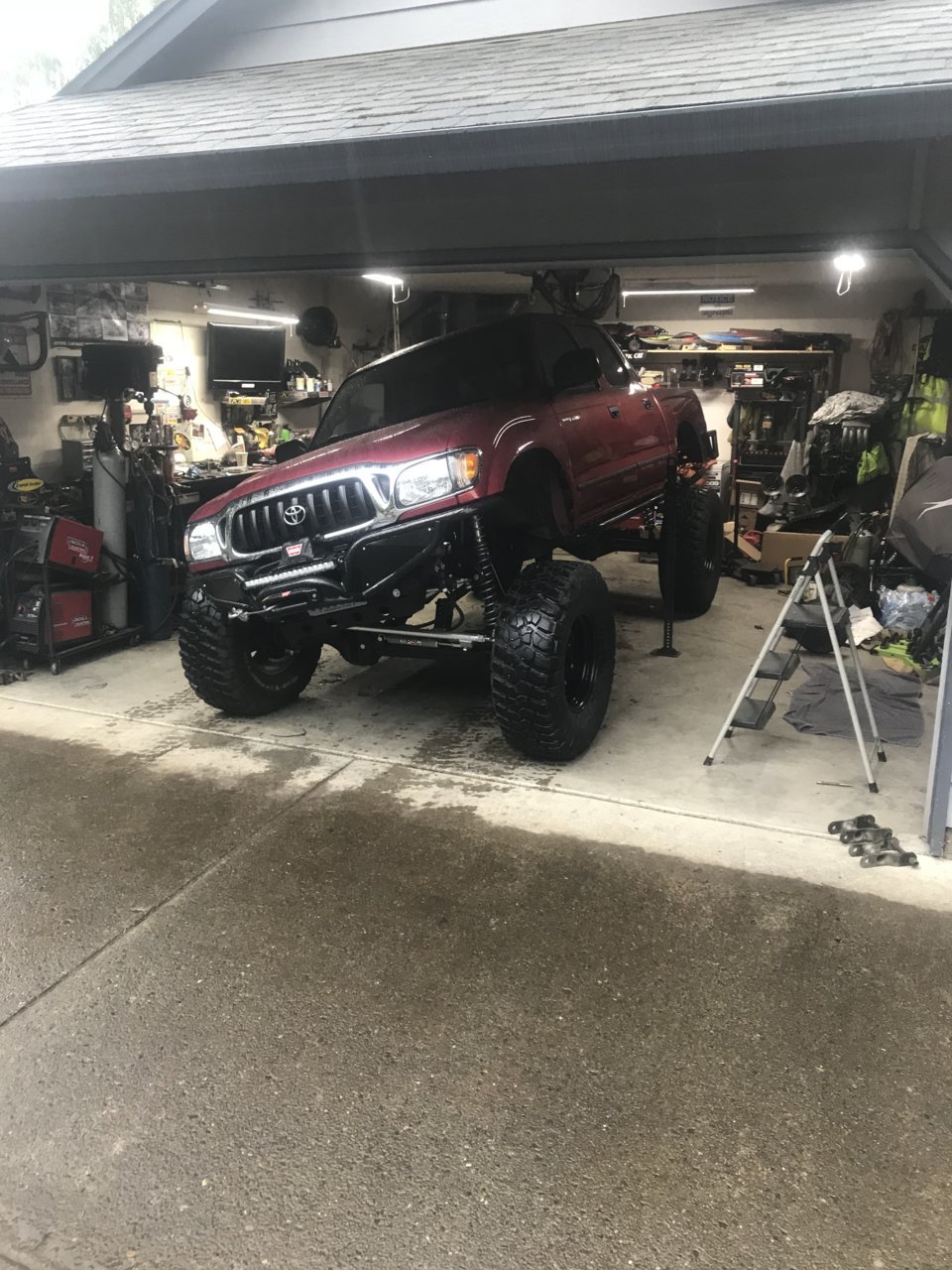

    Stuff going down today

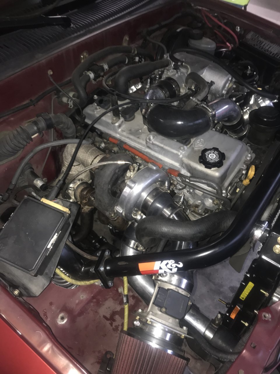

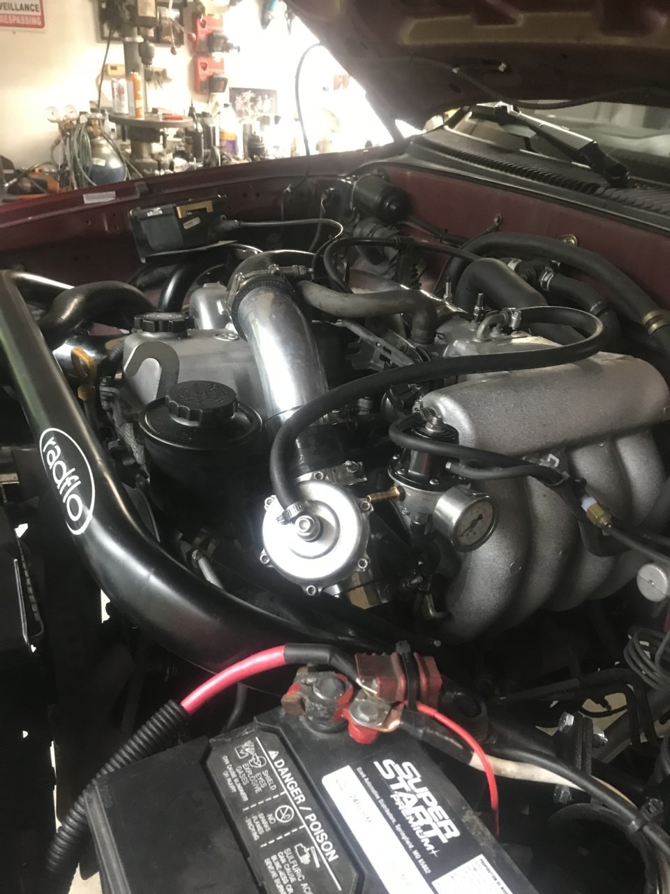

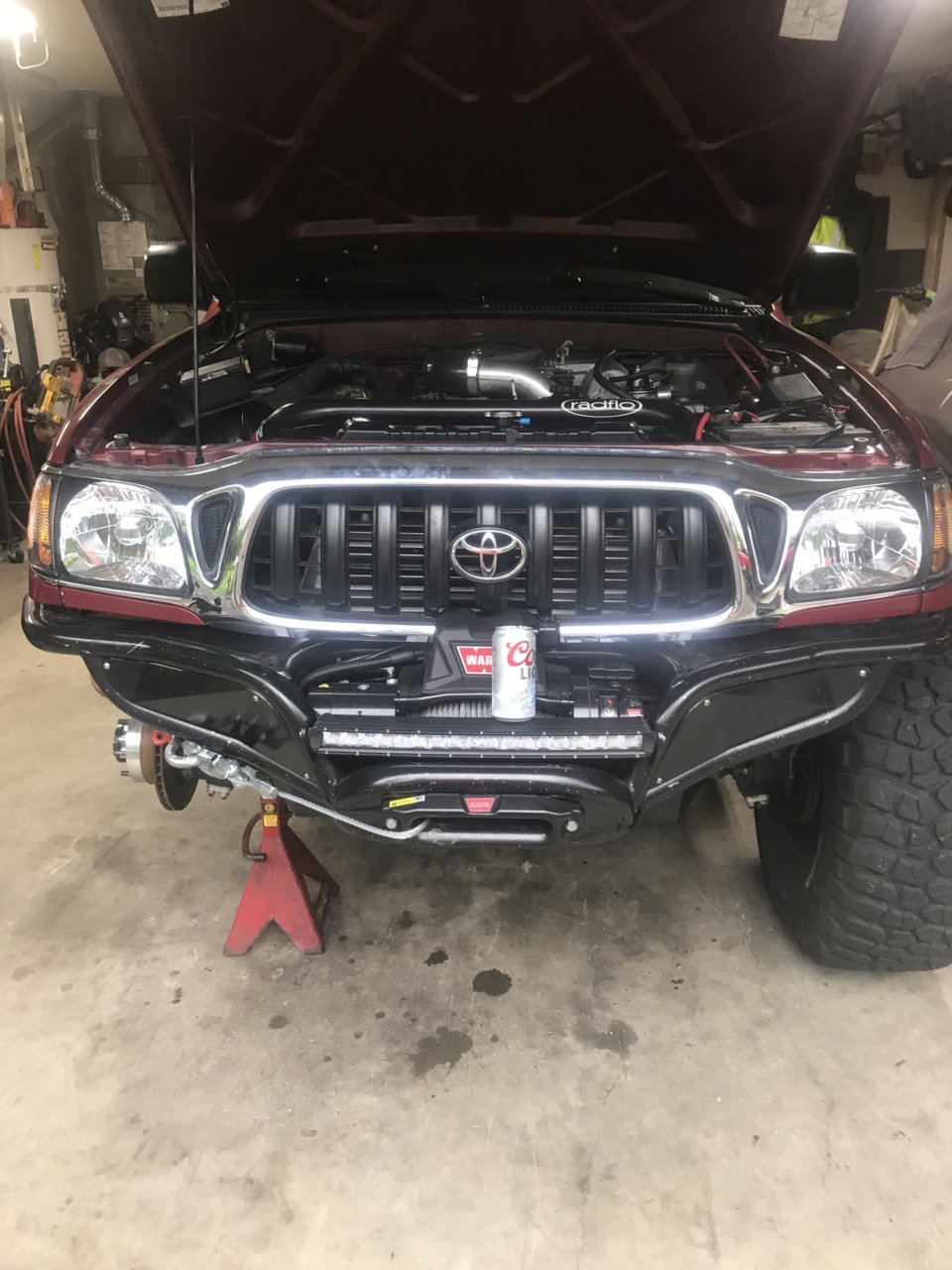

    Tacoma sas

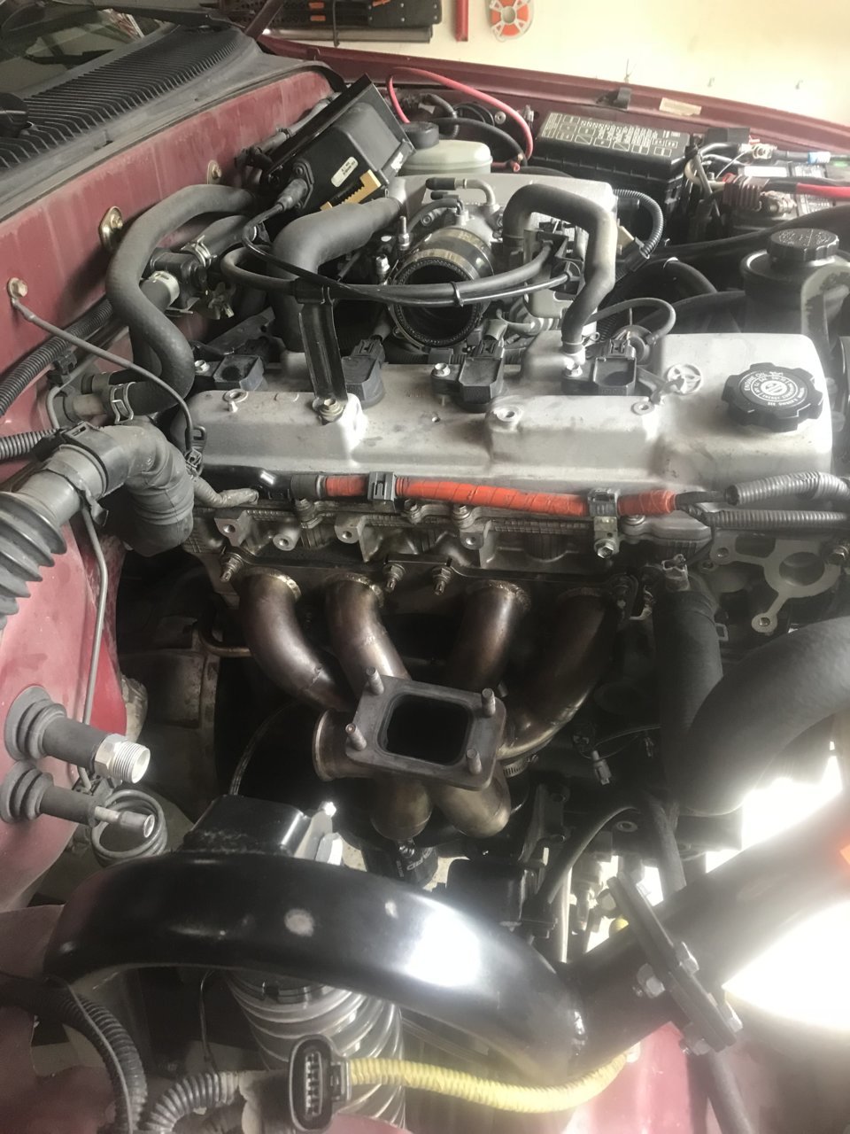

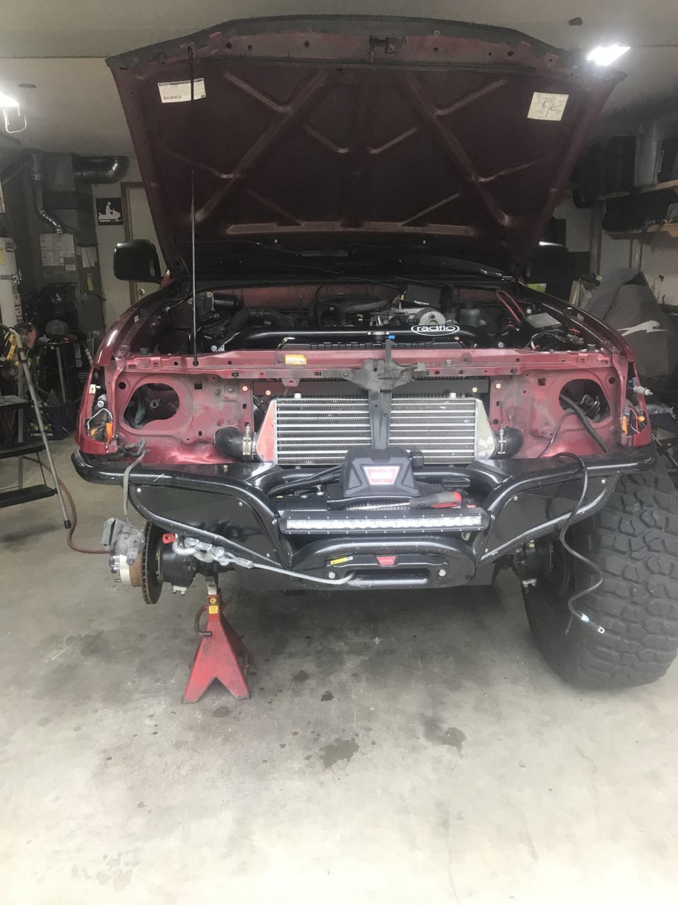

    Made slow progress today but it’s in, still gotta wire up wideband and boost gauge then route the muffler pipe. I ended up having to buy a 3rd gen pickup radiator to squeeze in the fmic as it’s 6” narrower
