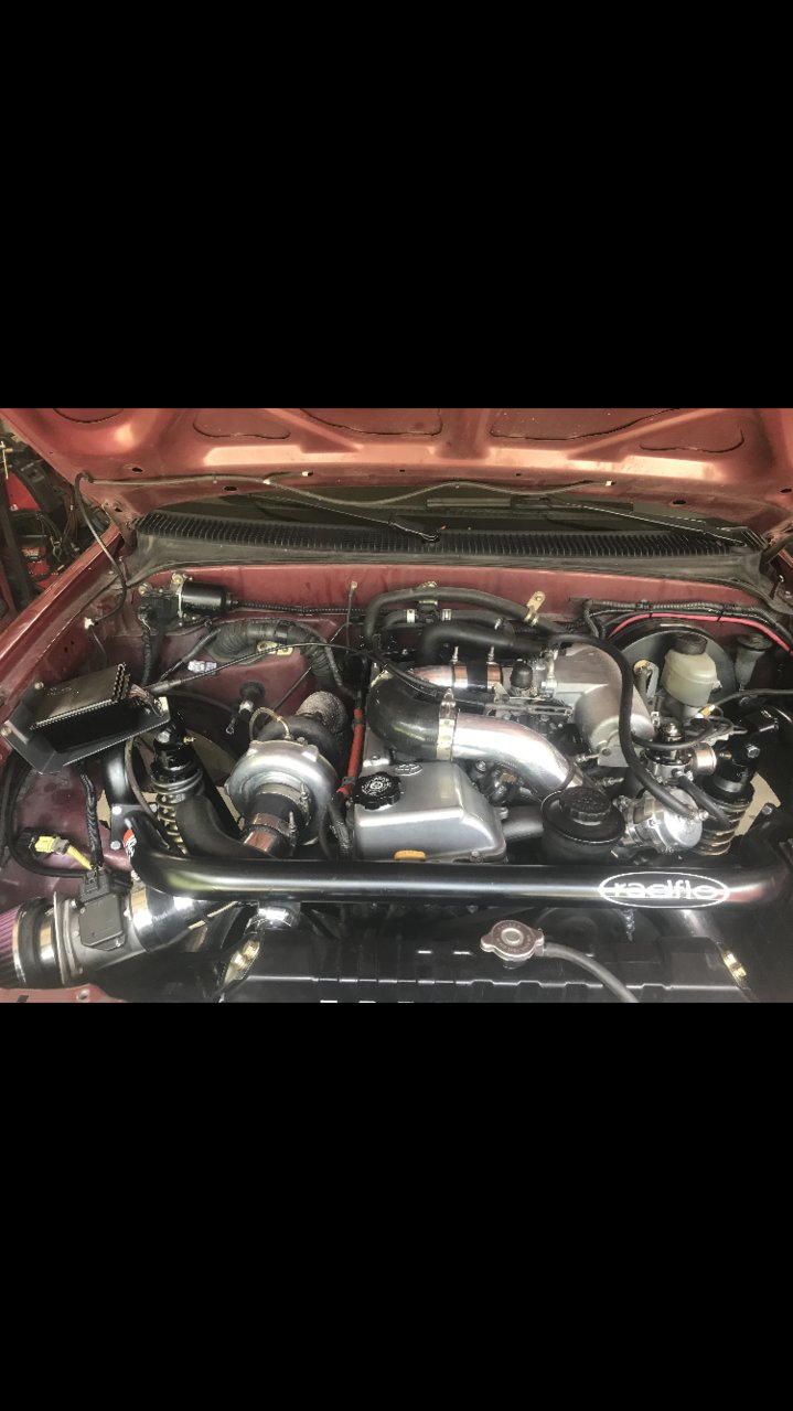

    Test drive went great... crazy how 10lbs of boost wakes up this rz:)

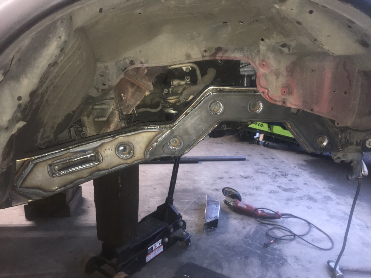

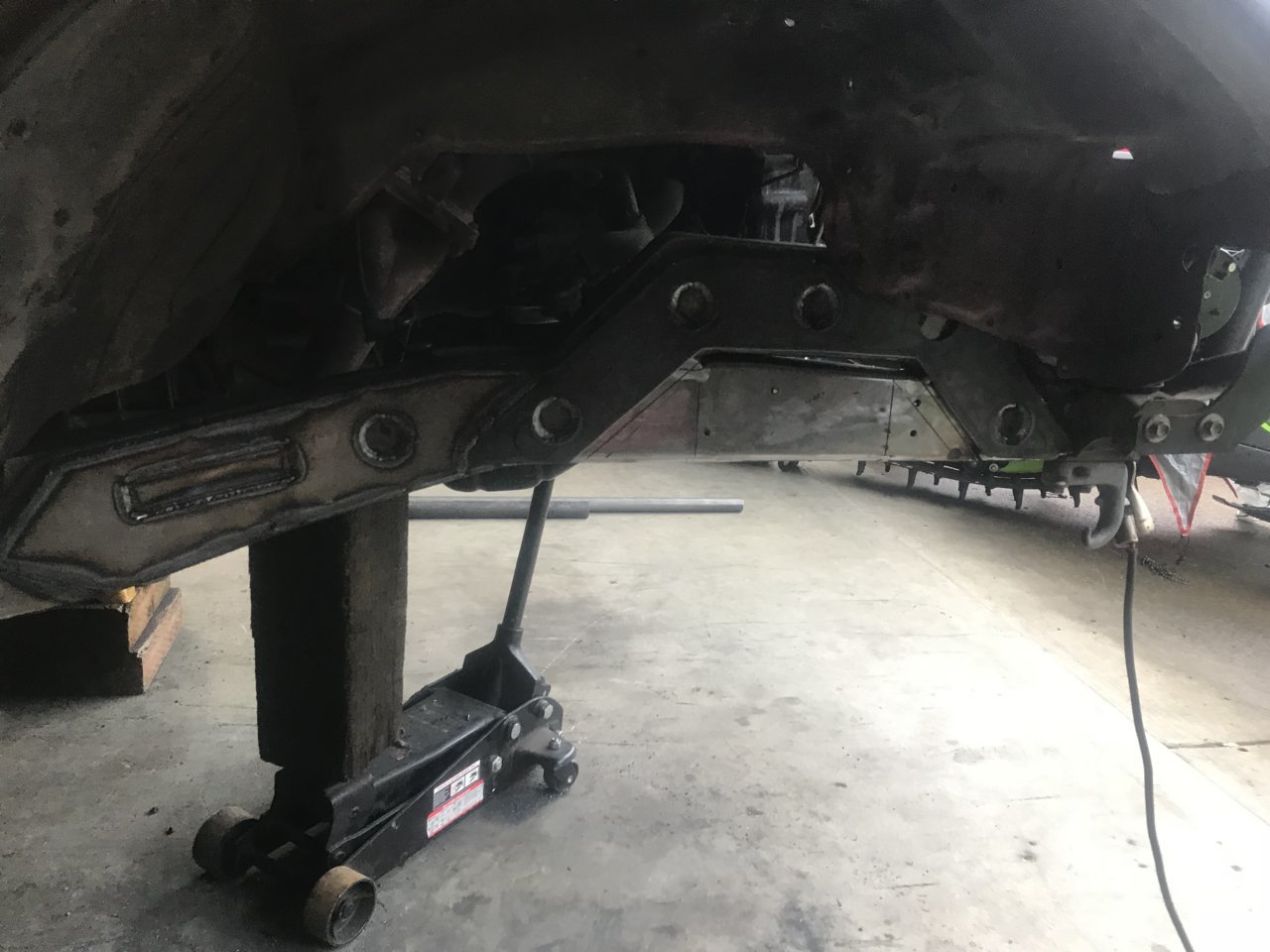

    Talk to me more about what's happening here... got any more pictures and/or measurements?

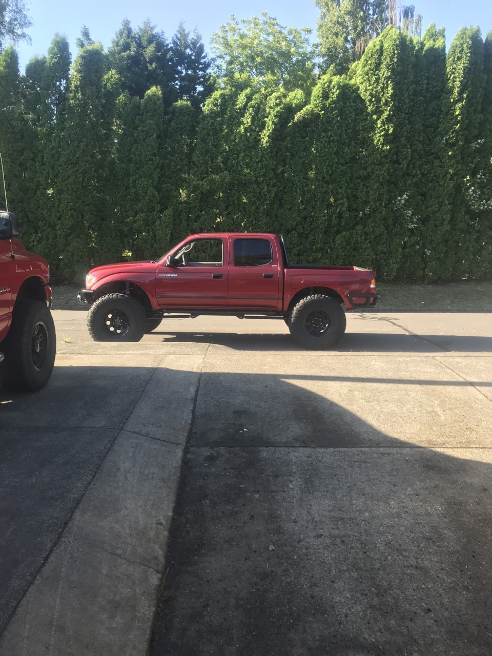

    Was needed for max up travel/low ride height! It’s 4x2 boxtube and bottom of tube is 1” higher then top of factory frame location

    10psi on stock ecu?!
    What turbo?
  6. May 20, 2020 at 9:44 PM
    #146
    Kkrause09
    Kkrause09 [OP] Well-Known Member
    Jan 20, 2020
    #316705
    171
    Kyle
    Tacoma sas
    Ya, been running this setup in my 3rd gen since 2013 with no issues, still stock gasket. Hoping the Tacoma will like it as much:) Garrett t3t4. Running a turbo smart fpr set at 65psi

    Damn. Maybe I should consider a fpr. I have heat issues at only 5psi. I didn't think a fpr would help in closed loop though. Thought the ecu would tune it out after some driving to maintain 14.7.

    Very nice. I figured that's what you were up to. I was thinking about doing something similar but I'm leaf sprung, so I don't know how it would hold up.

    That seems waaay too easy... stock ecu and a fuel pressure regular to bump up the pressure.. :bikewheelie:
  12. May 22, 2020 at 10:15 PM
    #152
    Kkrause09
    Jan 20, 2020
    #316705
    171
    Kyle
    Tacoma sas
    Lol it’s worked for me, I drive it like a 2stroke:) once rpms are 3700 I let her eat

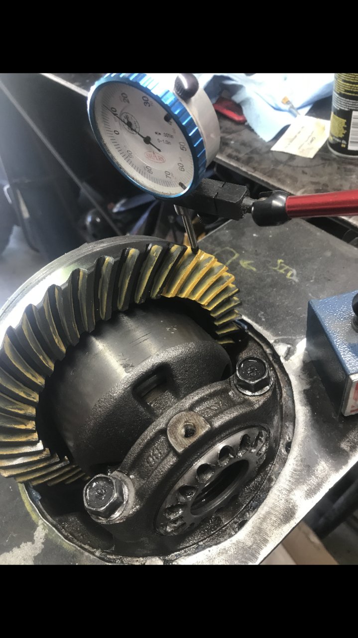

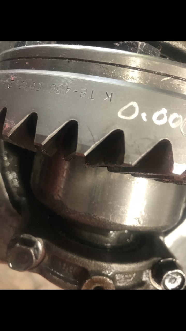

    The last piece of the puzzle was pulling my 4.56 with the Detroit locker out of my 3rd gen and what do you know... cracked ring gear teeth!!! Fuckkkkkkk
    Hoping my local 4wp store has everything in stock, I’m needing to take this to the woods!!like yesterday

    Apparently g2 is completely out of 4.56 gears and not going to be cutting any anytime soon! So much for warranty through 4wp!!! I ended grabbing some Yukon’s and got them set-up this afternoon, happy with pattern after the second attempt:) hitting the local trails tomorrow finally

    While I was awaiting parts I did some polishing on valve cover and installed rear limit straps. I also tied front link mounts to rears with some 1.75x.25 dom

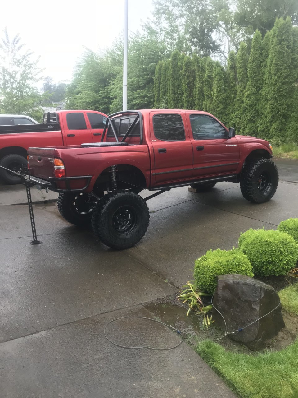

    What size coilover are you running for the front and rear?
  17. Jun 3, 2020 at 9:11 PM
    #157
    Kkrause09
    Jan 20, 2020
    #316705
    171
    Kyle
    Tacoma sas
    14” 2.0s

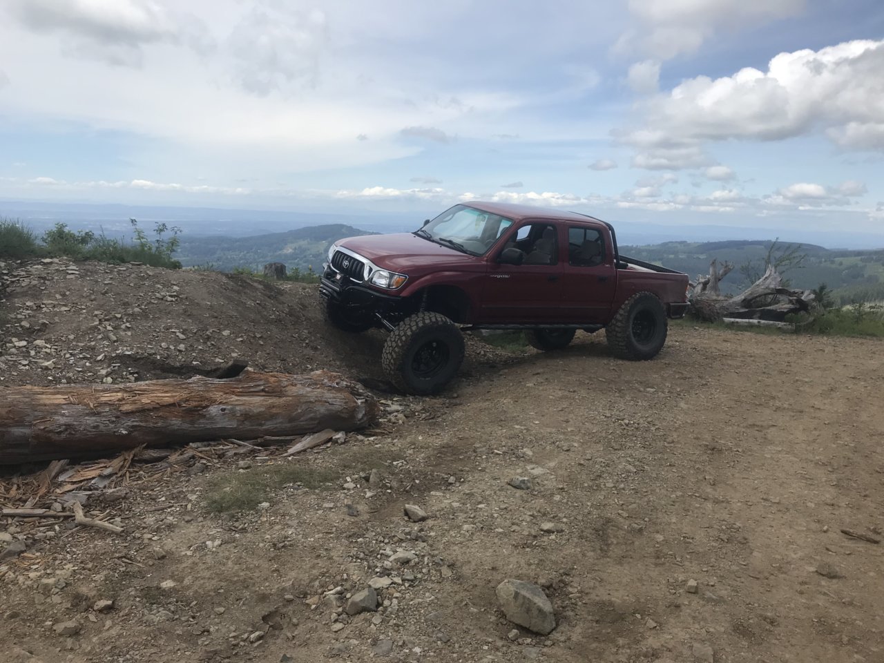

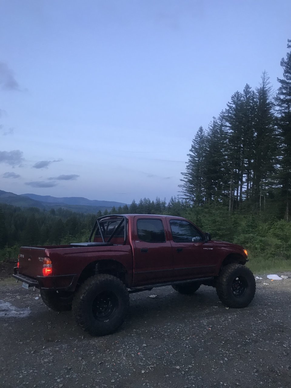

    Good shake down run, still need some more fender clearance in rear but otherwise truck did great
