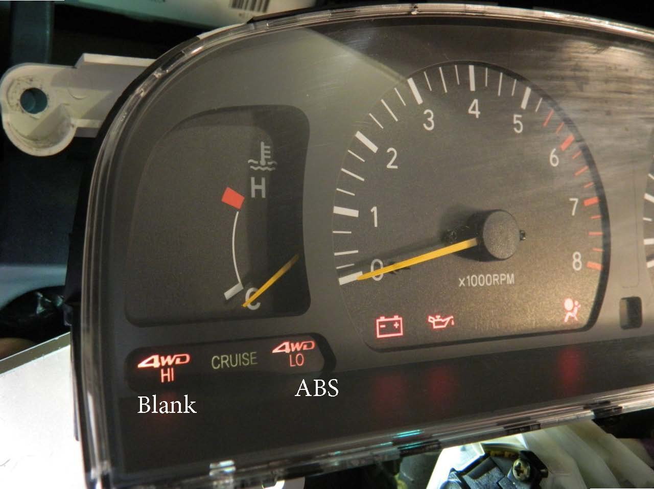

    Hate to kick a dead horse, but just found this, concerning the early, 1st Gen Cluster panel Elocker symbol.........Looking at installing a Elocker would like the original light for the Elocker in the dash.
    I'm in the same boat you were in. Looking for any instructions, directions concerning making a symbol for the (ELOCKER). Pulled my Cluster, Zippo , Blank, dark inside.....
    last socket on the drivers side. I do have ADD also my 4x4 stick has the High- Low, like your set-up. Just not sure if I can add the wires to the cluster, Like your set up. Your 4WD Low symbol is where my ABS symbol is, I do not have ABS...so I'm game to add the whole set- 4WD Hi - CRUISE - 4WD LO.
    I sure would appreciate any info:

    Wow! Fantastic work on the custom lens. I really like the Toyota style script on the “4WD Hi” and “4WD Lo”.
    Any more details on how you printed the lens? Did you print directly onto the plastic lens? Or is it an adhesive decal?

    It’s several layers of plastic projector transparency glued together. There’s a black layer, a color layer, etc.

    a how to thread would be really cool :fingerscrossed::D

    Basically I took it into Adobe Illustrator and uploaded a high quality scan of the original lens. I retained the Cruise light, and then put in my own graphics for the 4WD lights. I took that layer and changed the colors on each one. Printed them out, cut them, and glued together.
