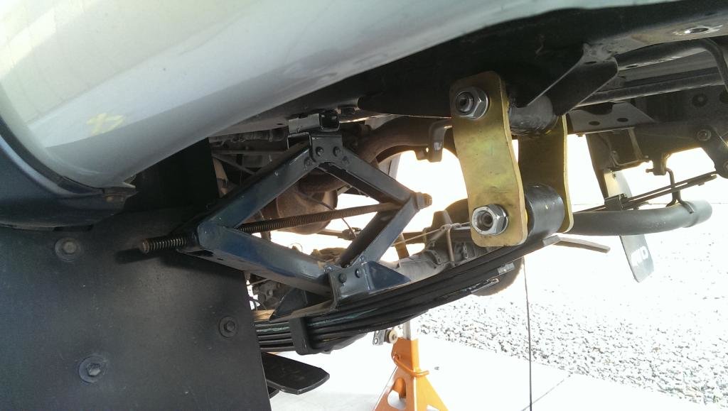

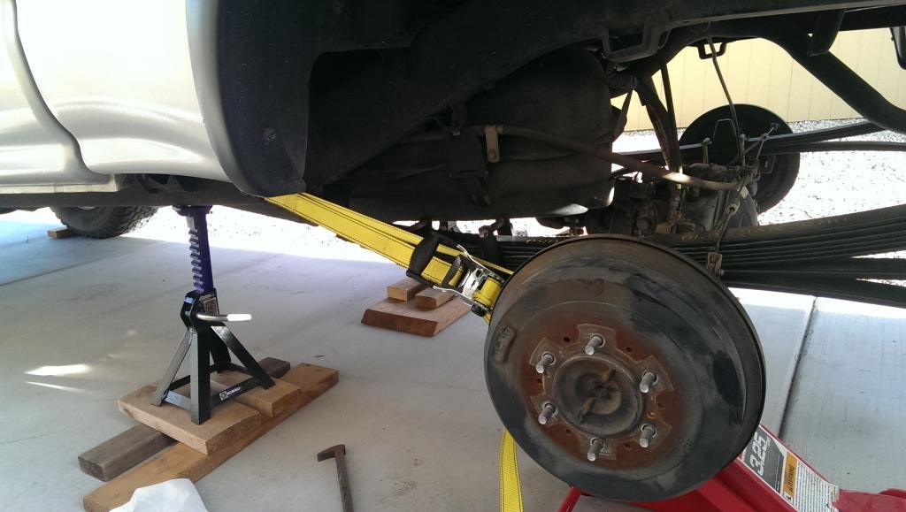

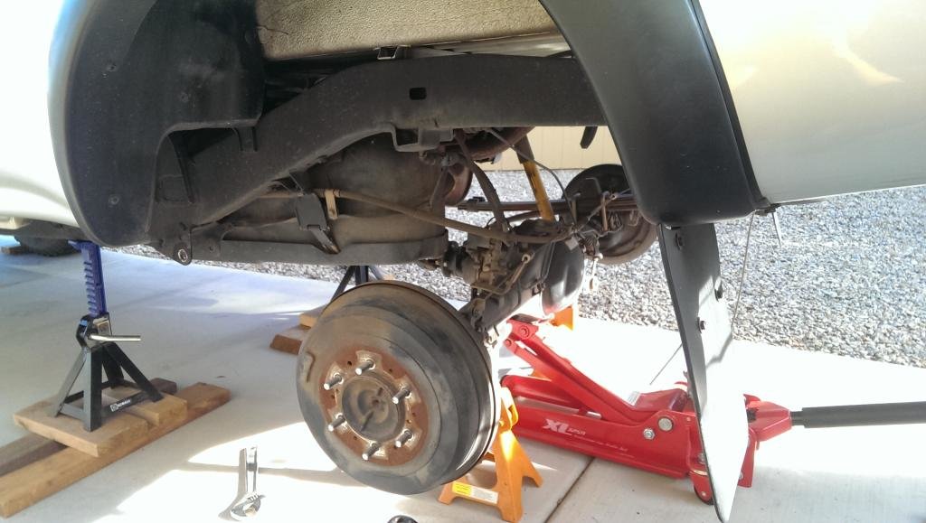

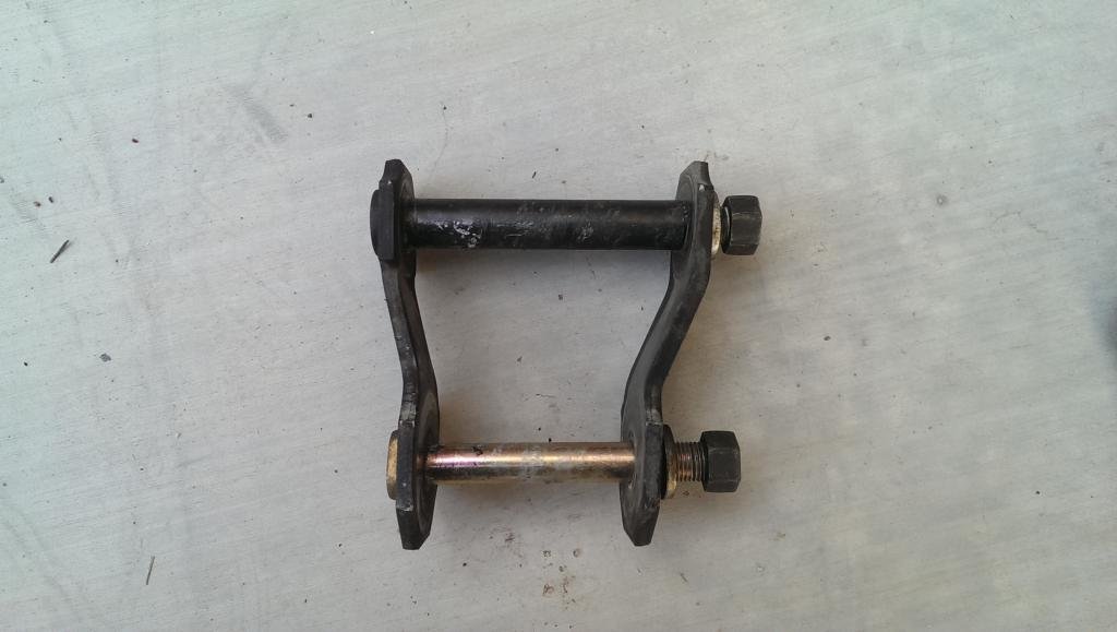

    John, you were right lol.
    I was hoping to finish up the whole rear and only got to finishing the driver side leaf pack and U-Bolts...
    Springs didnt want to go in the places I wanted them to go....
    Everything off the drivers side...
    Shackles don't look bad at all.. But then again this is Phx AZ, the land of no salt or snow ;)
    Ratchiting the axle forward..
    Using scissor jack to get the dang spring in place....... Took a long time to think of this idea..... (Bolts were tightened after that)
    Finished! Still need to add shocks

    Surprised you needed to Rachel forward, mine needed that too the first time but figured it was cuz I failed to anchor the axle on stands.
    Edit
    Not Rachel... Ratchet

    I thought with dakars you almost always had to ratchet it forward because the center pins are in different positions compared to stock.
    Most of the pics and installs showed people doing it.

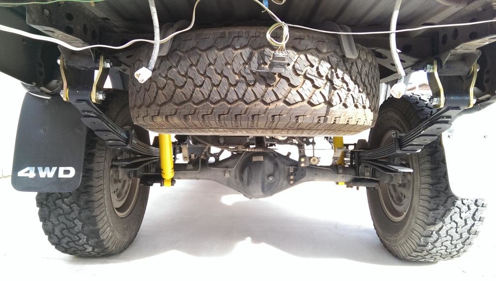

    Rear done
