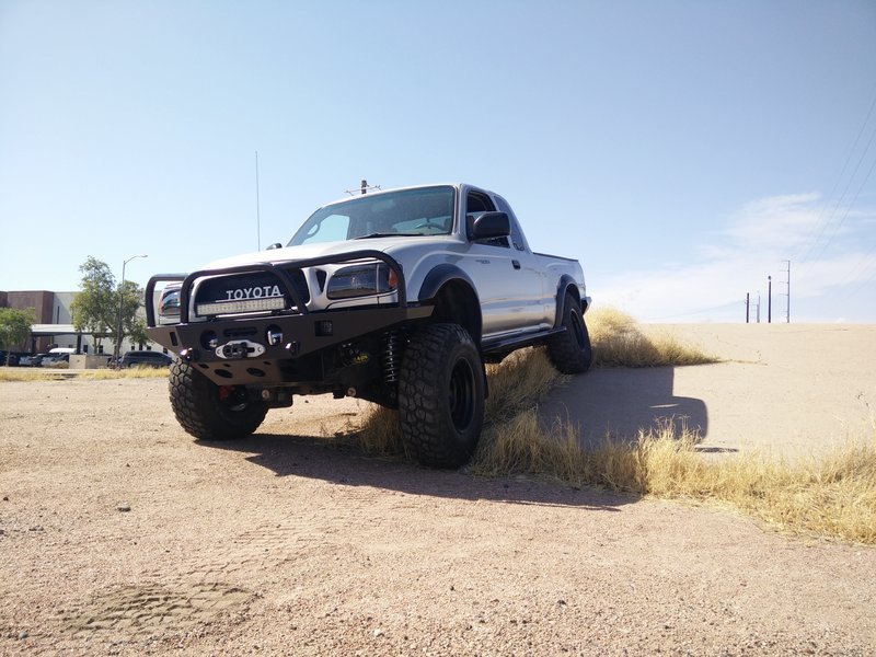

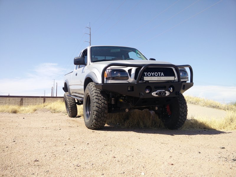

  9. Jul 29, 2016 at 3:54 PM
    #2009
    Delta00
    Delta00 [OP] ᕕ( ᐛ )ᕗ
    Sep 16, 2013
    #112633
    4,137
    Troy
    Chandler AZ
    2002 Toyota Tacoma 4WD
    Check Build
    Went out and saw how much flex I could get, probably could have got more just ran out of ramp.

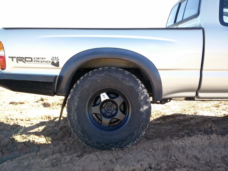

  16. Aug 1, 2016 at 12:30 PM
    #2016
    rngr
    rngr Aix sponsa
    Jan 13, 2015
    #146258
    9,244
    01 SR5 4x4 2.7L
    Awesome build. I picked up a 1st gen and have been thread stalking all of you 1st gen guys. I have dakars and 255/85 km2s waiting to go on my new old truck. Forgive me if I'm wrong, but I think it was here I read about relocating the rear axle to eliminate rear rubbing. Was that you? If so, what does that entail?
    Edit - something like this, I assume?
    MatthewMay1 and Adventurer_Alex like this.
  17. Aug 1, 2016 at 2:52 PM
    #2017
    Delta00
    Sep 16, 2013
    #112633
    4,137
    Troy
    Chandler AZ
    Check Build
    Yeah, but I got mine here...
    http://www.4crawler.com/4x4/ForSale/Shims.shtml#StdRelocationPlate
    You just have to take off the u bolts, and drop the axle down then slide the plates in and select how far you want to move it back.
    Mine rubbed pretty good
    Now it looks good, not flexed all the way but I haven't had any issues.
