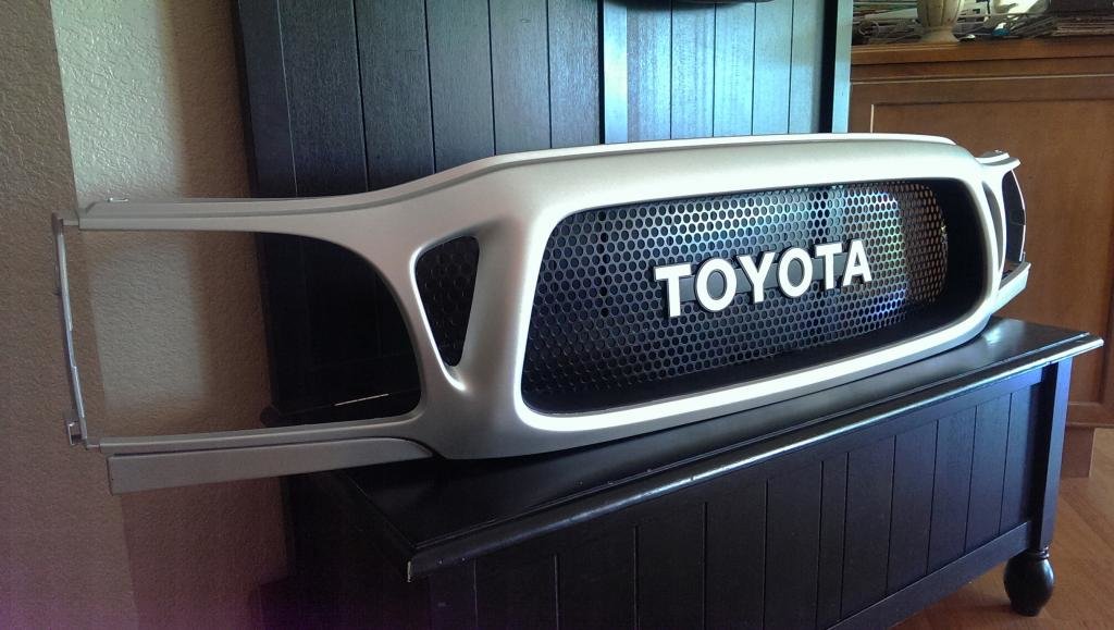

    I painted my chrome grill. Used duplicolor perfect match and I think it came out good. You need two cans though. Wish I had another when I did mine.

    Wow, Turned out great. What did you do to prep it? sandblast, sand? Any primer or adhesion promoter?

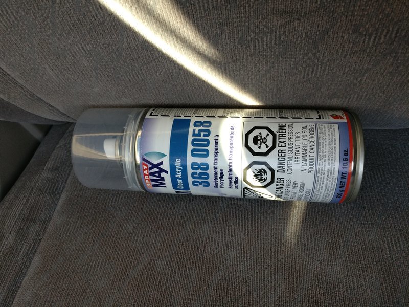

    Lots of sanding, then a couple coats of self etching primer. I used the duplicolor clear but I didn't think it was all that great.
    I'd recommend this clear, you can get it at Sherman Williams stores that mixes automotive paints.

    Mmmmmmmm so glad I painted mine too. I used one can and a separate can of clear coat and it turned out well.

    Looks great. No problems with it holding up?

    When y'all sanded the chrome Did you completely remove it or just scuff it up?

    Few rock chips, but nothing unexpected.

    I scuffed it pretty good with a scotch brite.

    Mines held up well, some rock chips but other than that I cant complain.
    Looks great! I was very happy how well it matched.

    I sanded mine pretty well.
