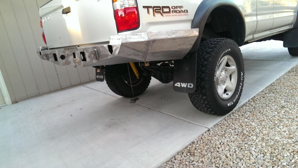

    Its nothing super major. Ill take pics of it after paint.
    The wrap around portion that got welded on the passenger side looks pretty good. Driver side wrap around looks a bit to far angled down for my liking. But the bumper could definitely take a beating to it will do its job great. I little more grinding and sanding and i think it will look pretty good though.

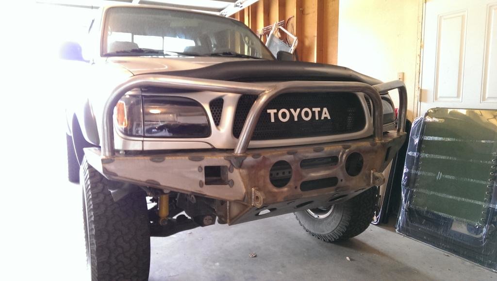

    Getting everything to fit before paint

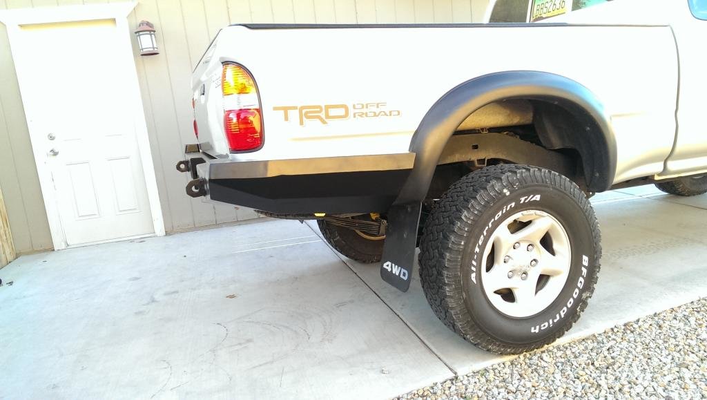

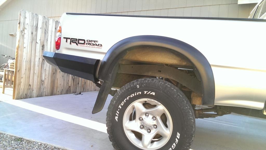

    Not the best pic but here is the driver side kinda angled to far down for my liking
    Passenger, if driver looked like this I would be happy
    Ill get better pics of what im talking about later.
    Id also like the gaps between the body and wrap around to be closer and more uniform but I dont mind that all that much.

    It's pretty good man. I think that isn't uncommon with aftermarket bumpers as a whole. My front droops a tad but it is good enough :) no one will look that close but you!

    got mine on the other day, yours looks good!
    can you get your spare tire down or is the bumper too high? I had to shim the bumper down with washers to give enough clearance to get the rod in there for the spare tire winch.
    you could also shim the left side bottom bolt (1 or the 2) to get the bumper to change angle a bit.

    Thanks for the heads up, I just checked to see if I could get the spare tire down and youre right. Im going to shim it a bit to get it back up.

    no prob, i shimmed it just enough to get it in there and its pretty tight, i didn't want to go too low with the bumper so a lil bit of shim and trimming of the sheet metal above will do as well.

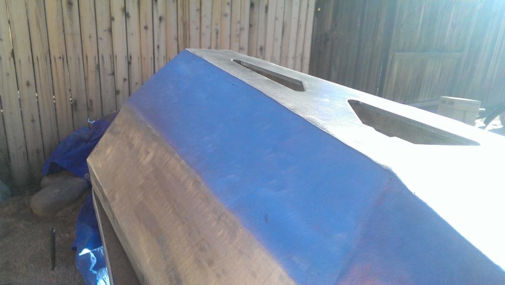

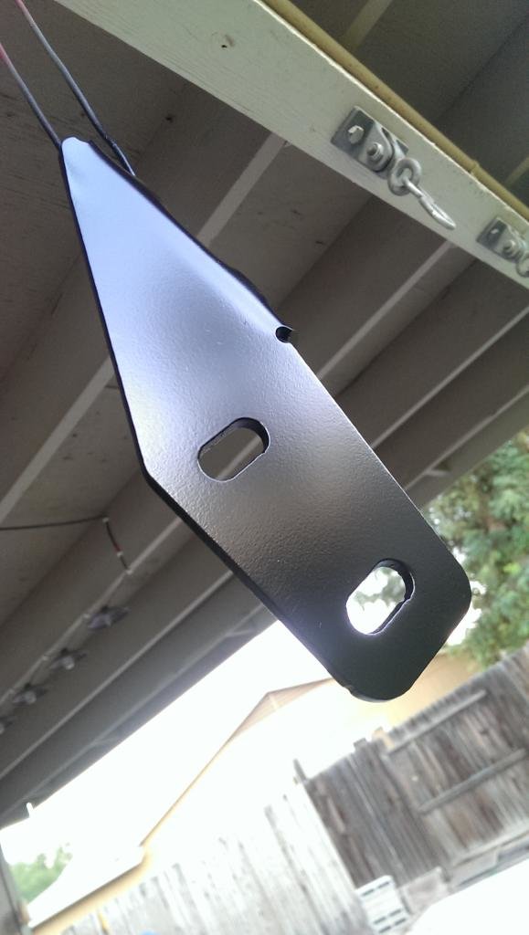

    Started painting the small pieces to get an idea on what the paint would look like. Turned out awesome, love how it looks and I cant wait to lay it down on the front bumper. Thanks Cory for the paint suggestion! (Orange peal effect went away after it fully dried)
    Also, the person I had do the rear bumper must have used some really aggressive flap disc because there were huge scratches throughout the whole bumper that i'm possitive would have shown up in the paint so I went over in in 60 grit flap disc and then rounded it out with a 120 grit orbital sander. Corners and edges look great now and the bumper looks a lot better. Going to paint the rear bumper before the front. Hopefully friday.

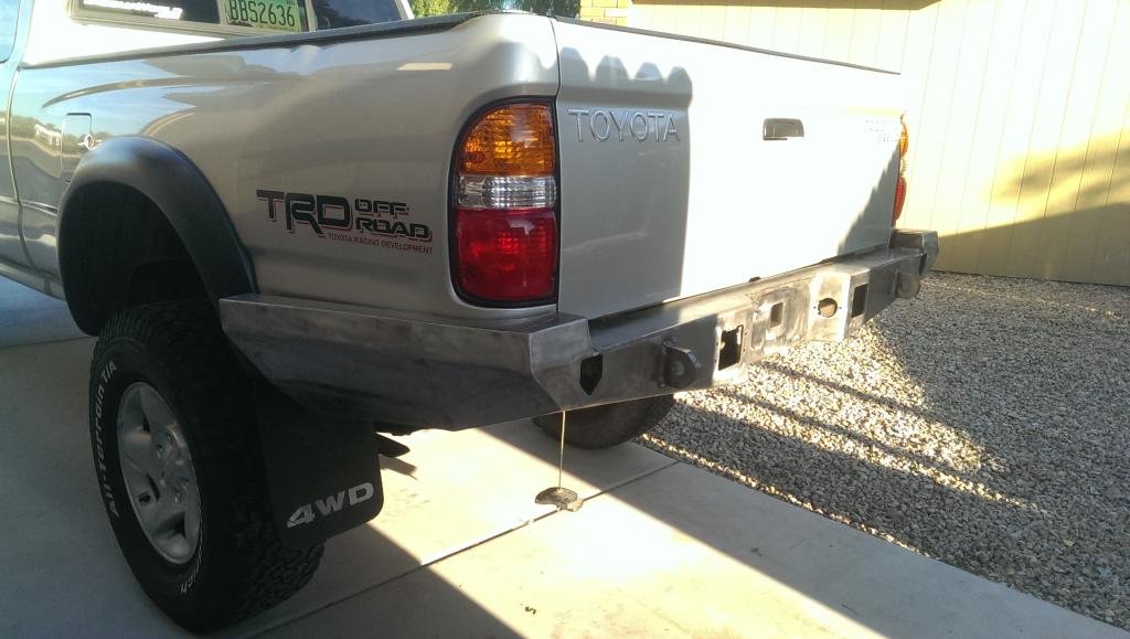

    Thanks man! Got the rear bumper on and painted pics later today.

    Rear bumper. Also, a special thanks to bayareataco for answering a lot of my questions about the bumper when I first got it! Thanks man
    Also, magnetic light I had when I installed the lift held on for about 17 days of driving. Strong magnet hahah

    Damn that turned out nice! You may need to do the flares next ;)
