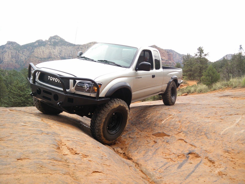

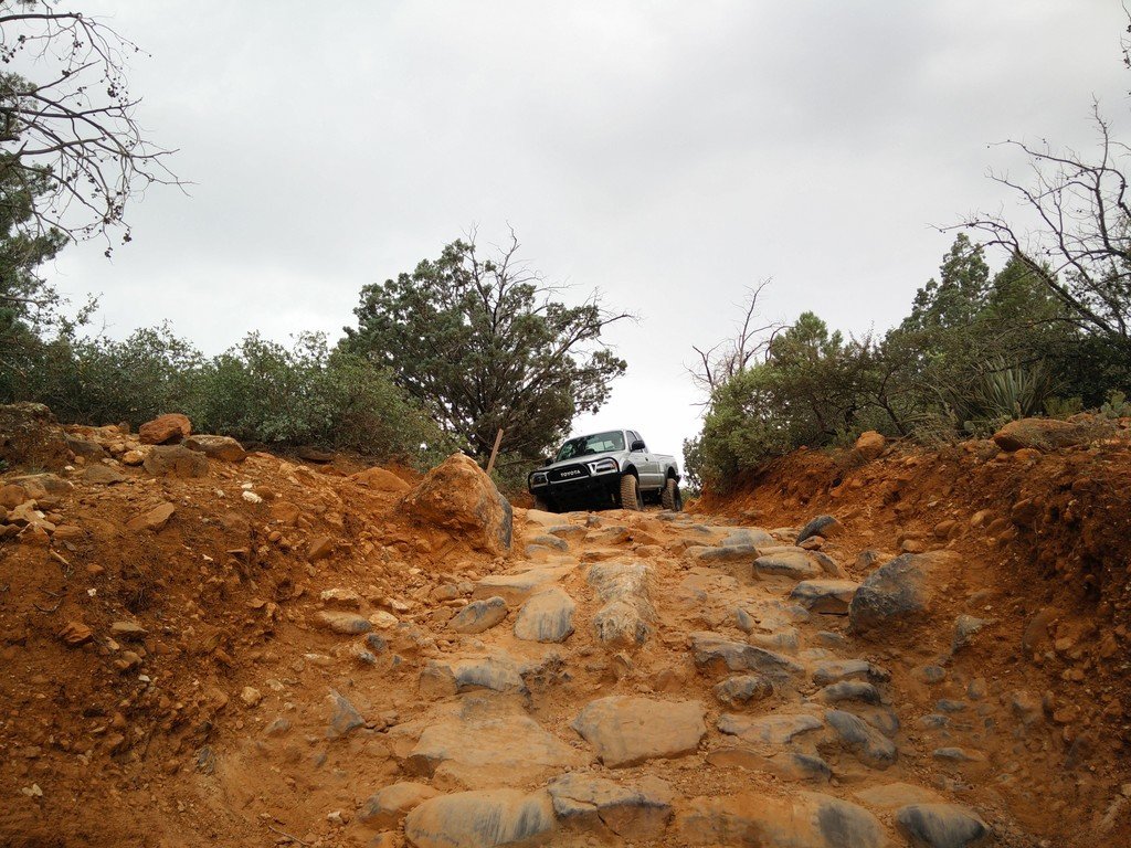

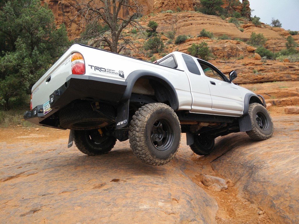

    Made it up to Sedona today, had a great time!

  4. Aug 6, 2015 at 7:47 PM
    #864
    stumbles
    stumbles 1 eye
    Aug 18, 2014
    #136442
    4,391
    bryan
    mesa
    2002 White Double Cab
    Those are great pics. It looks like a blast.

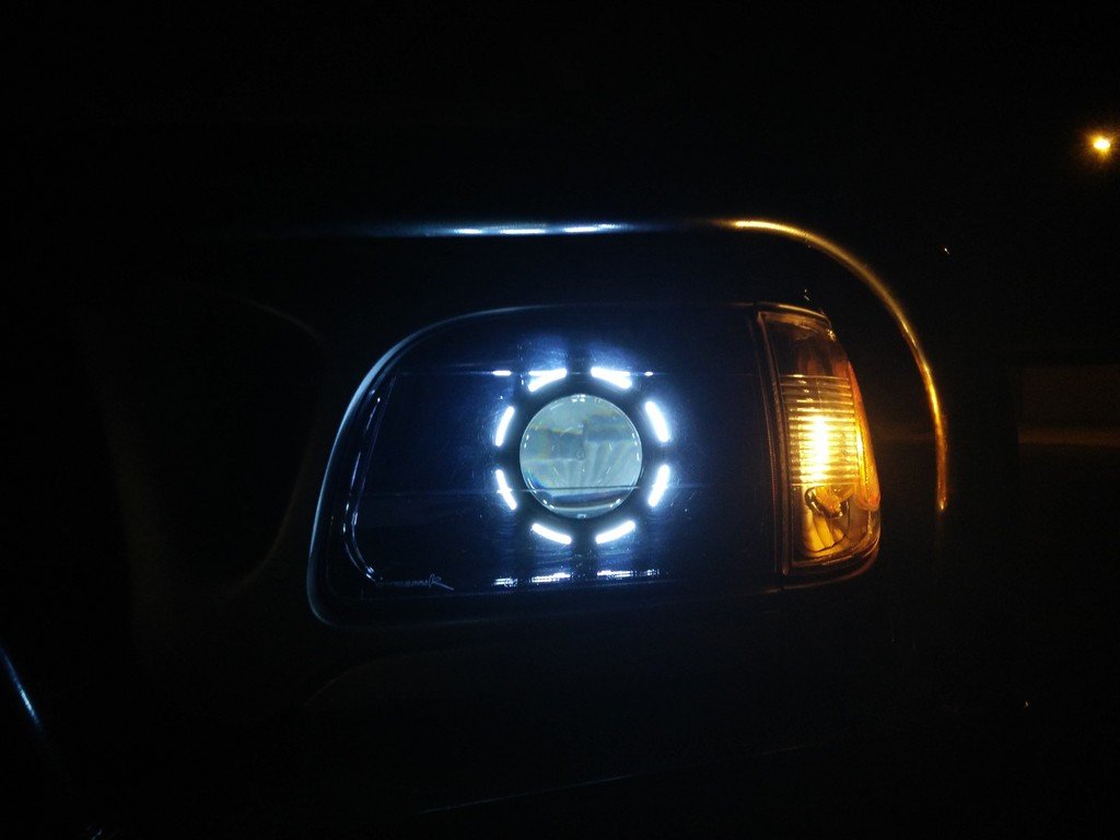

    On another note, led halos are going out. Getting some switch back halos. Thanks warranty. Sucks I have to open things up but there were some things I wanted to change anyways.

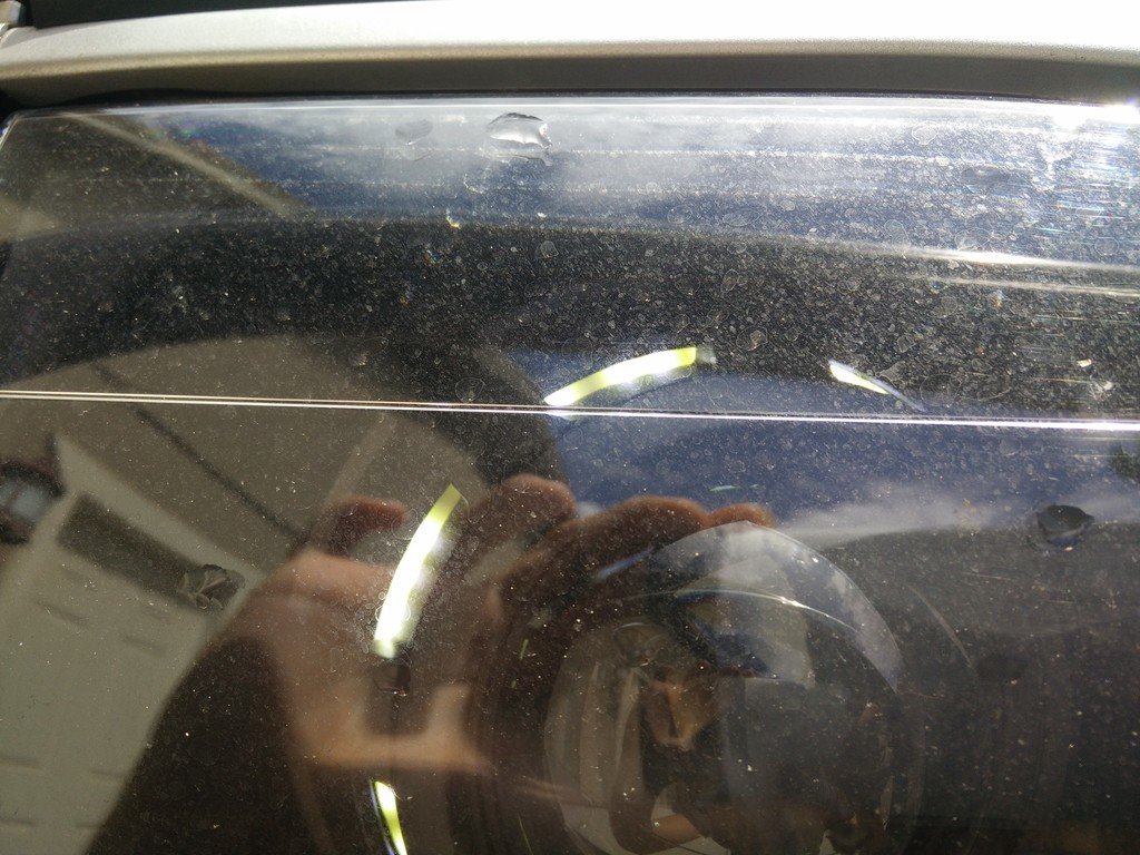

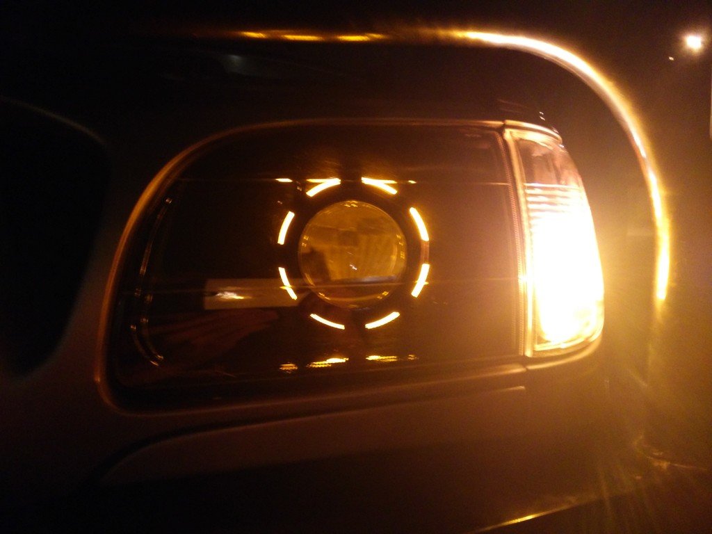

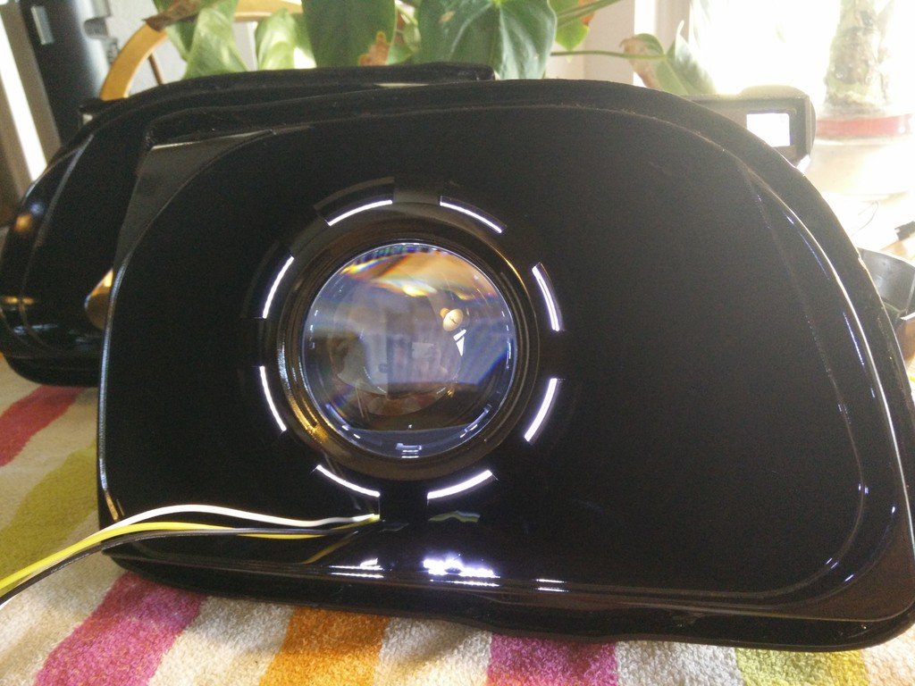

    Finishing the retrofit with switchbacks.

    Looks good Troy

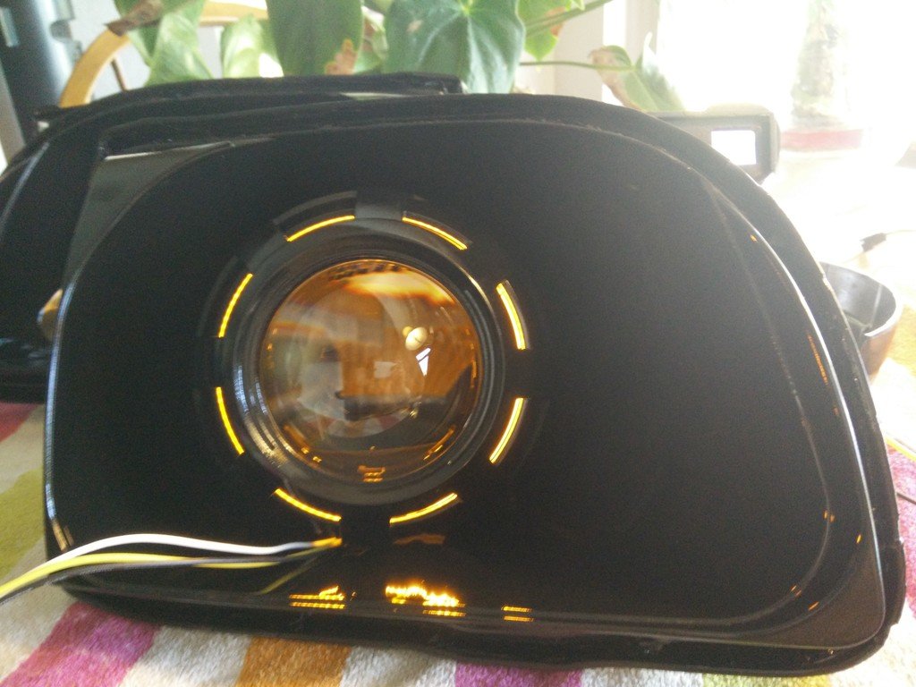

    Finished the new retros...

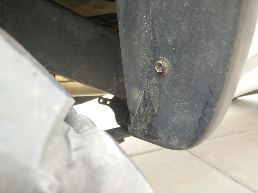

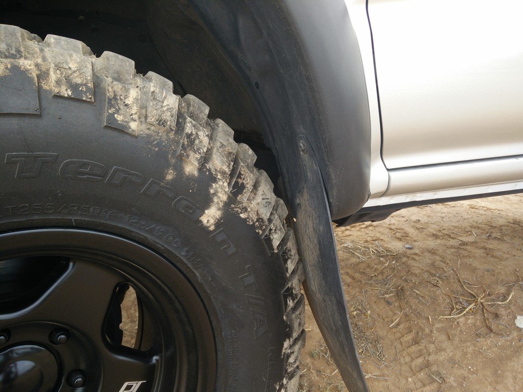

    Do you have any rub with those tires and rims?

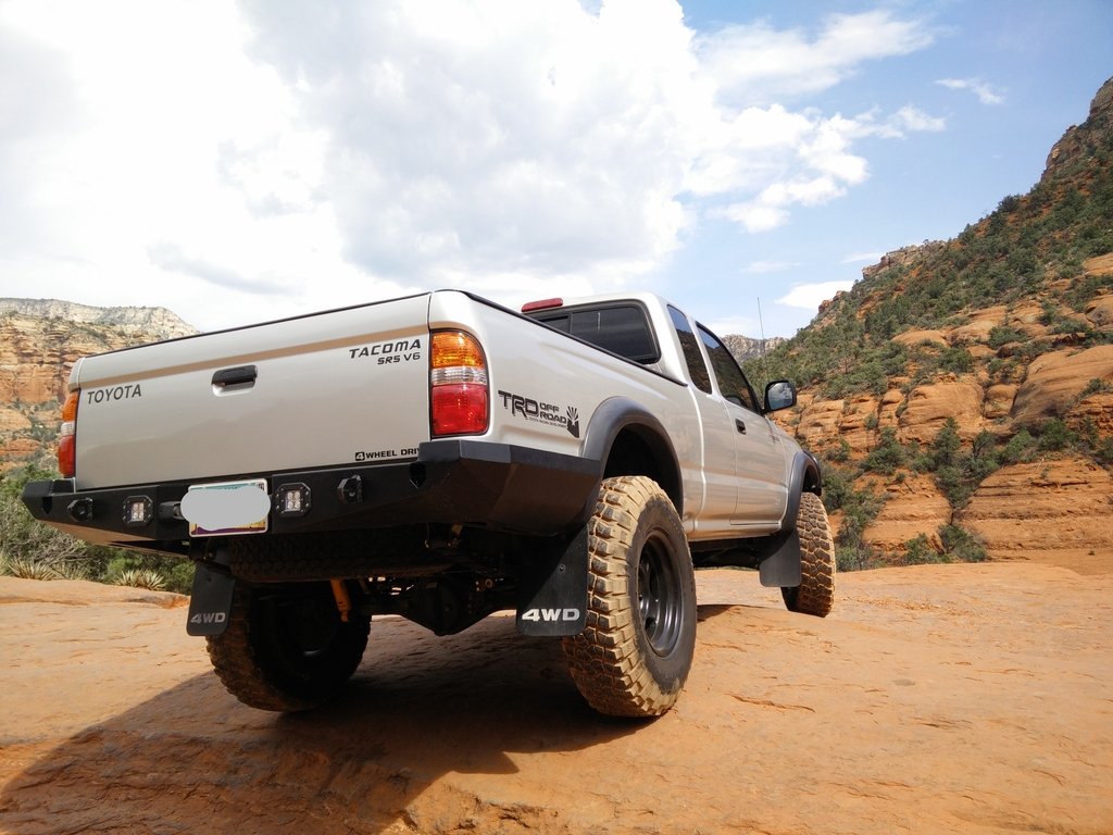

    Some, not any that is to crazy..
    Rear at full stuff rubs here
    Front rubs the mudflap.
