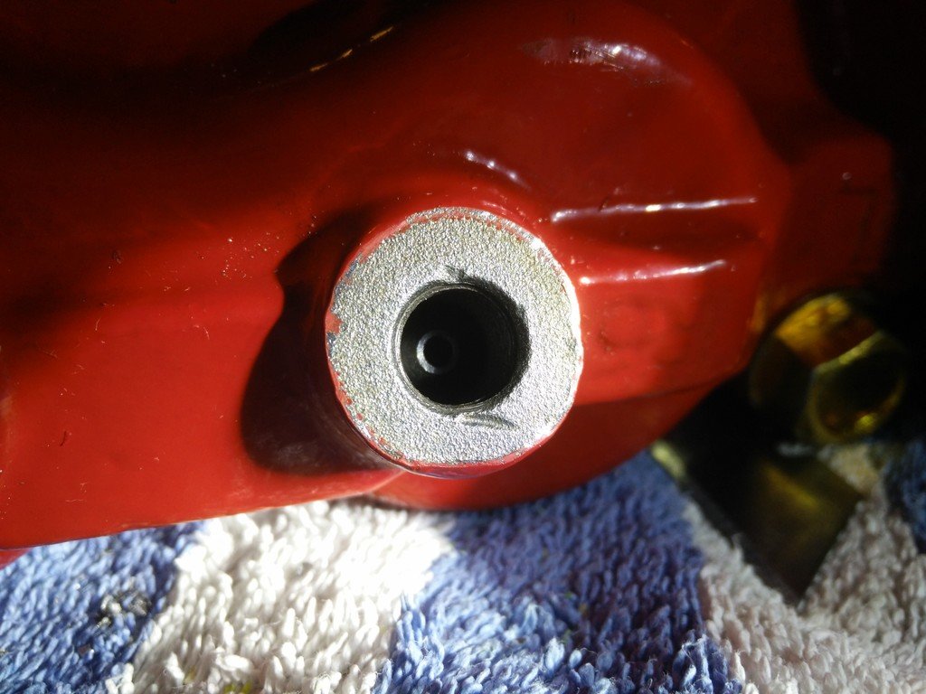

    Did you get a chance to do your brake swap?
  20. Sep 16, 2015 at 12:35 PM
    #960
    Delta00
    Delta00 [OP] ᕕ( ᐛ )ᕗ
    Sep 16, 2013
    #112633
    4,137
    Troy
    Chandler AZ
    2002 Toyota Tacoma 4WD
    Check Build
    Started it but then ran into an issue with the driver side caliper, the place where the copper washer mounts had a deep gouge in. The copper washer couldn't seal up because of that and brake fluid was leaking. I now have new calipers coming to me.
