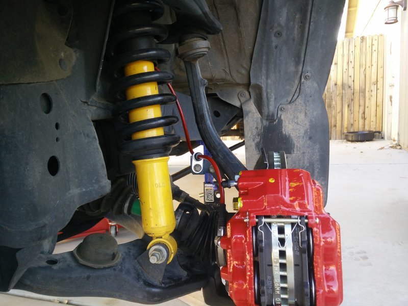

    Oh man, well the first set of calipers I got leaked brake fluid due to a knick on the mounting surface and I had both sides done. I had to take them off and put the stock ones back on. Next set went on in about 2 hours including bleeding haha.

    Ya, I saw your trouble with knick. I'm also doing the LCAs at the same time...so more frustration from that. I got the axle plates, but haven't gotten them on yet. Hopefully soon!

    Even more jelly now! Maybe Sunday I'll get mine in. LCA's and brakes are on the truck finally. Just need to bleed my lines.
    My nuts were rusted and seized bad. I had mine soak in PB for 2 days then gently but forcefully loosened them with a flare wrench. I actually stripped one end putting the new line on and had to run to O'Reilly's to get a replacement hard line. Be careful! I also ended up cutting off the old soft lines from the mount points and did not reuse them. Not sure what Troy did for this.

    The part that attaches to the spindle?

    Nope, here.

    Ahhhh haha. Yeah, I was able to reuse everything.

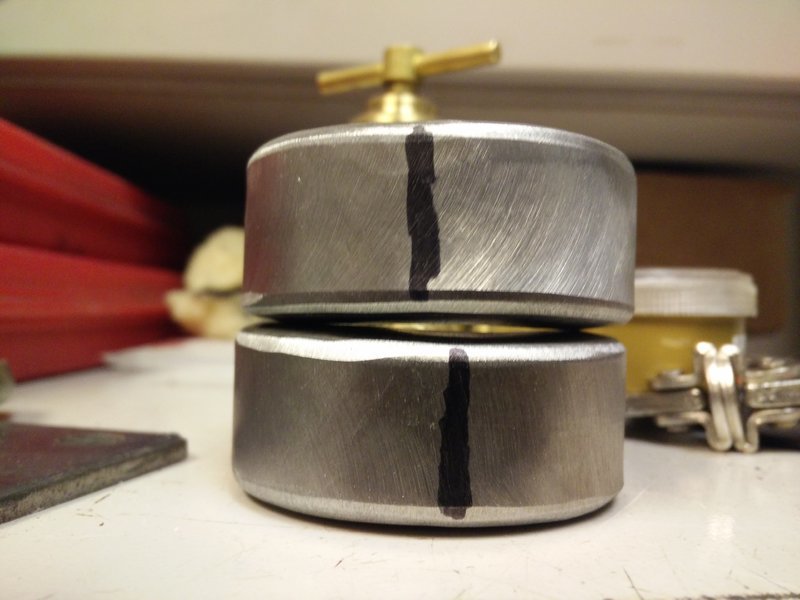

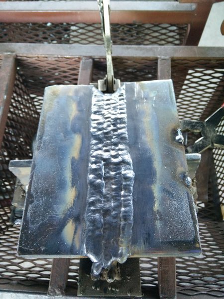

    Passed my 3g dual shield cert! And to celebrate I ordered me a winch.
