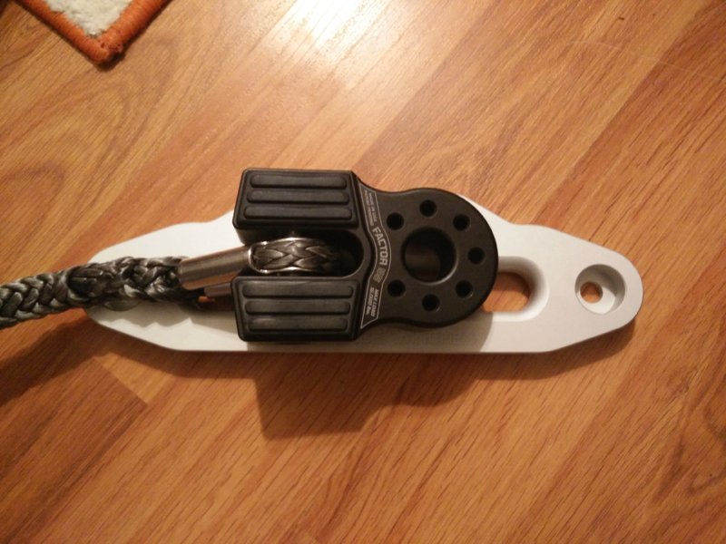

    Nah, just went with the regular flatlink. Didn't see the need for the E

    Really? You can only put a shackle in one way on the standard one, while the Elite version you could use in multiple ways.

    This what I mean by the Elite version. It seems more versatile then the standard one.

    Yeah, but I look into how many times I'll be using it... And I don't think it will be that much. Idk, with how I use it I'm sure it will be enough. And I like it being less bulky.

    I'd still go for versatility over "how many times am I going to use this." It's also not much bigger then the standard on. Maybe a 1/2" longer on the Elite version.

    Eh, well it's more versatile than the hook that the winch comes with :p

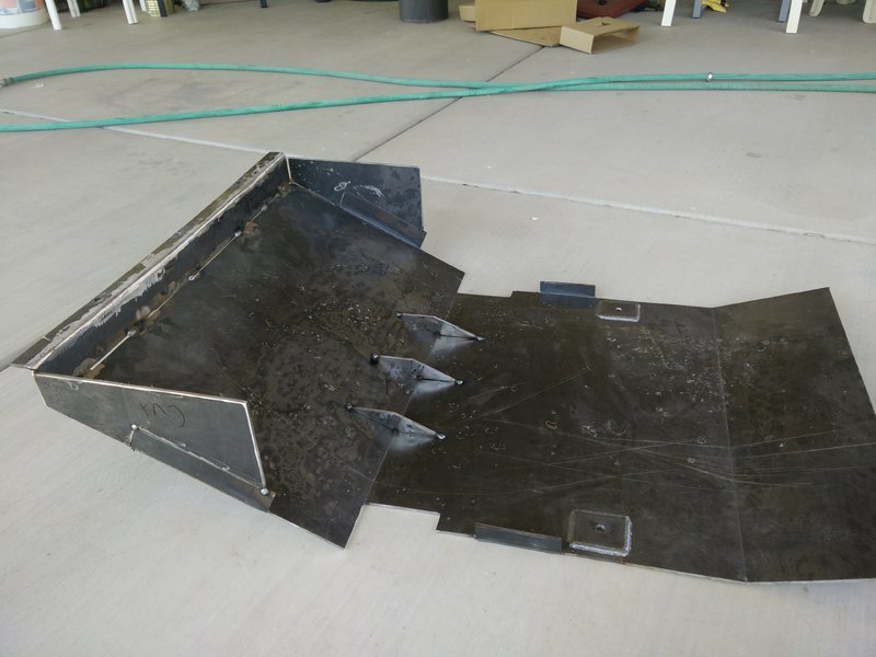

    @cbechtold finished my skid plate today! Ground most of it down, just a bit left but all the welding is done!
    Added some sides to the skid to make it look visually better when on the truck.

    I don't see primer on it :p

    I don't know if I would make another one without a plasma cutter. Cut off wheels take forever. Not to hard though! And kinda fun learning

    You also need a pretty strong air compressor. Running a plasma cutting of a dinky little home depot 1hp compressor sucks. The one my dad has in like 7.5hp or something.

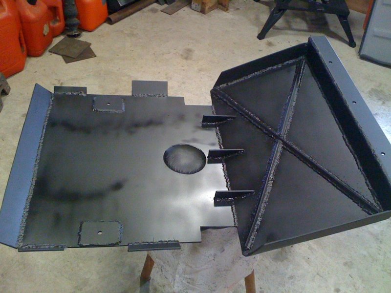

    Might want to make a hole for the oil drain plug, and I recommend making a hole big enough to get your entire hand through, not just a ratchet extension. Like so:

    Meh, I've gotten really good at taking it on and off.
    But how did you go about making the hole?

    I just used the angle grinder...Not the most efficient way, but it worked great. A fresh wheel will make the perfect sized hole. Taking it on and off for oil changes will get on your nerves I'm sure of it. Just make a hole now and don't wish you had one later
    Also, having a hole will allow you to change the oil easily if you don't have a floor jack. And it'll make a mechanic happier if they don't have to remove the plate to get to the drain plug either (if a mechanic ever changes your oil)

    Ohh ahh looks good.
