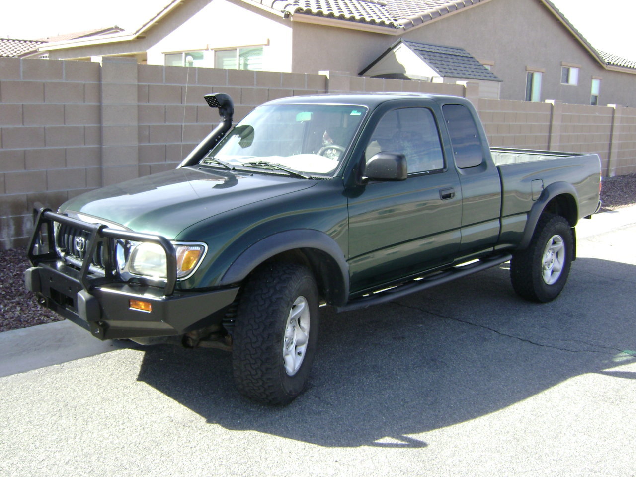

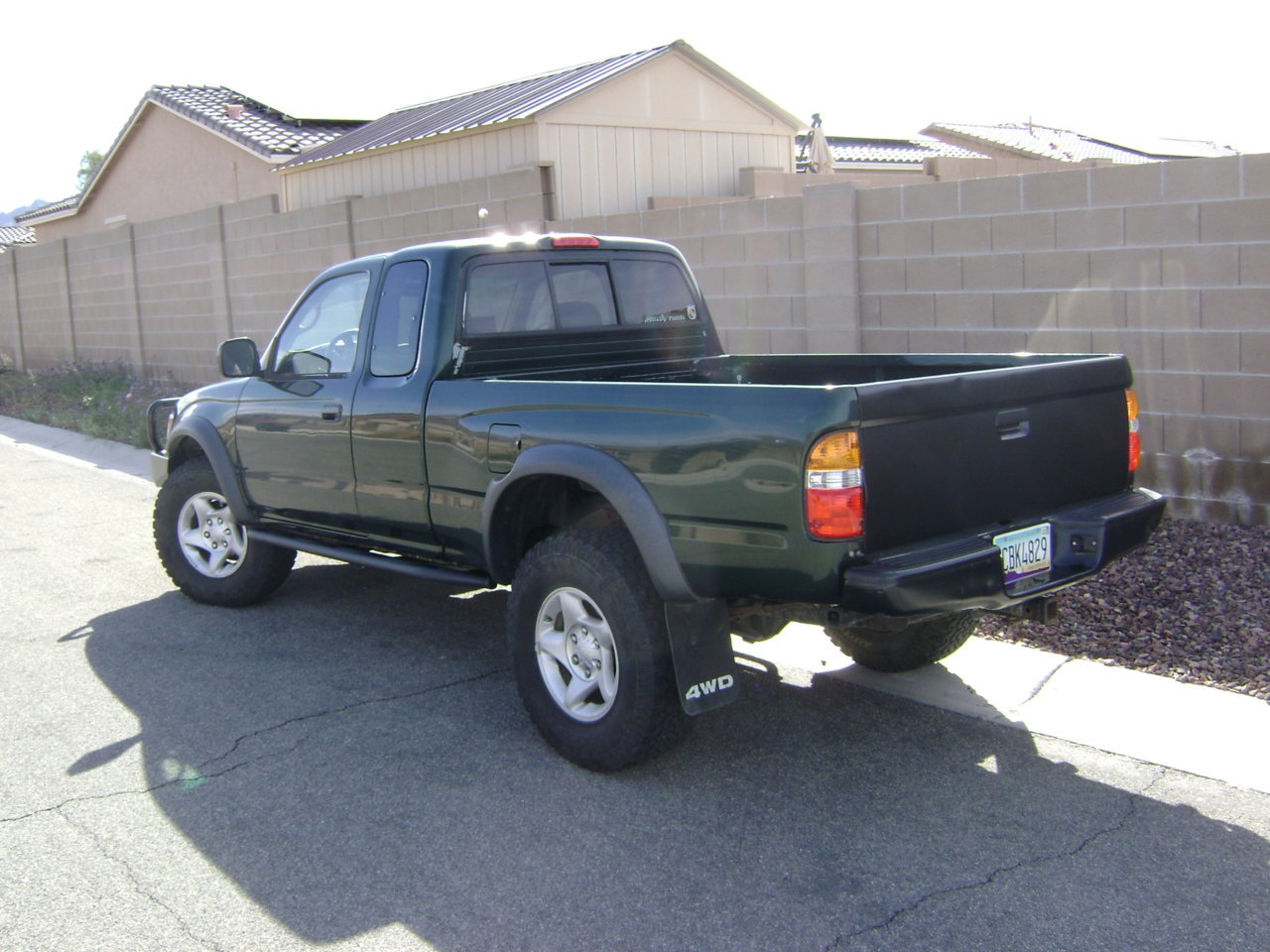

    IMG_5091.jpg T55 1.jpg IMG_5083.jpg I have purchased a 2002 Tacoma to build my dream extended stay desert camper. I am still researching all the great info here at TW but have a good idea on how I want to set it up. It is going to take a while to build it out as I am working overseas ($$$) and come home 3X a year for a month.

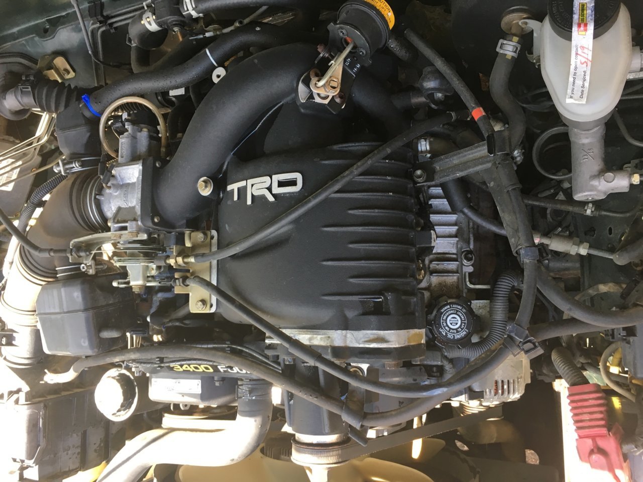

    So I purchased a 2002 Tacoma from a California original owner. Truck had 124K on it. 3.4 auto trans, a TRD supercharger and a few owner mods. Add a leafs, air bags (rear) front shocks, BFG tires, Torque Lift camper tie downs and a shell. He also wrapped the whole truck in 3M woodland camo. The reason was he scratched (pin stripped) the hell out of it traveling through manzanita bushes in California. Paint color is Forrest green under the wrap.
    I have been researching all the different canopy, caps, wedges etc. to start the build. I considered building my own of wood and fiberglass but decided I would spend too much time (lack of proper tools etc.).
    I don't like tents and fabric. I feel they can't handle extreme weather events very well (desert winds can be brutal). Don't care for packing a wet tent.
    I don't care much for camper shells as it seems all the dust gets sucked inside of them and the sliding windows can't be open in a driving rain and they don't offer much security against theft.
    So I have just ordered the 1st component. A Tufport T55. I have been given an estimated delivery date of 1st week of June. I know it's going to have some sail area. But at 375lbs and a low CG (compared to RTT) much more room than a high top shell. Plenty of room to move around in and a fair amount of space to customize.

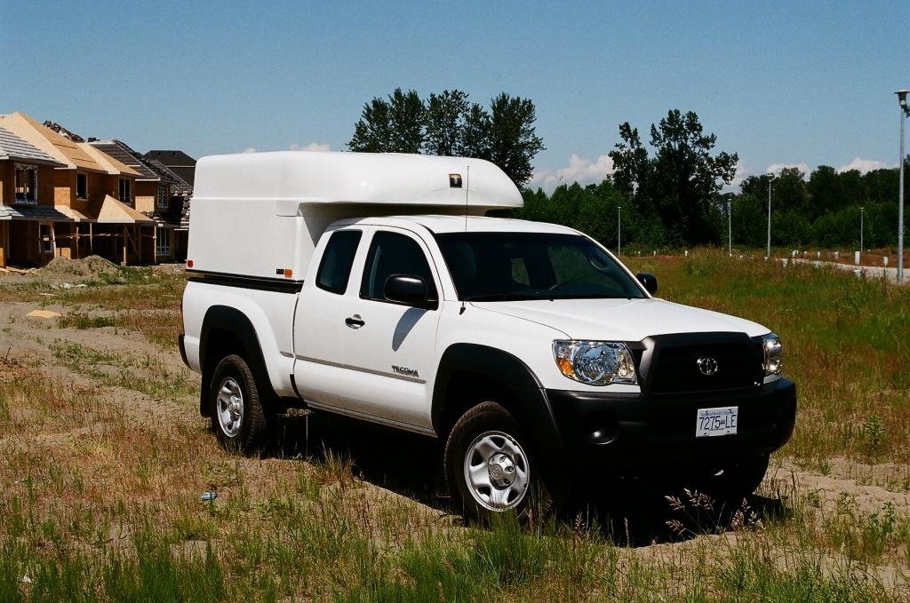

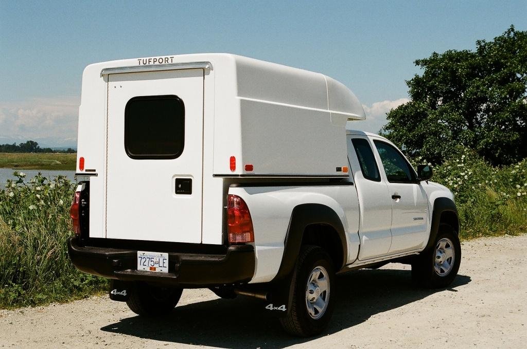

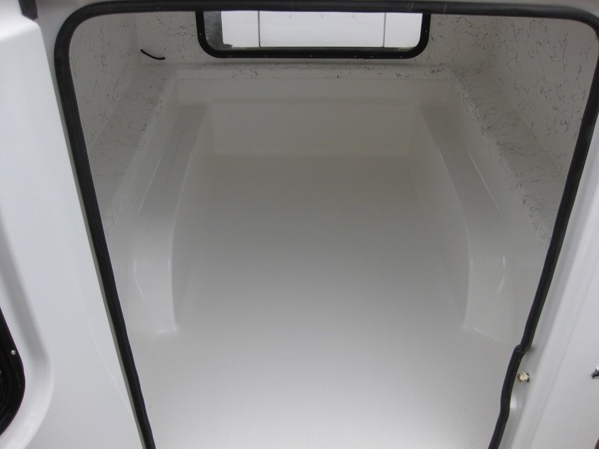

    A couple more shots of how the camper looks on a Tacoma and an interior shot.T55 2.jpg T55 inside.jpg

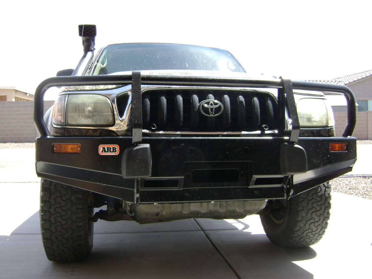

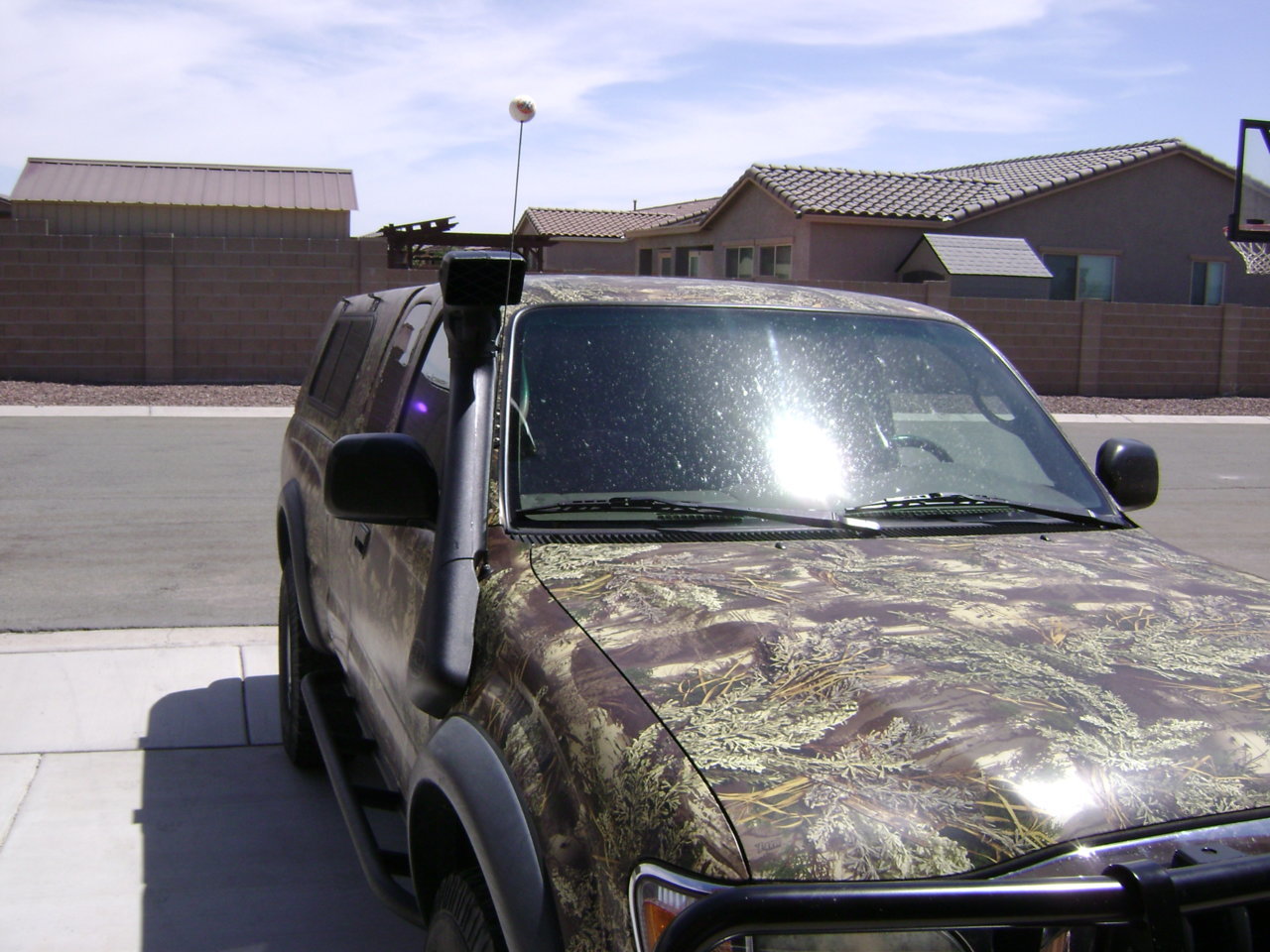

    Okay time for an update! Picked up my sliders, ARB snorkle and ARB bull bar. Headed out to San Diego and had Speed Freek do some install work for me. I had the sliders lineX'ed. Here is the results. Should have another update soon.DSC00846.jpg DSC00847.jpg DSC00849.jpg

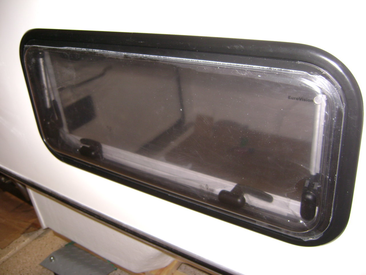

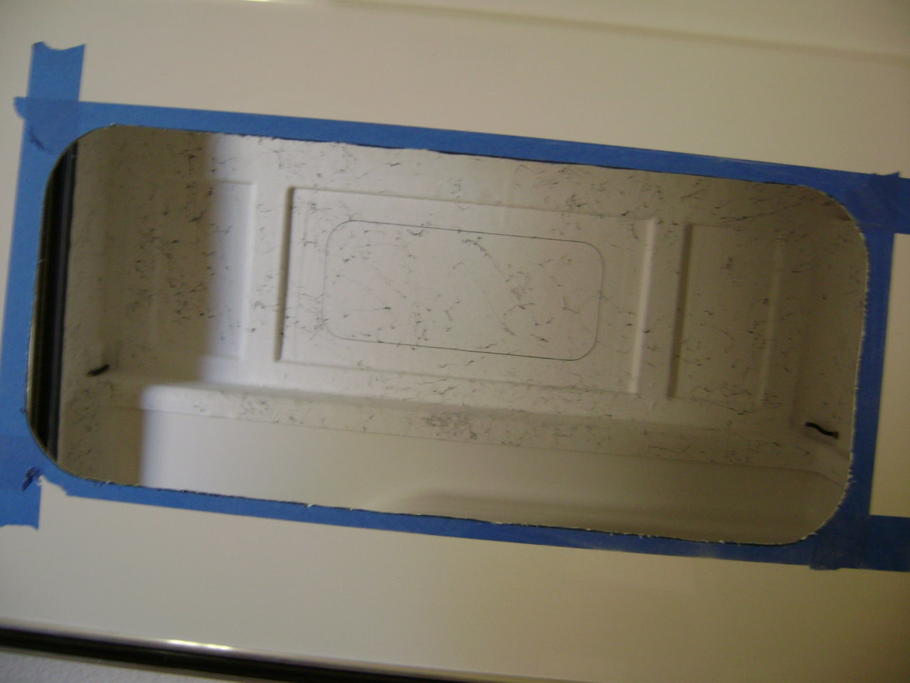

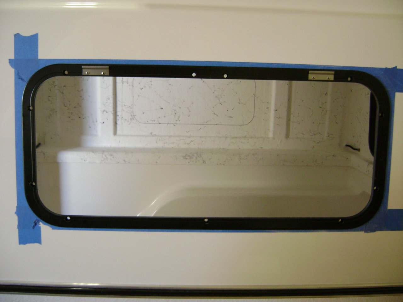

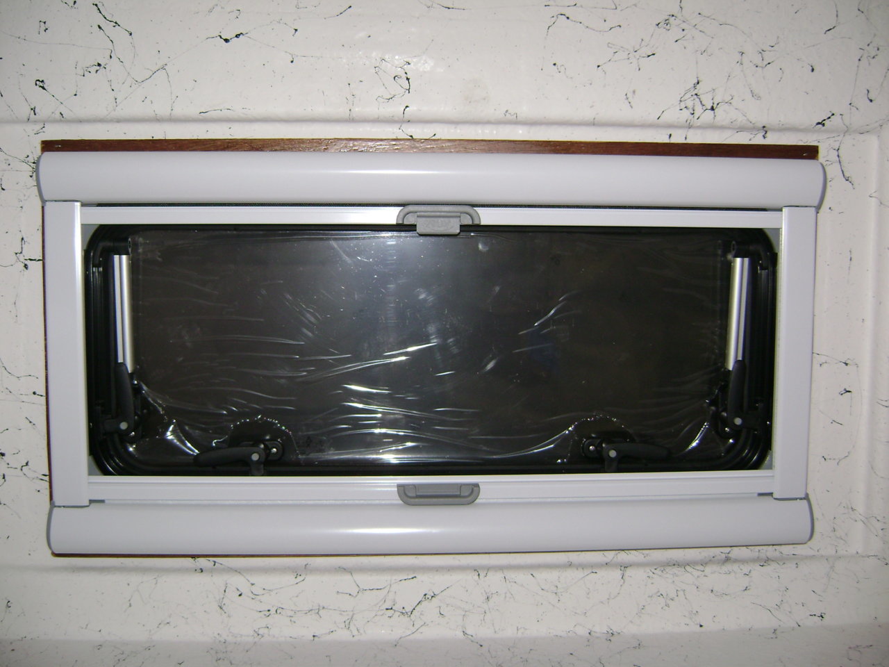

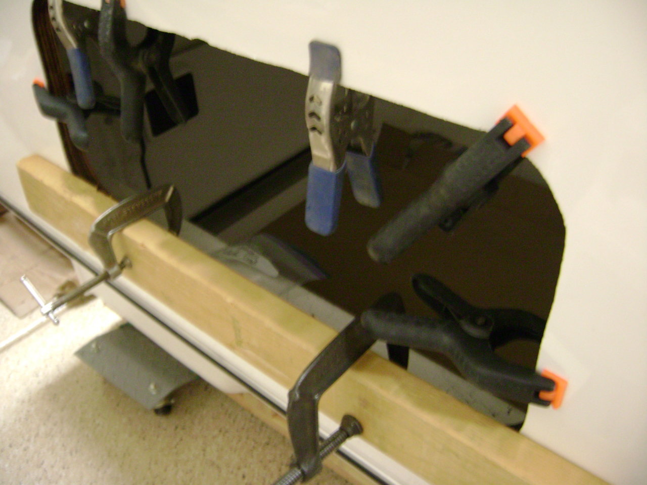

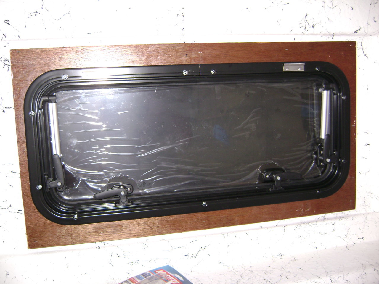

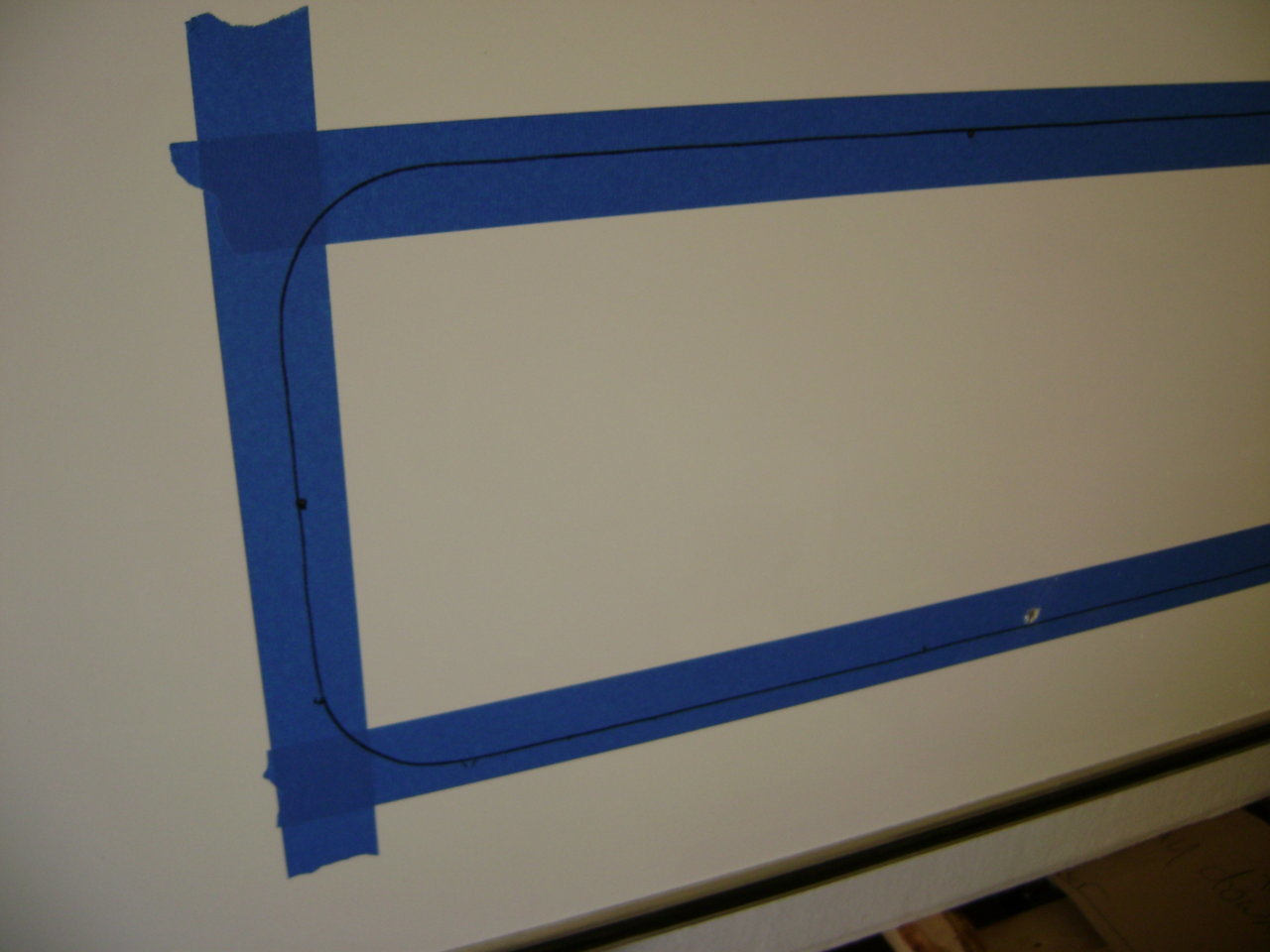

    Okay time to get this rolling again... Time to install the windows. I measured everything 100 times, cut a template out of Masonite and traced things out. I needed to fabricate some frames for the windows as the thickness of camper wall needs to be 1+ inches for the frames to screw tightly together. Also the blind/screen mechanism has to screw into something to anchor it. Couldn't find 1 inch plywood locally so glued 2, 1/2 inch pieces together. Then after getting perfect fitting/sanding I applied resign to seal the wood and allow me to epoxy the frames to camper walls.
    Materials used:
    Masonite, plywood, painters tape, epoxy resin, wood glue, west systems 610 epoxy adhesive, loctite.
    Tools used:
    Jig saw, fiberglass blade, wood blade, clamps, level, paint brush, screw driver.
    DSC00886.jpg DSC00888.jpg DSC00890.jpg DSC00891.jpg DSC00894.jpg DSC00893.jpg DSC00895.jpg

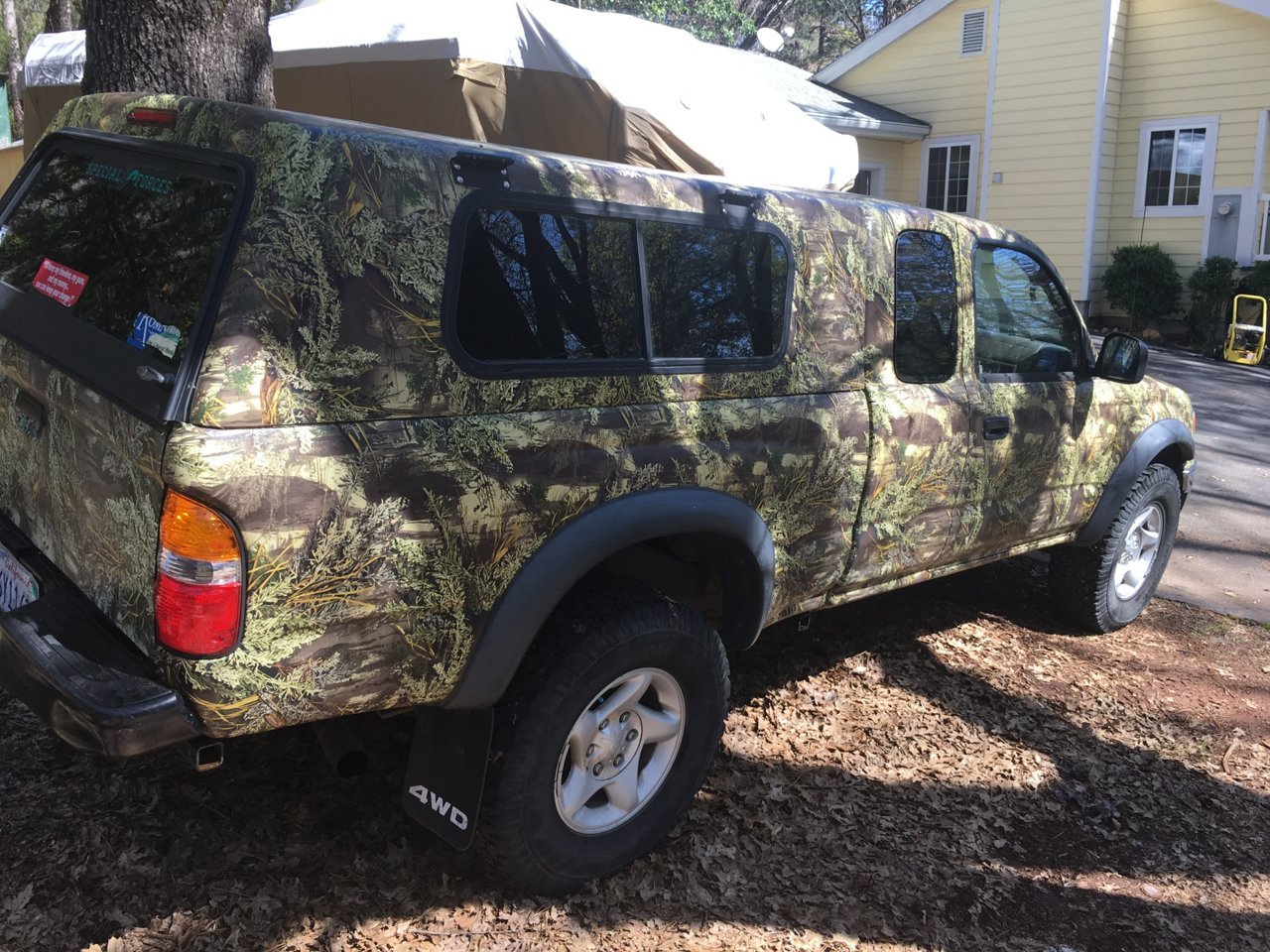

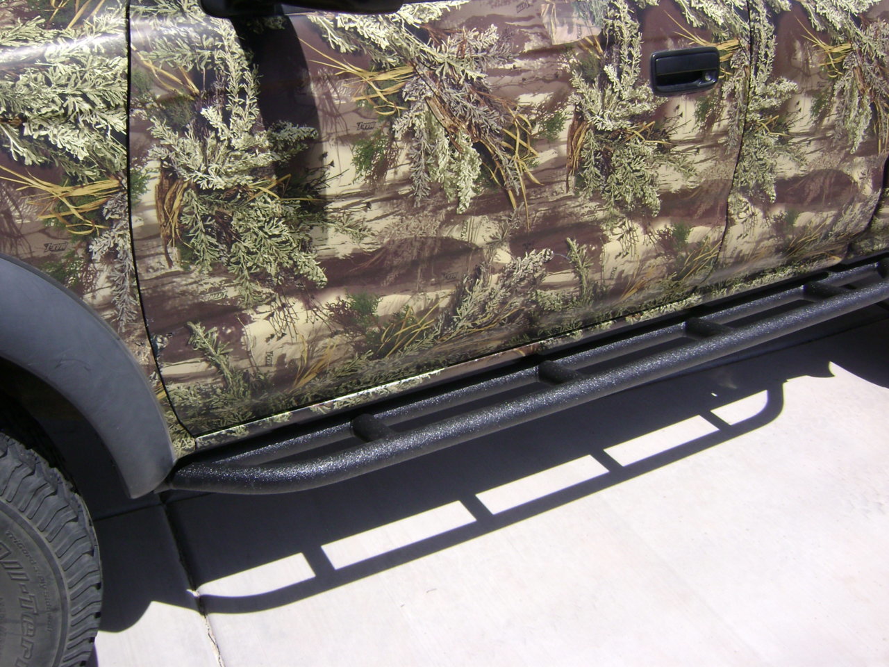

    Got a little project completed. Removed the camouflage wrap. It was a slow process but came off fairly easy. I believe it was on the truck for 7 years or so. It was 3M product so good quality.

  18. Mar 2, 2019 at 4:34 PM
    #18
    DW85

    Looks so much better!

    Thanks. Paint is in pretty nice shape. Of course now I can see a few scratches and dings. No big deal. Now to get busy on the camper set up.
