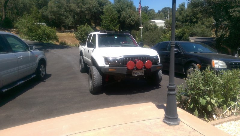

    This is my truck, I bought her a couple years ago bone stock, besides the headache rack and front bumper that is on it now. Picked her up for 5900 with 242,000 miles. I probably should've started this build thread earlier, but didn't have the time. I tried to get pictures at all the times I could throughout the build, so I should be able to answer most questions and have pictures with it. So lets go through the mods.
    Interior:
    -Gutted, for now
    Exterior:
    -Stock white paint
    -1-Piece smoked headlights with DRL's
    -Altezza Tail Lights
    -55w HID's
    -Some bumper and headache rack that came with the truck
    - 8% tint(20% over the factory tint) on the rear side windows and slider
    -42" CREE Light bar with custom brackets I made
    -3, 55w 7" HID Pods
    -Custom rear bumper/tire carrier
    -McNeil 6.5" fiberglass fenders
    -GG Red Labels 31x10.50
    -Manx Street Lock 15x8 Aluminum wheels
    -And a one of a kind cracked windshield
    Suspension:
    -Rear is stock besides some blown out Ranchos the guy before me had
    -ESB 5.5" over kit
    -10" inch Kings that I painted red and black when I rebuilt and revalved them(Has 10/15 valving now opposed to the stiff af 20/15 it had)
    -Custom shock mounts
    Engine Mods:
    -Stock 3.4L
    -HO 150 amp GM alternator
    Mods to Come:
    -Custom front bumper
    -Rear bumper tire strap mounts
    -New front shock mounts that will be tied together and tie to the bumper
    -Fox Bumps that just need to be mounted
    -McKenzie limit straps that just need to mounted
    -Poly bushings for the steering rack
    -TH400 gate shifter
    -Possible V8 swap in the far future or turbsky??
    -Bedcage(already in the scale 3D model stage) and Trailing arms SUA
    -Interior cage
    -Custom offroad dash
    - Sheet metal door panels
    -Sound deaden EVERYTHING
    -New Wheels and Tires(GG 31x10.50 red labels that I already have and new wheels in the mail)
    -New windshield
    -Rear bedsides
    -Making the interior led map and dome lights work properly
    -4" Cree cubes as reverse lights that need to be wired and mounted
    -Brake and possible turn signals mounted on the license plate mount on the rear bumper
    -Paint front and rear bumpers
    -Figure out fuel door situation
    -Reinforce bedsides
    -Mount camper shell
    -Custom fit radiator and TRD transcooler
    -Paint and reassemble AP leafsprings
    -Repair Tundra axle
    -Hood struts
    -Trans temp gauge
    -Carrier bearing
    -Trans mount
    -Fab interior console
    -Redo sound system
    -Aluminum door cards
    -Reassemble interior
    -Move blinkers to corner lights and attempt dual function
    -Wire bumper brake light and license plate light
    -Wire pods and light bars
    -Wire Taurus rad fan
    -Paint shock mounts
    -Custom alignment

    Deck plate mod Bilsteins All pro leaf springs All pro greasable shackles Camburg UCA Interior Led conversion Tundra TRD springs Extended SS brake lines Seat covers 33" yokos White herculined exterior
    Looking good. I love some long travel!!!!! Gotta get more pics on here. Lets see that bumper and headache rack.

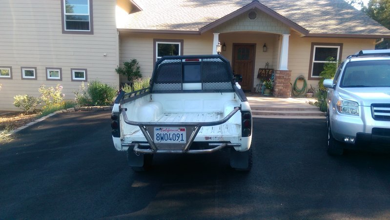

    I'll be painting the bumper black, when I'm finished with all the welding. The stainless plate will stay the same color, just buffed.

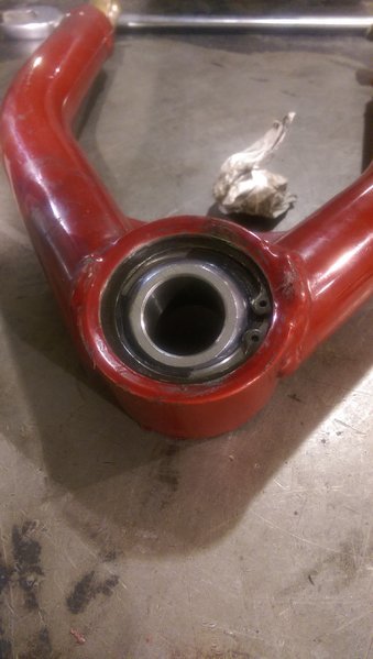

    Replaced the uniballs in the upper control, unfortunately that didn't fix my sticking problem.

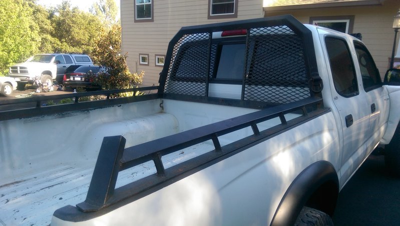

    The headache racks cool, but the rails attached to it is effn awesome. I'm going to have to steal that from you one of these days.

    Maybe if your interested I can fab one up one day.

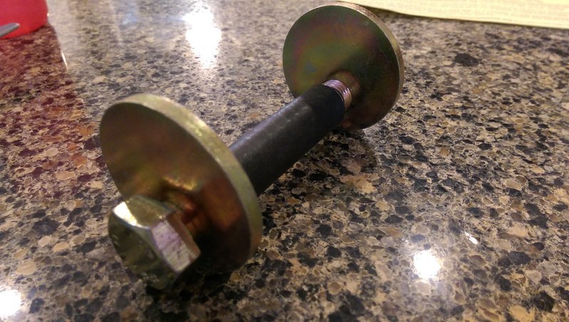

    Got some Grade 8 cams, really been needing these. The washers are crazy, they are like 1/4" thick.
    Unfortunately they don't have hash marks, but it'll be a hell of a lot better than just bolts and washers.

    Those bad boys are suppose to be about that thick. I was scared to buy aftermarket ones myself. I got some stock ones off a 4Runner that was being parted out. Seeing how they adjust these, they don't use the hash marks, but rather just look at the alignments computer screen. So I'd say you should be alright.

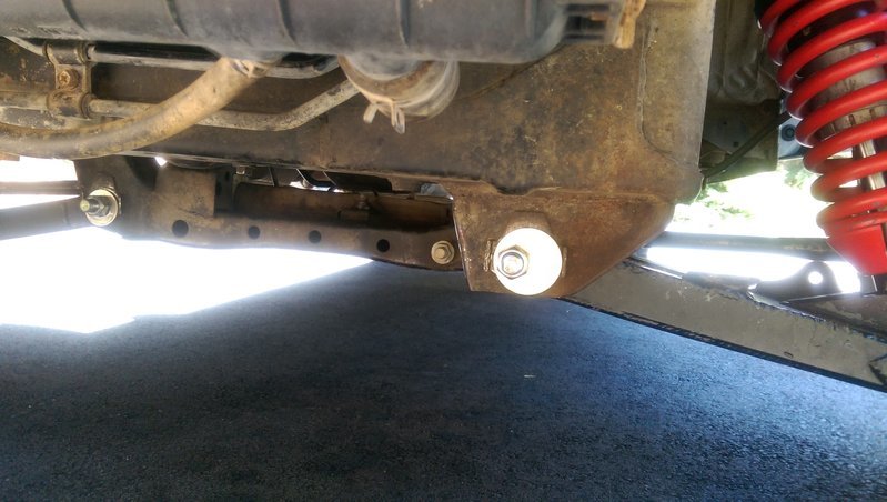

    I'm also thinking this could be one of the reasons my front is still sticking, because the washers don't fit I crank down the bolts really tight so they don't move. I think that this might be causing the bushings to mushroom inside the sleeves making it to not want to move.

    I'm pretty chummy with my local shop too. Might definitely be one of the problems. I know you got the Long travel arms but for stock you only torque those bad boys down to 96 ft lbs. Also when you tighten them, do you do it while its jacked up or on the ground? They recommend to leave them loose and then put the truck down to tighten to specs. That goes for both the UCA and LCA. Just throwing that out there in case. You seem like you know what your doing but sometimes its those little things ya know. Do you have zerks for any of the bushings?

    I actually don't torque them while the truck in on the ground, and I was torquing the grade 10's to 200 ft lbs cause that's the spec for those size grade 10's. And yes I have zerks and just shot them with grease on Tuesday.

    That might be part of the issue. When you tighten them down at full droop the bushings are then fixed in that position, and in turn are under stress when just going to where the truck sits normal and even more if your stuffing the tire. If you tighten them while sitting on the ground then there under less stress when going up and down. This is sort of how it was explained to me. I'm sure the guy who told me sounded a lot smarter than the shit I just spewed out, but if you do get what I'm trying to say then maybe that will help...maybe?

    No it makes perfect sense, the bushings articulate and while articulating become stressed and then when returned to there original position leaves it with room to move before it starts to stress again, I have it In a position where it under stress constantly and then going even further towards full bump causes even more stress and in turn causes massive stiction because the springs are more relaxed, opposed to being full bump with that amount of stiction where the springs have enough force to put it back to ride height where the bushing are not under stress... Something like that, it sounds good in my head.

    Got the front cams on, couldn't get the rear ones cause I have to remove the steering rack, will do that when the new rack bushings come in.

    You don't have to take the whole steering rack off. If you remove the two main bolts on the passenger side and the main one on the drivers side it should give you enough wiggle room if you turn the steering wheel all the way over and push it up and slide that cam bolt in and out. Its good to have one guy pushing up on the steering rack and another to work the bolt. I have a bit of a write up with some pics on my 1996 build page if that helps.
