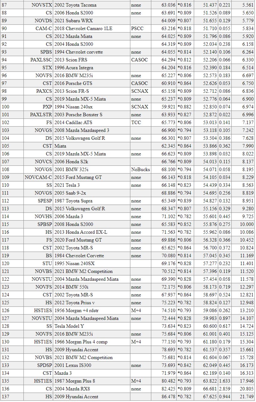

    Had another super fun weekend out there melting the tires off the old Tacoma on the autocross, and took 2nd place out of 16 drivers in the Novice class!
    And the obligatory list of 50 sports cars that were shredded by the pick up truck in the process:

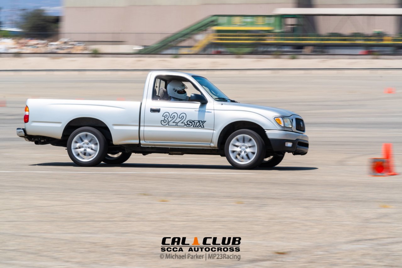

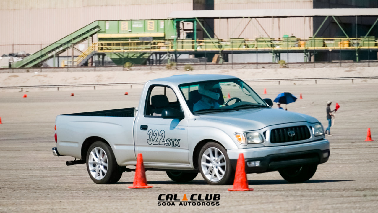

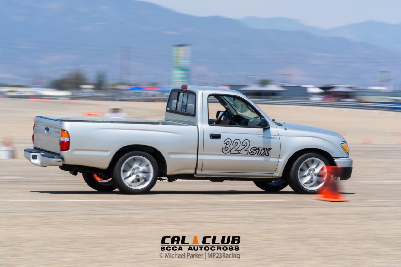

    Some more action shots of Trudy out on the course..

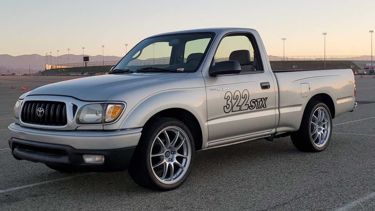

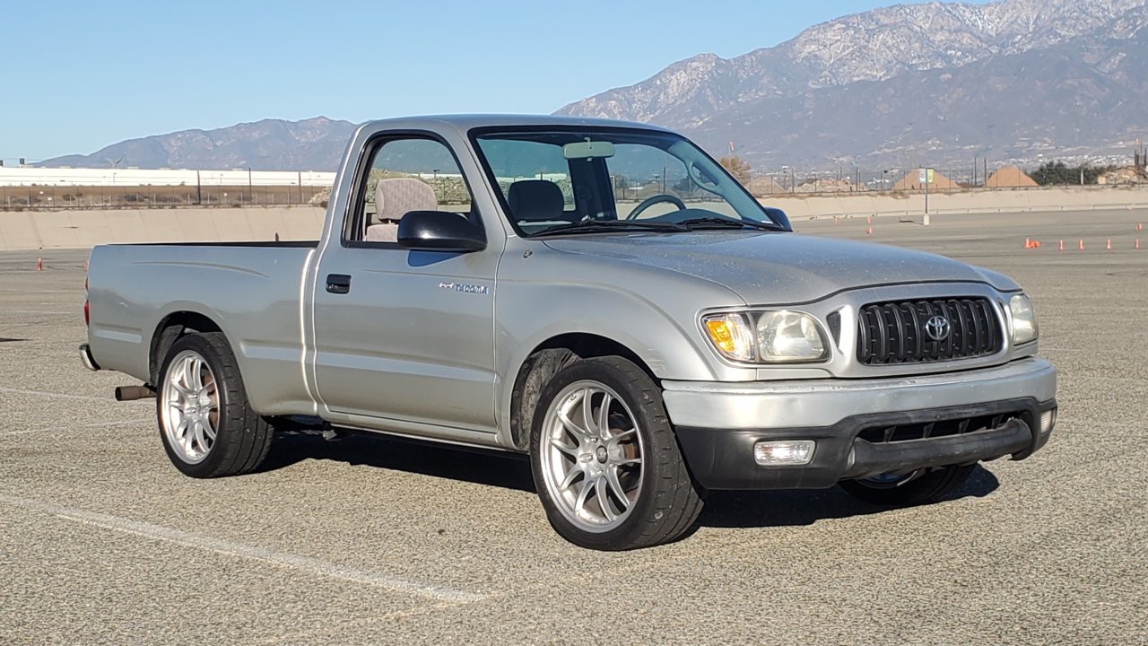

    Coincidentally enough I was actually out on the autocross this weekend with old Trudy.. trying out some new wheels and tires to run max size for my STX class (265/35/18 Nankang CR1's on some new PF01's).
    Here is Trudy on Saturday, no numbers and all dirty - ready for test runs.

    Shined her up for the competition and pro photo shoot on Sunday:
    Discussion Points for the "Taco-Cross Experts":
    I have quite a bit of roll as I left my springs at a street friendly 368 lb/ft. Who knows, I may redo my drop and go lower and stiffer for the next season. I think I will upgrade my anti roll bars to the Addco's first to see how this helps too.
    I am a bit uncertain on the rear anti roll bar still as I do like the rear rotating a bit for me. Can anyone chime in on the before and after on their rear roll bar specifically without any other mods at the same time perhaps?
    Definitely I have came across the loss of power steering pressure at times on the course as others have mentioned. I noticed this in my truck when I have some sections that require multiple quick directional changes it just looses all its assistance for a moment and the wheel gets very heavy to turn. May have to update that fluid and give it a go it seems, but luckily this has only happened a couple times I can recall.
    It was surely a whole new truck with them wheels and tires, it actually even rode nicer on the street too which I did not expect but of course welcomed! I did ok out there but I could tell I need more seat time to extract the newfound performance out of the truck!
    I am really wearing out my front outside edges on my tires quickly with my setup, any tips out there to get the alignment into more aggressive specs and more even wear across the contact patch you have found?
    One more question, do you guys run blocks for your drop in the rear and has this caused any issues when pushing the truck so hard? I am uncertain if Deaver can re-arch my leafs again to give more drop or if I would need to add a 1" or so block if I go lower.

    Well, to address your block concern first- I've been running the 3 in block all season and you've seen the pictures of how hard I pushed it. No issues with them so far.
    I aways have my power steering fail me in particularly tight slaloms with the rapid back and forth. I'm actually looking into a shorter ratio rack from a frs or something similar to see if that may help. (Also not have to go hand over hand around turns)
    As for your alignment, the quickest solution would probably be to have your camber bolts adjusted to give a degree or two of negative camber. I'm running -3 currently, but I'm also using my Taco for the track more than anything else.
    I'm wicked jealous that you get to have autocross events this late in the year! My season has been done for two months. No fixes for my truck yet since I'm still recovering from buying a house and a tundra in the span of two weeks...

    I've ran blocks as well, ever since I've owned the truck. No issues here either. I do run a helper spring from the local auto parts store in a reverse orientation to help prevent axle wrap.
    Do you not have a rear sway bar at all? I have the hellwig rear bar, and in my videos you can see the very minimal rear end roll that it allows. I love the way it handles.
    I second the few degrees of camber. I think I run somewhere around 2 degrees negative myself. You also wanna run some increased caster. One of the local alignment shops where I'm at is run by guys that used to race circle tracks, so they actually dialed in what I needed and requested, no machines to tell them what to do either.
