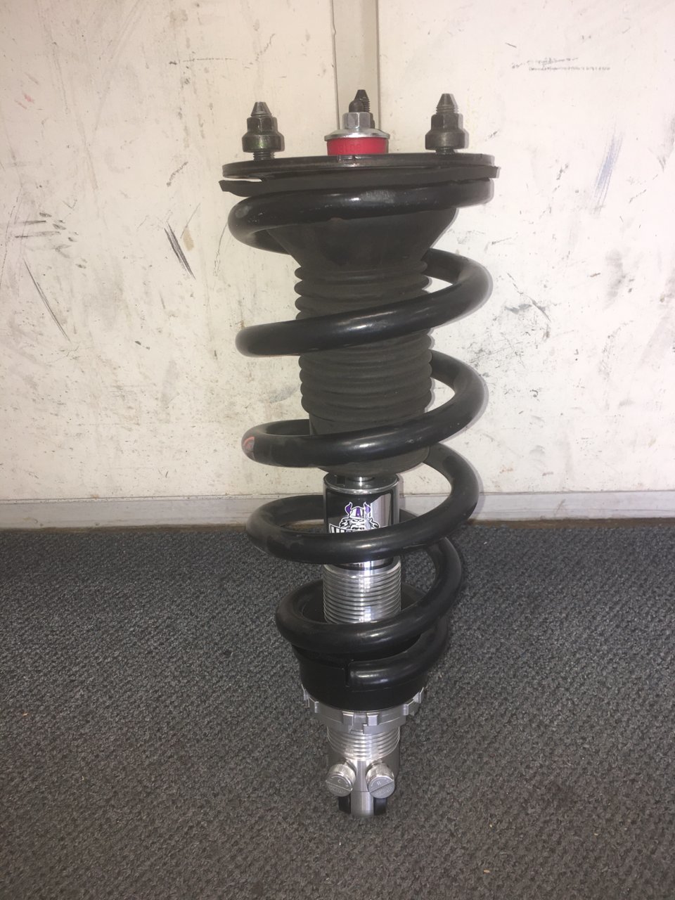

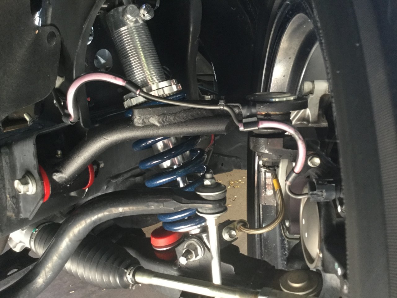

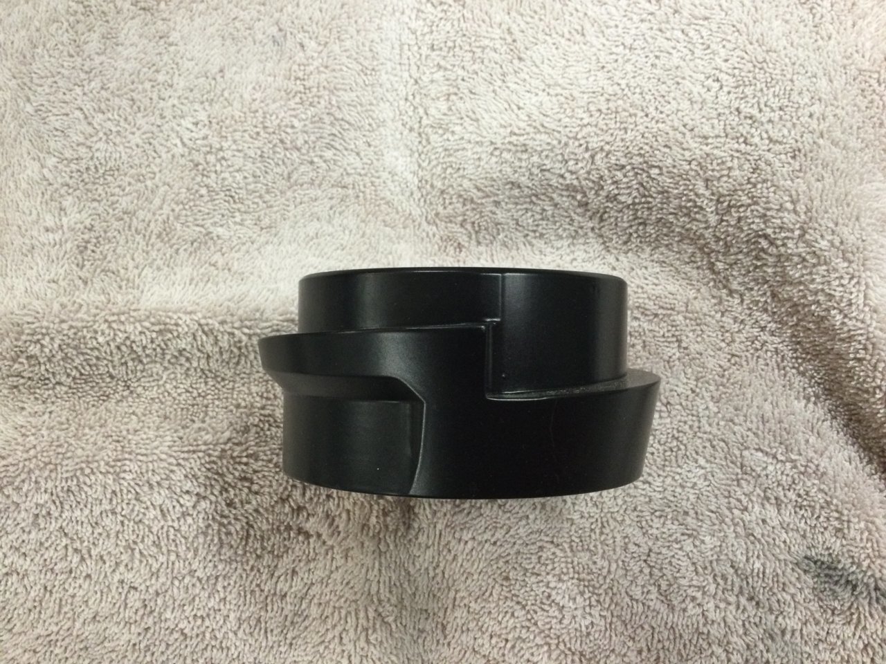

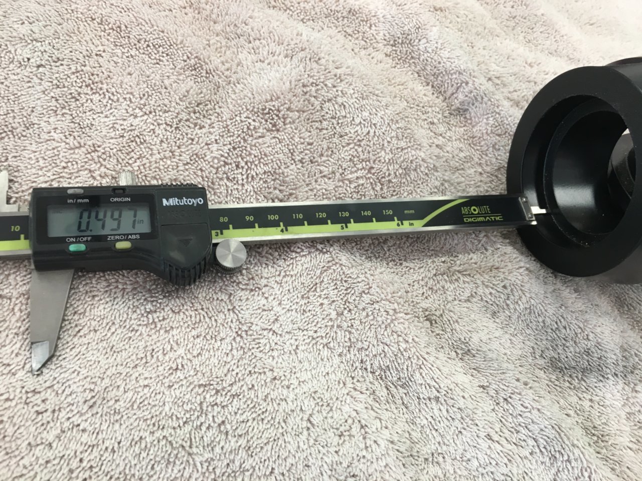

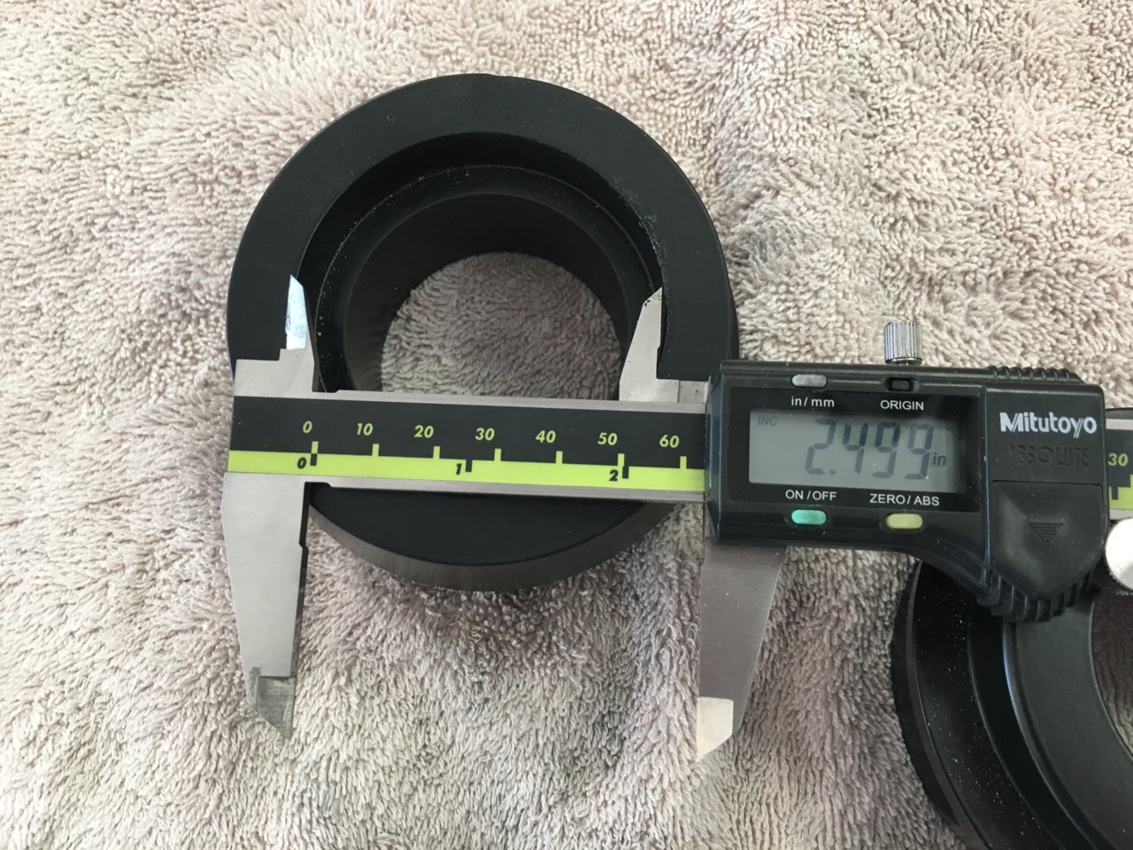

    @BananaMan WAY TOO MUCH FRONT SPRING RATE‼️ Soften the front spring rate! You can run OEM Access cab front springs or OEM X-runner springs with perch or better yet very bottom photo with coil-over top mount for option. Then add a X-runner rear sway-bar! I have all the part numbers but the mount welded to the diff. as there are many to choose from.
    @A.takemoto If you like the rears do the same in the front! See photo below spring not loaded / adjusted in this photo.
    This part has been machined to fit over top collar on coil-over shocks you BOTH can use. As a matter of fact I have this set (Edit; of spring perches for sale). They were for our 15 some guy talk me out of! Grrr…

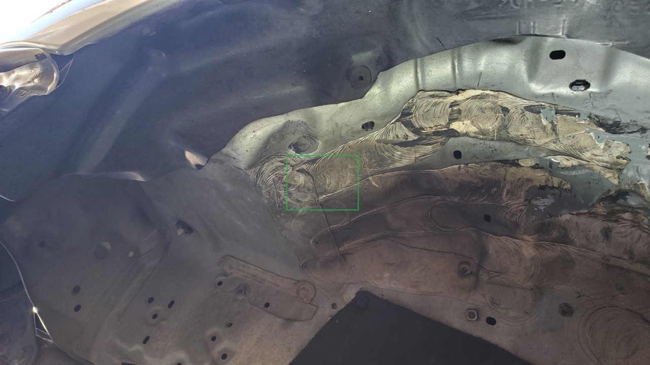

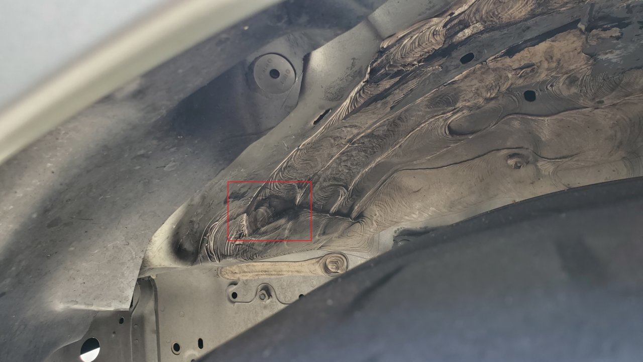

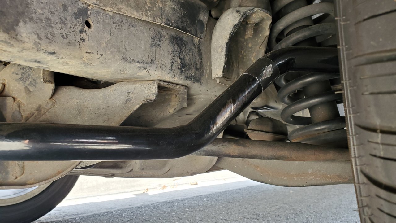

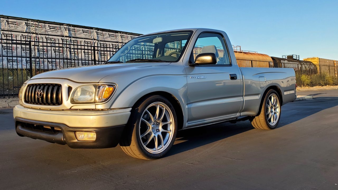

    The cycle of tire rubbing correction (Drive>rub>trim>bend>repeat!) has been ongoing for what seems like eternity, and I am longing to get back out on the course now to offset all this work with some fun! The truck is not quite there though in my thinking unfortunately so the work must go on...
    I have found many sources of rubbing along the way, and that that rubbing areas change as one area is fixed another becomes an issue. Case in point - the less the tires were rubbing my plastic liners and inner fenders, the more I found that darn Addco sway bar to become the main issue for me. This is only on the hardest off camber turns I can safely muster on the street coupled with a huge pothole to really put it to the extreme test scenario, but since I drive it to the extremes I dont want anything to rub ever.
    The sway bar was not only rubbing my tire, but I was hitting it so hard it actually even was banging loudly and starting to scratch the inside of my wheel and taking the powder coating off the sway bar too - only on the driver side though (perhaps since I cant replicate the same turn making a left hander?).
    Looking closer at the addco vs the srunner sway bar I can see there is well over an inch of clearance that you lose with this "upgrade". I liked the flatter ride the addco provided, but I just could not live with my wheels banging into it any longer so I popped my SRunner front bar back on. The issue with rubbing at full steering lock (u-turns) is gone now too I am happy to report (and feel), even with my extra drop and fat tires. Note for anyone thinking of that addco sway bar, you will lose clearance and I even found my 245's rub too just as fyi.
    Look below and you can see where it rubbed first without the drop spindles towards the front of the bar, then it rubbed higher on the bar too after the spindles. The black tape portion got rubbed as that was trying with and without 3mm wheel spacers. It rubbed wither way but the spacers are off at the moment, as I found I like the feel of the truck handling the high speed curves a bit better in some regard and this may reduce my over steer if/when I do lose traction. (photo on Moms Tacoma since I had hoped for better results with the 245 tires on her truck).
    I went for one more test drive and although I am still getting a rub, I am not seeing any marks on the sway bar so far to my delight!
    However I can still get the darn driver side to rub on that curve of doom, and it looks now to be on the front portion of the inner fender where the battery is resting up top. I am a bit hesitant to bend and bang this out of the way since the battery needs a stable mount of course and I dont want to ruin its mounting base in the process. I use photos before and after to try to determine new rub marks, you can see what I mean..
    Before sway bar removal test run:
    After:
    This is getting me thinking: I have been working on rubbing issues all this time and would say 98% of the issues have been on the driver side. Again this could be a bit based on the extreme right hand curves in my test area, but I am also starting to think just the extra weight of the battery itself is part or why the majority of rubbing is on the driver side.
    All said I am contemplating potential solutions as being either a battery relocation or maybe even just trying out a super light weight lipo battery in the stock location for ease of install. Curious if anyone has tried a lipo and know of one that works good in our trucks? Any you guys on the track relocate the battery to the rear and could speak to the weight distribution and handling feel?

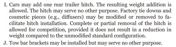

    I did check the SCCA rules and battery relocation is allowed, just have to follow some safety guidelines for remounting securely. I think it would be cool to try out a super light battery in the stock location and see how that helps first. Then if it still rubs maybe I will relocate the light weight more compact battery to the rear along the frame under the bed some where.

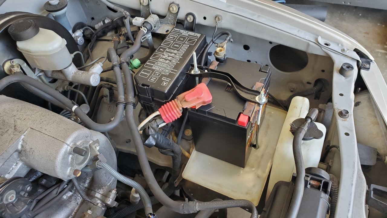

    The lithium battery came in yesterday.. I was outside removing the battery getting ready when UPS showed up. I was delighted when he handed me the box and it felt like there was a pillow in there instead of a car battery!!
    I started working on the mounting, and realized I could modify the factory bracket to make it work. I am still waiting for the post terminals to come in to finish the job, so I started looking at some older autocross footage to inspire me further.. Check out this video to get a bit of Tacoma action while we wait for the next round!

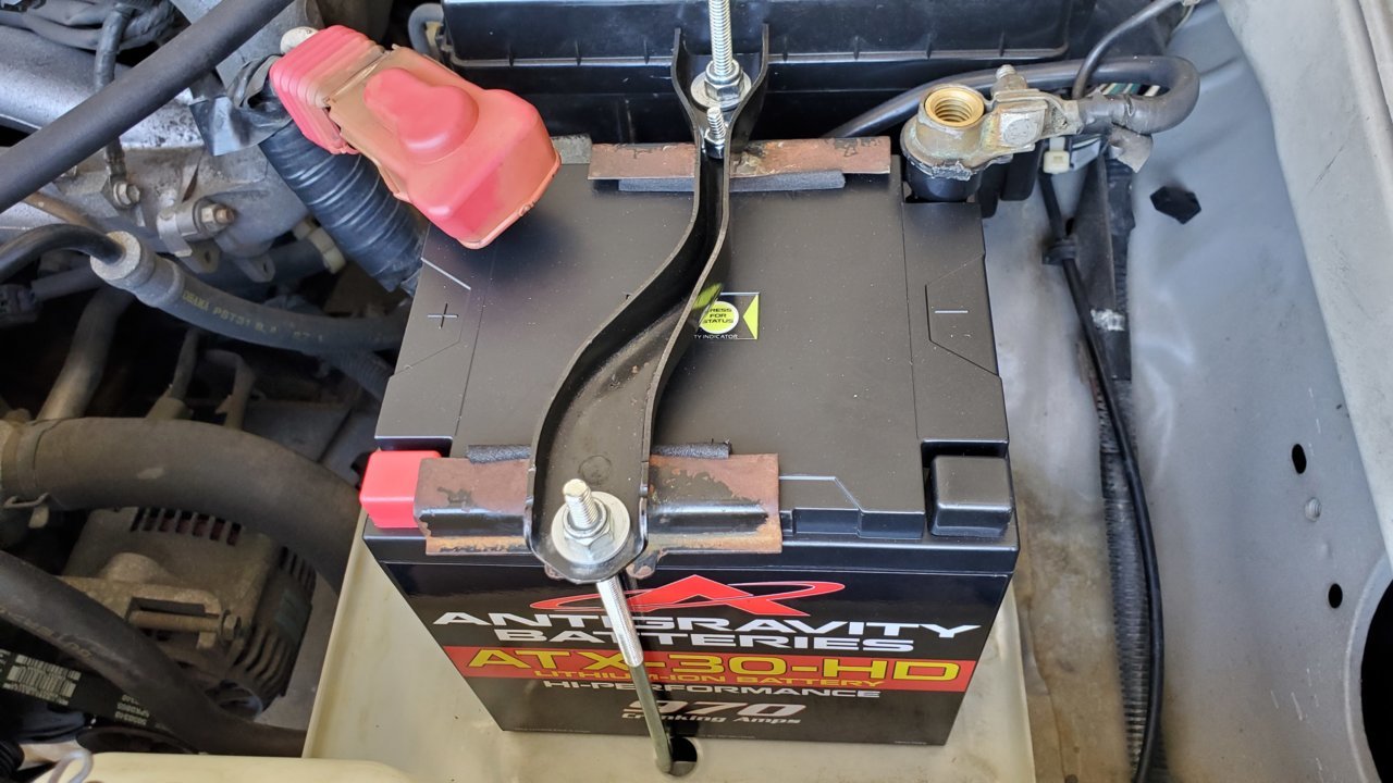

    Indeed I have continued working little by little in hopes I will have the truck track ready for the event next weekend..
    I got that ultra light weight lipo battery installed - Just cut down the factory mount, drilled a hole and moved one of the clamps to align with the smaller case, and adding some j-hooks I picked up at the zone for $5. I bent one into an L shape and found it worked perfectly in an existing hole that I used for the forward mount.
    This came out super sturdy and is the most secure mount I have had since I put the sloppy fitting Optima in a while back, combined with the light weight battery this should not move around on me at all even on the race track.
    I could tell there was a voltage increase as well, it cranks fast and quick, the lights glow brighter, and I almost feel the truck just runs better even now but this maybe my imagination.. Either way, I am already stunned by the Antigravity battery weight and performance and these will be the only batteries I buy going forward!
    Guess it seems kind of piddly dropping 30 pounds until I think about it. The truck curb weight is about 2700 pounds so 30 pounds is actually over 1% of the trucks weight. So this also just helped my weight distribution front to rear and side to side by 1% too! I am certain the center of gravity is lower as well with the battery even being mounted lower (no plastic stand like the Optima was running) and again less weight up high in the engine bay.
    I did go for the test drive crossing my fingers to see if this helped eliminate the front driver side wheel well rubbing, and I was stunned to find it actually did not rub at all on a couple of test curves that previously caused the harsh rubbing right under the battery tray! I dont want to go celebrating and saying its all done though yet, as I did have a passenger in the truck this time oddly enough and I feel maybe the extra weight on the right kept the truck more stable overall in the hard right hand curves.
    I had a buddy visiting from Oklahoma and he was not afraid to join in on my spirited test run to see how the truck rides and check if it still rubs of course. He was very brave riding with me, and said he saw the videos and knew the truck handled good, but was blown away riding in it and said he had no idea that truck could reach the speeds it was hitting in the curves without even a chirp from the tires. He soon spoke of getting a pickup, adding grippy wheels and tires, and lowering it so he could join in the unexpected badass fun!
    You probably would guess at this point, the passenger side of course started rubbing a plenty with my buddy in the cab with me. So I spent most of yesterday rolling my rear fender lip up and inwards, and more trimming on the passenger front fender liner, and a bunch more "massaging" I now refer to as "heating and beating" of the wheel well to give as much clearance as I could while I was there. Hoping I can resolve any issues with tire rubbing in a timely manner now, without having to re-work it time and time again. As said I am itching to get out on the auto-x again, but dont want any potential of tire rubbing issues plaguing my track days.
    Next up I will be taking another look at the driver front rub zones, trim some plastic, and may as well try to remove any lingering lumpy bumpy potential rubbing spots I may see to give as much clearance as possible and figure out if I will be able to get her track ready with the battery in its original location. As mentioned earlier if it still rubs under the battery tray when there is no one weighing the other side down, I am going to need to look into relocating the battery to allow me to give the clearance as needed up front.
    If I can go for another test and find no rubs in the front driver area now, this will probably mean I will be hitting the track next weekend... shooting out a prayer to the Tacoma Gods now!

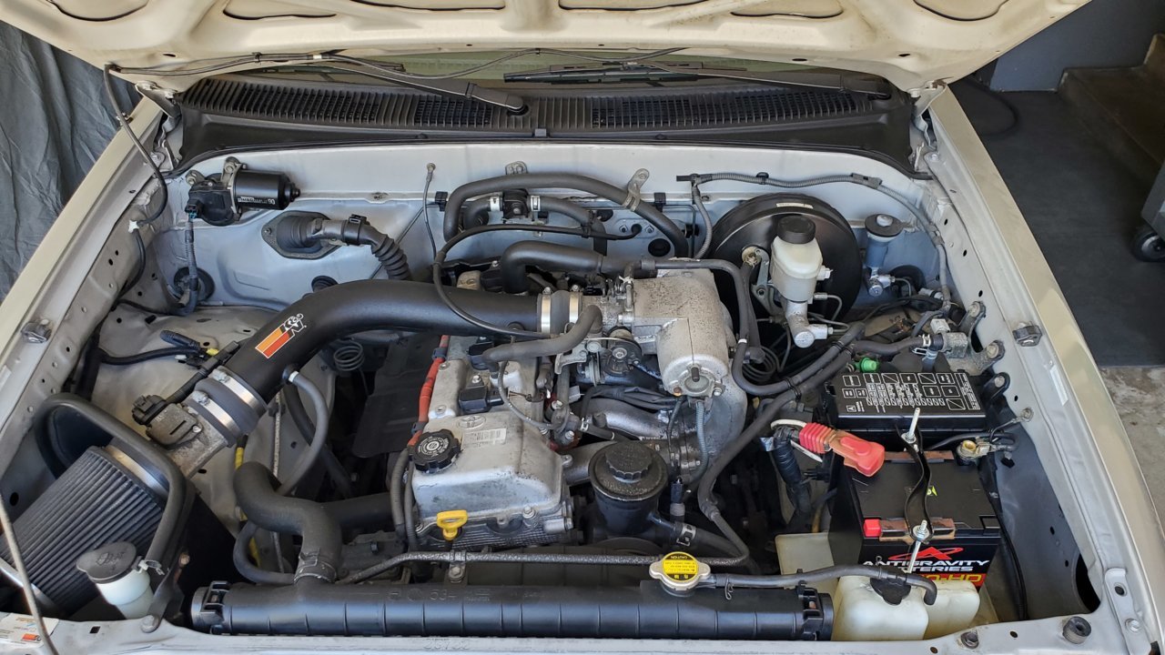

    My prayers indeed may have been answered, thanks be to the Tacoma Gods!
    Yesterday I trimmed up the drivers side fender well anywhere the tires had shown to rub in the past, which was mostly the upper center portion not surprisingly. Also pulled out my bottle jack and fender dolly to push out the fender wells a bit more overall as best I could and saw some visible gains. Then finished up with the body hammer to smooth out the arch and remove some lumps.
    She still looks like she rolled off the showroom floor from the engine bay:
    The late night solo test run was simply magical, and for the first time since the extra 2" drop spindles/blocks there was absolutely zero tire rubbing what so ever.. No rubs on inner fender wells, plastic fender liners, or even sway bars, no rubs at all in any of my brutal known test zones!
    I was certainly hopeful installing the lightest weight battery I could find would help the cause, but I am stunned that it seems to have resolved the issues altogether and I believe I am going to have to call Trudy "track ready" at this point in time. If this level of non-rubbing keeps up on the test and tune day at the track I may not have to do that battery relocation after all. (Note to self to bring the fender/body tools to track day next time around.)
    Definitely going to have to approve this race truck battery mod to all citizens (based from my limited experience so far):
    The truck does feel more poised and better balanced in the curves and under braking with less weight transferring around. I think the drop in weight can also be felt when accelerating too, the truck seems notably peppier and even slightly angrier now which was a nice bonus!
    Out of curiosity I measured my overall height of 58 1/4" at the brake light on the cab, and my rear wheel track at 56 3/8". Can you believe after all the lowering and mods the truck still does not even fall into the rollover guidelines put out by SCCA since the height exceeds the rear track!!
    Luckily it's very little weight up there for sure, we all know the first gen Tacoma is getting quite a bit more serious this season..

    Aren't we always looking to squeeze more out of our machines..?
    Next up.. the coveted oem XRunner-ish rear frame bracing (aka "Tow Hitch" PT22804030):
    This should stiffen up the frame and add a bit of weight low and to the rear of the truck.
    I was thinking to cutoff the actual receiver portion since that looks to add weight unnecessarily, but reading the rule book below (section 13.2) sounds like I am unable to do so:
    see: "complete or partial removal of the hitch is allowed for competition, provided it does not result in a reduction in weight compared to the unmodified standard configuration"..
    There goes my weight loss idea, I dont want to break the rules out there of course. Well, one less project I need to perform - looks like this will be a bolt on affair after all!
