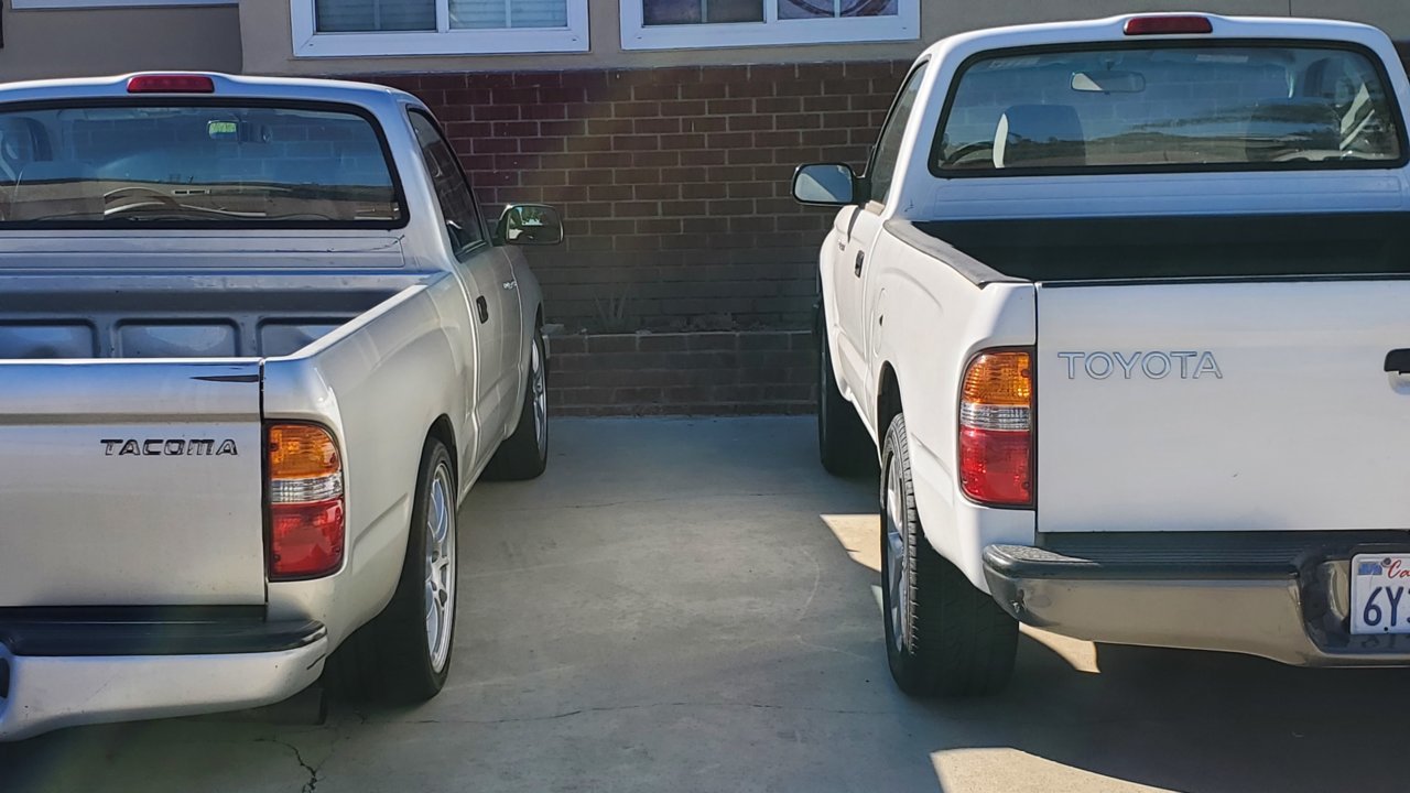

    Went out to the shop thinking I would drop the rear a bit more with the 2.5" blocks, but ended up going for the 3" blocks instead!
    The stance is almost level now with the rear fender wells measuring roughly 1/8" higher off the ground than the fronts. I have not had a chance to go for the canyon test runs yet, but I took her out for the initial run on the rough streets, big dips, and steep driveways to the local photo spot and there were no issues of rubbing or bottoming out to note as of yet.
    Even better to report, the truck feels like the handling has indeed gone up another measurable notch!! It seems way more planted and balanced with the extra weight bias in the rear now and slightly lower center of gravity. I was able to hit my handy 90 degree test curve with more confidence and speed than ever after a couple passes, and noted less weight transfer under braking and cornering. Even the front end and steering feels lighter and quicker with more pounds in the rear now, hopefully this will help to alleviate some power steering pressure losses in the hard tight s-turns I was detecting on the last course. Also feels like less weight in the front should help with less rollover/better traction up there too.
    As a nifty bonus the ride is just nicer cruising down the street - taking hits in the rear with some weight back there seems to benefit these trucks by smoothing out the hard hits when there is no weight in the bed. Also the seat position is a bit more laid back now with the rear lower which I like since I can't recline the seat too much in the regular cab. This truck just keeps getting nicer and nicer as the performance increases all the time, seems dreams really do come true!!
    As stated, it certainly feels like the truck went up yet another notch in the handling department and I am blown away with my first impressions. I am going to have to get some seat time to get used to it's new limits, and hopefully dont run into any issues in the ultimate local rough canyon spirited testing phase coming up next..

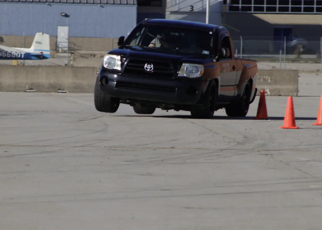

    This photo generated a bit of buzz in the club I run with. Officially time to take the suspension setup a bit more seriously and try to keep them closer to the ground. 5CD5B334-0E32-4747-B1A5-A93901BF6CA3.jpg

    Holy crap! There's no denying you're getting some good traction!

    No doubt about that! If I could actually make use of the inside tire in the turns I would probably do even better :rofl: going through slaloms the truck "walks" back and forth picking up each tire.

    Hard to tell, but almost looks like the rear tire is in the air too. Since the shadow isn't connected.

    That is in fact the case. I'm amazed somebody got it in photo, but we could feel it in the truck many times.

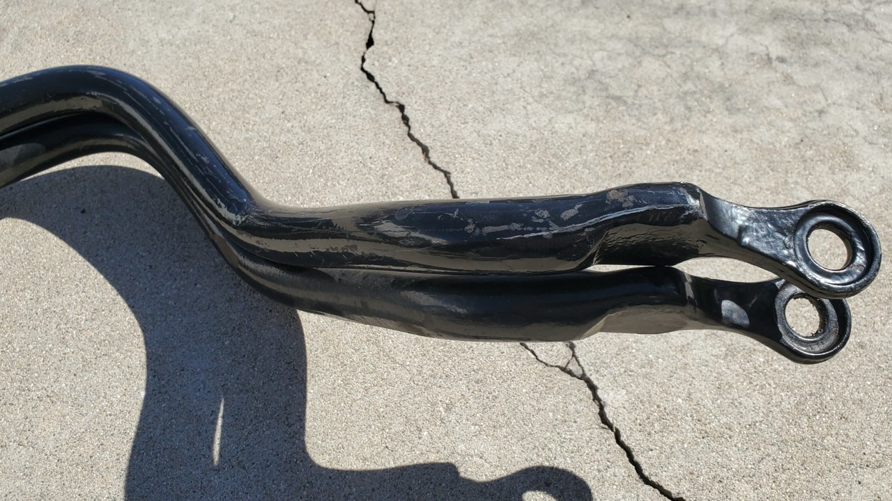

    I got a buzz looking at this photo too!! Good thing you got a passenger riding along to keep her from rolling over! :thumbsup:

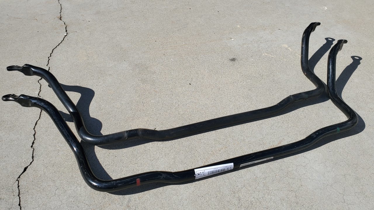

    I'm running the oem SRunner bar on my truck and can really tell a difference in keeping the front level(er) in the curves. I'd think you could do the same for your year/model or does Addco make a bar (note the Addco front rubbed on my wide tires, different truck though)? Cheap handling upgrade and an easy install that does not impact ride character too much.
    Yeahp, not sure how much of it is the placebo SRunner effect but it sure feels like the new 02 and later SRunner bar is another notch up in the handling department from my initial testing. There was definitely a difference in the design and curves, subtle but notable nuances that surely make this bar handle better than the rest!
    Here is the old vs new, you can see the factory markings are different, the new model has a red stripe on the passenger side where the old had no stripe. They both have a green stripe on the driver side. If you stare hard enough at the curves especially towards the end links you can see they do vary quite a bit..
    Right at the ends of the bar you can see the differences in the bars (new model on top). Much sharper curves and angles where it will meet with the end link on the new bar vs a straighter angle on the old, this is where the magic happens it appears. Again they seem almost identical at first glance, but they really are quite different the closer you look!
    Anyhow, I was able to take them on the initial canyon run and I certainly had a smile on my face with the extra stability the truck had going into the hard curves with less body roll than ever! This new bar is definitely staying on my truck and dont worry, the 01 SRunner bar made its way to my moms truck so it has a good home too.

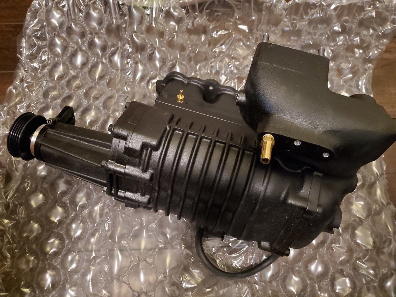

    So next up is that short throw shifter and the new shifter bushings. Also have them 1/4" spacers I plan to test for a bit more drop in the rear.

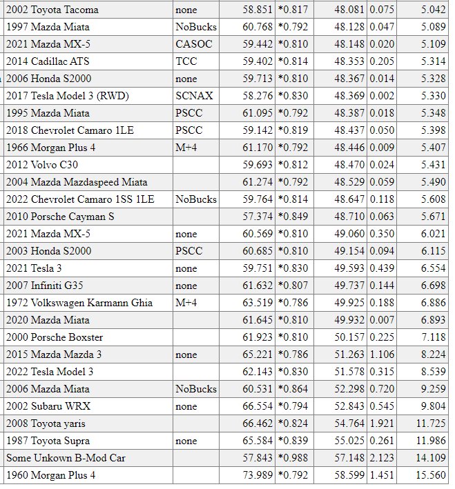

    Trudy did take 57th place out of 84 entries, and this is with the PAX time class index adjustments calculated to "even" out the competition. So 1 out of 3 sports cars drivers are wondering how the Tacoma is beating them on the weekends! Look at all the cars the Tacoma can out handle as is (it definitely is not out powering anything).. sorry to those Miata, Corvette, Tesla, Porsche, Camaro, S2000, Subaru, etc. owners out there:

    If I decide to go for practice days only, I think I may finally try slapping that supercharger in there and see what she can do with a bit more grunt!

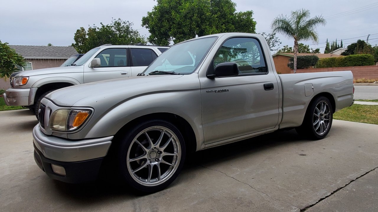

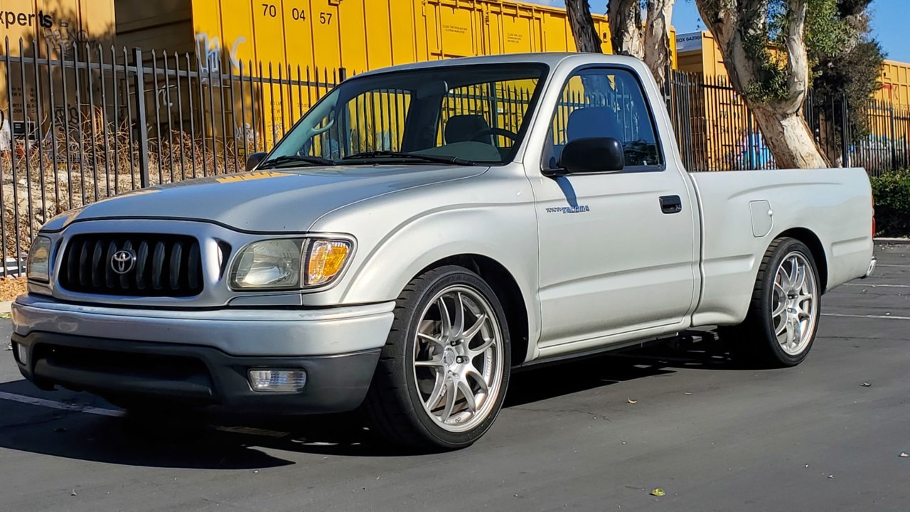

    Love the truck man! What wheels are you running? Also are those stock Tacoma buckets ?

    Thanks a bunch, those are stock buckets from an SRunner or also found in the "Limited" first gen's. They are way more comfy and supportive than the bench and stock buckets too but really hard to find (I have had them all in my truck).
    In that old first pic I was running 17" 2012 Lexus IS250 wheels (note these need to have the centers bored out to fit over the front hub), nowadays I am running Enkei PF01 18 x 9's for lighter weight and more rubber of course. Just added some 5mm wheel spacers last week (in place of my old 3mm). The truck is a couple inches lower now than when I first started out too, boy time sure flies..

    Kind of looks like STX is not happening at my event, more and more that supercharger is starting to call out to me to just go have as much fun as I can next year...
