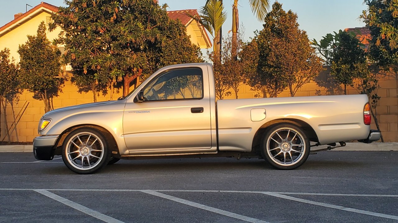

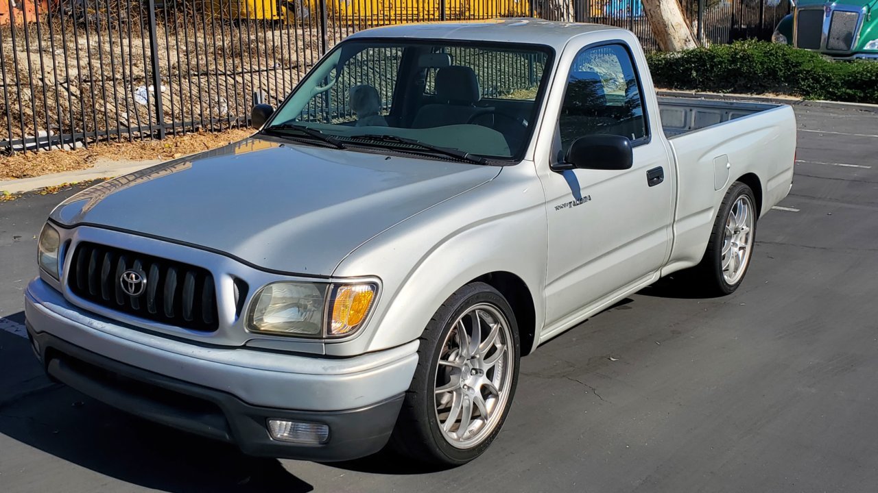

    Old Trudy was feeling better than ever out there this weekend. The weather seemed perfect and even though the track was really open and I was hitting the rev limiter all over the place she was still turning in some really good times. I had a really good time a well with over 20 runs I was really able to get a good feel of the course and felt great whittling time off wherever I could lap after lap! There are no timing records to share since it was practice day only, but from what I saw she was definitely "in the game" just a ~couple seconds off some faster pax drivers laps I spotted.
    That fiddly Gopro failed to capture any decent action sadly, but the cell phone came through with what it could video wise.. enjoy!

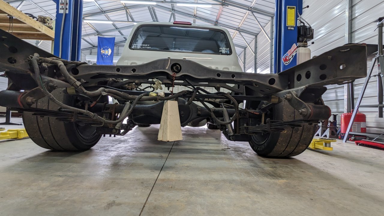

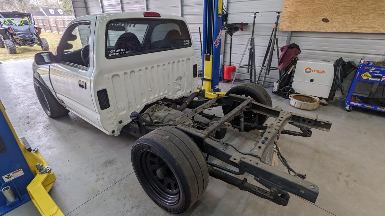

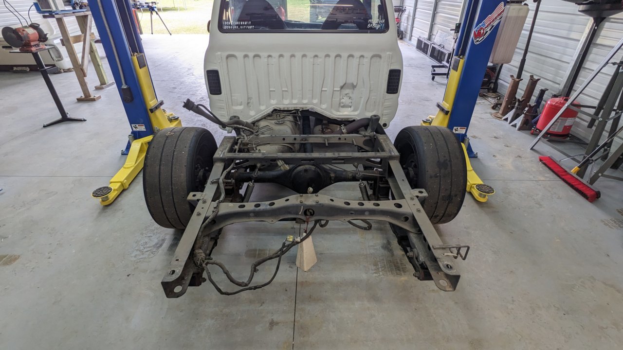

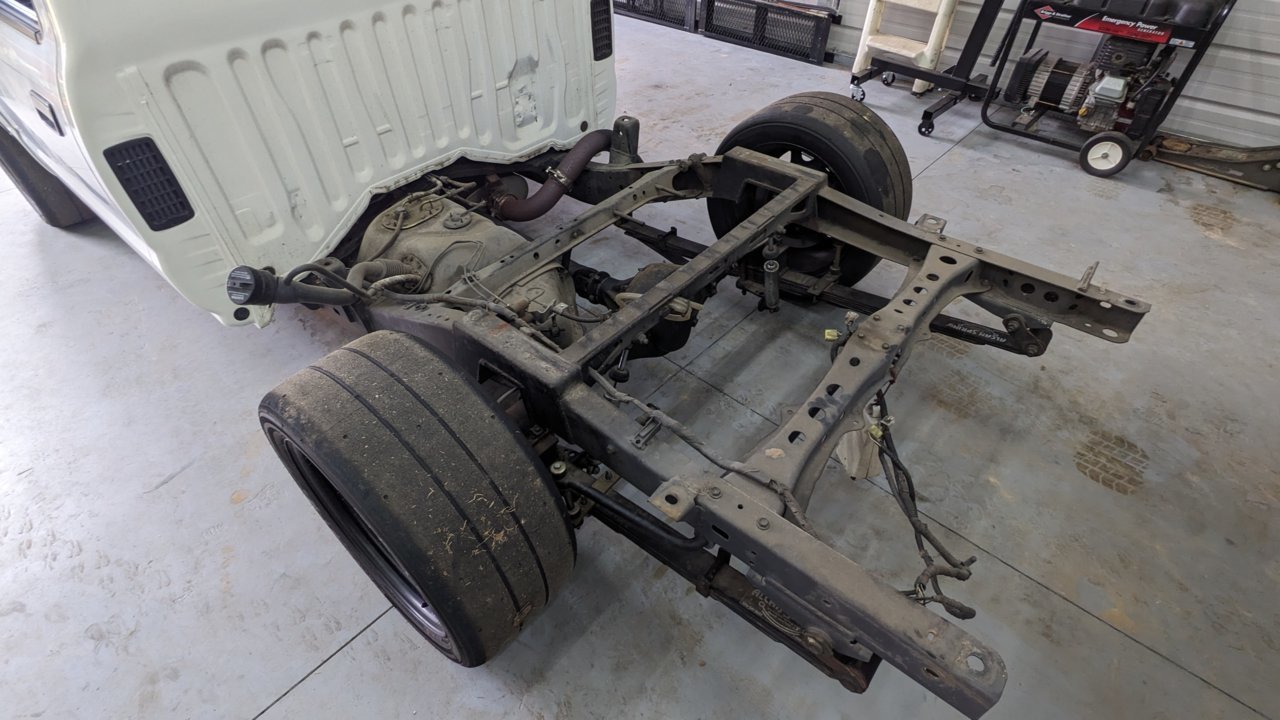

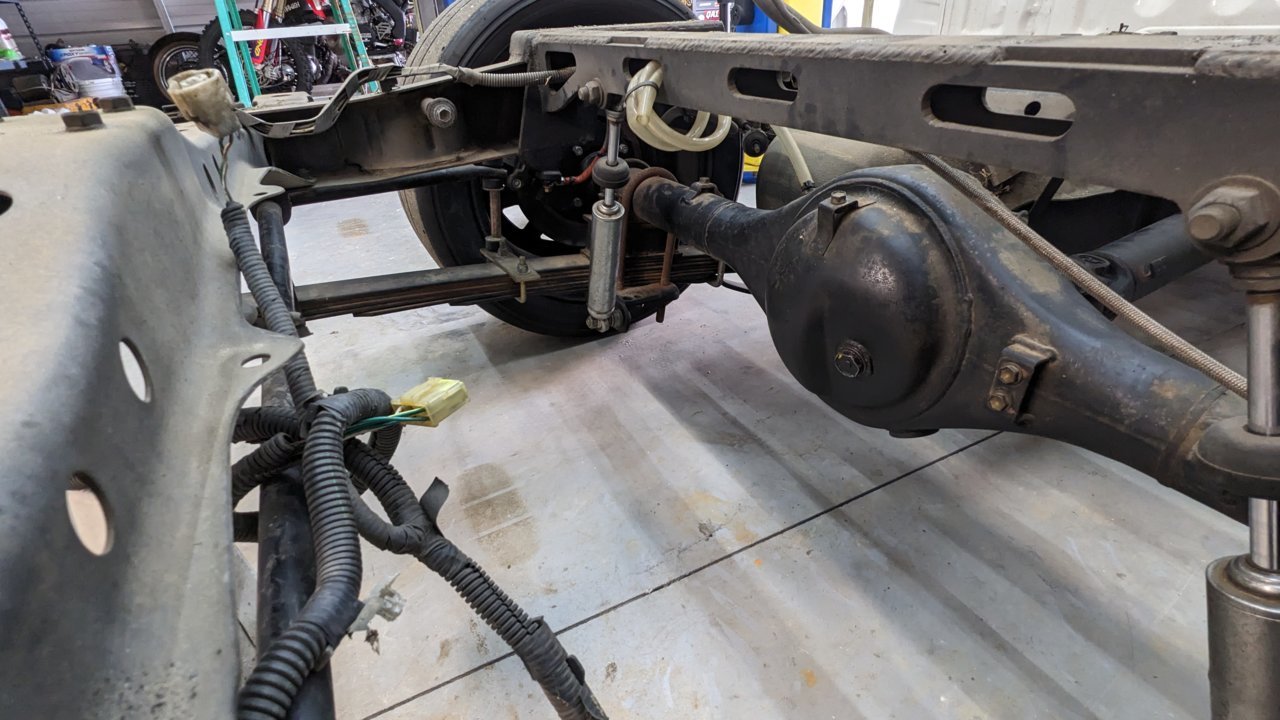

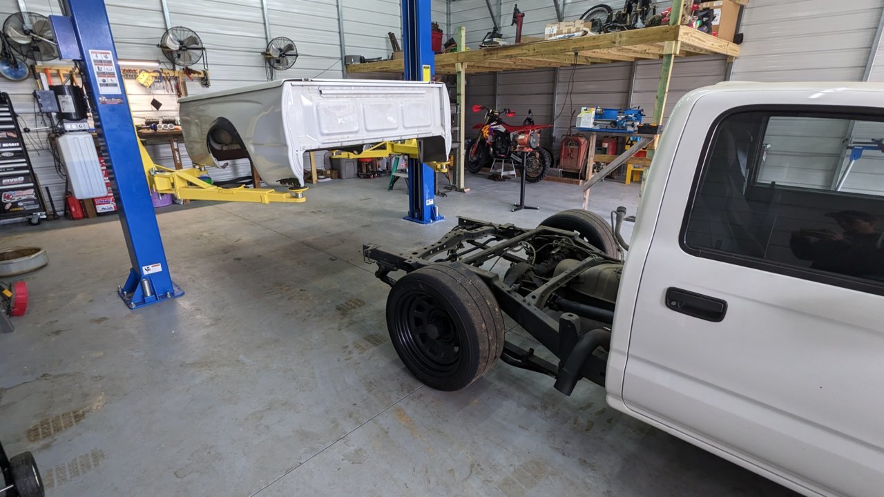

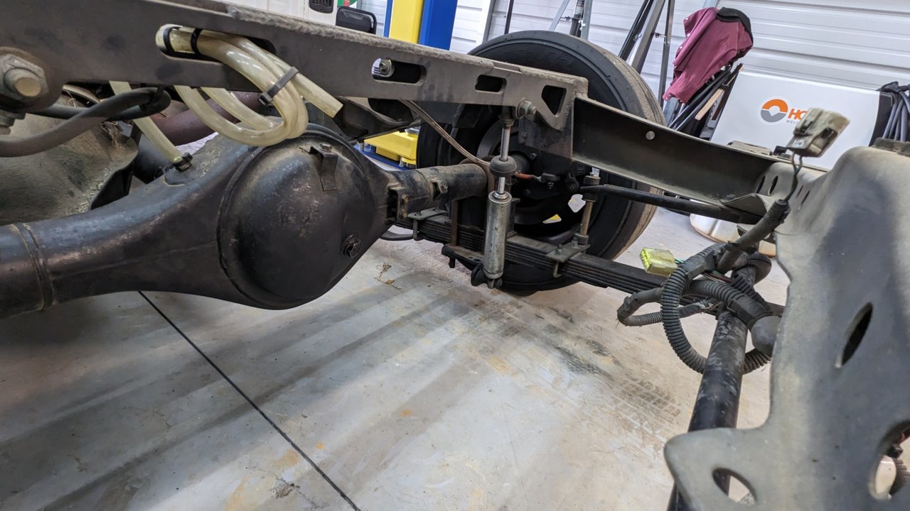

    I'm starting a big project since I'm taking time off from trying to make every autocross event for the next few months. I'm tackling the rear suspension. Kiss these leaf springs goodbye, time to go full-bore into a triangulated 4-link setup and coil-overs. The guy I bought the truck from had that notch put in and the shock bridge, so it gives me a good starting point for the coil-over location. I got the gas tank removed yesterday, and got the forwardmost center gas tank strap/pin bracket cut off and painted. I'm also going to fully box the rear part of the frame as well as mount a fuel cell behind the rear axle. The idea is for it to be just barely sunk into the bed so it's not exposed under the roll pan.
    PXL_20230129_171201710.jpg PXL_20230129_171303219.jpg PXL_20230129_172413926.jpg PXL_20230129_172445823.jpg PXL_20230129_172453583.jpg PXL_20230129_172503308.jpg PXL_20230129_172508403.jpg PXL_20230129_172514207.jpg PXL_20230129_203656568.jpg
    The last pic is after I pressure-washed everything off and removed the gas tank, but before I removed the rear sway-bar. That will be reinstalled after the 4-link is done, but something different has to be done since the leafs aren't gunna be there anymore.
  10. Jan 30, 2023 at 2:13 PM

    BananaMan
    BananaMan Well-Known Member
    Sep 4, 2019
    #304247
    8,151
    Bumfrick nowhere Maine
    06 2.7 RC 2wd manual "squattytruck"
    I'm excited to see this since I aim to four link my 2nd gen for the same reason eventually. I've had a couple people bring up the idea of doing an IRS swap, and I'm still tickling that idea as well.
