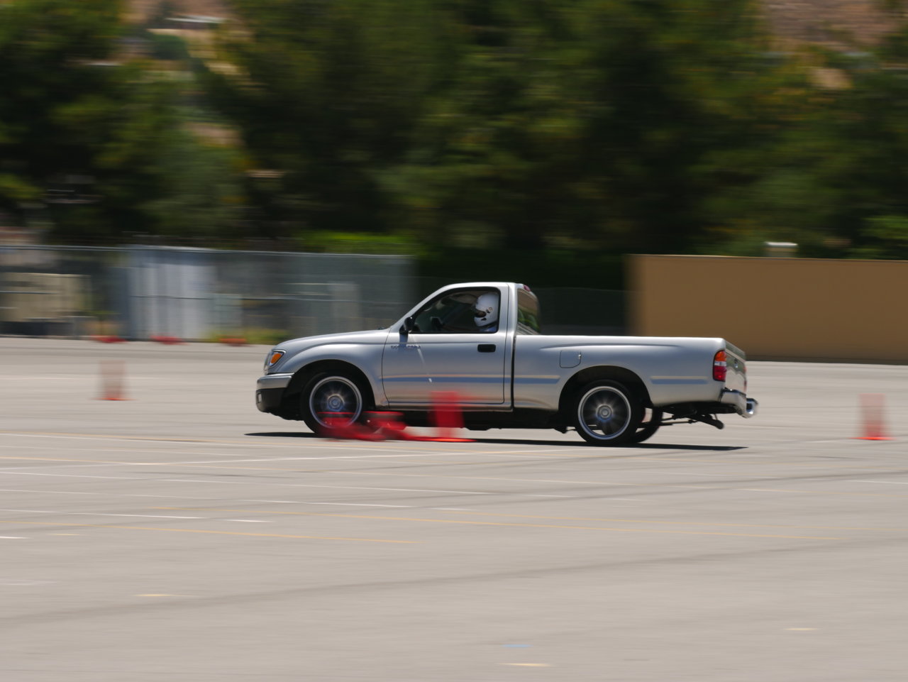

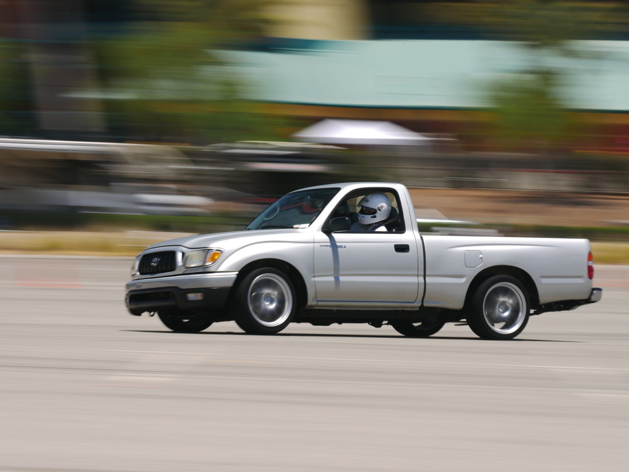

    Hahha too true! Of course Trudy has beaten anything you can imagine to the delight of many onlookers, but has also been spanked by everything ever made too fairly handily. Guess the vehicle truly is nothing without the driver at the end of the day.
    However, the Tacoma does seem to turn heads and set the tone to pure fun when out on the course like no sports car could ever dream of doing.. basically everyone is living in Tacoma World when Trudy is on the track! :thumbsup:

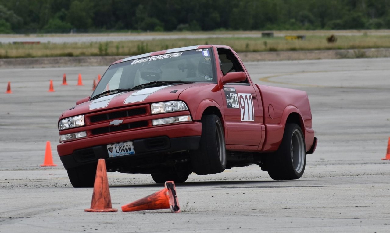

    I'm still shocked that you're not carrying a tire off the ground, all the trucks that run with us do it to some degree or another. I'd be in seventh heaven if I could use all my traction.

    Hmm.. maybe shock tuning, spring rates, sway bars, alignment, or combination thereof!? I dont run a rear sway bar, have a couple (SRunner, Addco) laying around and never tested them out since my truck is feeling pretty good to me but I do wonder how it may impact the ride.
    Is that an LS swap above, wonder if my truck is perhaps a bit lighter than others?

    Yes the truck in the pic is ls swapped with a t56 magnum, making about 450 to the wheels, running a 315/40/18 square setup. He's done a full custom 4 link rear with coilovers, no more leaf springs. Even I get the front tire in the taco up that high on occasion too. I'm running the 4x4 leaf springs, no rear sway, stock front sway, and the feal coilovers.
    edit: that s10 weighs 3200 lbs, my Tacoma weighs 3600 with me in it

    Interesting, wonder if the 4x4 leafs are softer combined with extra hard front springs upfront amplifying the handling character seen above? Or perhaps a combination of soft and no sway bars with stiff/soft springs working against you.. hmm, just thinking over here and wondering how to bring some contact back to the ground! Have you gone full soft on your shock settings to see if it lets the truck settle a bit? Do you have a sway bar upgrade or other springs to test out?

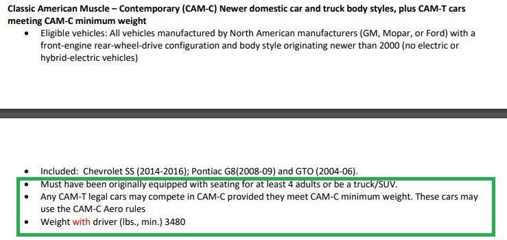

    Is he running at 3200 pounds in CAM-C? I believe the minimum weight was 3480 with driver looking at the rule book, maybe he is quite large or!?
    Gotta keeps these fellow truck racers honest you know!!

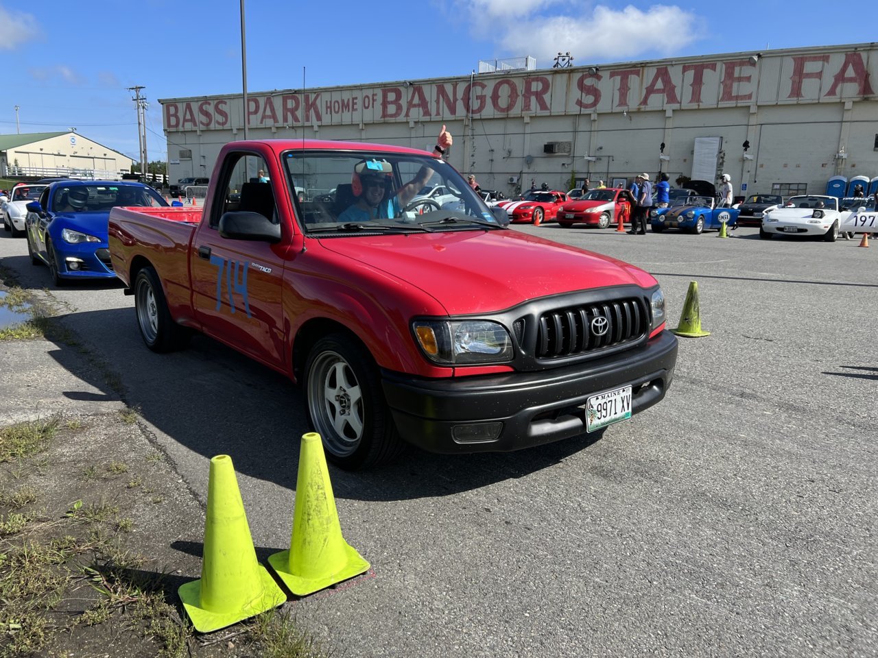

    Finally! Another Tacoma at an event with us!

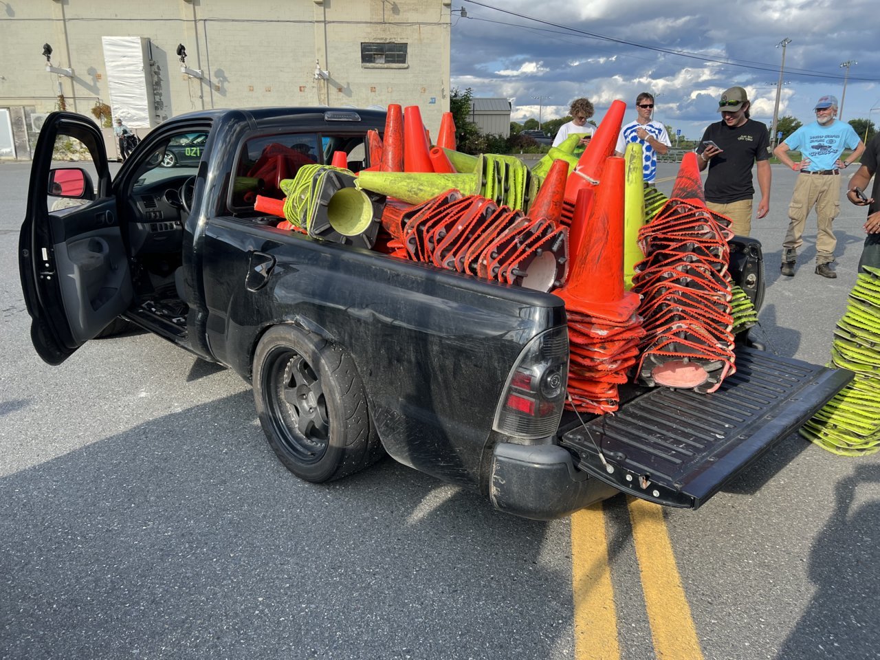

    Race truck putting in work after winning its class.
