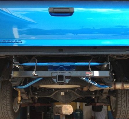

    Depending on class get wider wheels and tires. Could run a staggered set. You could also try and adapt some xrunner implements on the 1st gen like the x brace and box the frame for multiple benefits.
    2Runner[OP] likes this.

    Funny it was mentioned, I was actually looking at the XRunner brace and saw how it ties the shackles together and then to the frame for some stiffness. This doesn't look to difficult to replicate..
    I looked under my cab and thought I could use the lower shackle mount vs the bottom of the shackle, then just gotta work around the spare tire and the exhaust a bit on my first gen.

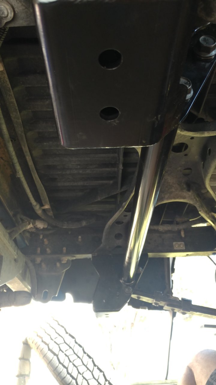

    If you want a cheaper and easier alternative you could add a brace or Cross tube between the rear leaf hangers. Made a good difference on my dd/rally truck.
    2Runner[OP] and Torspd like this.

    Very nice, this looks like half the xrunner brace already!
