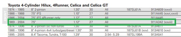

    I was able to have my local gear specialist install the TrueTrac as mentioned above yesterday. I ordered part #911A342, it actually had a part #911A644 printed on the diff itself when I pulled it from the box!
    He stated it was set up with proper rotation to use in the rear so didnt need to flip anything. Also mentioned all the parts I purchased worked out for the installation. This was basically all oem stock parts used for a full rebuild with the exception of running the "larger 50mm" diff carrier bearings. Here was the parts list used:

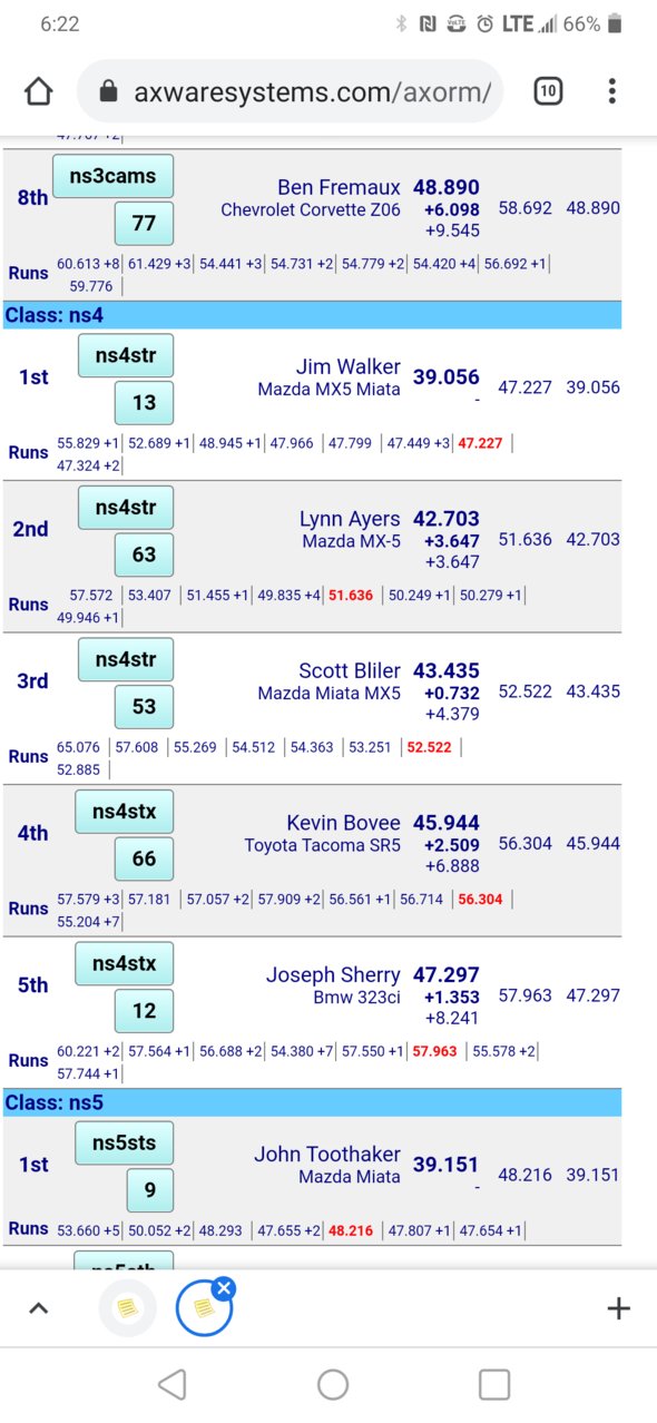

    First event, 4/5 in class, 47/57 overall.
    Not quite as good as my Miata, but it certainly jails more stuff

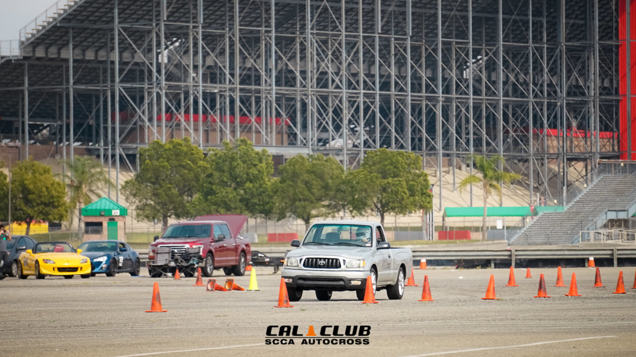

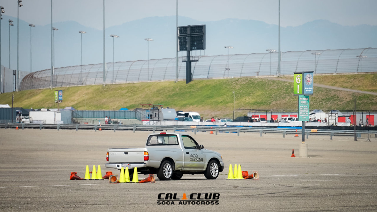

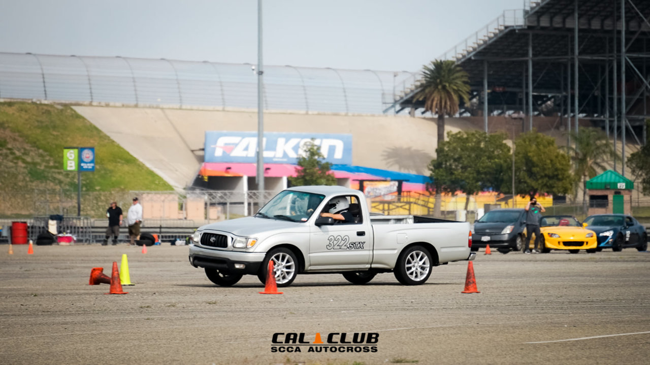

    Found some sweet pics up on the auto-x clubs site..
    These are from the March event:

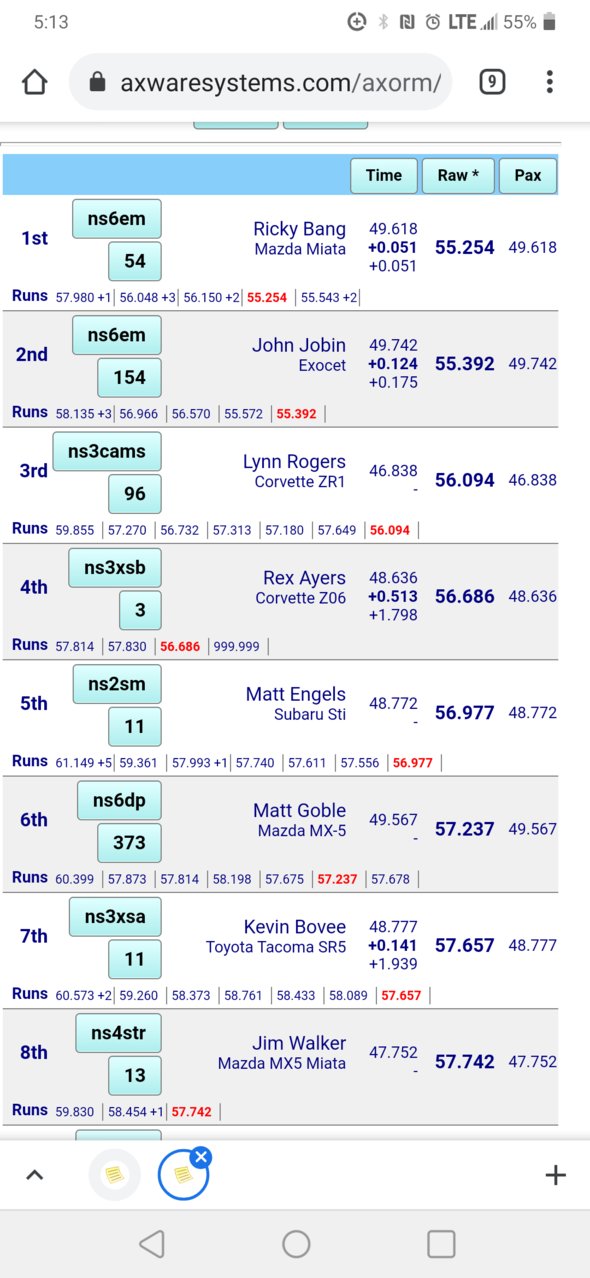

    Did better today, 7th raw overall.
    Some of that might be because I drove an STI instead of my pickup, but registration still says Tacoma so...

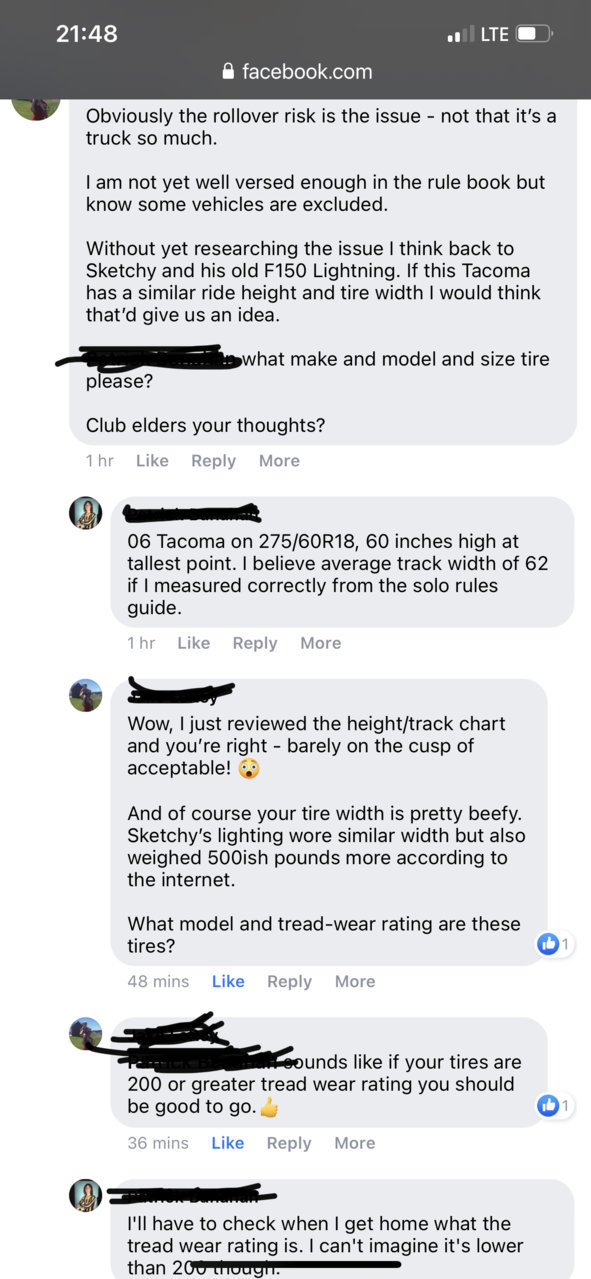

    2390E9B6-B7D2-4063-BCD6-4A1DFDEC9669.jpg Alright! So after some back and forth with my local clubs head of safety, my truck should be able to compete! I barely meet the non standard vehicle rule of 1:1 on the height vs track width. 60 inches high at the roofline, and 62 inches average track width if I measured correctly.
