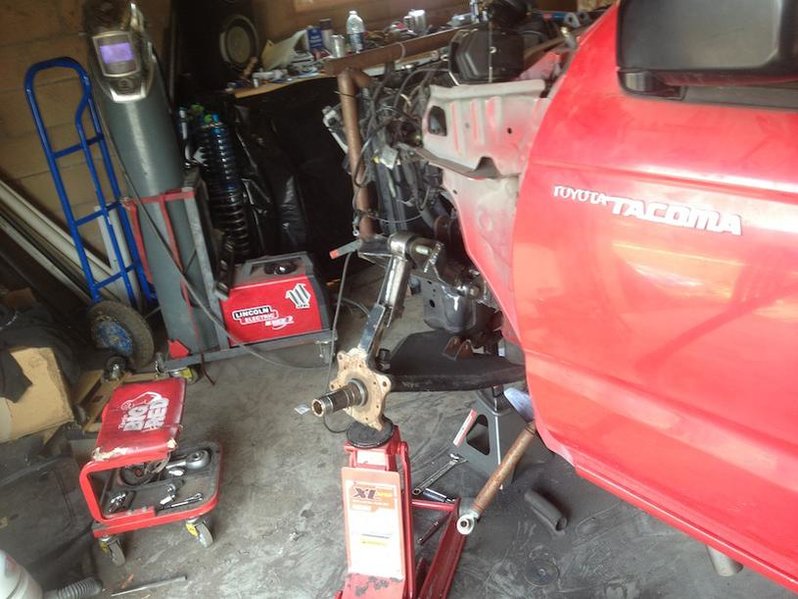

  11. Dec 30, 2012 at 5:29 PM
    #311
    linked2002
    linked2002 [OP] Well-Known Member
    Aug 17, 2011
    #61872
    812
    san diego
    02 tacoma, 3 linked, 6 over custom arms, cage
    links, custom 6 over arms, full 1.75 d.o.m. cage, 35 gallon cell, etc
    re-did the uppers again... kept vertical uni but changed it around again... i like this more.. less travel overall but way cleaner cycle.

  13. Dec 30, 2012 at 5:46 PM
    #313
    mjp2
    mjp2 Living vicariously through myself Moderator
    Feb 16, 2007
    #924
    22,014
    Milton Juevo Portimous II
    NJ
    Current: '21 Bronco Badlands. Previous: '06 TRD Access Cab, v6, 6-speed
    Nice! Any plans to tie the two tubes together with a gusset or gonna rely on the strength of the bolt through the uniball to hold everything together?

  16. Dec 30, 2012 at 7:43 PM
    #316
    linked2002
    Aug 17, 2011
    #61872
    812
    san diego
    well thanks guys! my name is nick and yes i do plan on tying the tubes together. that was what i got done today and was able to get a few pictures in. both sides arms are mocked so i should be able to gusset and ill be happy. still have to place in the rest of the tabs for the uppers to the frame and figure a way to brace the hell out of them.

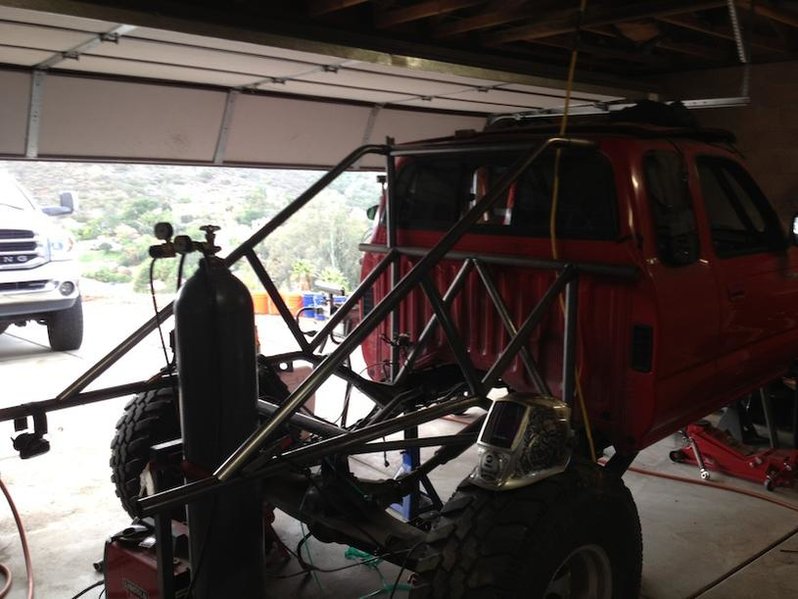

  18. Jan 27, 2013 at 6:22 PM
    #318
    linked2002
    Aug 17, 2011
    #61872
    812
    san diego
    well finally got into the shop this weekend for a few hours and was able to get a bit done... i need a cherry picker as mine is over 400 miles away and im sure its probably non-existant anymore... anyone local have one i can borrow for a weekend? hahaha
    and yes i know my work area is beyond blown up right now...
  19. Jan 27, 2013 at 6:32 PM
    #319
    Glueman
    Glueman Yersinia pestis
    Dec 27, 2012
    #93882
    2,119
    Utah
    The Plague....
    6 inch Douche Bag lift...what else do I need?
    WOW! ... Just Wow. That is some serious work! Well done. I'm liking the rear cage design.
