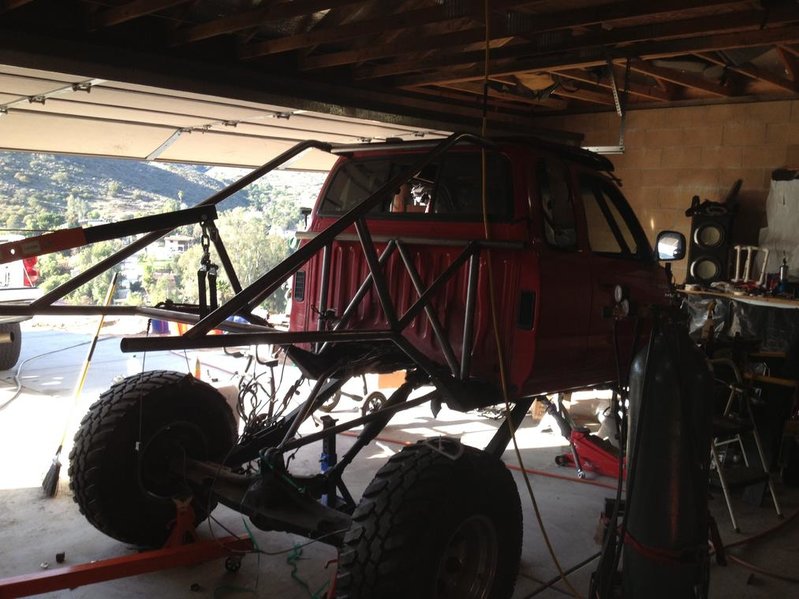

    Was a good day. Thanks to Tyler (Tcyota) I was able to cyclthe rear. I have roughly 31-32 inches of travel at one inch of pinion plunge through the whole cycle while maintaining proper third member angles. A good day indeed.

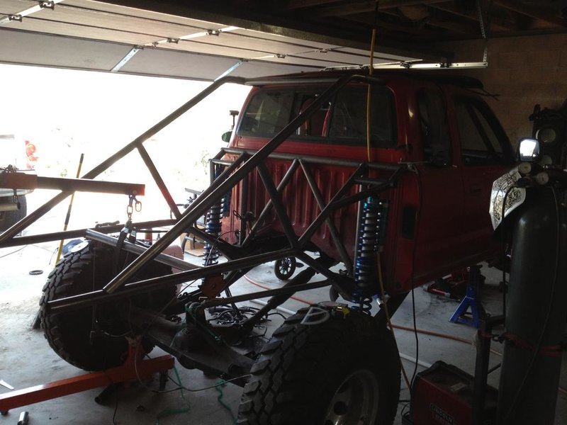

    Won't let me post two pics in same messge so here is the other

    Looks good, Id add a cross piece on that upper wishbone

    Nowhere near complete yet. Couldn't put a cross bar in there rollitup cycled and knew it would clear the drive line and the cell placement. It's all good so more bars go in.

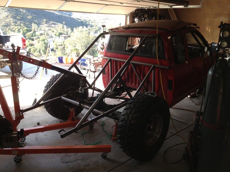

    Rear is now on her coil overs, a pillars tied to frame, b pillars to frame today. Complete external c pillar and engine cage to cab cage. Mount coil overs up front and do engine cage, she is touching some dirt.

    Cab cage is to the frame!!! And she holds shocks now :)
