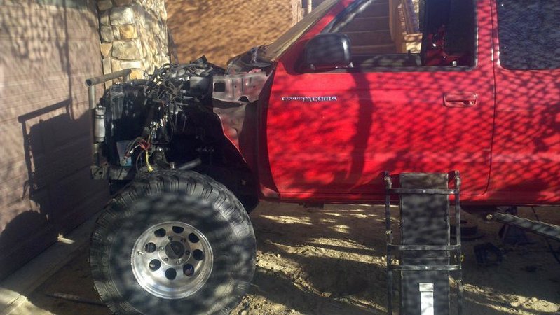

    Can I see a picture of the lower spindle ball joint area? I want to see what you did!

    like stated priviously i had receivers turned down on a lathe so i can weld them in. i will take pictures tonight for you guys if i remember. sorry for lack of updates. i have 1 final engine i have to put the bottom end back together on then it is back to work on the truck.

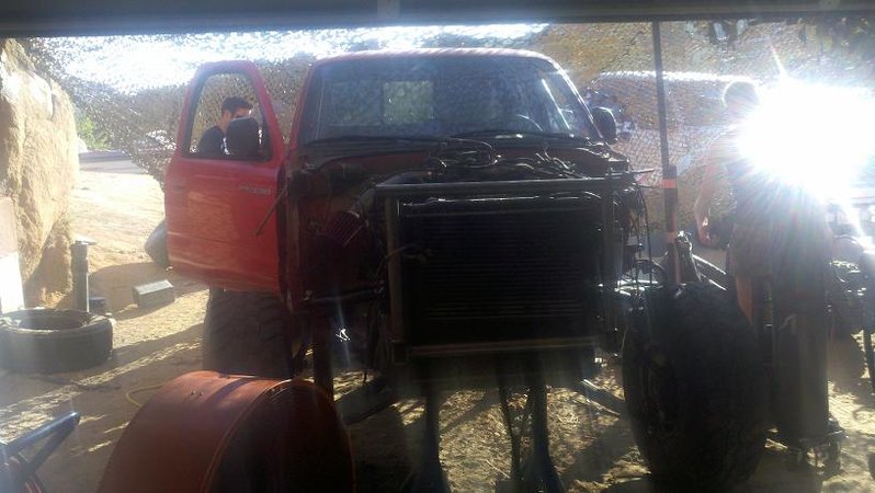

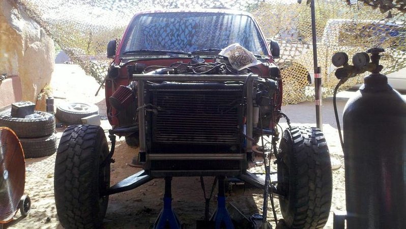

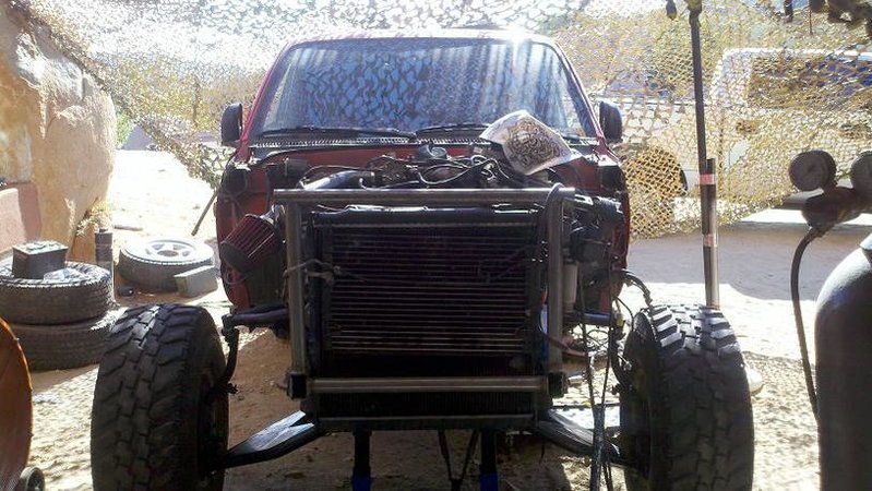

  8. Oct 31, 2011 at 9:05 AM
    #168
    linked2002
    linked2002 [OP] Well-Known Member
    Aug 17, 2011
    #61872
    812
    san diego
    02 tacoma, 3 linked, 6 over custom arms, cage
    links, custom 6 over arms, full 1.75 d.o.m. cage, 35 gallon cell, etc
    the truck after this weekend. cab cage is almost complete. just covered the truck before i could take pictures. lemme know what yall think so far. that is about the ride height i want... the back a bit higher... but imma have to rebuild my uppers as the uniball cups dont have enough angle built into them.
  9. Oct 31, 2011 at 9:12 AM
    #169
    theduck911
    theduck911 Max's Canadian Twin
    Oct 28, 2010
    #45374
    3,925
    Max
    Northwestern Ontario, Canada
    Locked and Geared!
    Looking good:thumbsup:
    So are your uppers binding then?

    maybe I missed it but are you going to make new spindles? Linked truck with stock spindles=fail

    eventually. right now im aiming ot get it back on its tires as some recent personal shit has left me in quite a bind. the truck will be put together enough to get on my trailer, unloaded in my shop, and left alone for a while.

    shit. sorry i didnt get to answer your question. yes the uppers are binding on the cup. i have a 0* offset in the cup so it is limiting the travel numbers right now as i wasnt able to get the proper cup angles needed until recently. i will fix it all once im back under the truck and getting it finished.

    Looks like you need to flip them lol I built mine so both top & bottom were centered at "ride height"

    i wish it was as simple as flipping them. and i built these guys with that idea and ride height in mind, but i obviously fucked something up somewhere.

    did you not cycle it before finishing them?:rolleyes:

    i did not actually. i hit the point of "oh shit this needs to be ready to pull on a trailer in 2 weeks" so i said fuck it and i will fix it once my life straightens out a bit. :jerkoff:
