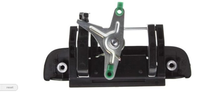

    should look like the green pieces...two each.

    It's a $5 dollar fix. Do both sides. Get them at any car parts store in packets called "Help". The rod goes thru the hole and the plastic wraps around the rod.

    looks like the actual handle is broken ill have to order a new handle now.
