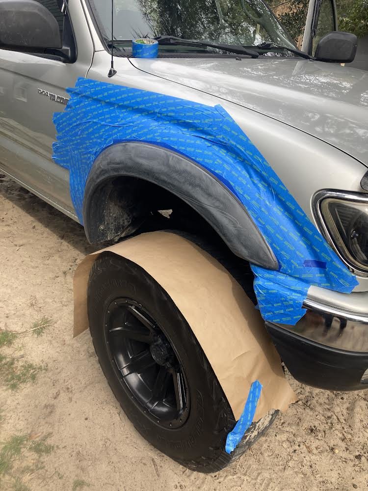

    Good, just two days I’ve done a lot of work to it. Mostly cosmetics but put some Hercules bedliner can spray on the fender flares and random things

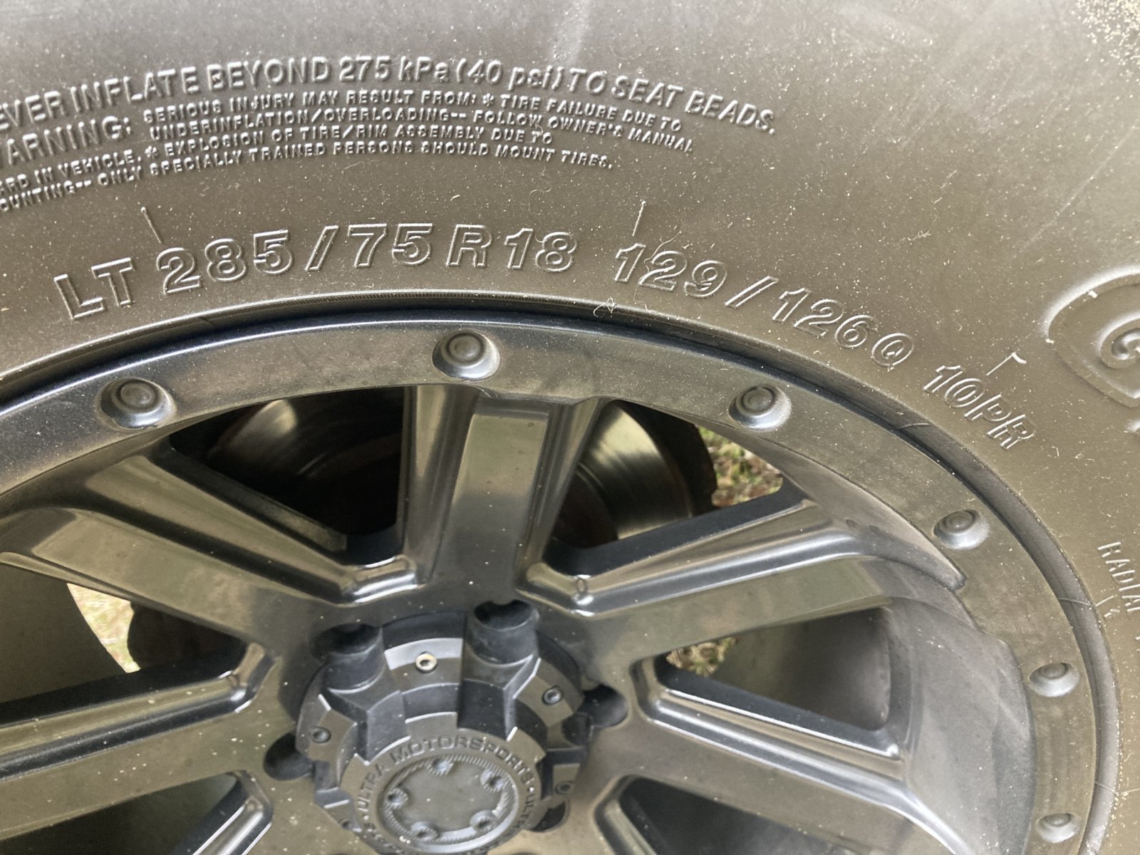

    Sliders, lift, 275/70/17
    I’d definitely get skinny 33s (255/85/16). 35s make it easier to break stuff, especially with a teenager driving, and it sounds like you don’t need the extra clearance if you’re just driving on the beach.

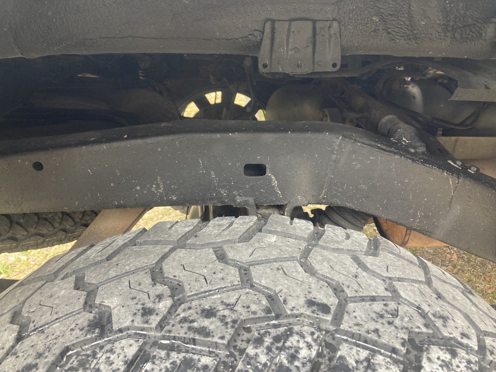

    I would not trust that they visually seem fine. The lower ball joints on these trucks are very well known for failing, and the failure can be catastrophic. I know personally I've had one fail that looked fine previously, thankfully I was only going 5mph when the wheel fell off not 65.
    Since its for your daughter, I would just go ahead and replace both front LBJs with OEM just to be safe. They are the only common failure point on these trucks that can be dangerous.

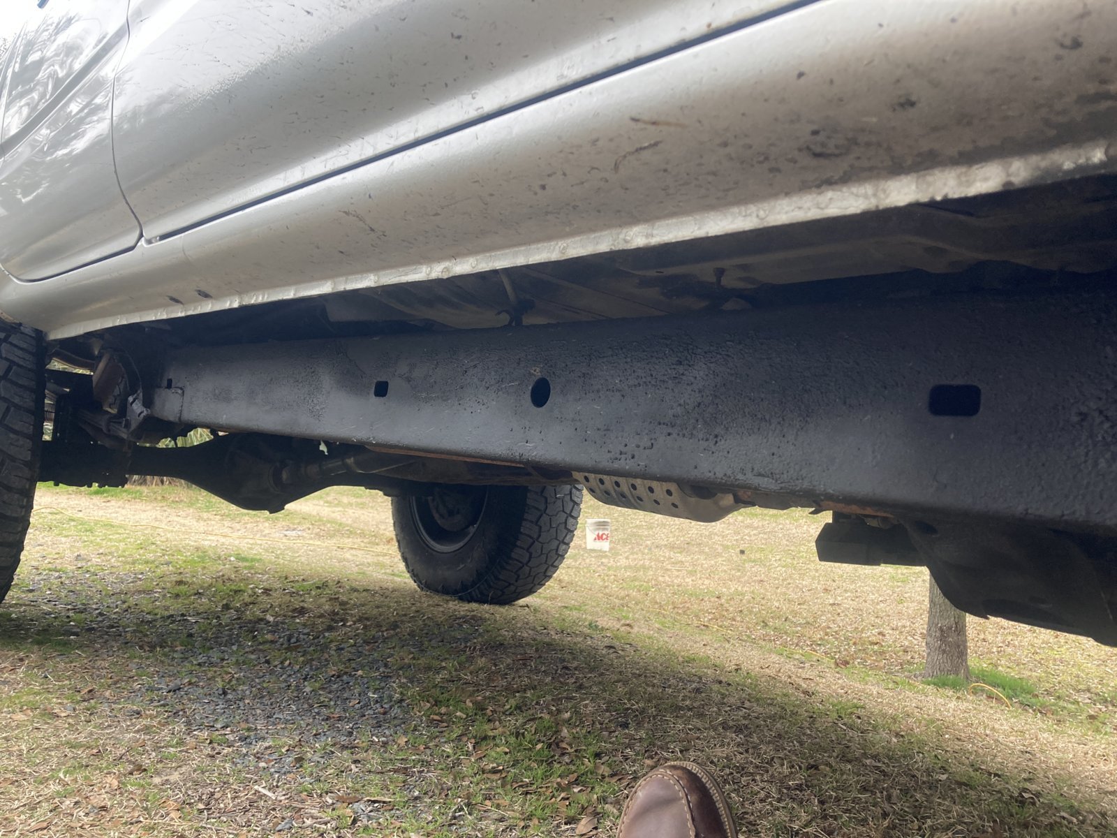

    If that was my 17 year old daughters truck I’d definitely investigate what the suspension lift is all about.
    If it’s spacer, blocks and/or body I’d do it right.
    I’d also check the cv axle angles. I’d also replace the lower ball joints if there’s no history.

    That’s kind of what I’m thinking, I’ve been running around, but here are some photos of the tire size and the rest of the truck1BB9A938-D663-4B64-AE31-55C1E968E503.jpg
