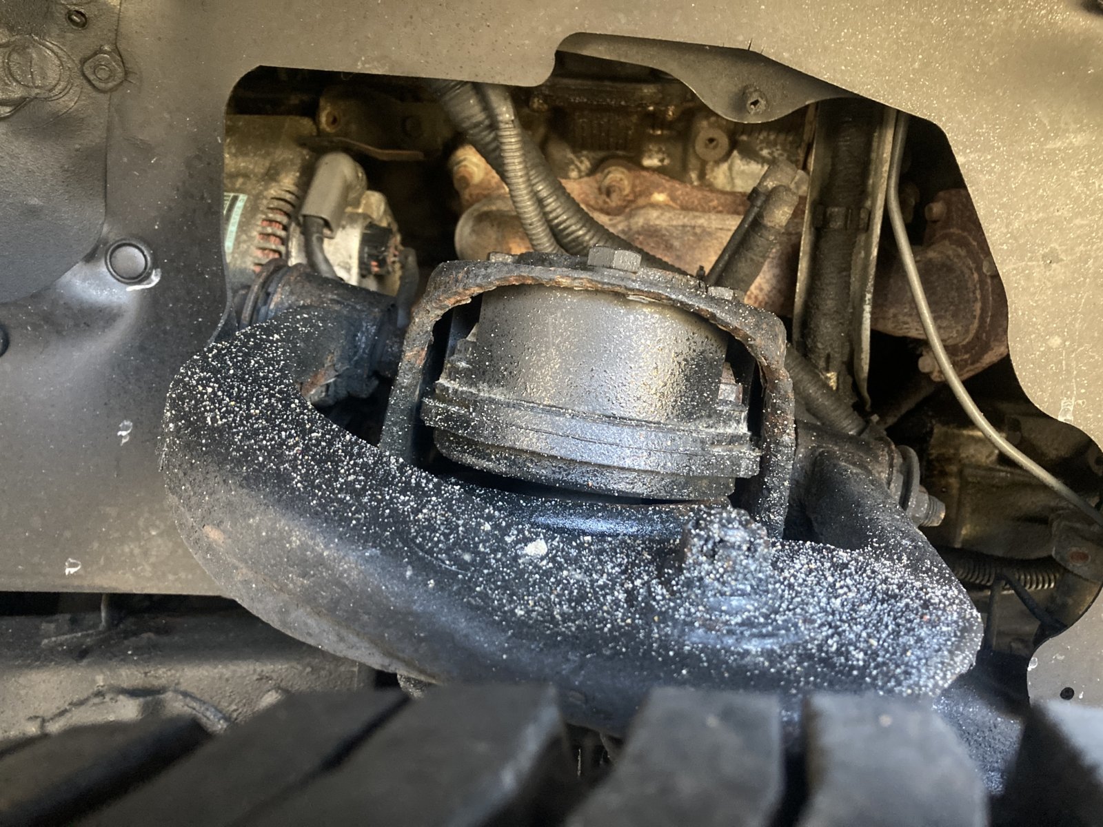

    Photo #2 is called a body lift. Yes it's a spacer but it has zero to do with suspension. We would need to see the top of the coil assembly to know if there is a top load or preload spacer giving it some suspension lift.

    Gotcha, I will take a photo tomorrow. At least you guys are educating me what to look for.

    Just got the shot this morning. Hopefully I got the right area.

    It's a nice "beater" in my opinion. Tall body lifts and top hat spacers are frowned upon. What you change would depend on budget. If you drop tire size you could ditch the body lift but that might be a challenge to source all the bolts etc. to return to stock. New coilover assemblies might not be a bad investment. It's possible that that stuff is original. There are pre assembled options that use lift coils instead of spacers (e.g. Old Man Emu). If you go that route 2" or less will net a better ride.
