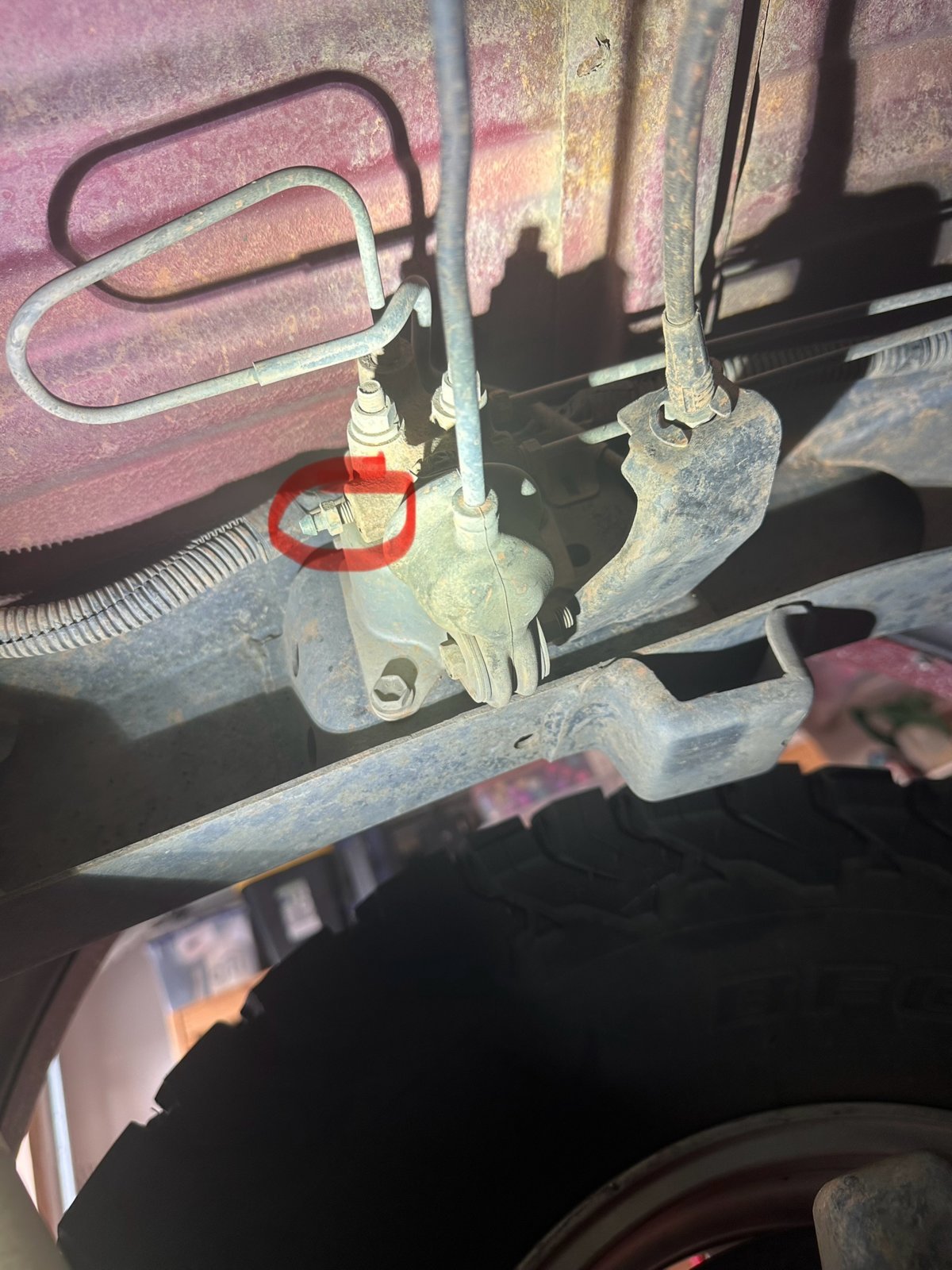

    You bleed the LSPV yet? Maybe one of the rear drums isn’t engaging because of an air bubble. Should take about 3 minutes to rule this out.

    Trents Tocoma

    Here it is on my 2000, right behind the rear driver tire. Have a friend pump and hold the brake and then briefly crack and close the bleeder valve circled (with a hose and bottle attached if you so choose). If you get a big spit of air, do it a few times and then bleed the rest of the brakes in order, that may have been your problem. If you get a solid stream of fluid it was probably fine and you can rule it out. it’s the highest/furthest point in the system so most likely to trap air and should be your first stop in the bleed sequence.

    Oh ok awesome I’ll have to give this a try hopefully this is the problem but I’m doubtful but worth a shot I’ll let you know what I find out

    Good luck! Agreed not a likely culprit but free and easy, so worth a shot! I could imagine a scenario where one drum is bunk because of some air so you’ve possible got disproportionally more stopping power in the other side?
