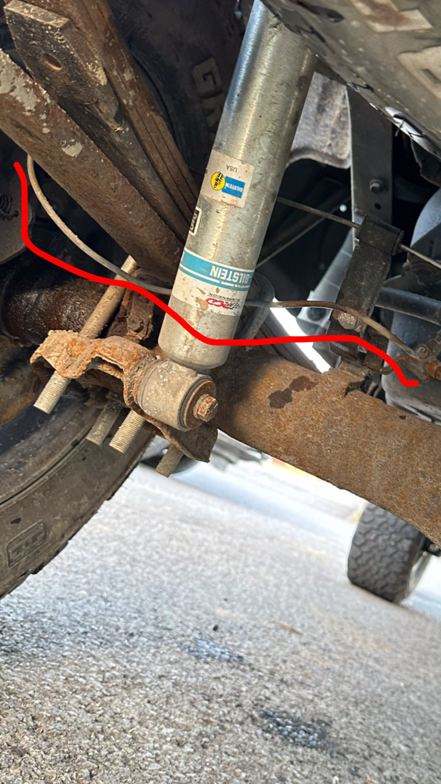

    Ok guys so I bleed the lspv there was no air in it at all then we blead everything I did notice that the rear driver side blead really slow and the rest of them blead normal. I went for a drive and the truck was perfectly fine no pull at all.then I decided to test the limits and go on the interstate where it happens the most and sure enough the truck pulls a bit harder to the left when breaking then usual it’s almost as if the truck has to get warmed up and other ideas on what to check?

    Slow bleed is an interesting clue, any pinched/kinked/dented lines? Someone with more understanding of the interworking of the drum might be able to direct you better.

    I actually way back when I made my own line it was like 10$at auto zone maybe the problem?
