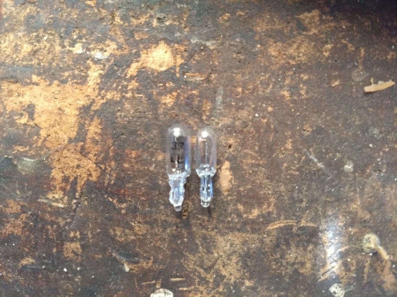

    I replaced mine a few years ago in my 2002 and now I'm doing it again. I used a 37LL (Part No. 37LLBP2 from Advanced) it fit and worked fine. It is a little bigger (see Pic). But I definitely agree with bsedgal, that at $5.99 for two at Advanced and I paid $3.22 for one at the dealership. The original one lasted 10+ years and the 37ll lasted like five years.
