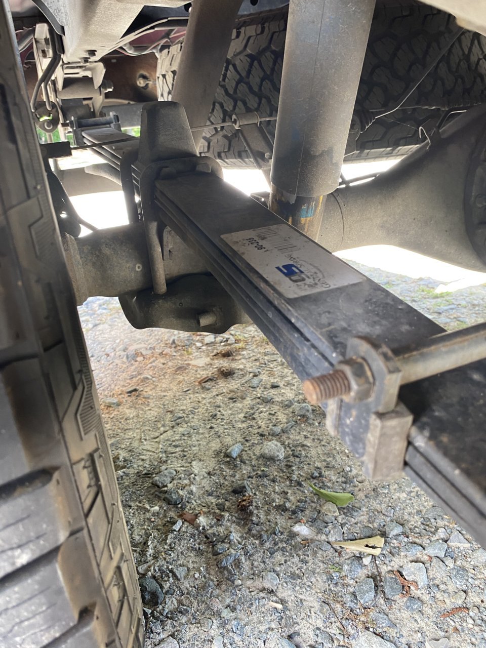

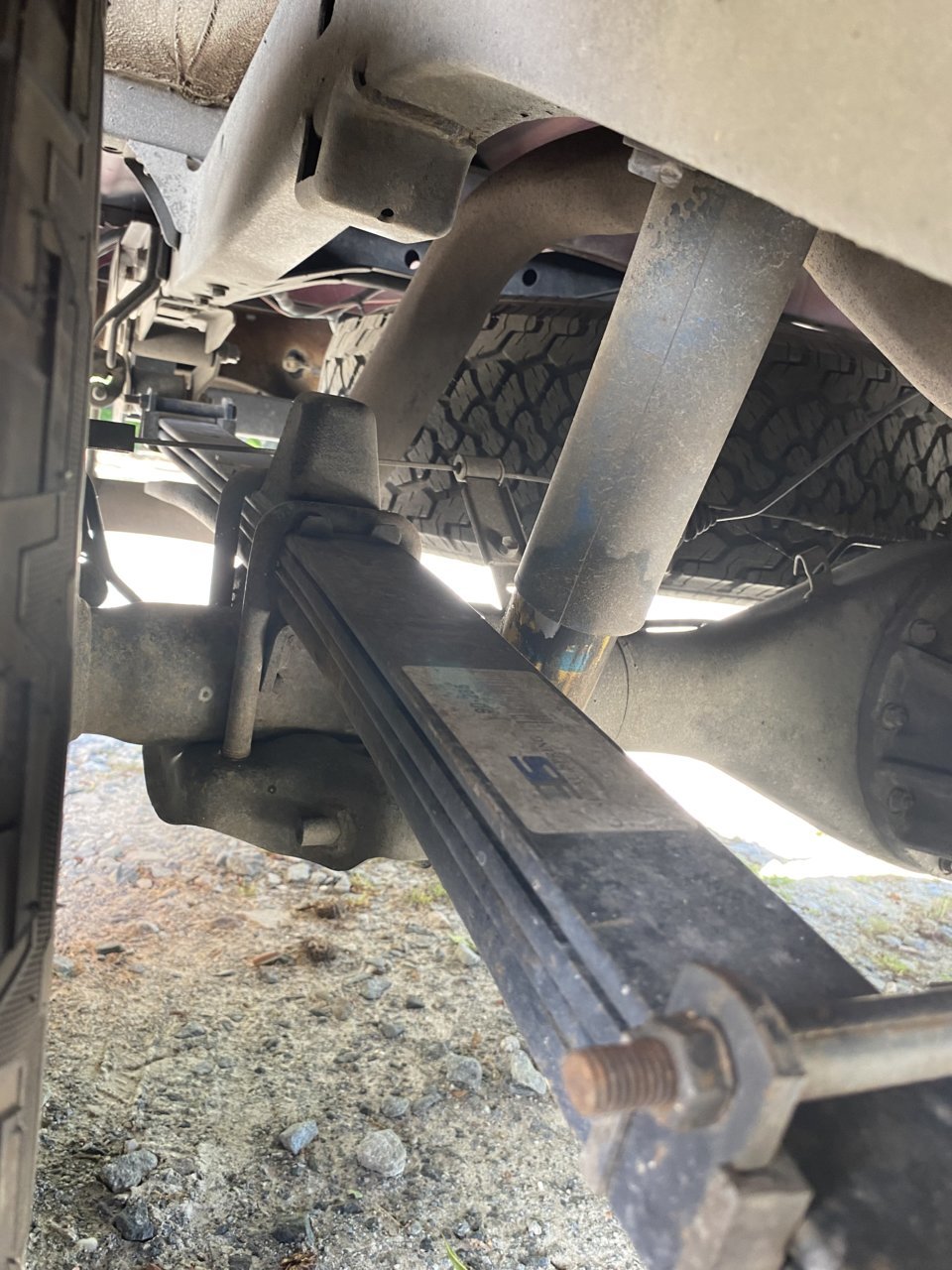

    I bought a 2002 Toyota Tacoma about a month ago and the back of the truck doesn't sag but it will go down like two inches with only 270lbs in the back the leaf springs are on it are General Springs and they don't look that old and the truck has no rust. I think I'm going to replace them any good brand or suggestions on what leaf springs I should get?

  3. May 11, 2022 at 8:15 AM
    Chapito
    Chapito [OP] Well-Known Member
    May 11, 2022
    #396962
    103
    These are the leaf springs on it.
    Taco critter likes this.

    Look a little warn out ,I would check into wheelers off road

    I’d look into Deavers. I got some universal group leafs from the parts store and had a leaf break within a year with very mild off road and no heavy loads. If anything stay away from universal group.

    I have had very Good luck with General Spring out of Kansas City.
    I have bought a few sets of springs for my projects they beat the local spring Shops delivered to the shop.

    You can go with the stock replacements or the heavy duty I also go with the heavy duty.
    The more weight the springs will support the rougher the ride will be
