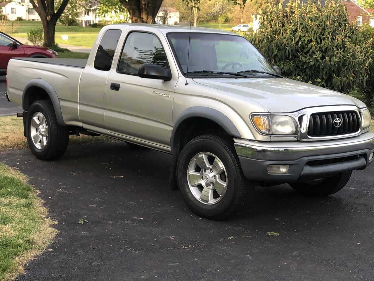

    Hi all,
    Hopefully someone here has done this and can point me in the right direction.

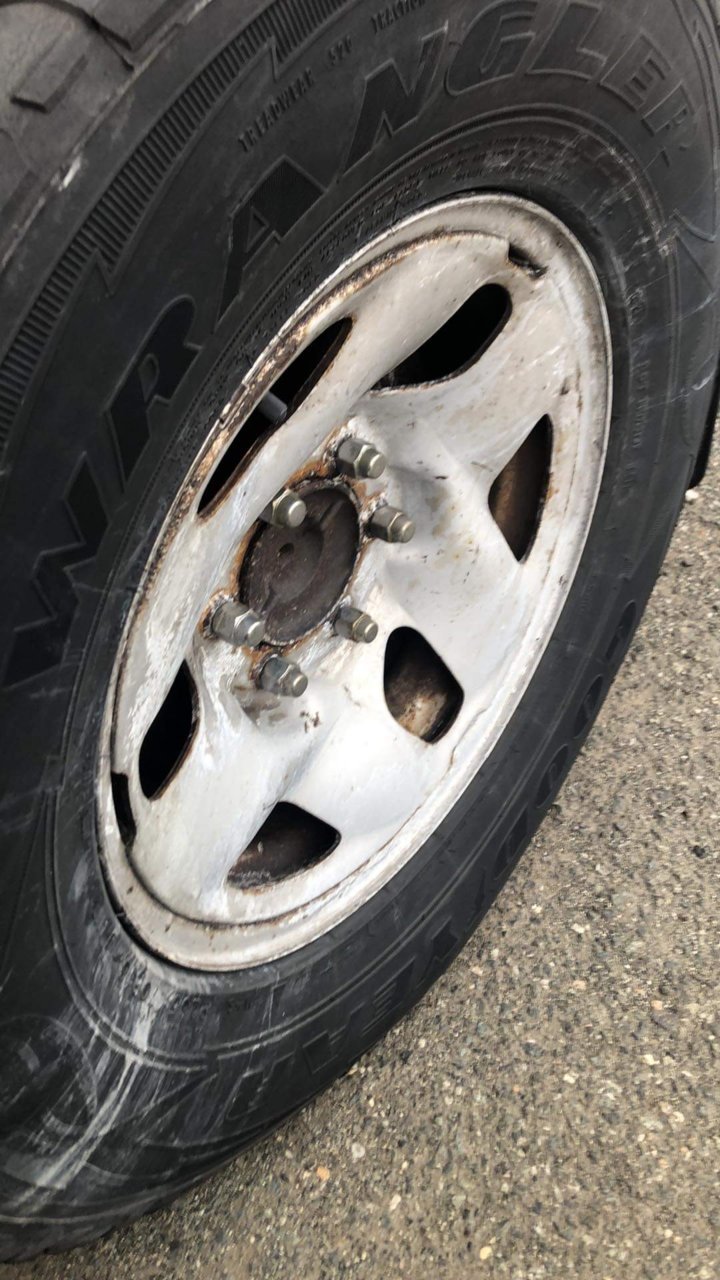

    I have a 2002 Tacoma with the 16” steel wheels and acorn lugnuts.
    On a whim, I saw a local classified ad for 2015 Tacoma 17” wheels and nice rubber on them. I “think” the offset and backspace are close enough to work, but is there any issue with the center hub of the differentials and threaded studs for mounting? Will they be long enough? It appears I need shouldered lugnuts, but is there anything else I need to be concerned about? Can someone suggest the proper lugnuts?
    Pictures for reference….first one is new wheels, second is my current nasty looking steel wheels.

    If its stock I think thats +30mm offset like the 3rd gens, it should probably work depending on your set up, same overall size as your other ones, but will likely sit in a bit more (less poke). Ive got the 3rd gens and it works with mine at stock, no rub, close though

    they should work. How much are they asking for them?

    Center bore and wheel stud length should be the same. Overall tire diameter is equal, offset is a bit more but should still fit with the correct style lug nuts. You will need the shank style with washer, 12x1.5.

    Yes the wheels and tire combo will work and you need the factory oem lug nuts as posted above in #5

    Got them mounted and have to say it makes my 20 y/o truck look like new!
    (Well….almost!:)
