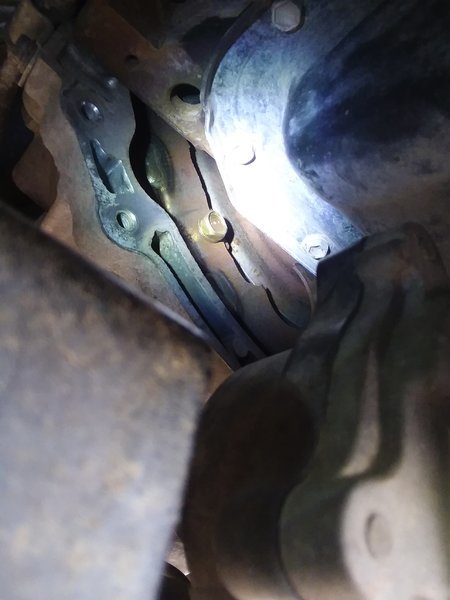

    From what I've read on other sites, there is a remove-able inspection cover for the flex plate.
    If you can locate/remove it, it may answer some questions.

    Sounds like a bad starter to me...flexplate just seems unlikely to break without some other catastrophic failure that you would notice. If it cant even turn the engine and your battery volts are good, I'd start with the starter.

    There's a gynormous hole in your thought process. How would a bad starter cause his vehicle to lose power, cause a shuttering feeling and then fail to start afterward? The flex plates on 1st Gen Tacomas and 3rd Gen 4runners are known to fail. You just haven't ever heard of it. The OP did say he heard the tell-tale signs of a cracked flex plate before he had the complete failure. Once he pulls the access plate off the bottom of the bell housing, he'll know if it is a flex plate failure because it will be obvious.

    sounds like a possible stripped flex plate.
    Tho' I'm not sure what may have caused that.
    Possibly the motor is locked up and the starter stripped the engagement gears ?
    The engine can be checked by pulling the spark plugs and turning it over manually at the front crank wheel.
    Does the engine turn over when turning it manually ?

    if/when the flexplate went south it should have made a horrendous sound. once broken all the way around from the mounting bolts, the torque converter quits spinning, thus the loss of power to da wheels...crank connected to flexplate, flexplate connected to torque converter, torque converter connected to transmission, transmission connected to driveshaft, ect...any part that fails in that chain equals no power to rear wheels..I doubt it was the timing belt as you stated the engine kinda ran after the problem...
    most likely scenario....
    if the engine puked, there would have been a terrible noise too...

    Sounds like the tbelt is toast and it's just free wheeling with the starter, you said all the timing marks were lined up? Did you try turning the engine over by hand? Did the tbelt rotate when you did?

    Well, opened the inspection cover and I was greeted with this....
    So plus one for the flexplate crowd! Thanks guys. Just have to replace it now.....

    Your next challenge is to see if there are any determining factors of the failure, other than just fatigue. Looking for some of those possibilities could be a bit tricky.

    Well the truck has 230k on it right now, and I started to hear the tick around 225k. So it might just be fatigue.... I hope.
