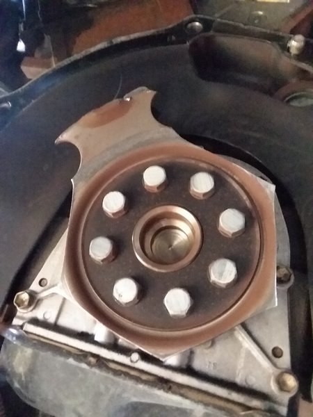

    @gearcruncher is it me or does the pilot on that torque converter look weird?

    that pilot shaft does look a little strange . just a bit too long from the pic

    Did this truck ever have a manual trans in it? Or crankshaft replaced ie: new motor? Looks like a clutch pilot bearing/bushings spun on end of tourque converter pilot.

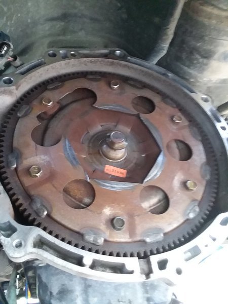

    Did the converter slide forward easily to met up with flex plate? The converter bosses were the bolts go in was there a gap between them and flex plate? Requiring the bolts to pull it closed?

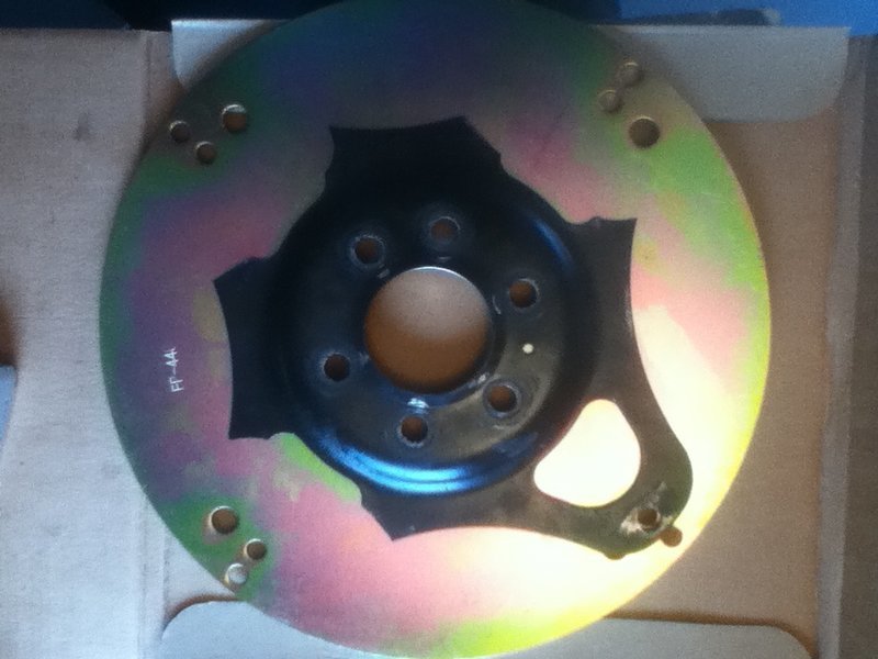

    This would be the second thread I have stumbled across (recently) where the flexplate is giving a first gen auto issues. I just read through the whole thread and I am happy to see that you managed to figure it out and get it patched up OP!

    Nice. My big block did the same. I upgraded my flex plate.

    Everything came together pretty easily. The bellhousing bumped up right against the block. The tc met up with the flexplate pretty easily too.
    I bought the truck about 6 months ago, and to my knowledge, there hasn't been any replacements to crankshaft or motor.

    Did some more digging. It looks okay compared to what info I can find.
