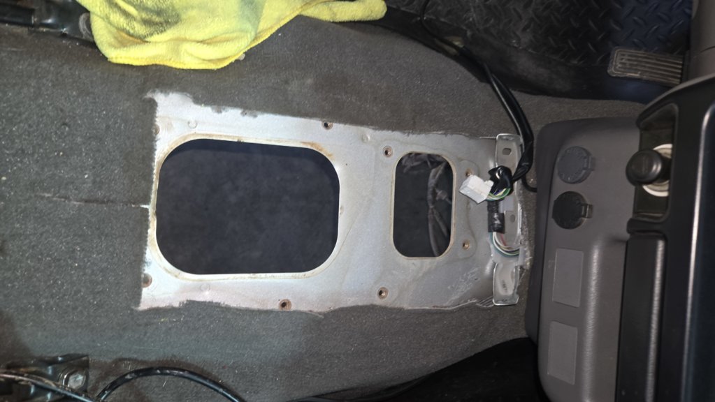

    Today's progress
    1. Pull out old ECU, install donor ECU
    2. Pull both driveshafts (not reusing)
    3. Pull T-case (reusing, twin sticks)

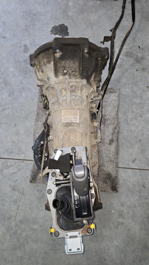

    4. Pull A340F (FOR SALE)
    I've got 2 questions to end the day. First, how did you guys template a hole for the shifters? I need to cut one large hole correct?
    Same concept second question, how do I template a hole for the clutch master cylinder? I know it's has to be pretty perfect because it doubles as the stud mounts for the clutch pedal assembly.
    Let me know! Thanks!

    Use the master cylinder to make a construction paper trace out. Then just tape it on that area that has the shape for it and drill out the holes (two mounting holes and one for the clutch).

    Do I just center it in the divot?

    Yup, that's what I did.

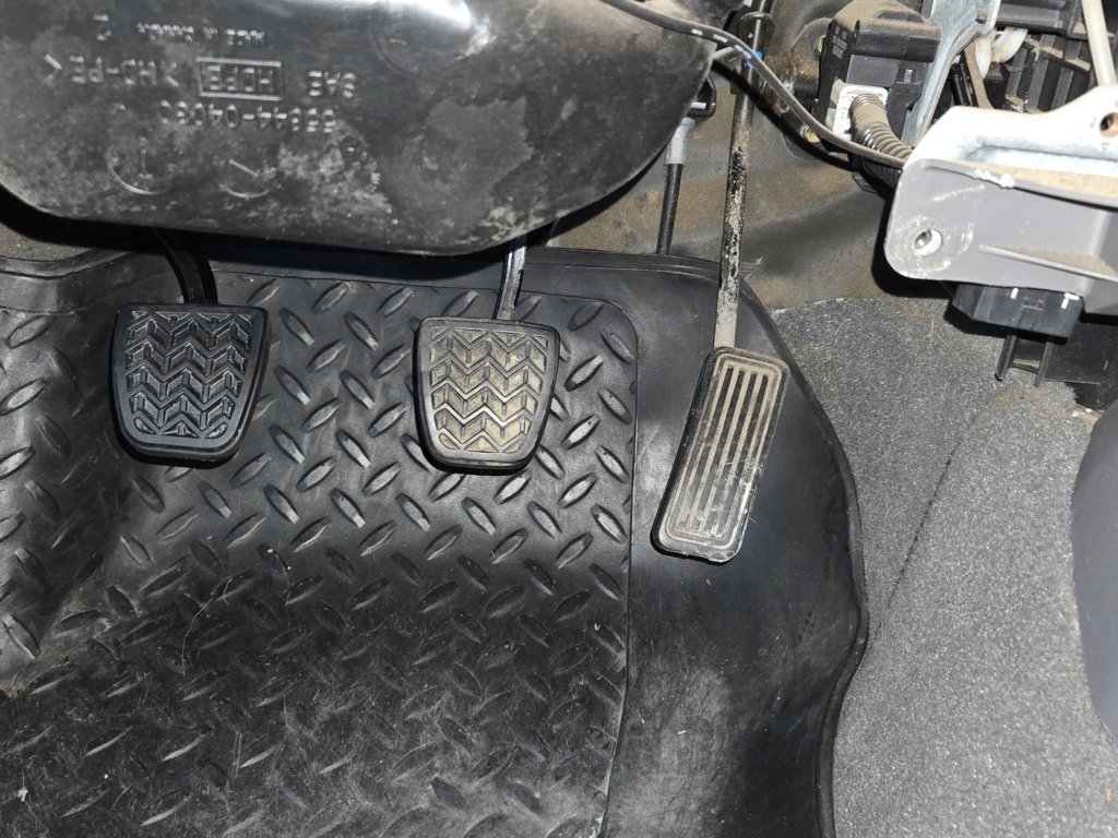

    @SafetyDang @BossFan I'm getting ready to drill my clutch master. Do you guys have any tips for keeping the pedals square?

    R150F Swap OME 1.5" Lift TG Front Bumper TG Rear Bumper Yakima XBars RC Winch J-Shift VF2 Swap
    I just checked post #7 on your thread, it looks like the clutch pedal sits lower than the brake pedal - do the brackets line up under the dash? I guess I might have a misconception that the pedals are supposed to be more or less in line
    EDIT: I wasn't smart enough to take a picture in my donor before I pulled the pedal

    If I remember correctly the bolts for the cylinder go through the clutch pedal assembly. Hence everything already lined up. It was easier than it looked.

    I do remember you might have to swap your big brake pad for a clutch sized one. I've seen other people just alter theirs to get it to work.

    That is the way they are supposed to line up. Pretty sure.

    I understand that the studs on the back of the pedal mount are the same studs that mount the clutch master on the opposite side of the firewall. I'm wondering if the pedal mount should be moved "up" in order to keep the pedals more in line with each other and, if-so, does that still allow the clutch master to fit in the divot relatively square?

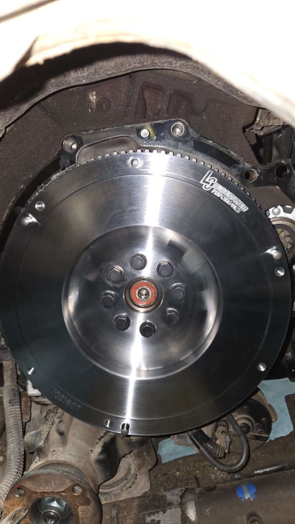

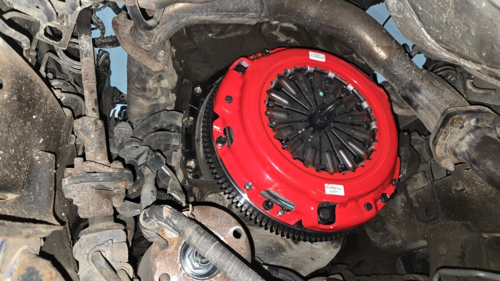

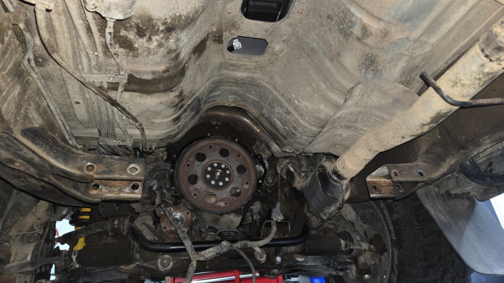

    FLYWHEEL AND CLUTCH

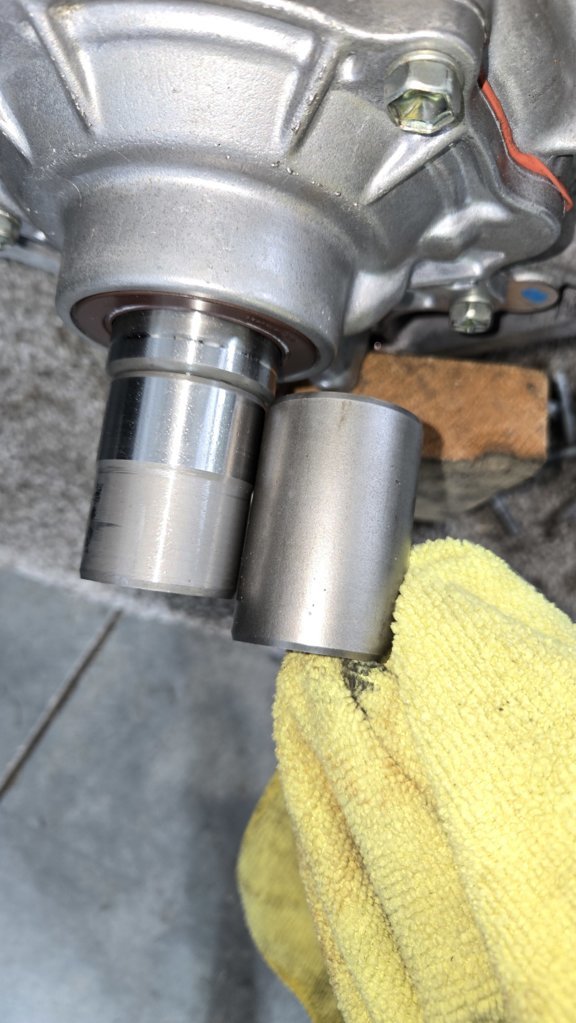

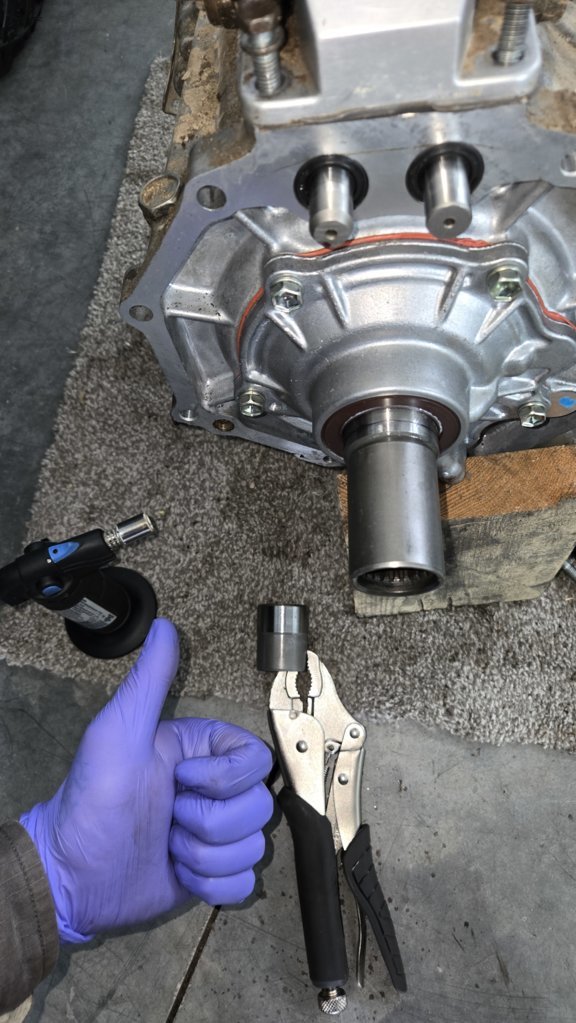

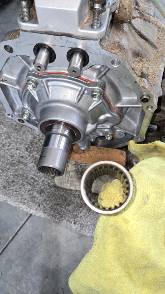

    Working on transfer case. Got my input shaft sleeve swapped from the shorter auto version to the longer manual version. Only thing left to do is clean the mating surface and seal it back up

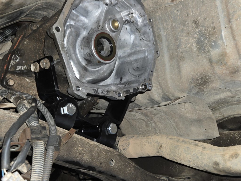

    Hi, getting the pedals to line up made me want to die :)
    @BossFan @traxman25 Trans mount fit like a glove

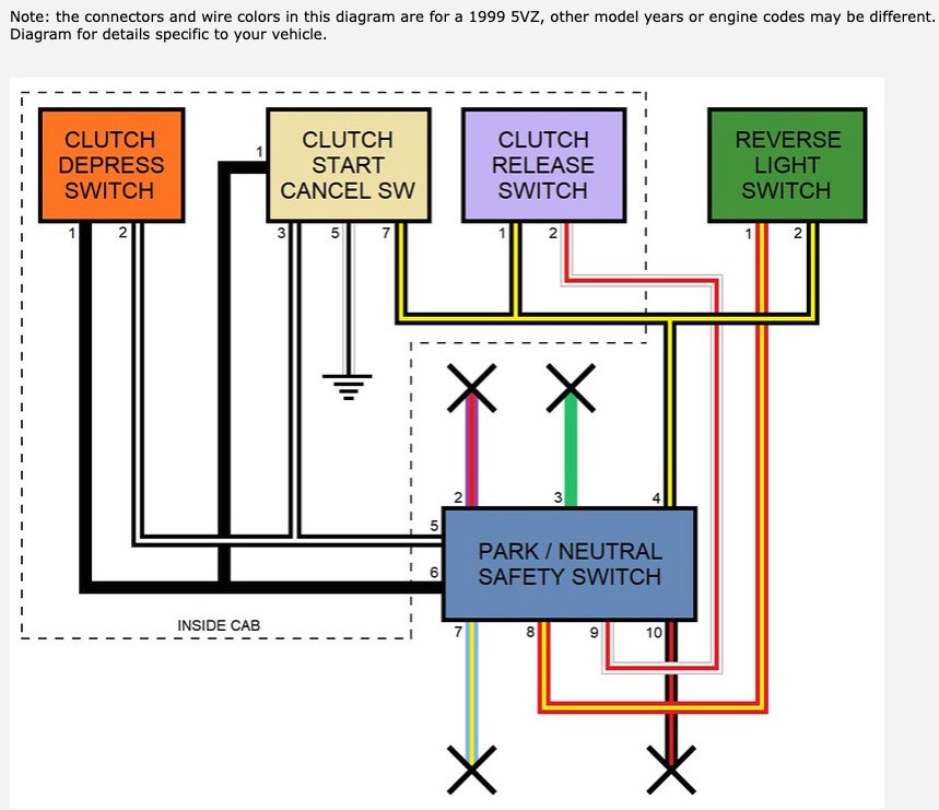

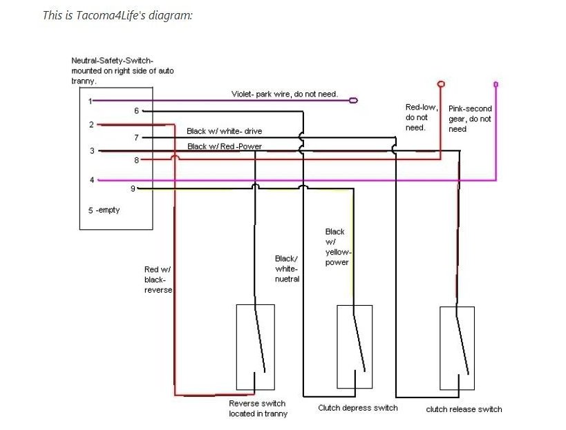

    Using the wiring diagram I got from @osterhagen build, which is also a 2003 double cab (lucky me)

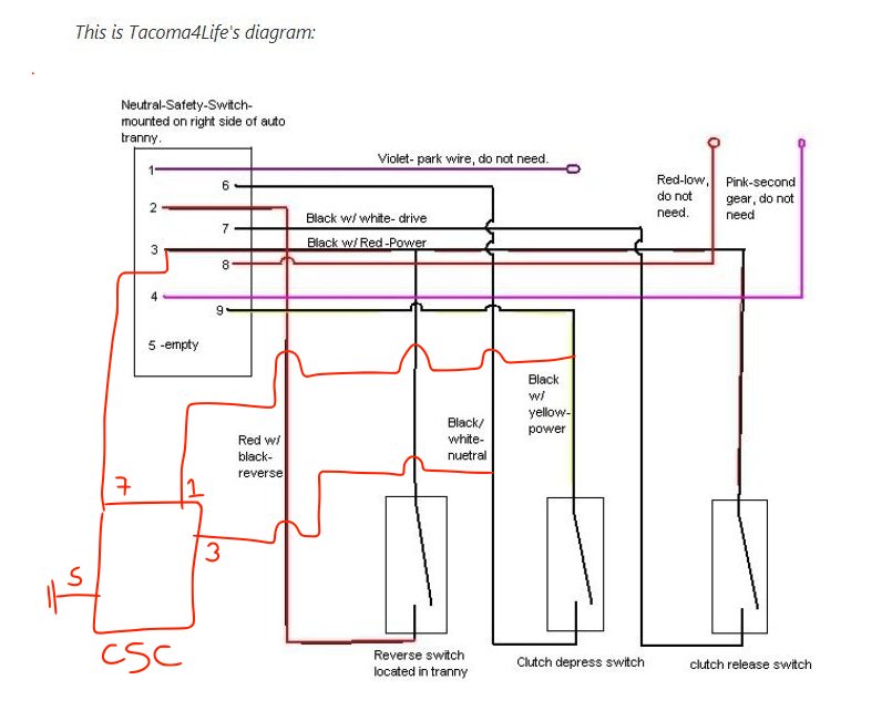

    And a diagram I found which includes the clutch start cancel from a 3rd gen 4Runner swap Screen Shot 2025-05-25 at 10.57.39 PM.png
    I have redrawn my harness to match this diagram (I am clearly an artist as you can tell)
    As far as I can tell, this wiring will complete the build from a wiring perspective. I had already figured out the reverse wiring switch beforehand, so I'll have to un-do that or re splice it to accommodate the other switches (clutch release, clutch start cancel) that needs power from the black/red wire. Wish me luck I hate wiring.

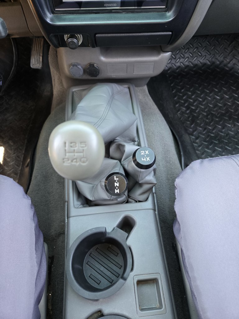

    COMPLETE, and cruise control works. Truck shifts like butter on glass

    I think the URD short throw shifter makes a huge difference. I also think that the high torque flywheel makes a difference in smoothness. It doesn't rev as fast, but damn is it smooth. It idles quiet and without shaking. The trans mount seems to be solid as can be.
    Very stoked about this result!
