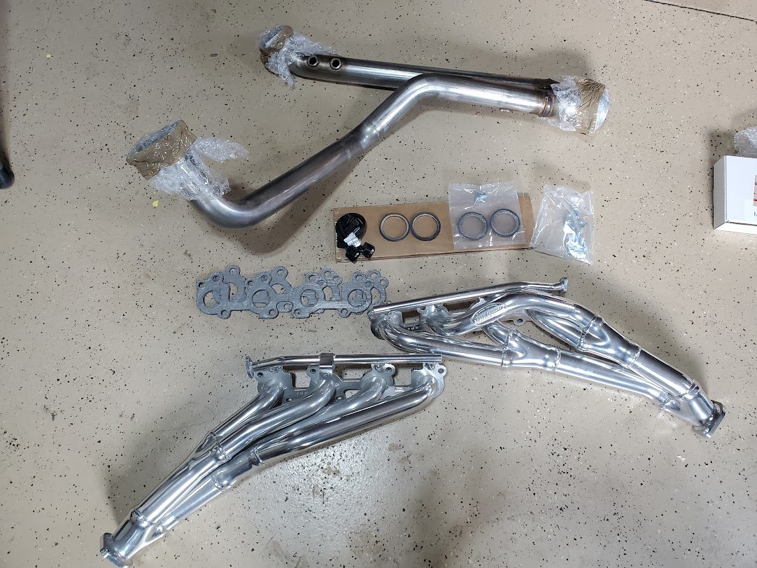

    Haven't done the headers yet. Money and time have been tight lately but I'm hoping to do them soon. @MI-FLoffroader installed his headers a couple year ago and has a small writeup on doing them in his build thread. Check his sig for that. He's not running cats either and was able to get the CEL to go ff, look like by using some extensions for the O2 sensors.

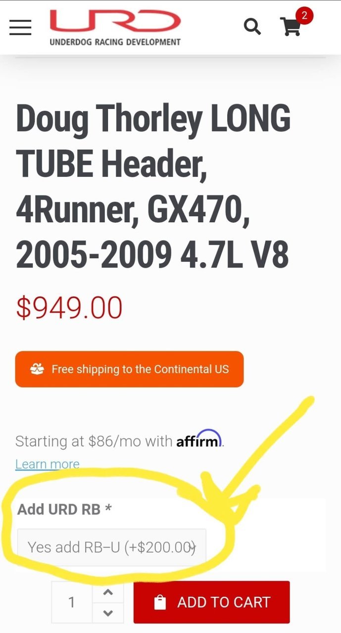

    Had DT headers, URD y-pipe (cat delete) on my GX, not sure how different it is vs a 4th gen T4R. I had a shop install them for me since I didn't want to deal with it. Purchased them from URD and they offered an O2 simulator. No CEL's or pending codes since install almost a year ago. Not sure if they still offer it or not though.

    The .gov has clamped down on o2 signal modifications, so finding one might prove difficult. URD sold their version called an "o2 sensor calibrator" but they had to stop selling them I believe.
    The "mini cats" as people call them are nothing more than a right angle fitting for your o2 sensor.
    They have a small amount of metal material in them that tricks the sensor.
    They have been getting harder to find also.

    Yeah, URD no longer has the o2 calibrators available. Haven't check for the right angle fittings tho. I was just looking at the DT Y-pipe and thinking of cutting the resonators out (interesting that the y-pipe that @Gen1FTMFW had didn't come with the resonators) and replacing them with cats, and moving the O2 sensor to after those.

    I got the URD y-pipe. Wish I had seen that the DT version comes with resonators. Email OV and see if they have anything. I reached out and they didn't support mine at the time but said they were working on it. If they know there is interest, they might work on something...

    Also, if it is something that you're serious about, I could get the OVTune and sell you my O2 simulator/calibrator.

    The URD y-pipe is pretty pointless and only results in rasp. Unless you have a turbo or supercharger maybe. No, URD no longer sells any goodies. Been scared into submission. I don’t know what they’re good for anymore, all that’s left from them can be had else’s for less.

    I don't know about being scared into submission, heavy fines incurred to sell a product doesn't make good business sense.
    My 5th gen URD Y pipe works well. I guess the V8 Y is not so good. Considering how unbelievably restrictive the oem Y is, I would take the rasp.
    The Thorely Y I bought for my V8 didn't match up to the headers, so it had to be cut and clocked to the proper angle. Sounds good, but I can't recommend it because of the misalignment.
    Keith Carty/Dirty Deeds sells Tundra exhaust for the 2UZ, he might have an idea of what works for a Y. All of these companies might be getting pressure from the gov though.
