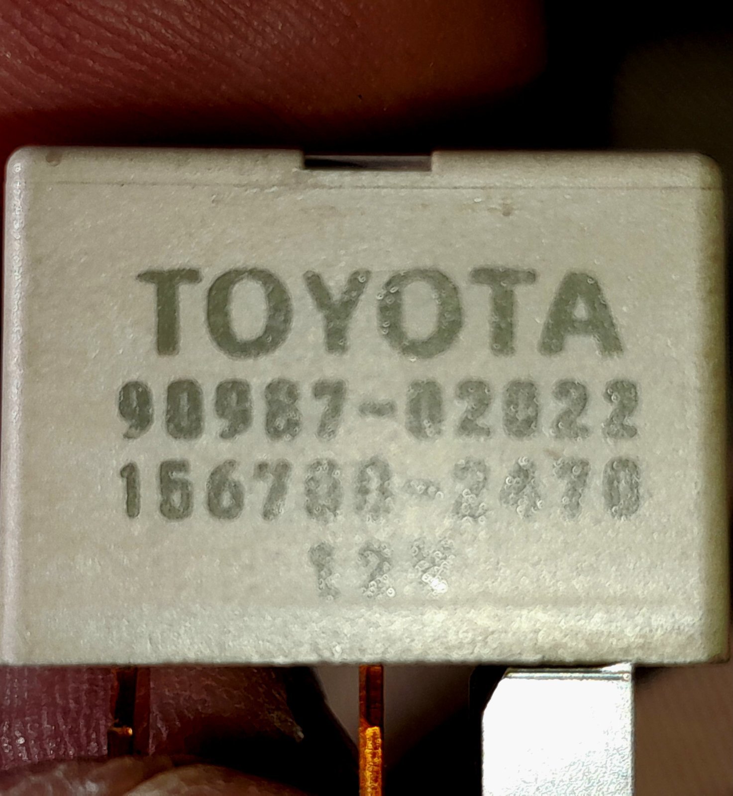

    Annnnndddd, the AC has acted up a couple times lately, with the dash light blinking at me on starting the truck. Turn it off and back on again and it seems to work fine after that. So, I might need to look at replacing the compressor at some point. Hopefully it makes it through this summer. It's already been sitting over 100 degrees for the last few weeks here in Tucson. Hit 110 while I was doing the CV boot in the garage today. Sweatfest. Yuck.

    My AC Relay in the fuse box under the hood took a crap when I was in Parker AZ last February.
    Not a big town, but the local Autozone had one in stock.
    From what I understand they can start to cycle when they go bad.
    xtremewlr[OP] likes this.
  13. Jul 5, 2024 at 7:04 AM
    #713
    xtremewlr
    xtremewlr [OP] Well-Known Member
    Oct 25, 2018
    #270626
    8,390
    Todd
    Tucson, AZ
    2003 4Runner V8 - 2012 b00sted XRunner
    I have mods
    Might try changing that out then. Good call, thanks.

    Replaced the relay, OReilly's had one in stock. Hopefully that's all the AC issue was.

    Side note on this specific relay. Toyota had a TSB for it (https://www.tsbsearch.com/Toyota/EL011-05) and the part number was replaced with 9098702028. I guess the relay is known to be faulty sometimes, although mine lasted 347K. 5 other relays in the fuse box are identical as well.
