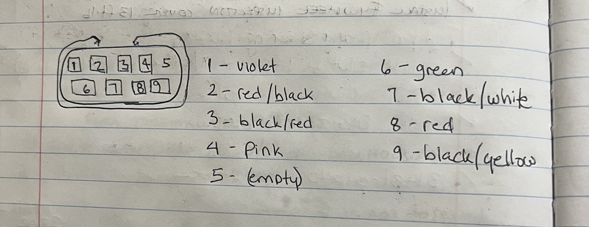

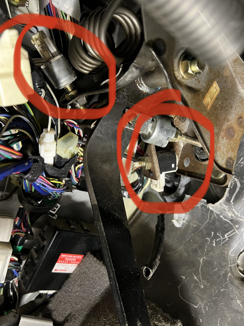

    Does anyone have a 2003 wiring diagram so I can figure out how to wire in the two switches on the clutch pedal. I know one is for canceling cruise control and one is a start safety switch. 718AD78C-D677-44B4-A3B1-D842198E14F8.jpg
  2. May 2, 2023 at 8:20 PM
    #182
    drr
    drr Primary Prognosticator
    Oct 17, 2013
    #114681
    2,730
    Dan
    Seattle-ish
    02 4WD Tacoma
    It’s pretty simple, the wires for those two switches as well as the reverse sensor on the transmission all come from a single plug off the automatic trans harness. If you haven’t read through this thread, it details it really well in post #95:
    https://www.tacomaworld.com/threads/yet-another-dc-manual-swap-thread.661925/page-5
    The one part that threw me off and I had to redo to get it figured out is that there are two black with white stripe wires on that plug - one goes to the top switch and one goes to the bottom switch on the clutch pedal, and it matters which goes where. So pay attention to which position the wires are pinned in the auto trans plug and mark them before you cut anything. Let me know if you have any questions.

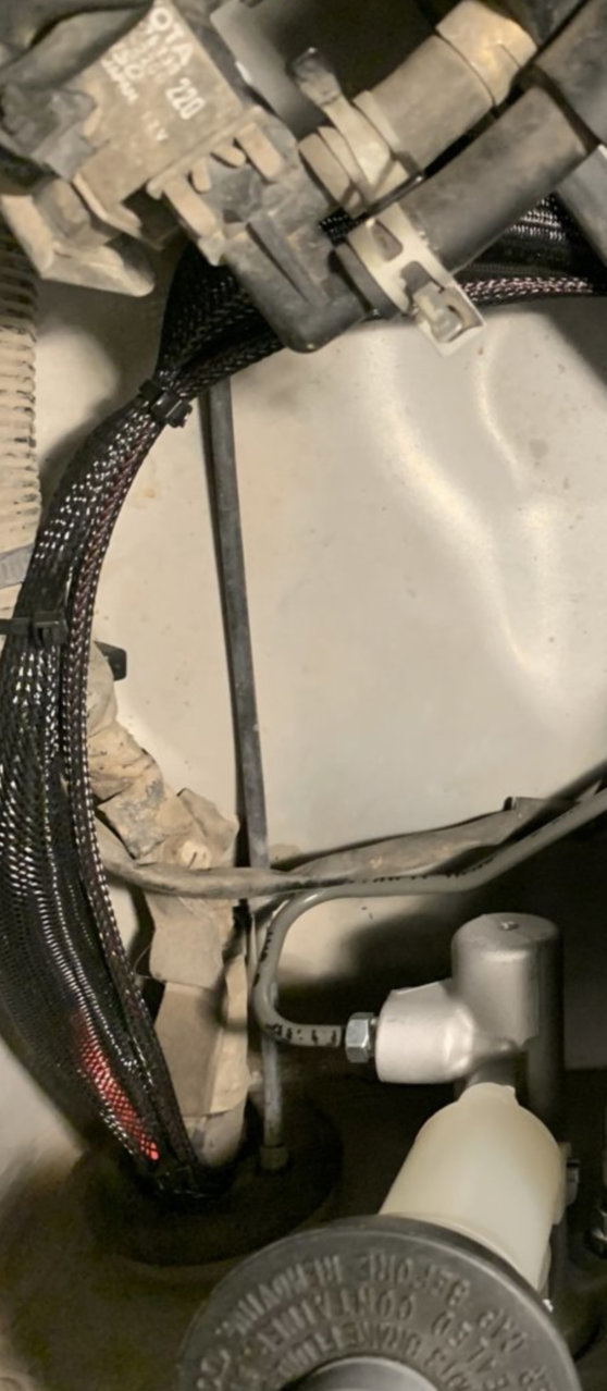

    That post #95 is a good one. Thank you. In one of his photos, he shows how he used the pre-existing grommets in the firewall to run his wires into the cab to connect to the clutch. It looked like he had some kind of single-wire loom for each wire. Do you know what this is actually called?

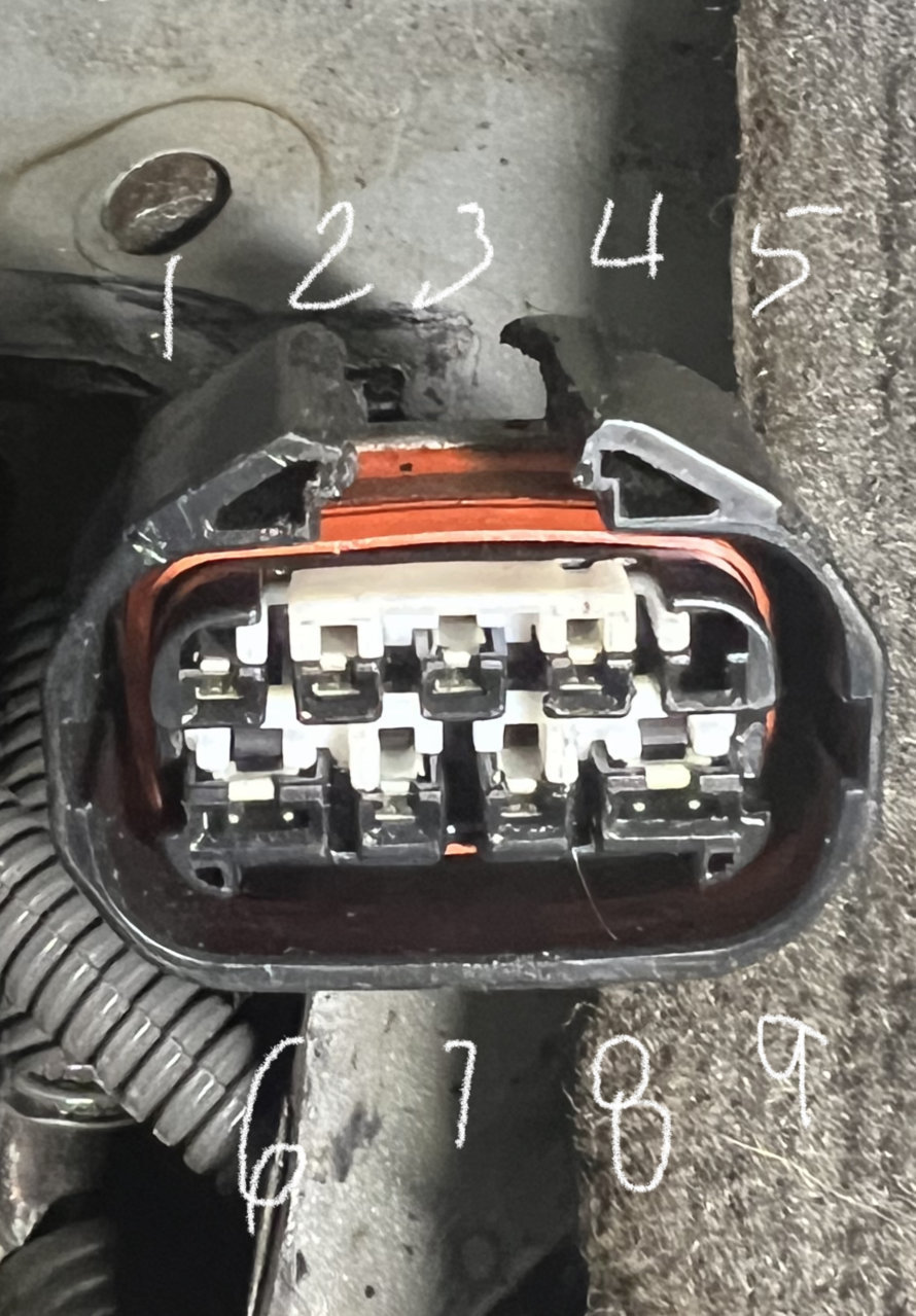

    So I compared my automatic NSS to the diagram in that post and found one difference. Spade 6 on my plug is GREEN but in the diagram it shows Black w/ White. Do you think it is still the Neutral switch?
    697D2069-DF78-4389-90D4-35C7F8AD178E.jpg B292204F-EABF-4994-BEE1-65F36D925142.jpg
  8. May 3, 2023 at 4:38 PM
    #188
    BossFan
    BossFan [OP] Well-Known Member
    Jan 31, 2015
    #147590
    551
    Frank
    NJ
    03 TRD 4x4 X-Cab MT swap
    Tundra brakes Bilstein 5100s OME springs
    Also, regarding the two clutch switches. My understanding is that the Clutch Depress switch is the one closer to the firewall, that let’s engine start. The Clutch Release switch is closer to driver and that is the cruise control cancel switch. Do I have that right?
    And the black/red power wire (#3) goes to both the Clutch Release and the Reverse switches.
    Is there a special technique to depin the automatic neutral safety switch? And could I just depin the wires I need and then place a ziplock bag over the switch, zip tie it to the trans/body?

    I just reread that other post #95 and he said all of his wires matched the diagram except one. He didn’t say which one, but when you look at his depinned wires, he has a GREEN one as well. That makes sense considering his truck was also a 2003.
  10. May 3, 2023 at 6:00 PM
    #190
    drr
    Oct 17, 2013
    #114681
    2,730
    Dan
    Seattle-ish
    02 4WD Tacoma
    Yes you have the switch orientation correct. I just cut the whole plug off the harness, I’m not planning on putting an automatic back in my truck.

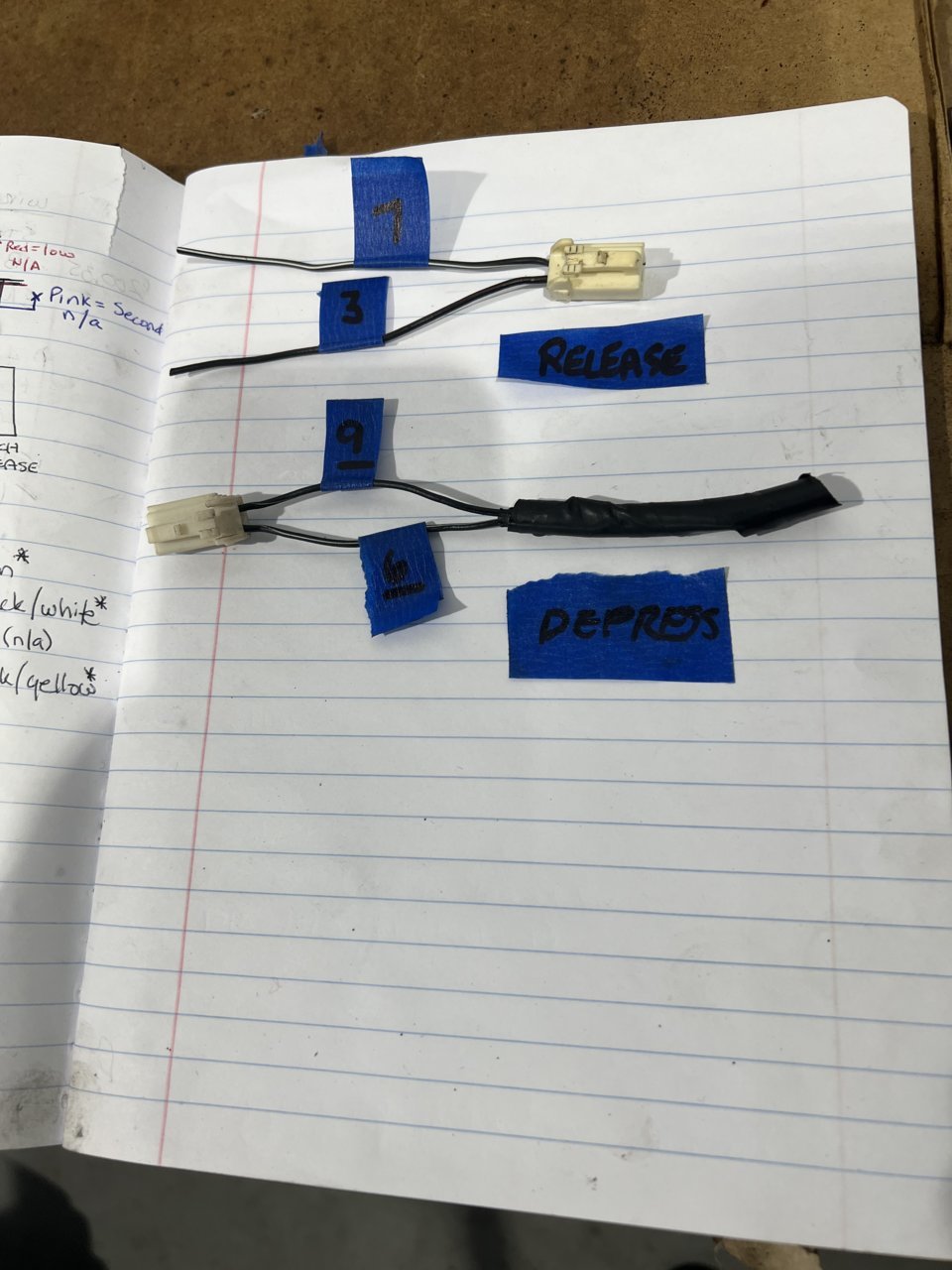

    Figured out how to depin the connector. Labeled all my wires and connectors. I just don’t have any thin wires or small butt connectors to do the wiring yet.

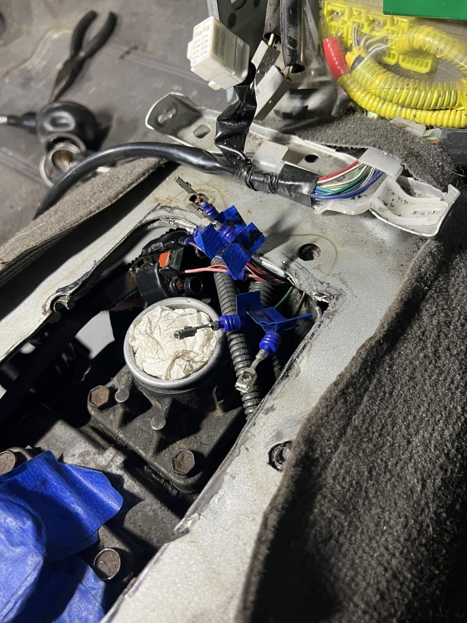

    Since my wiring reaches up to trans tunnel, can I just run the wires from there behind dash to clutch switches? Or is it better to have them come through firewall near clutch pedal?
  15. May 4, 2023 at 5:36 PM
    #195
    drr
    Oct 17, 2013
    #114681
    2,730
    Dan
    Seattle-ish
    02 4WD Tacoma
    Interesting, hadn’t thought of running them up through the tunnel. Don’t see why not, that’s basically where that wiring harness has to run anyway.

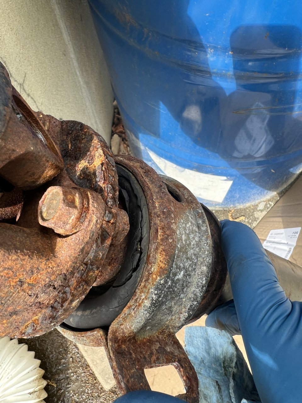

    I ordered this connector to see if I could replicate the auto NSS and keep all 5 of the manual trans wires sorted.
    I also ordered a new carrier bearing b/c as I started to clean up the manual trans driveshaft I noticed a large split in the rubber.

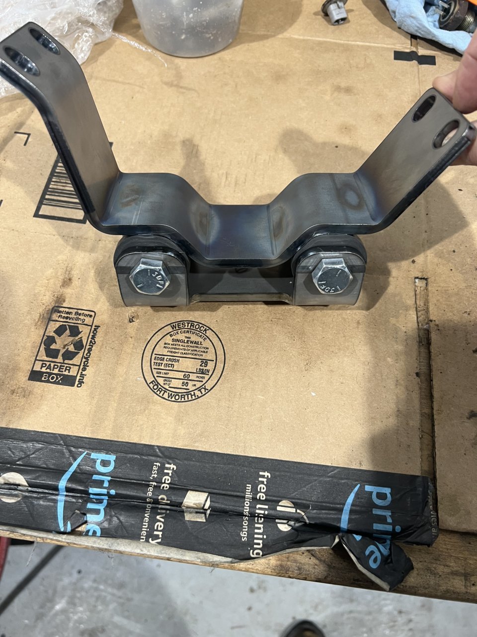

    My new solid transmission mount from @traxman25 arrived. Here she is in bare metal. Almost too nice to paint.

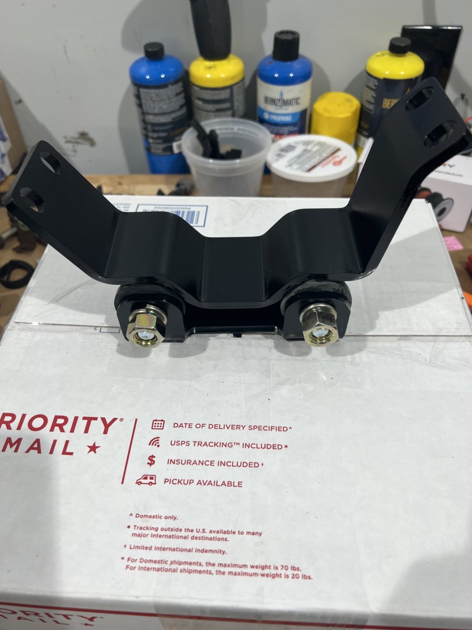

    and painted.

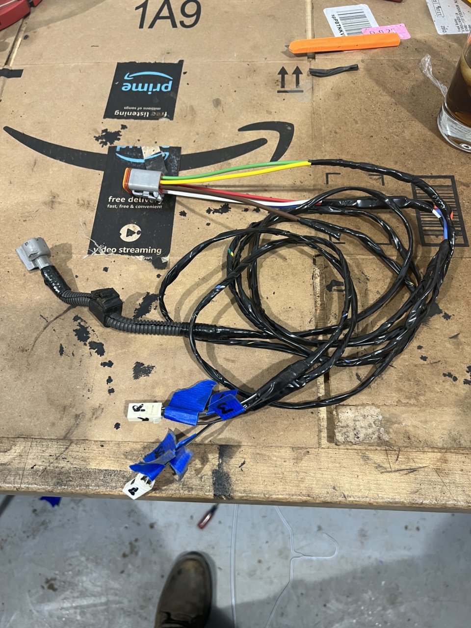

    I made up my manual transmission harness today.

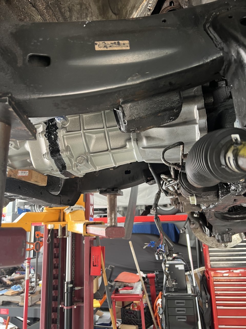

    I did another test install of the crossmember. Going to work on getting the headers and y-pipe installed this weekend.
