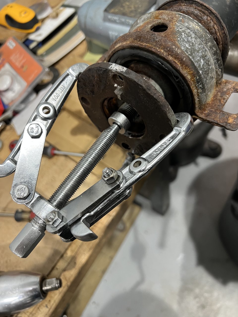

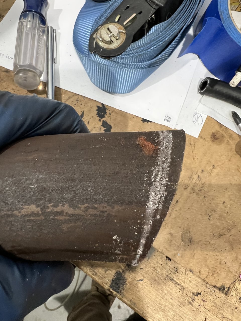

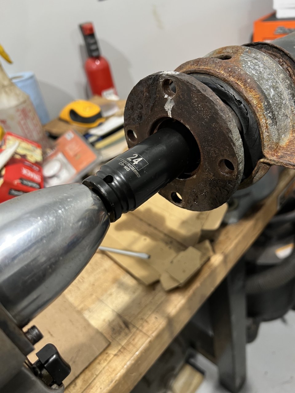

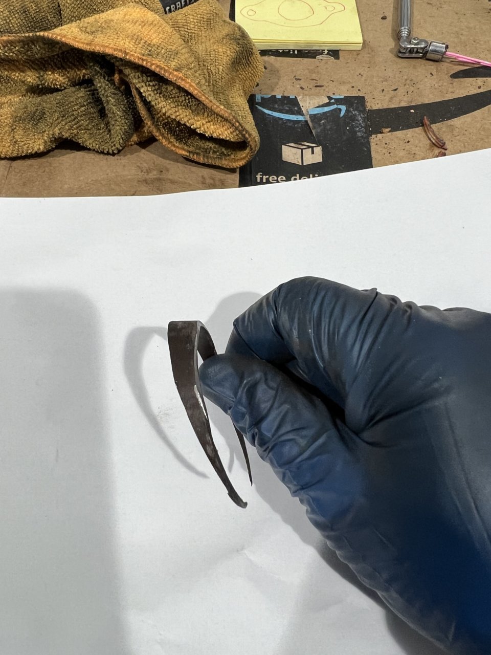

    Got my driveshaft apart this morning for new carrier bearing. I followed the old post from @TacomaJPP. Took a bit of “effort” to get the two shafts separated. .
    C7C10B42-53AA-4E17-9D96-EE77ADAFD1A0.jpg 6363BC4A-620A-435B-B449-58B3302F48A2.jpg 51537000-A338-4731-8B8C-438AAF81412F.jpg 90FF24F3-58DB-48CA-BC5E-1A2B14A79DA3.jpg

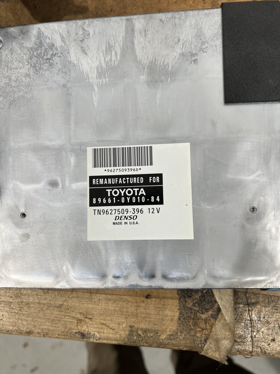

    Picked up my new carrier bearing and manual ECM yesterday. Carrier bearing is straightforward but would it be better to get the truck running again before swapping in the new ECM? I know @drr said he was running his manual conversion with the computer from the automatic. I thought I would just focus on getting everything sorted mechanically and then swap out the ECM. Thoughts?

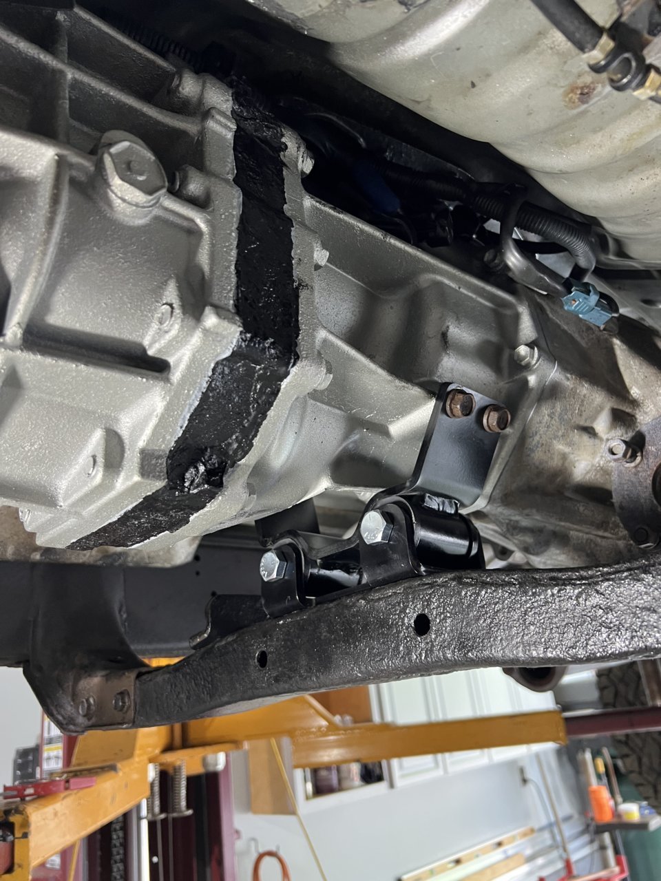

    013B3605-904C-49FB-8482-8C43BB5D6635.jpg 9F31CCA4-2406-4E46-96A3-901F0994A135.jpg FF53214C-9B5F-4829-84ED-303C8F2A55D6.jpg A79030B6-6809-4F99-A153-D6F57FE3FD79.jpg Weekend update. I got my manual ECM installed and all my clutch wiring installed. I filled the clutch m/c with fluid, but didn’t bleed it yet. I also found all my battery cables/alternator wires wrapped up in loons and installed. The transmission crossmember and HD trans mount are all torques to spec. I cleaned up my y-pipe, tightened up the headers, and did a trial fit of the exhaust. I think I didn’t leave enough metal on the front of my cat, but my buddy thinks we can fill the gap with weld.

    Is there any special trick for installing the shifter and rotating the ‘locking’ groove?

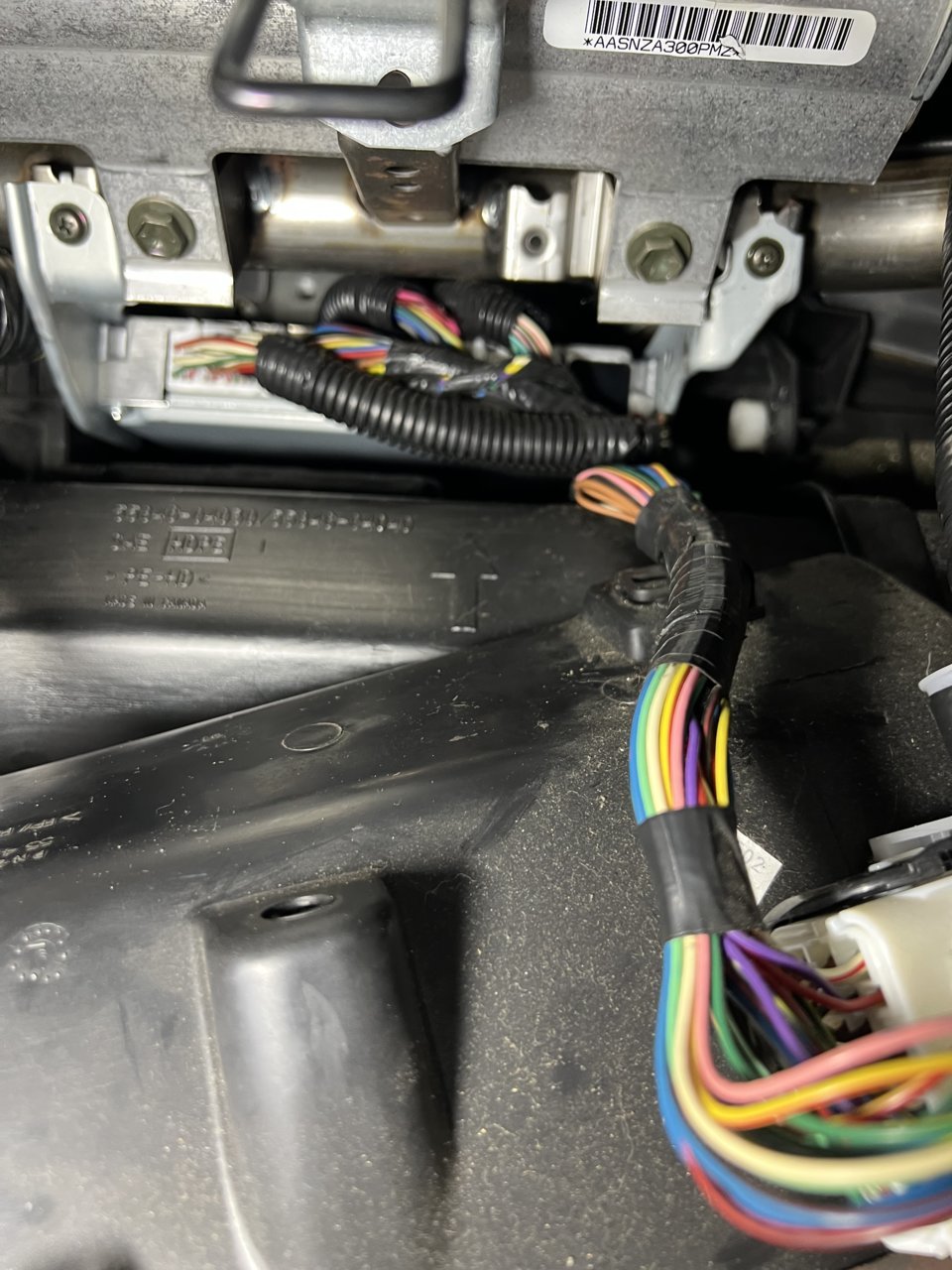

    Weekend update:
    • got all the clutch/cruise wiring connected.
    • shifters installed. I mistakenly installed the t/c shifter from the automatic and couldn’t figure out why my shifter knob was backwards Doh!
    • Power steering pressure switch finally came so was able to reassemble everything up top
    • Big 7 (actually Big 4) battery cables
    I was able to start the truck and it fired right up (with clutch pedal depressed). I tried starting it with clutch in ‘released’ position, and it wouldn’t start, so I know the neutral safety switch is wired properly.

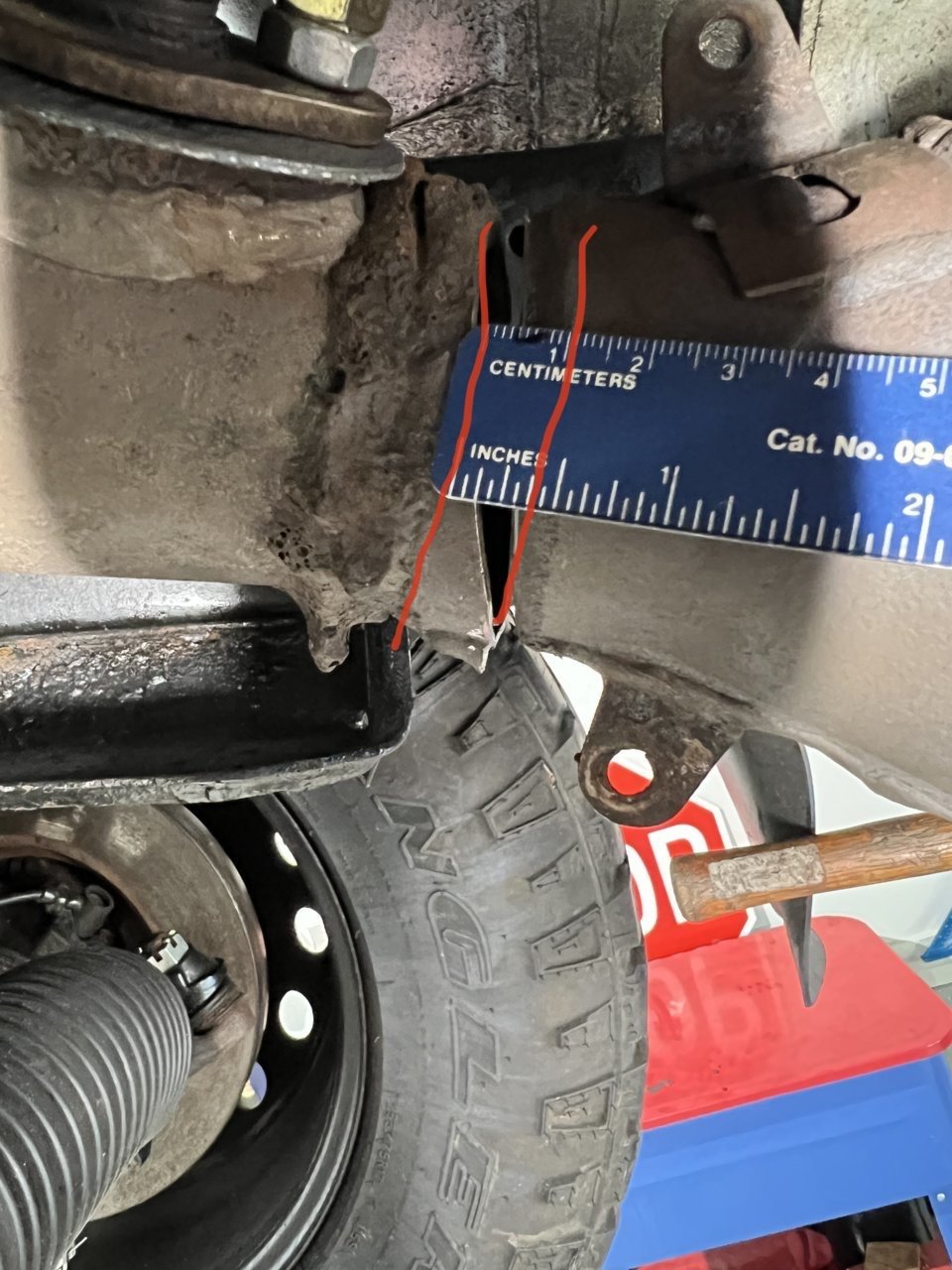

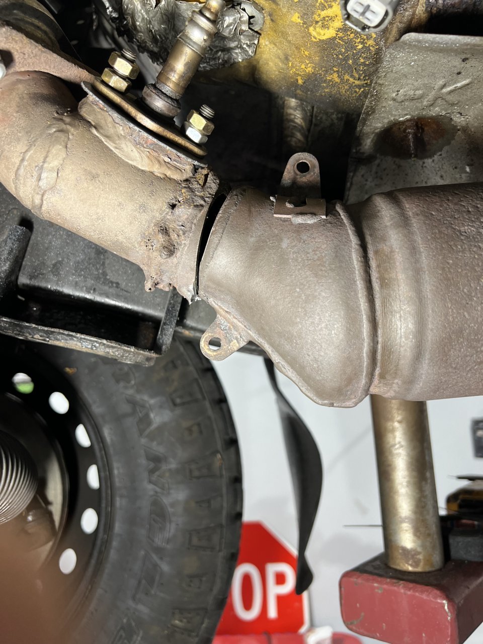

    Regarding the cat welding, there is a 70 mm gap between the cat and the header y-pipe (why didn’t they just make the y-pipe with a flange!). I’m a hack welder at best but I don’t think that gap can be bridged. I was thinking of trying to cut a small band of exhaust pipe and use that as filler? Do you think that would work?
    I was thinking of getting a slice out this pipe and using that as filler:
  9. Jun 4, 2023 at 7:40 AM
    #209
    drr
    drr Primary Prognosticator
    Oct 17, 2013
    #114681
    2,731
    Dan
    Seattle-ish
    02 4WD Tacoma
    The two surfaces need to be flat and parallel to each other. Looks like there’s gap in some places and interference in others. Now would be the ideal time to put flanges on, they will take up the gap after you straighten those cuts out and allow you to weld each side separately and then bolt it together.
    https://www.summitracing.com/parts/sum-626013
    Something like this.

    Here’s what I was thinking

    oh. Ok. I didn’t see your response until I posted. That works too! Let me do some measuring for diameter

    Another option is run stringer beads on both sides till they meet in the middle . what we did in the field on poor fit up joints.
    I would not try adding another piece if going that route get a piece that fits inside both ID`s weld that in place .
    Flanges should be easy to find new I bought new ones from walker exhaust a few years ago.

    I got the cat welded in. I did a hack/temp job just enough to get it to my buddy’s shop. I’m going to ask him to cut it off and weld on the flanges I got from Summit.
