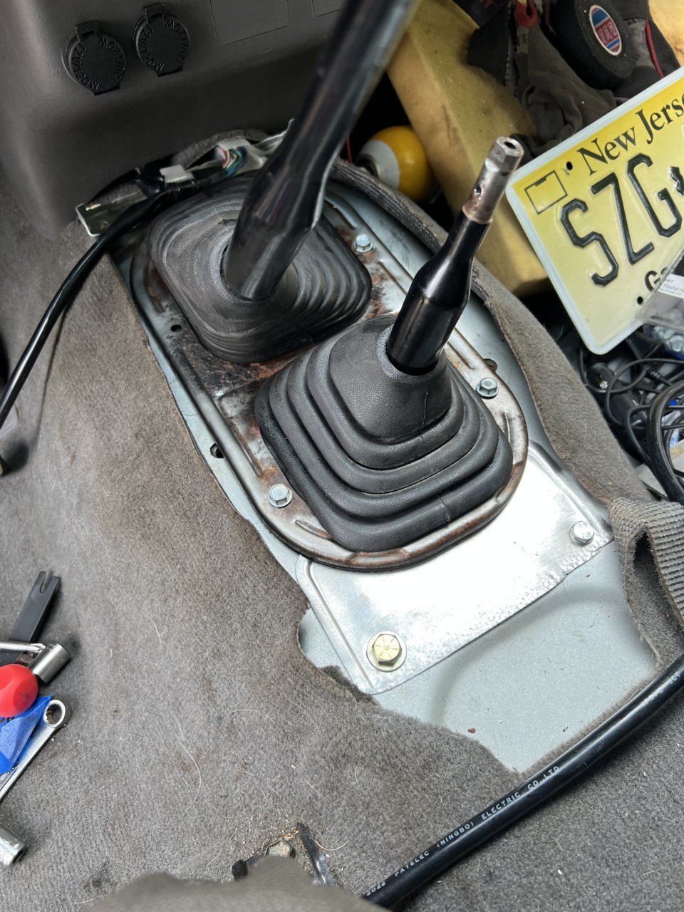

    Like you, I did all OEM. The slave cylinder, hydraulic lines. I did upgrade to the Marlin Crawler braided line to replace what would’ve been an OEM rubber line, but basically every else, including the ECM came from a Toyota for the transmission swap. Even the clutch parts. The flywheel is a Marlin Crawler one, but only b/c the guy I bought my parts from had done that swap a few years back. I had it resurfaced.

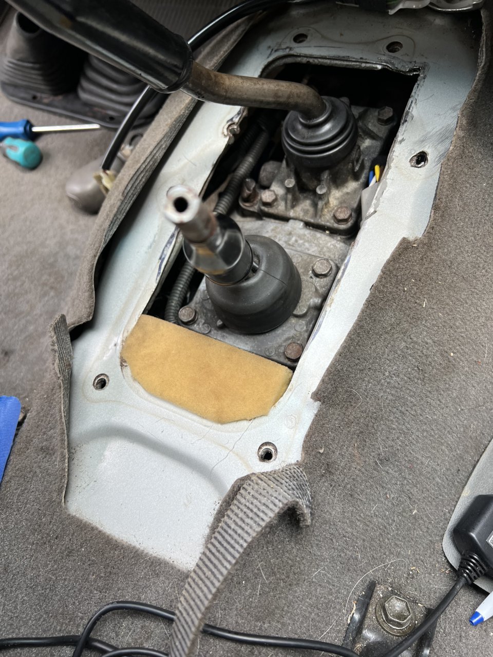

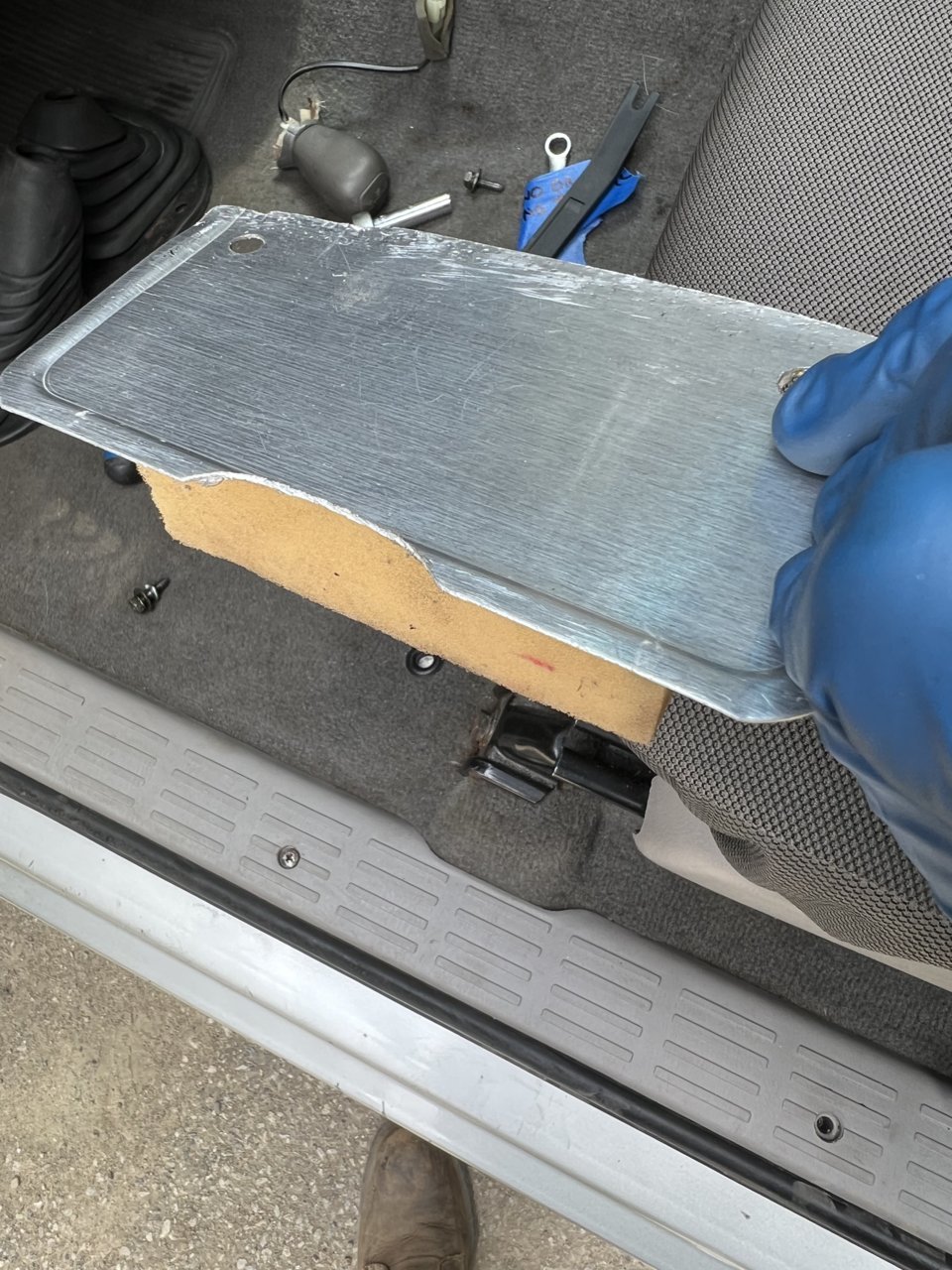

    To fill the gap in the trans tunnel, I used an old license plate and the used 3M adhesive to stick the foam to the plate. I bolted that into the existing holes where the automatic shifter bolted. Cleaned everything up and reinstalled my console and the manual shift boot. I took it for a drive around the block. :). Still needs an alignment and I think a better clutch bleed.

    This is the gap I wanted to fill.

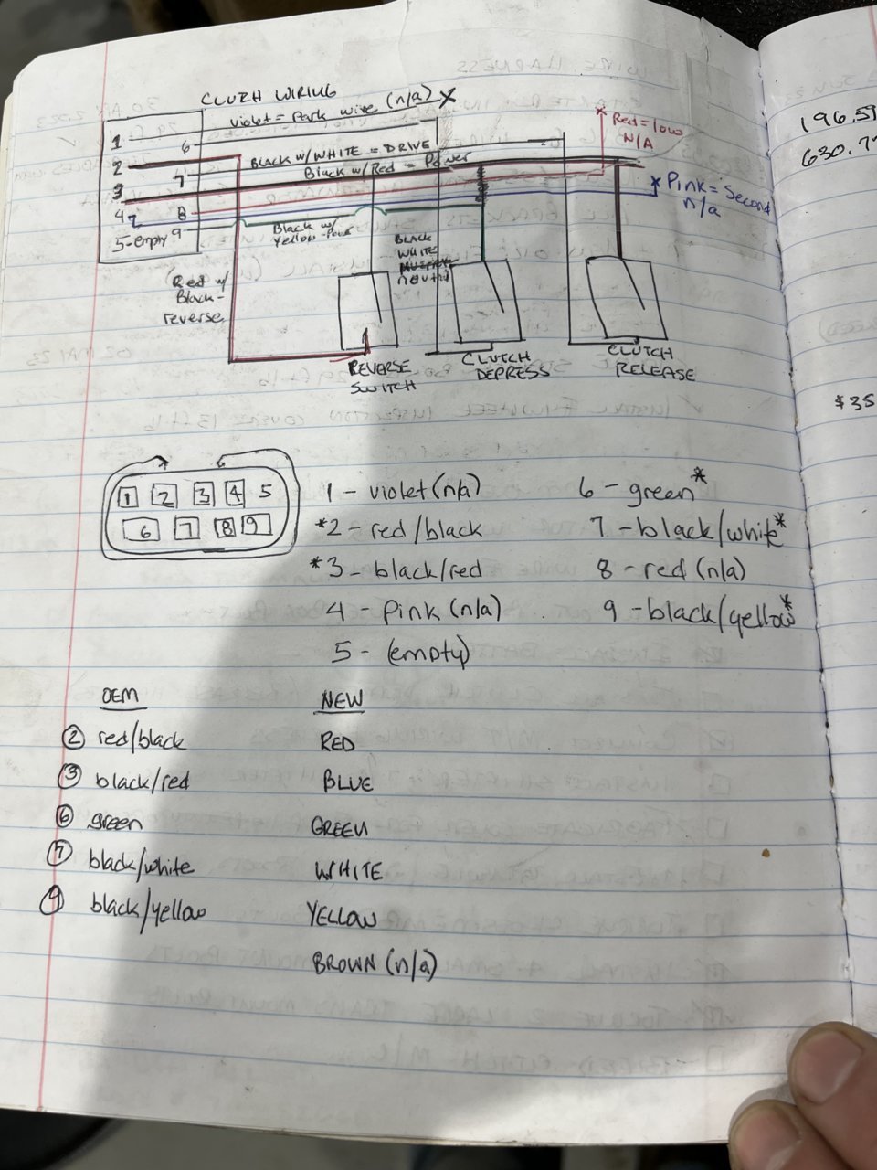

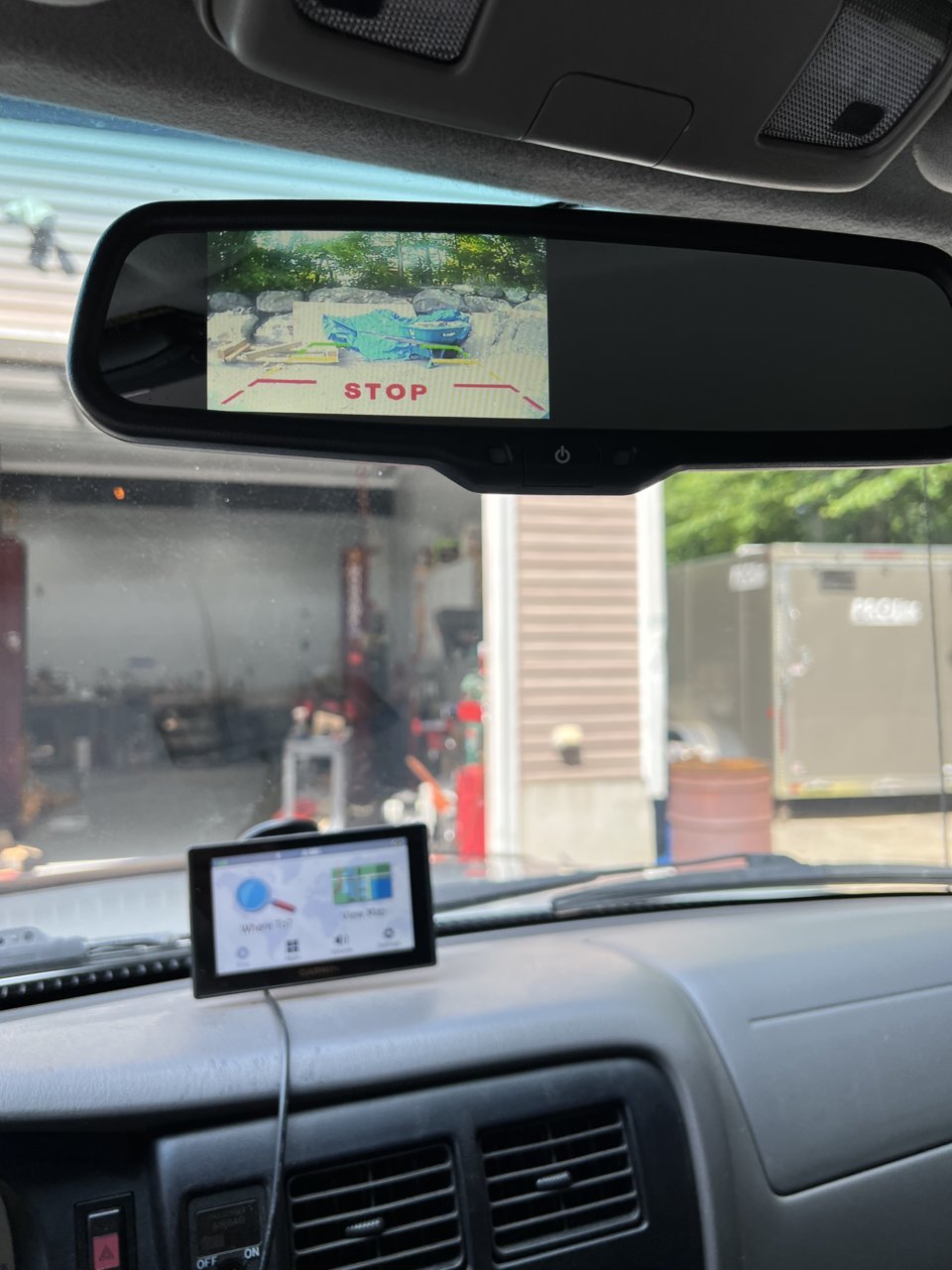

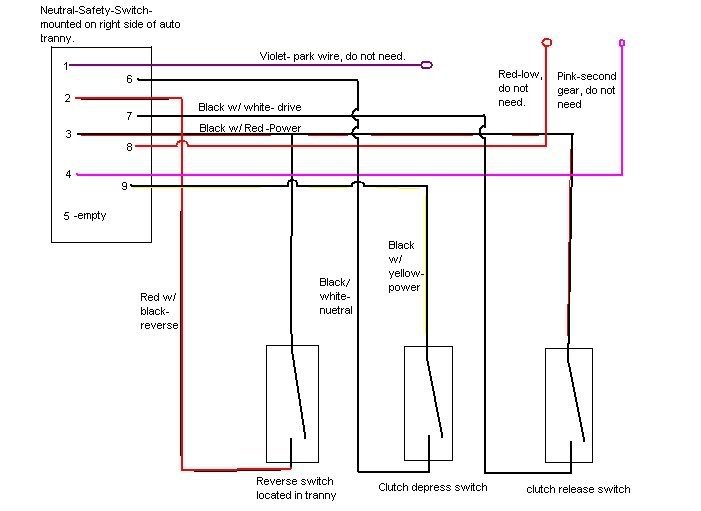

    The wiring wasn’t bad at all. You just have to follow the diagram. I depinned the automatic neutral safety switch and even bought wiring and a connector that was a close enough match in factory color.
    I don’t know if my reverse lights work yet, but my neutral start switch works and even my aftermarket backup camera works I was also intimidated by the wiring, but I marked every wire with a piece of tape and a number.4EF161D4-5105-49C6-989D-753DFD41C000.jpg

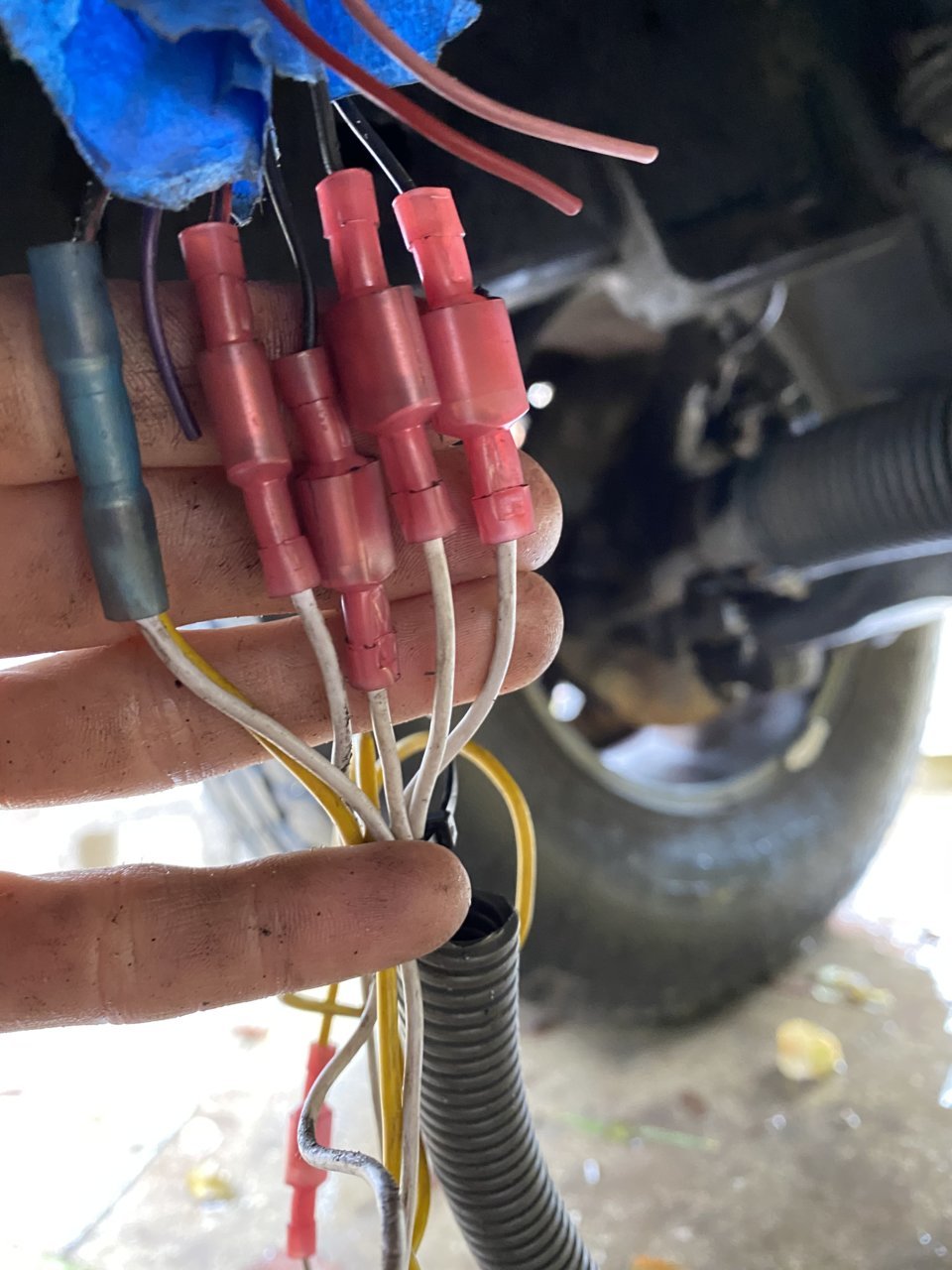

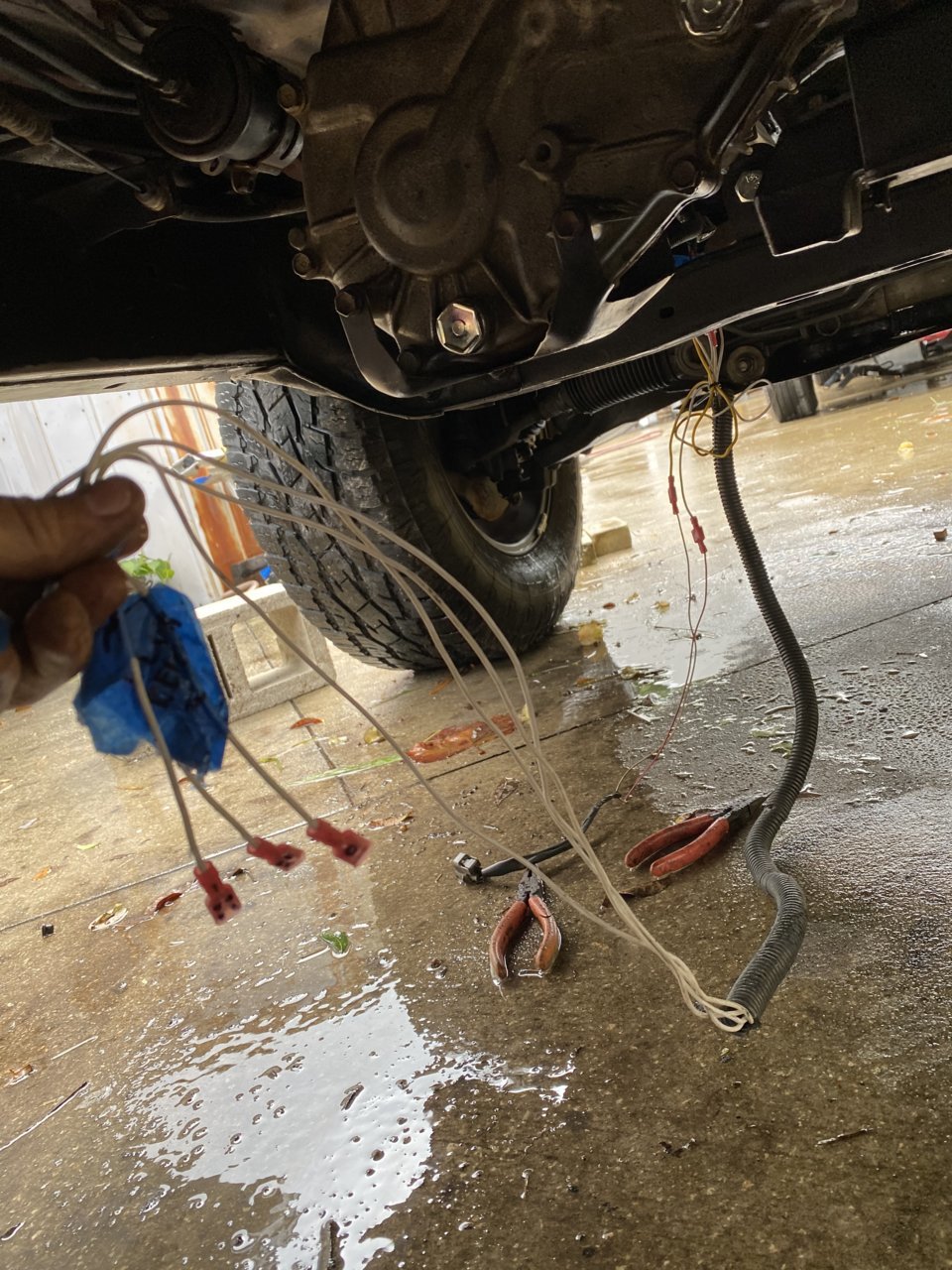

    The wiring diagram that Bossfan posted is the exact one I used, I finally found the picture that I used. I forget where I got it from but it is the easiest diagram I have found. Also here is some pics from my swap of the wiring, now I hate electrical stuff and didn’t do the prettiest job of it but it hasn’t given me any problems since 3 years ago.
    So for the wiring I ended up just using some 16 or 18gauge I had laying around to run from all the switched back down by the trans where the loom is that has the wires in it you need to connect, I know I used all white but I labeled them as I installed them but I probably fucked up being that I will have a hard time finding out what is what in the future if I ever have to disconnect it.
    Also I did this swap outside and half of it was done in the rain at 10pm because it is my daily driver and didn’t really have a lot of time to wait on weather haha. But being under the truck most of the time keeps things dry other than the ground lol

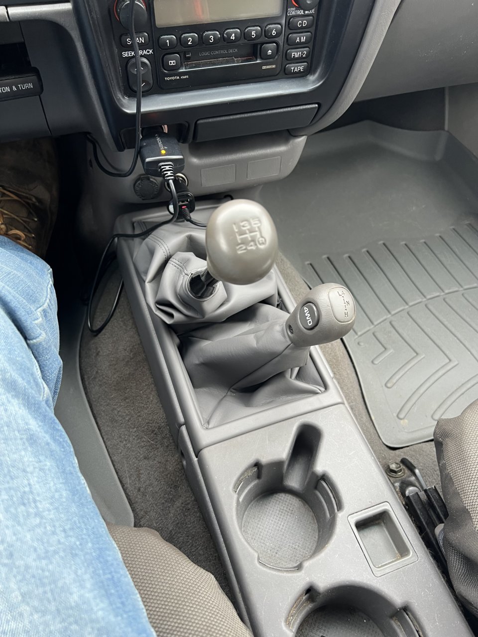

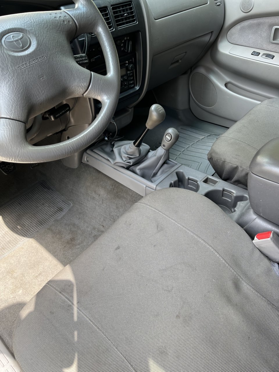

    IMG_3103.jpg Got the truck back from my buddy’s shop today. Had him do the alignment, weld up the exhaust better and also install a new set of JBA UCAs (I should’ve ordered them when I had the front end all apart). I drove the truck about 100 miles today. Shifted nice. I can say this project is done, except I still need to get new swat bar end links and put the sway bar back in. Could not have done this without the help of the TW members on this forum. Thank you all so much!
