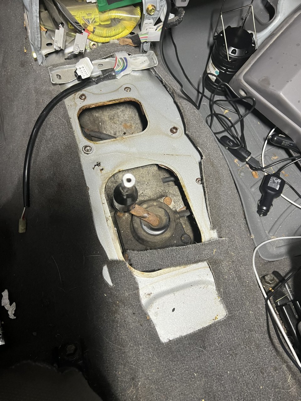

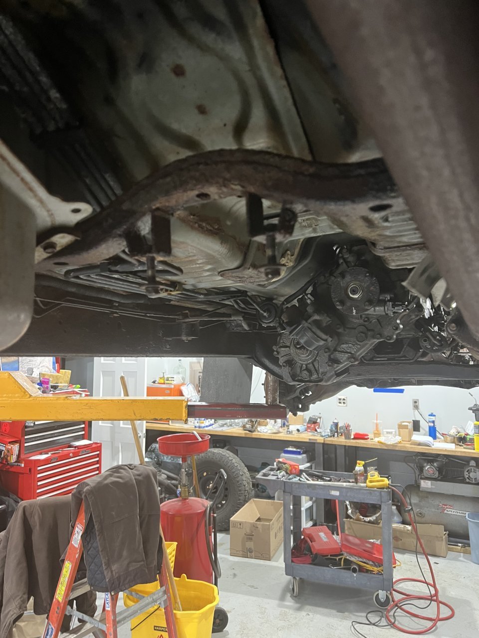

    Progress update.
    • Removed rear driveshaft
    • All electrical connections
    • Drained trans
    • Removed inspection cover
    • Removed auto shifter (all 8 bolts broke)
    • Loosened 3/4 trans to trans mount bolts
    • Tried removing trans lines from trans but that won’t work, will have to cut lines0FE60C93-0A7E-4164-BF96-B4B19EA4019A.jpgE9E12F71-7EC4-4239-9C71-67DFF019E473.jpg

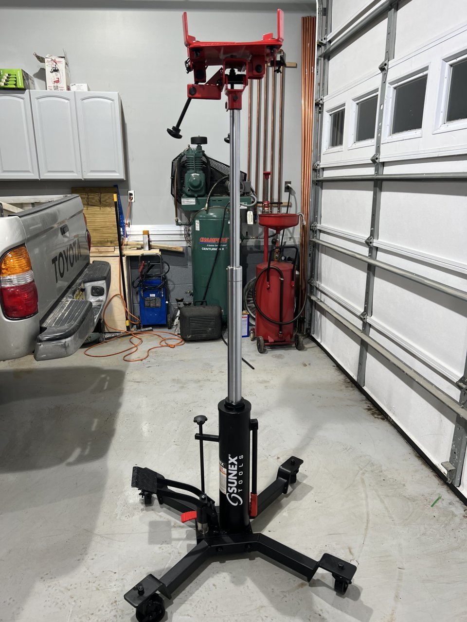

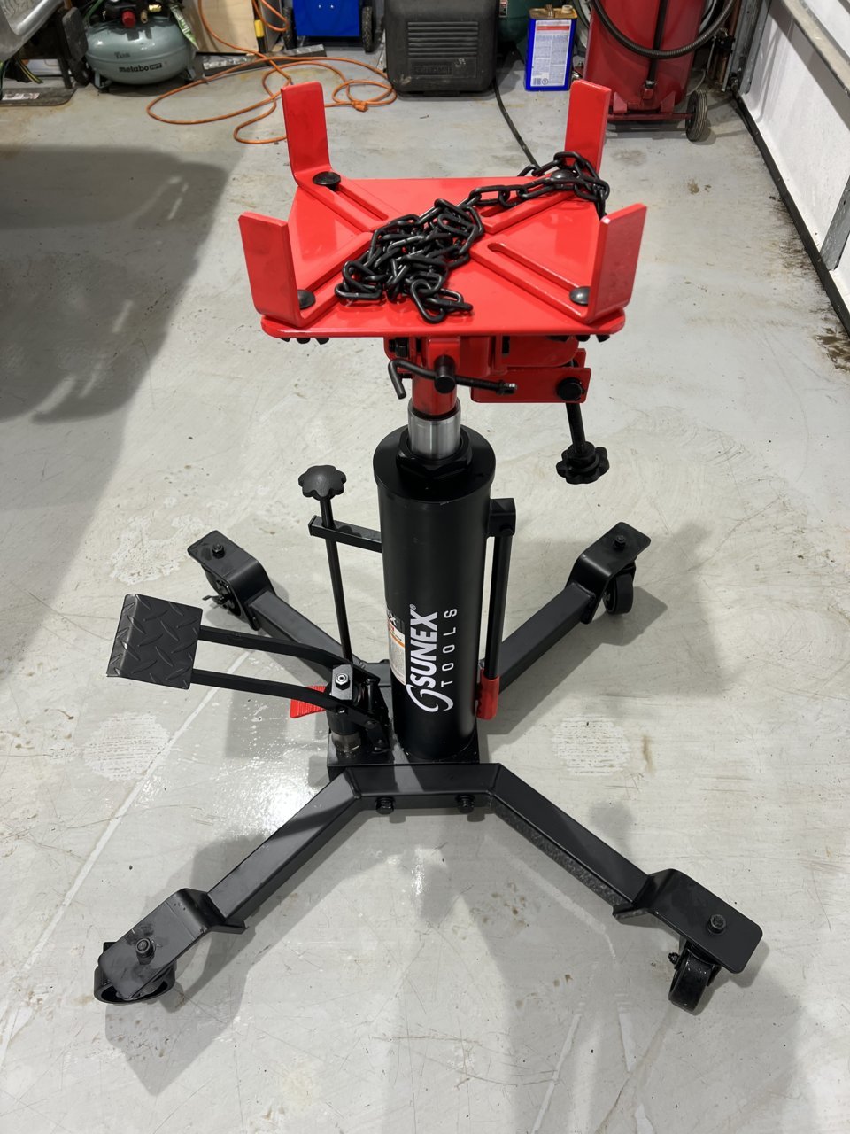

    My Sunex arrived today. I unboxed it and assembled it. My plan is to put it to use on Saturday. The box it came in was pretty sturdy, and even though the contents weren’t packed very tightly, the parts didn’t get too beat up.
    4DA2DAE3-D473-484D-9DFB-8F0EC143AF0E.jpg C66235C7-5016-4088-8BAA-722DA1927638.jpg 3324AAB4-73B3-4275-A6F7-0F3E2EDD62EA.jpg 5518C957-FA88-4E4C-B044-58ACC271227C.jpg

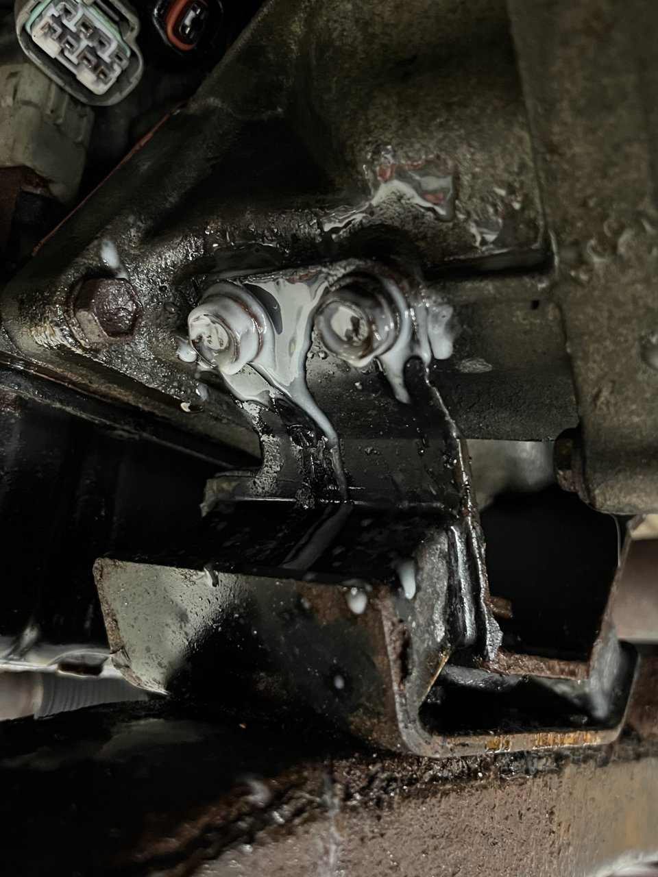

    Ok, cool. Thanks. Yes, I believe it is a 17mm. Right now, this 14mm bolt that holds the trans mount to trans is goving me fits. It’s the one on the left. I’ve tried soaking it. Using heat. Will not budge. I may have to cut it (or the bracket). I soaked it again today. The other theee bolts came out just fine.
