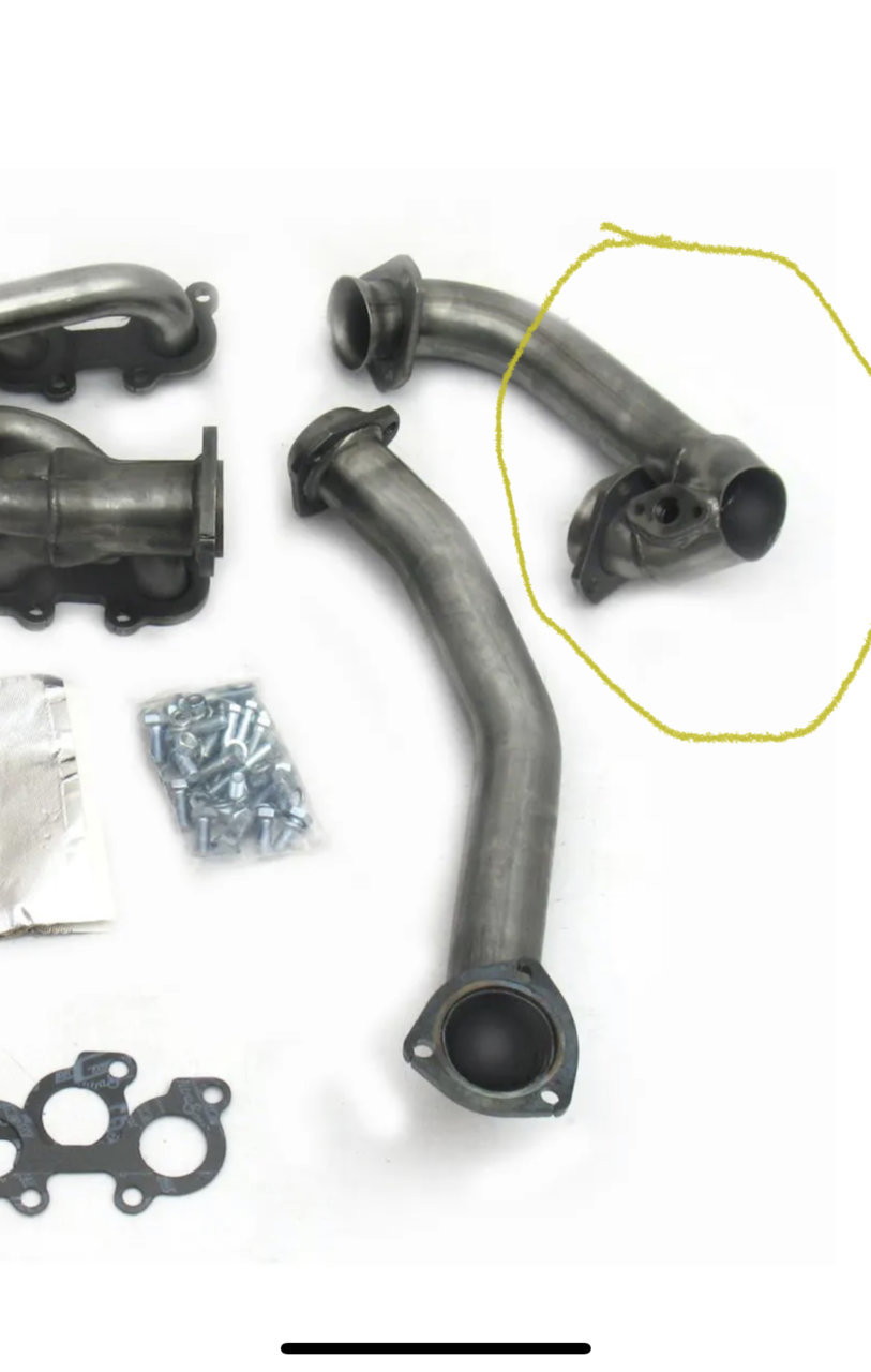

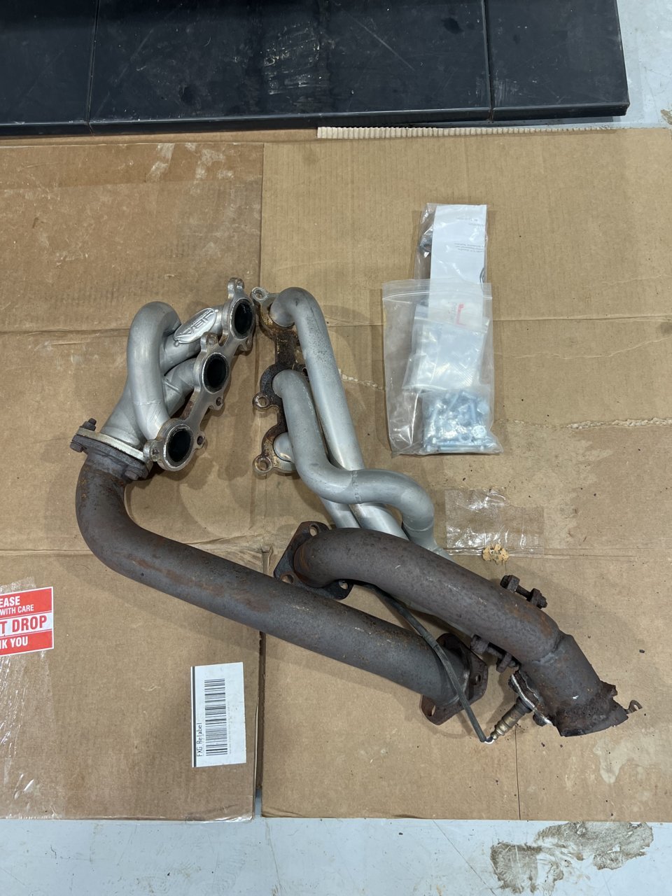

    Seeing the underside of your truck (I’m so jealous at the lack of rust) reminded me of a question I wanted to ask here. I bought a set of headers from the same guy who sold me the transmission. My plan was to have a local speed shop do that install sometime over the summer. After I finished the auto-to-manual conversion and sorted out any bugs. But since I have so much stuff out of the truck now, I was wondering if I should just do it myself. These are the headers, but I don’t have any gaskets for them.

    Yeah it would be pretty easy to install them yourself with no transmission in the way. The crossover is really the only tricky part, but you can get to it from behind the engine now.
    It looks like the downpipe was cut at the first cat though, so you would need to have a flange added there or weld an intermediate pipe on to attach to the rest of your exhaust.

    Thanks. I looked up what this kit came with new and it appears you always had to do come level of fabrication/welding. Here’s what it looked like new:

    Ah, the “choose your own adventure” exhaust kit. Who is the manufacturer?

    JBA headers by Pertronix. I reached out to them to see if I could just buy a new Y-pipe but they said they don’t make that kit anymore. I can still buy the full kit because there is some left in inventory but I don’t need the headers and crossover.

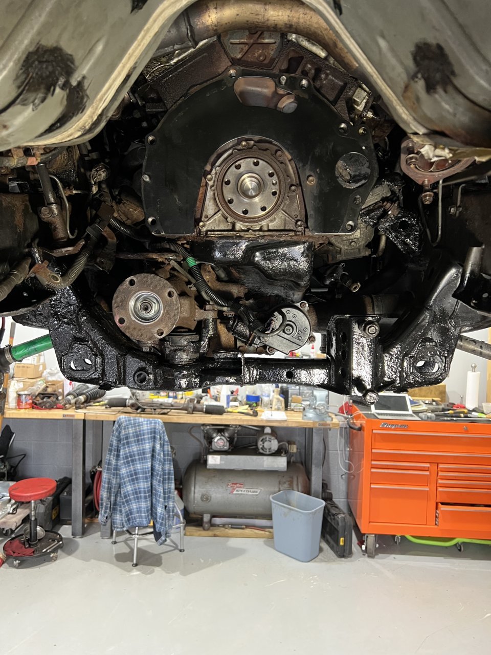

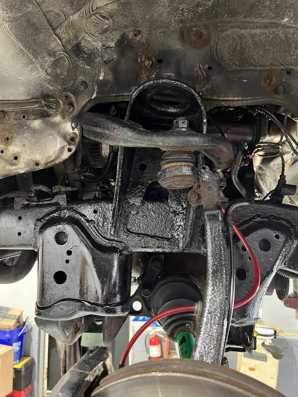

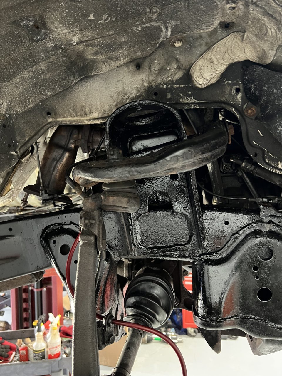

    So I finished up my POR15 part of the project. At least for now. There are other places I want to coat, but they can wait.

    It won’t win Concours at Pebble Beach, but hopefully helps with the NJ rust

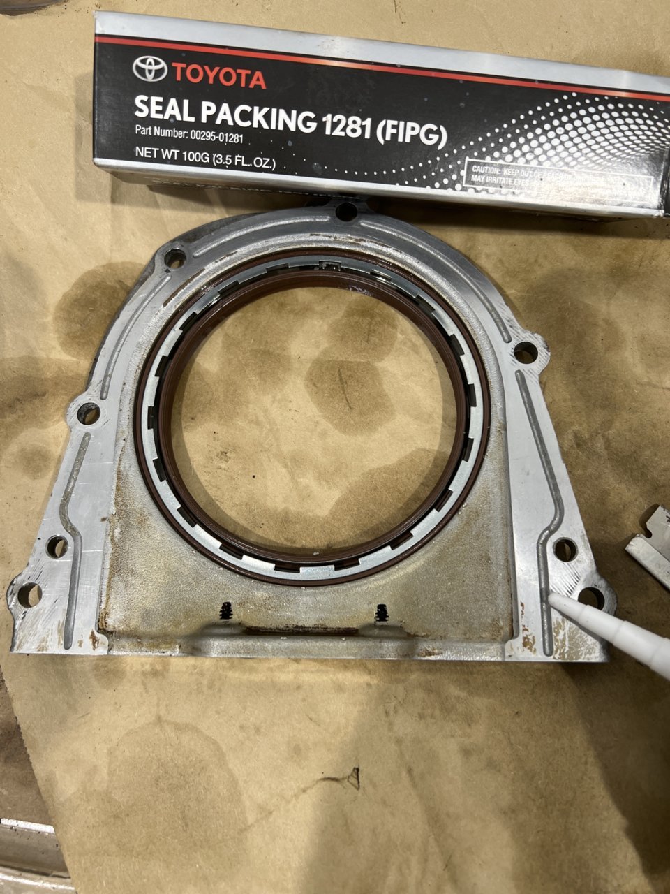

    I got the rear main seal carrier out and removed the old seal. I cleaned up the carrier and the block. As far as the bead of gasket material, do I only insert it in the grooves or run it around the whole perimeter?

    Interesting, the FSM doesn’t mention it. Did you just clean the old stuff out of the groove or scrape it off the flat mating surface as well?

    There was definitely some gasket material on the mating surface, especially along the bottom. I installed my seal dry but now I see your manual and it says to install it with grease.
