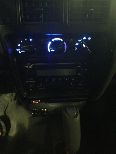

    roly6two
    roly6two New Member
    Jan 25, 2015
    #147213
    Atlanta, GA
    2003 Toyota Tacoma
    HID lights, blue dash lights
    This thread help me out and here is the result.

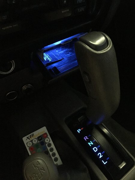

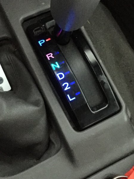

    Icon 2.5 Ext. travel coil overs, Camburg UCA's, rear Icon smooth body 0-3" VS 2.0's and a 2" AAL. Custom color matched retrofit HID 4.0 d2s projectors, dual switchback halos w/ RGB Demon eyes. Deck plate mod. Flow master 40 series. 4D optic 22" light bar & 4D optic Pods. 16x8 Method double standards w/ machined lip, wrapped w/ BFG KO2's. Steel grill insert by DB Customz. TG Front & Rear bumpers and sliders. Tundra Brake Upgrade. Complete Interior LED Swap.
    01 - 04 Tacomas Instrument gauge cluster 4 - #194's, HVAC area - Neo wedge 4mm, Glove box, gear shifter and ashtray lights are all #74's

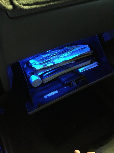

    gmr102 Well-Known Member
    Dec 24, 2015
    #173068
    323
    SE Idaho
    2002 Silver Stepside TRD OR Extended Cab V6
    Did you add those LEDs in the ash tray and glovebox? or were there lights in there to begin with? If there were lights there already then mine must be burnt out.
