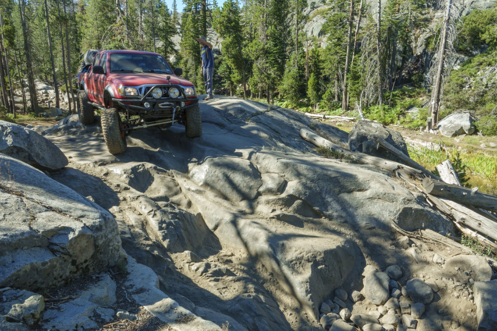

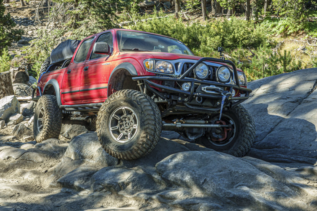

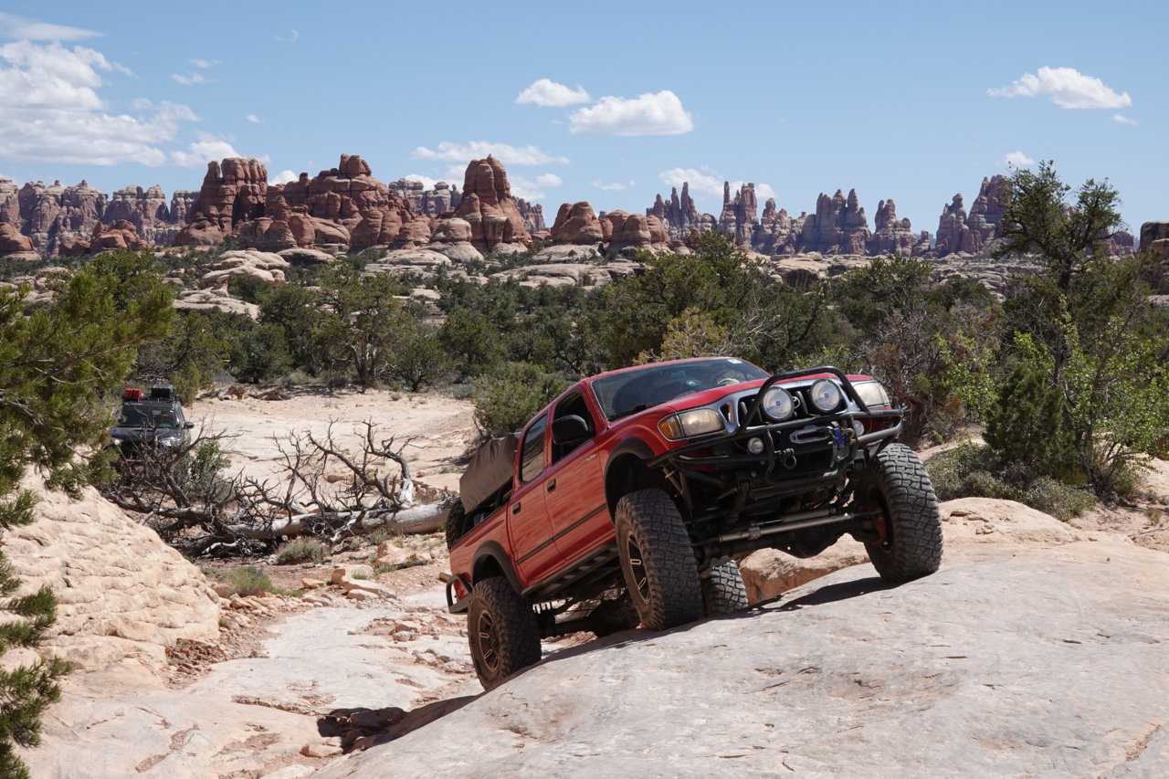

    Flexed it out good this past weekend and it all clears as it should.

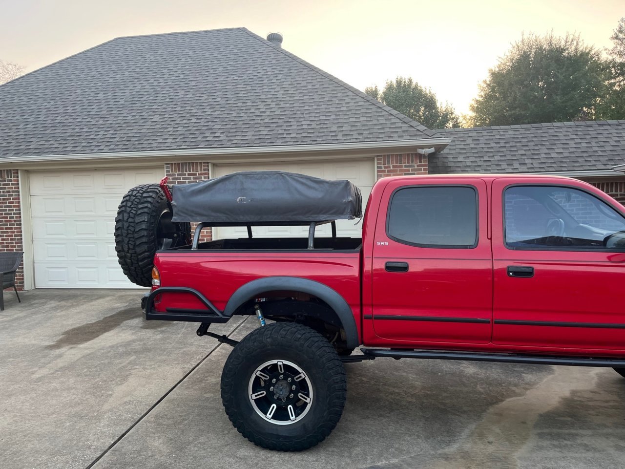

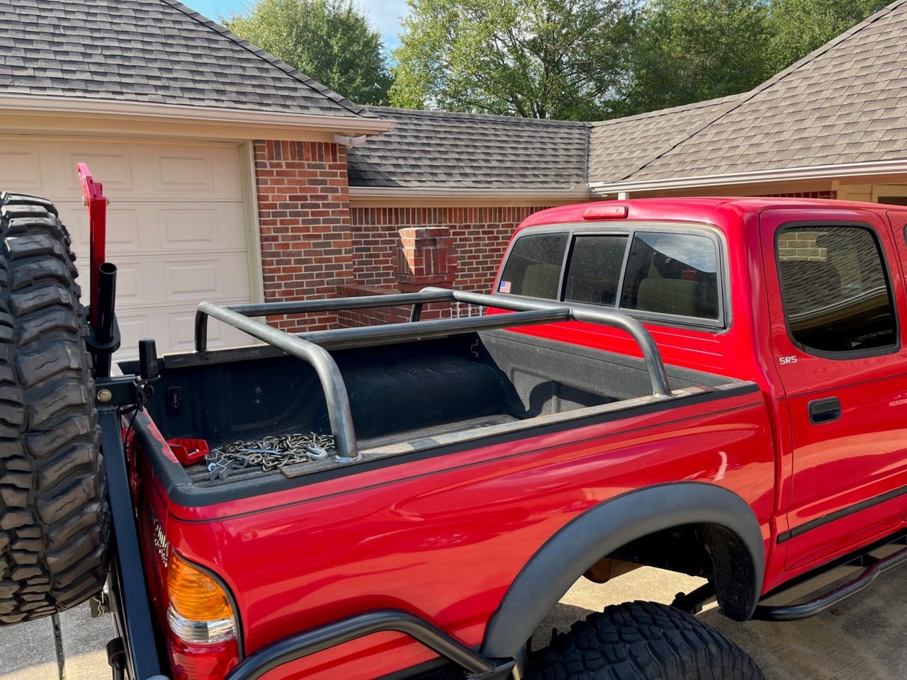

    I bought an ARB RTT from a local guy and got then bender out and built a simple rack for it. Had it powder coated to match the sliders and bumpers.

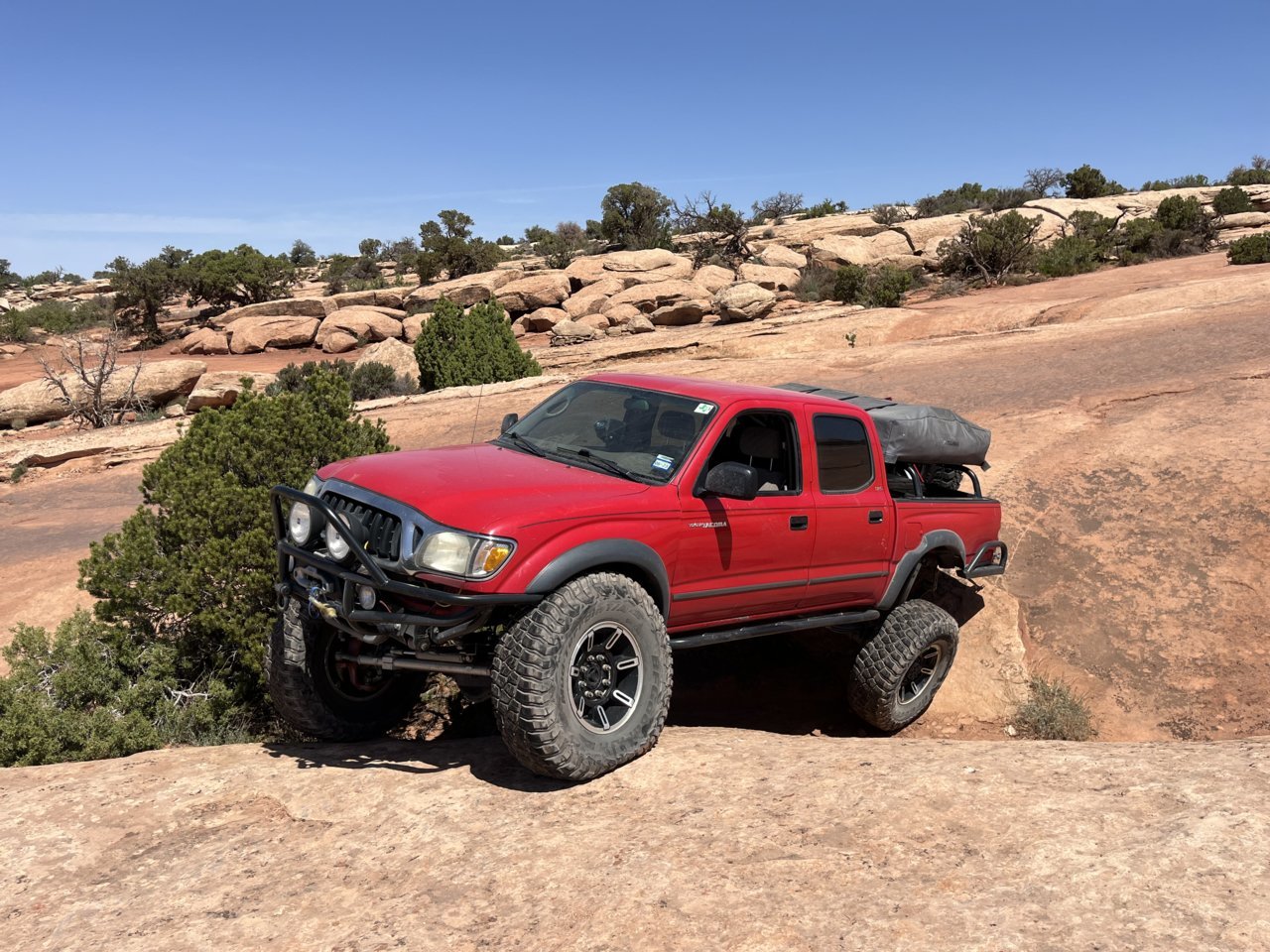

    Moab trip in early may was a success, no broken parts or trouble!

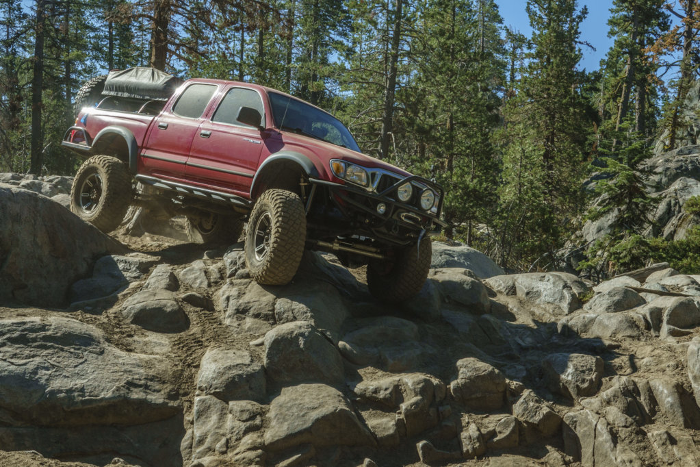

    Rubicon Trip 2024 - Awesome time and a great group! Only casualty was a bent rear shock mount!

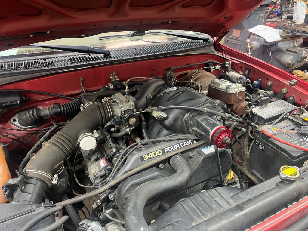

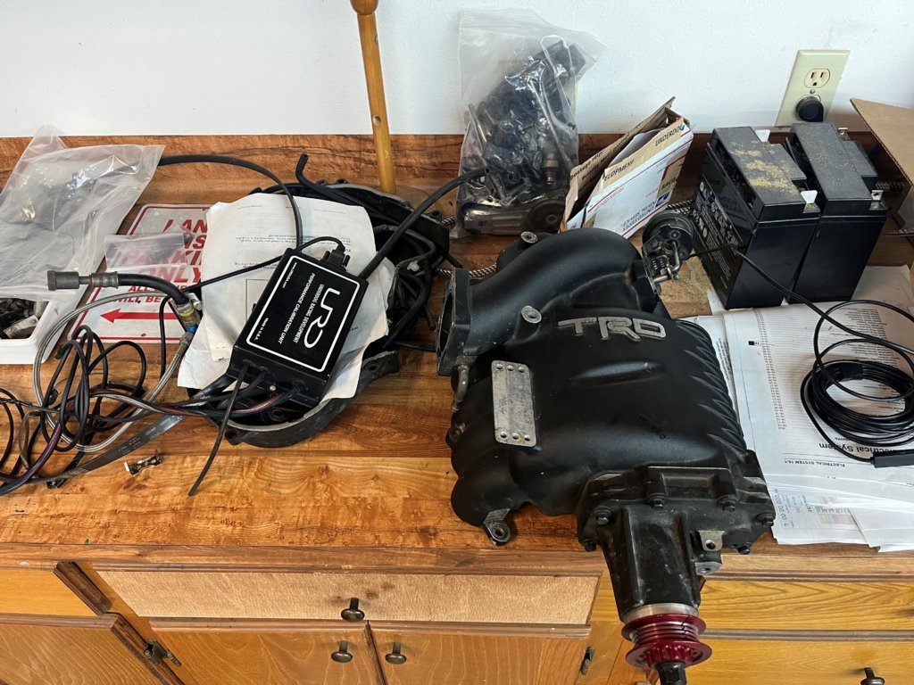

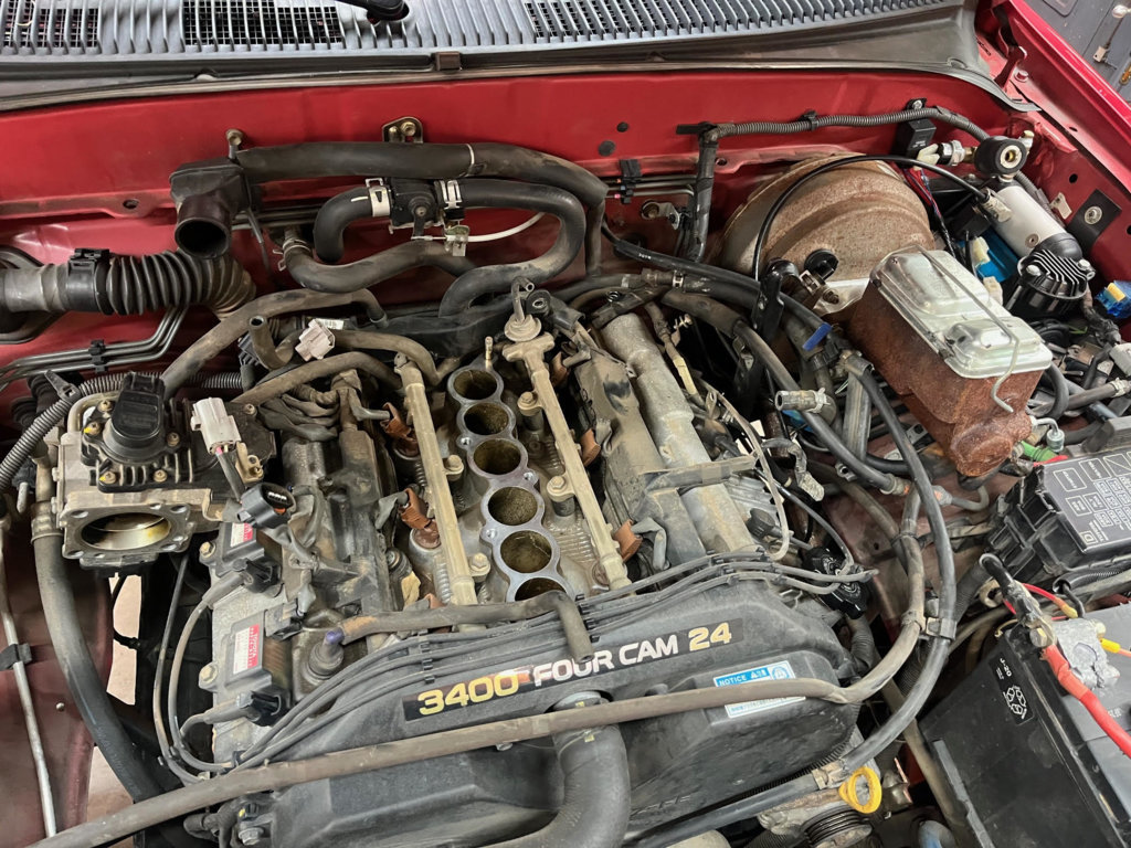

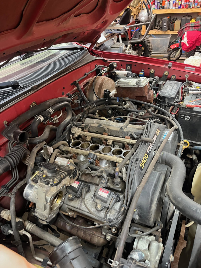

    Let the fun begin! I fund a good deal on a recently rebuilt 2nd gen SC with the 7th injector and all the needed install parts not too far from home! Looking forward to seeing how this runs down the highway after the install!

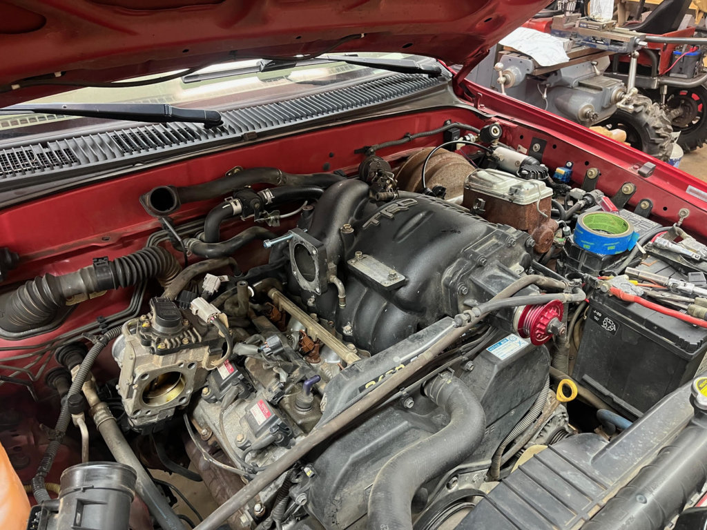

    SC install wasn't too bad at all. The 7th injector wiring went smooth and no CEL's. I was able to plot it and I'm getting ~ 9.5-10 psi of boost with the 2.2 pulley. Going to install an AFR gauge to fine tune the 7th injector, but it runs pretty good with no pinging as is.

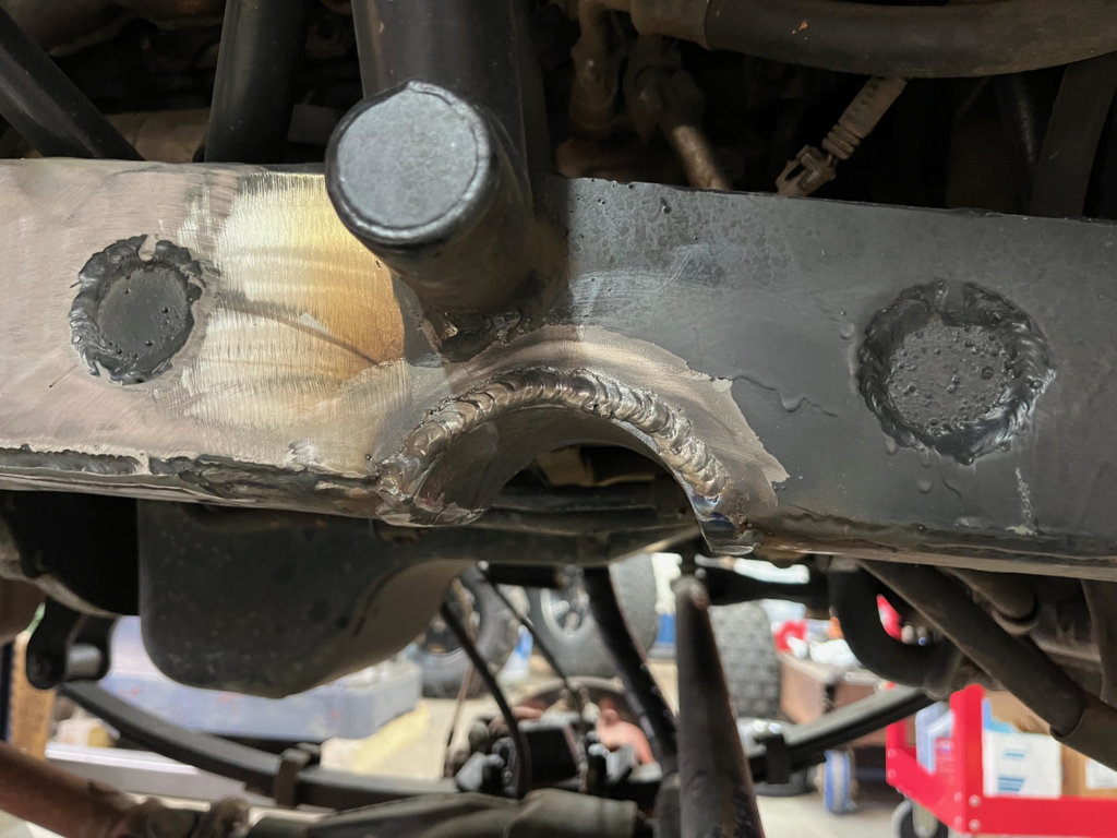

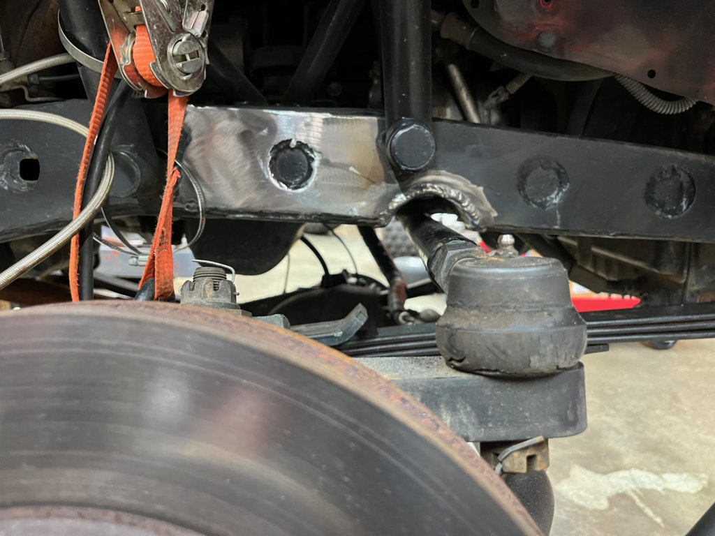

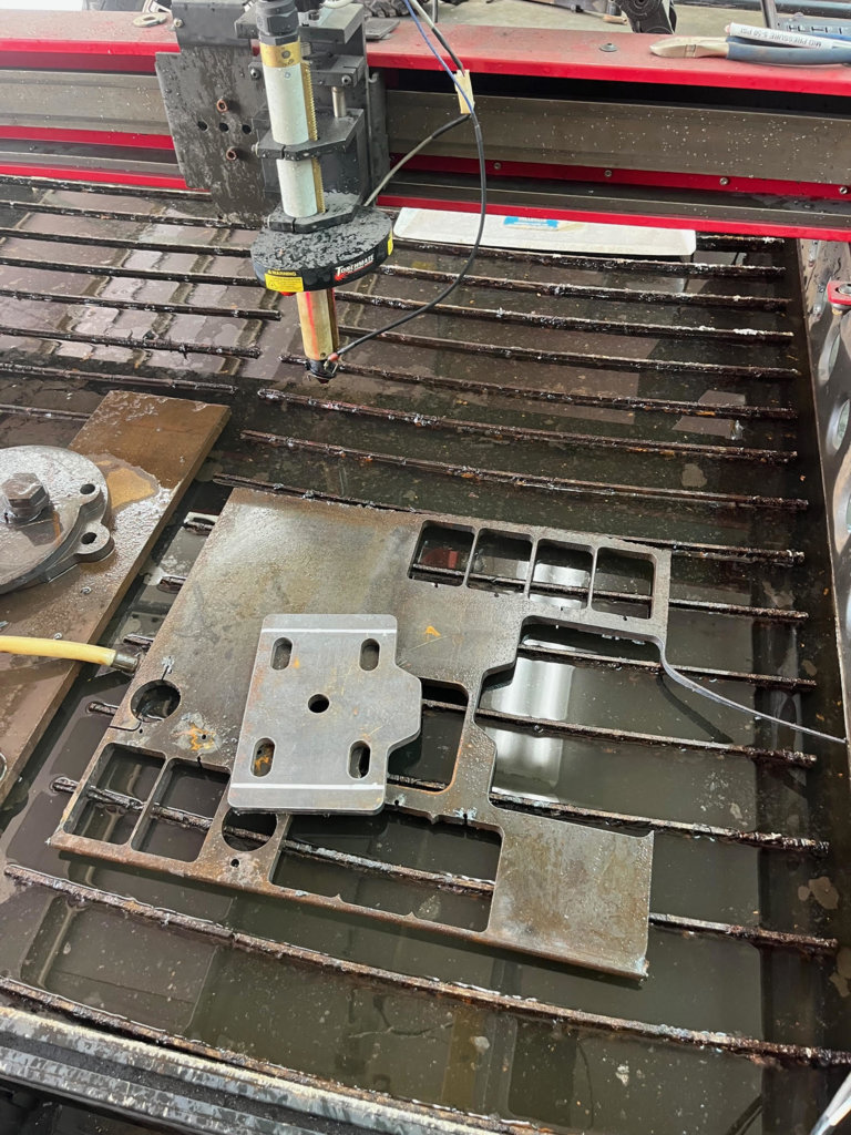

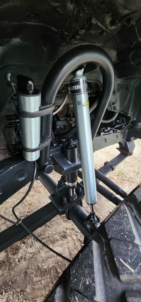

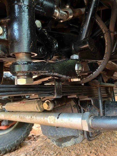

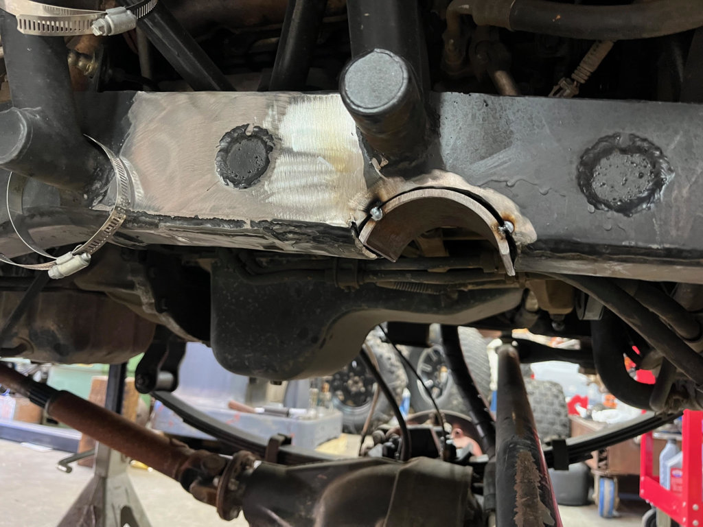

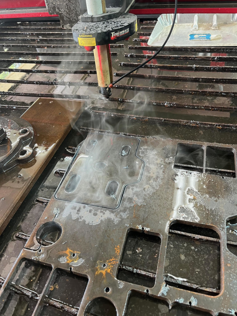

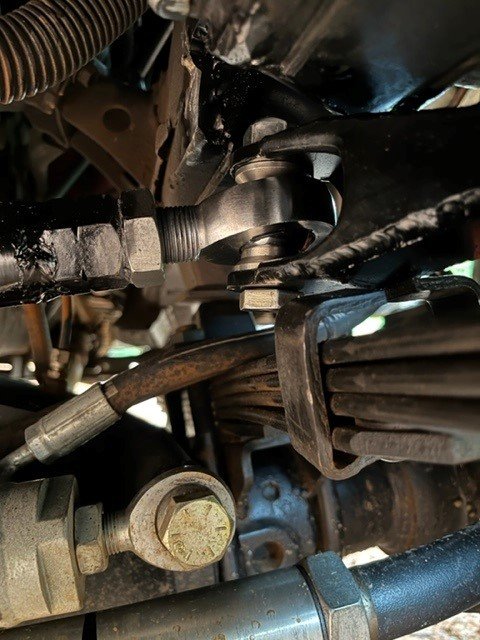

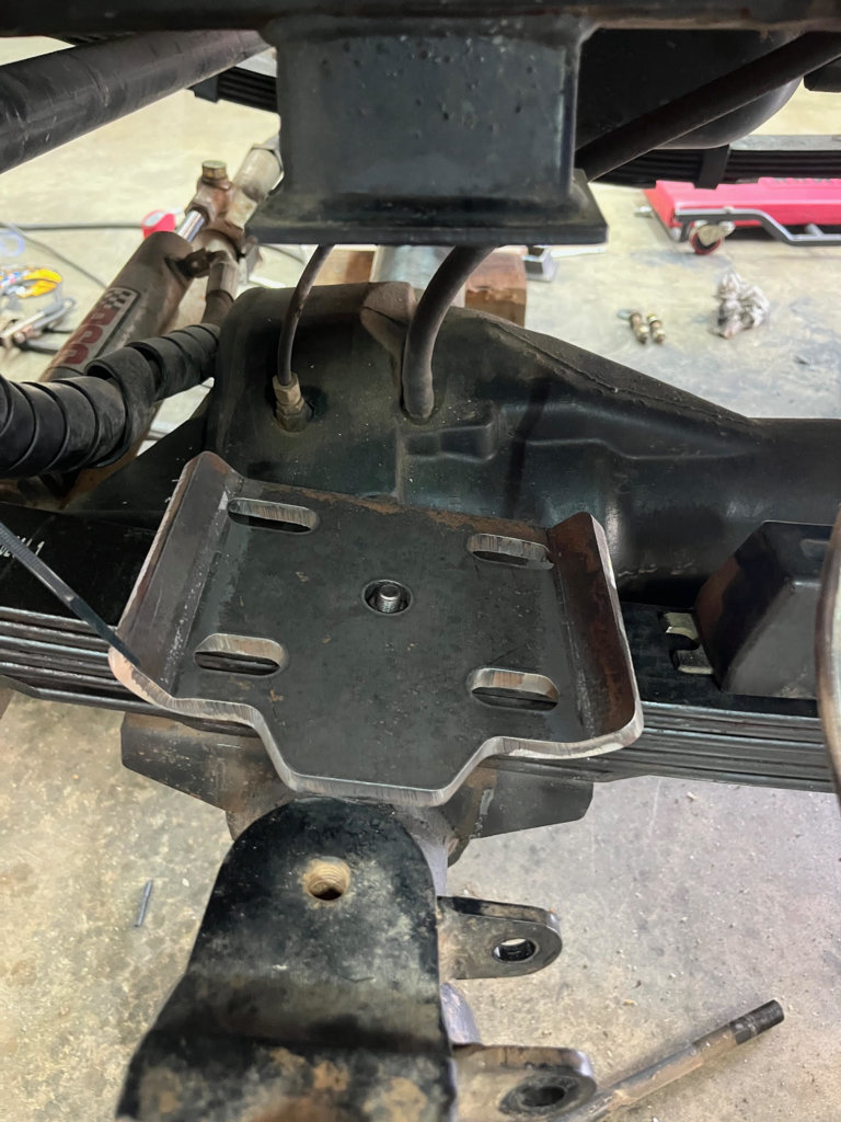

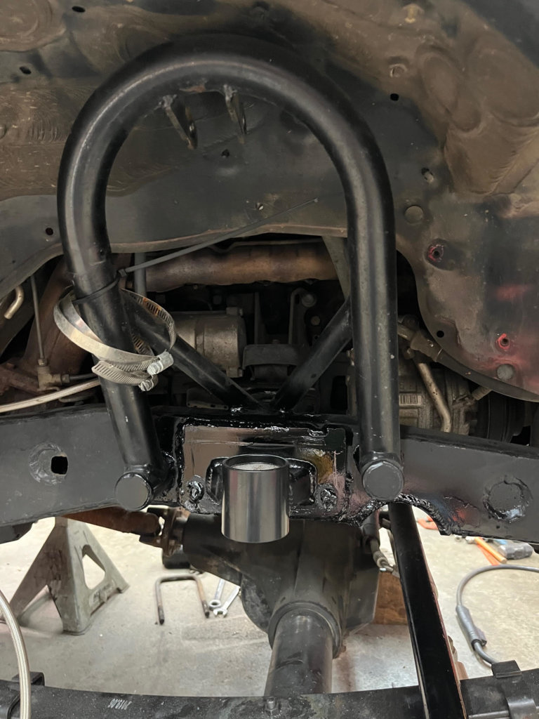

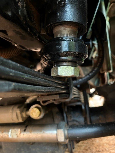

    Removed the solid rubber bumps and have started down the path of adding air bumps on the front. I couldn't find spring pads that would work with the air bumps, so I sketched them out in Fusion 360 and cut them on the plasma table.

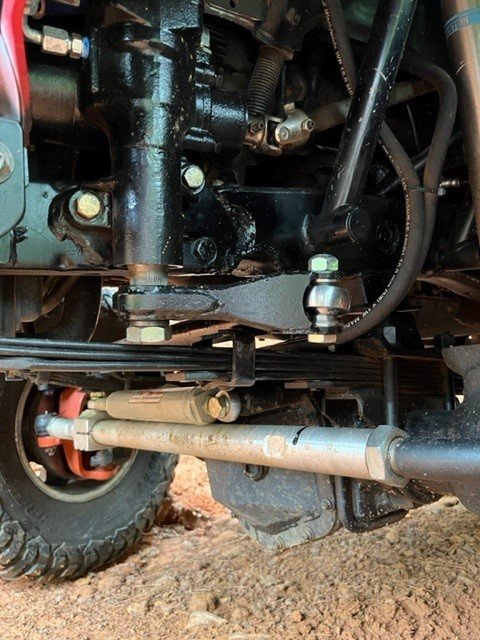

    The Rubicon trail made me aware of some clearance issues with the drag link. Notched the frame on the passenger side to clean it - you can see the paint gone from the drag link where it was hitting the frame.

    Perfect spot and room for bumps.
    Which bumps did you go with?

    I went with Locked off road 2" bumps - threaded style that can be adjusted. They sell a "Kit" for the rear of the 05+ Tacoma that I chopped up the mount to use. I'm not sure what powder coat they used on them, but it was a bear to get off....
