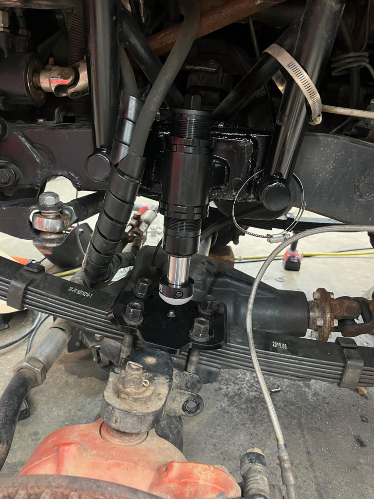

    Looks good, I've played around with N2 pressures. Ended up at 100psi instead of the standard 200psi.

    Care to share the .step file for the leaf plate? I'm about to do the same exact thing myself. The poly bumps are super harsh.

    I sent you a message.

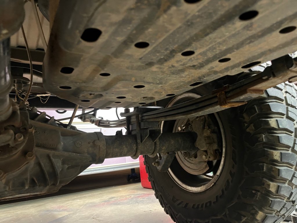

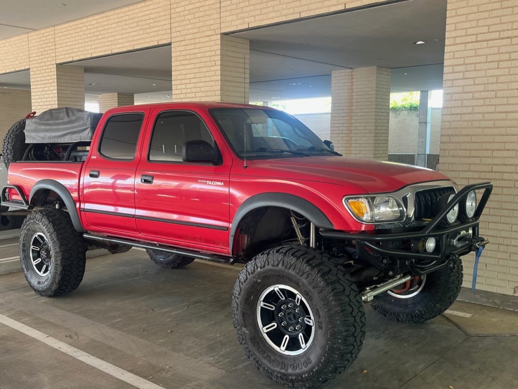

    Swapped out the 37x12.5x17 BFG KM3's for a set of 38x13.5x17 Patagonia M/T 02's. Happy with them so far. I was always told that the BFG's ran small, but the 38" tires are noticeably larger then the 37" BFG's.
    When I added the air bumps on the front, I added back in the HD leaf that originally came with the leaf pack and replaced the rear bent up chevy 63" springs with a "fresh" set from the salvage yard. The old 63" springs were the newer design with 3 thicker leafs, the "fresh" set are from a 99 chevy 1/2 ton and have 4 thinner leafs. They ride a little better in my opinion.
    Old bent 63" springs....

    I put it back in to try to stiffen up the front a bit. The springs had settles quite a bit and I was only about 2 - 2.5" off the solid rubber bumps.
    I do run the 1" block with the 4 leaf Chevy 63's - this helps keep it level with the RTT and all the gear in the bed.
