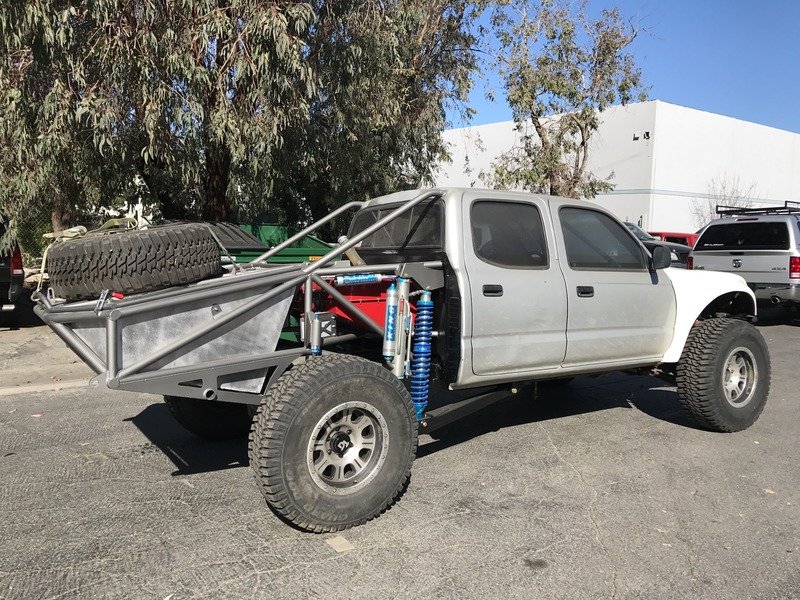

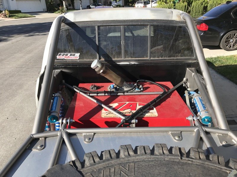

    Beyond stoked right now.

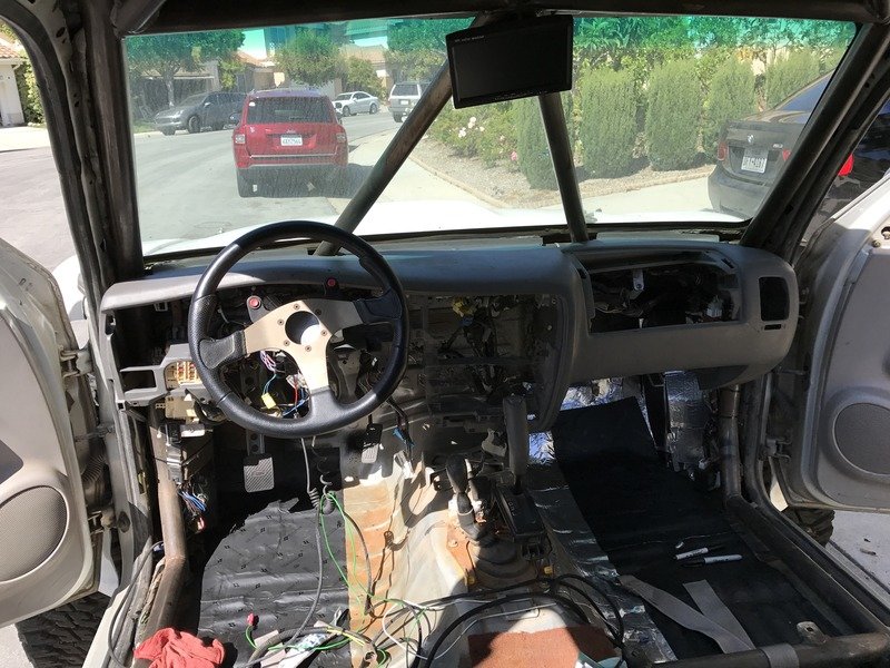

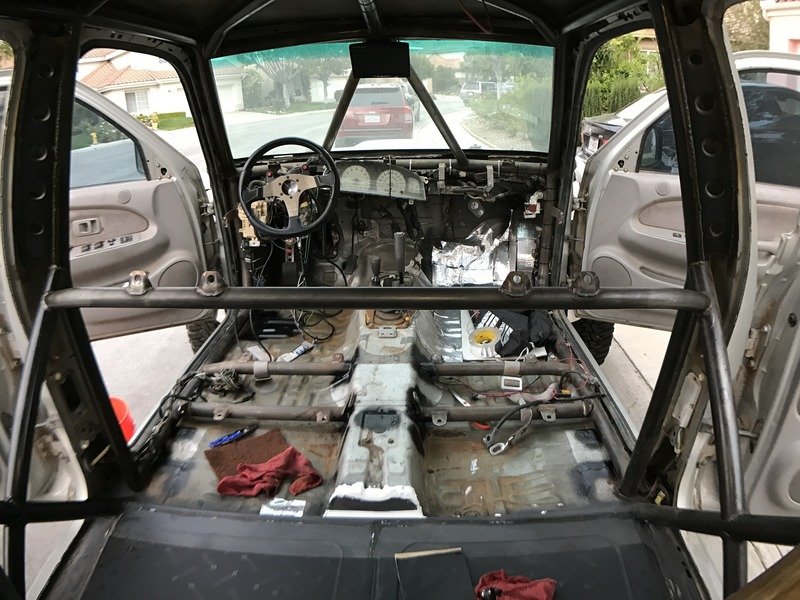

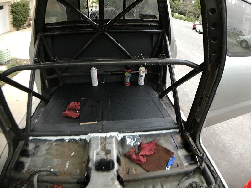

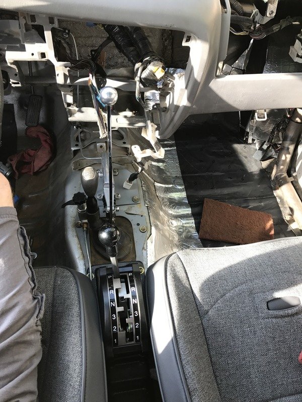

    Made progress by taking out the entire interior. Bought some new PRP seats from Envy Motorsports which I will hopefully be mounting tomorrow. Removed the old stock carpet, it's disgusting and the padding has tons of rust on it so it went in the trash. I bought Second Skin sound deader which I began to lay down on the back wall and rear floor. Tomorrow I'll try to cover the rest of the floor, I covered some holes and re-sealed the seams of the new rear floor so I want that all to dry first.

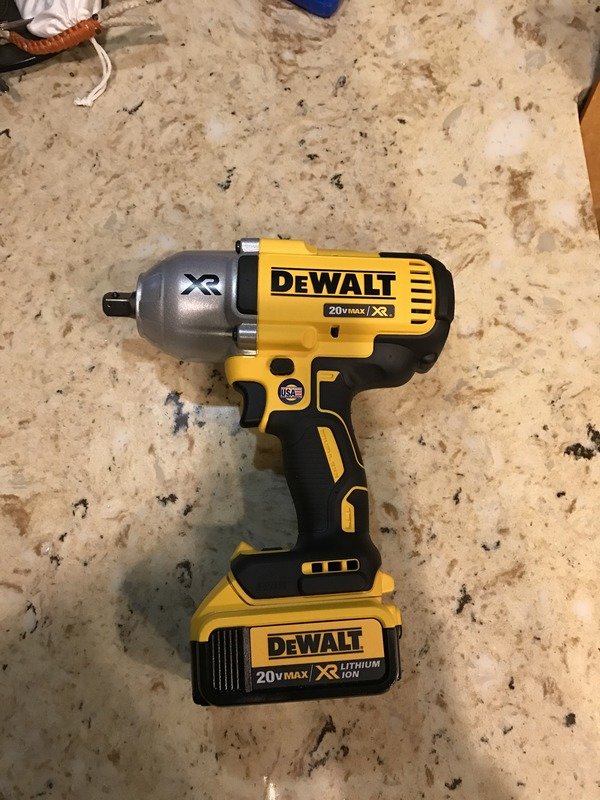

    Bought myself a new tool. Been trying to use a shit Crapsman impact for years which is less than worthless.

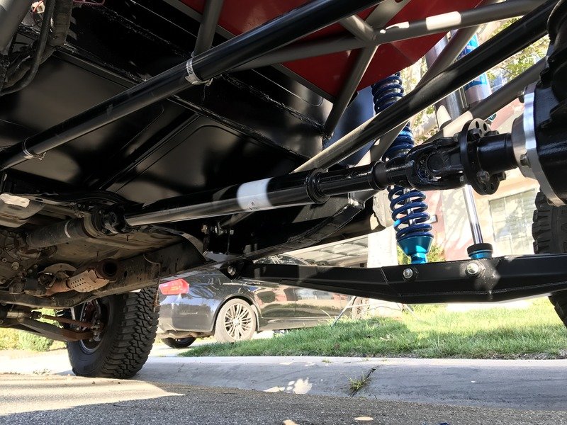

    Driveshaft!
    108C1E9A-7A29-45B6-BC77-FB392E2063AA_zps_9fdddb610baf04a9356ce31558ff775798682734.jpg

    What a pain in the butt. Messed up cutting the hole for the passenger side windshield bar big time. Eventually I'll find another dash for round 2, but it's in for now. I think with round 2 I can move the dash up several inches. Gonna have to figure something out for my gauge cluster, my steering column goes right through where the gauges are supposed to be.
    E4C182A0-5C0F-477A-9B92-0C262D29A60C_zps_04cd05382f3588d87349bc49303b13921ea5f4ae.jpg

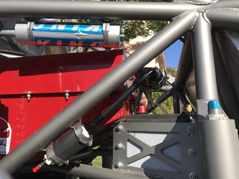

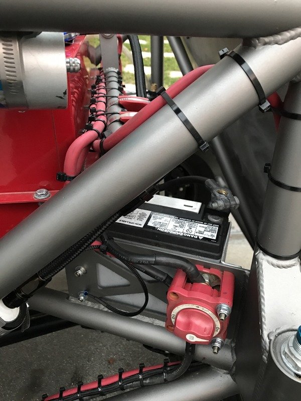

    Got the truck running finally! Took one step forward but like 6 steps back in the process. Broke off one of the studs for the fuel pump power, so I had to go buy a new one. Ordered the one I broke off Amazon so I have a replacement coming in a few days time for a spare now. I also removed the rear wire harness off the truck and removed all of the wires and plugs which went to the nonexistant EVAP equipment. I wrapped the wires in expandable loom and swapped the massive old plug for an 8 pin Deutsch connector. One of these days I really need to remove the body harness and remove the rest of the wires I don't need. This bit was easy enough it gave me the confidence to tackle a bigger project.
    Realized also why my battery used to always go flat when the truck would sit: There's no positive cable from the alternator to the battery! I bought the truck "wired" and running so I never noticed it before. Ordered 0 gauge black and red cable, plus a 150 amp breaker to get more power.

    I finished wiring the batteries and ran a positive wire from the alternator through a 150 amp breaker to charge both batteries. I ran cable to hook up both of the batteries and found a spot to mount my battery switch that'll be easy to get to for now. I do not like the concept of a big power cable running through my cab, so all of it is outside the cab.

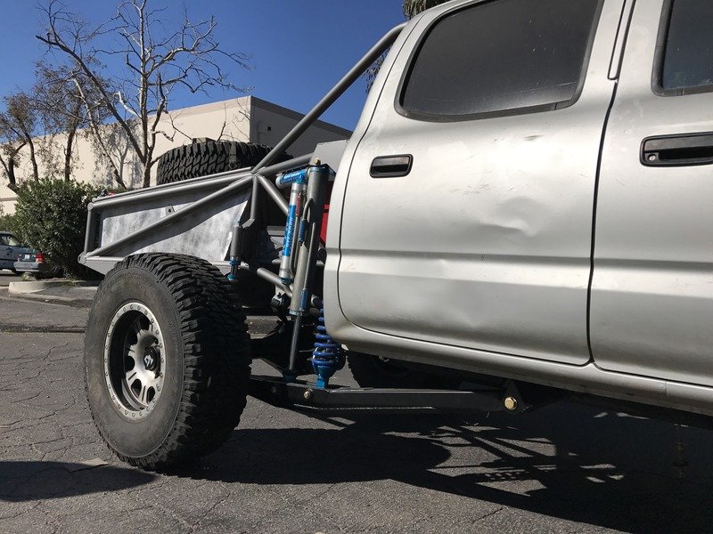

    Got bored on my way back from lunch and tried to find somewhere to flex the back end a little bit.
