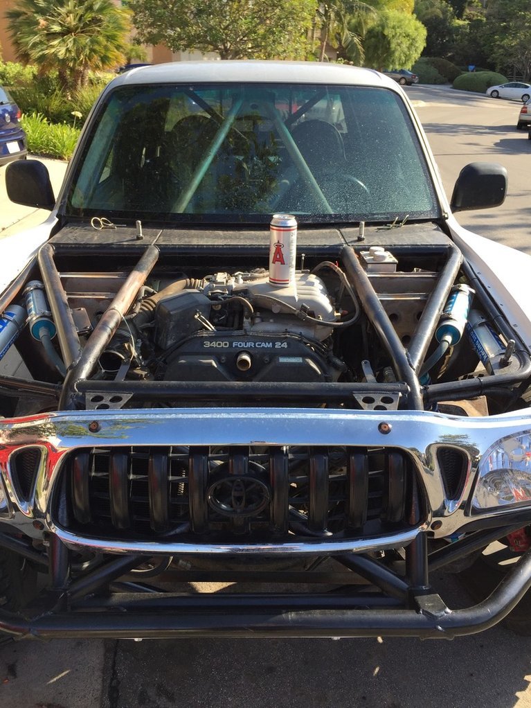

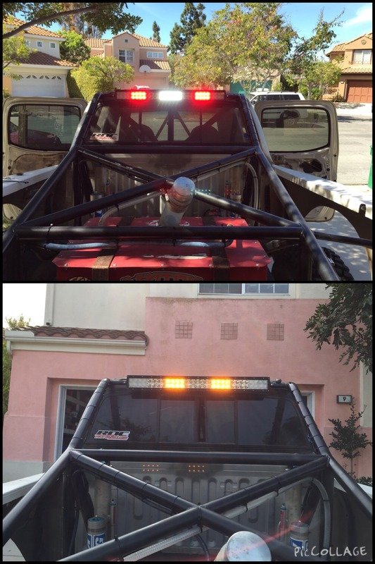

    BC10C455-69F8-480F-8277-8C564B00EC43_zps_be4465fe2f6d5a91bef28e0ab199efcc95af331c.jpg
    Wired the dust lights in the below picture. Top is the brake and work/reverse light that's already wired

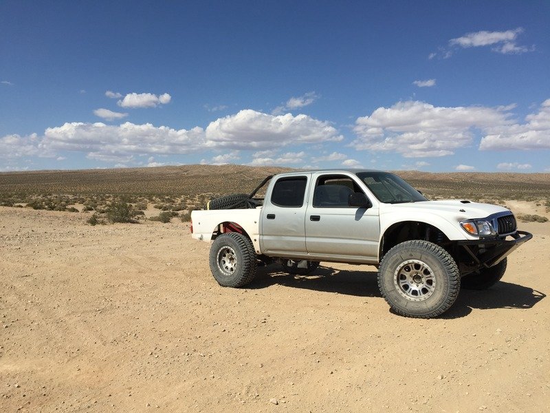

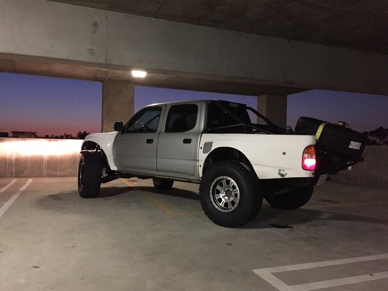

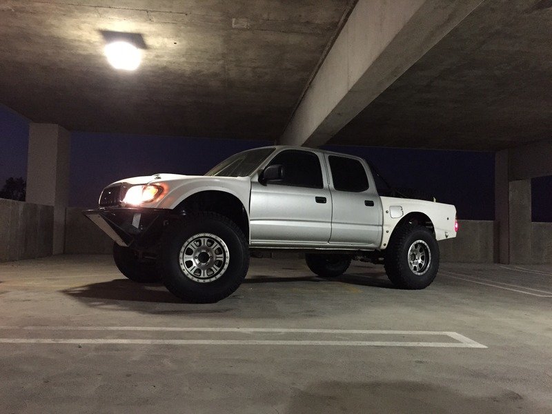

    Shit yeah. Got my rims and tires all mounted up and looking spiffy. Ready for the SoCal Offroad Trucks meet in Barstow tomorrow.

    GUESS FUCKING NOT.

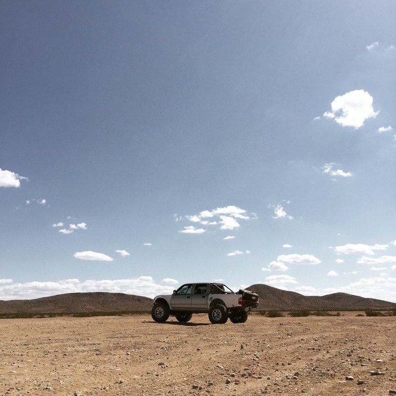

    5/10/15
    Seals and brakes turned into a full rebuild. Bearings and everything were done, so I took the truck to a friend's dad who is a Toyota master mechanic at an independent shop. Got it back a few days later without having to worry about the work. Went to Barstow with a coworker in his raptor and dirt bikes and another friend in the blue raptor.

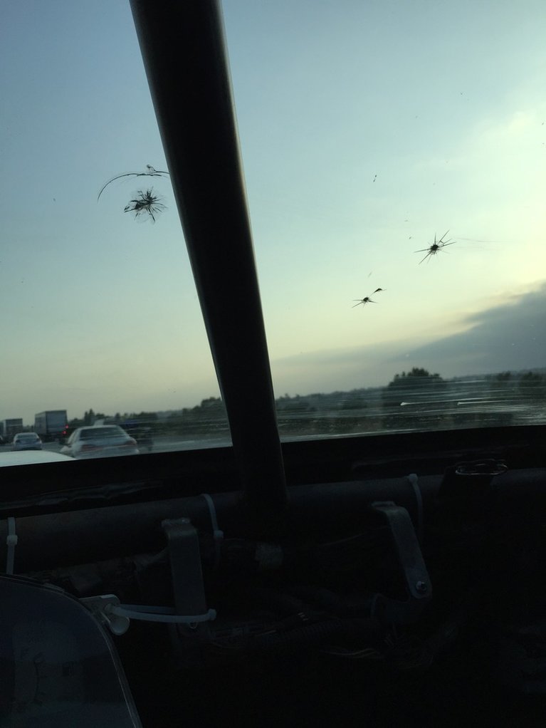

    My only damage was to glass. My rear tires munched my bedsides and my coworker kicked some rocks up on his bike.

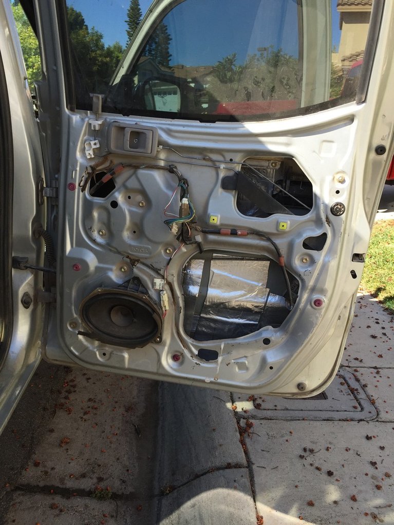

    Picked up rear door panels from SoCal Mini today and trimmed them to fit around my door bars. Also collecting more parts to get a/c back in the truck.

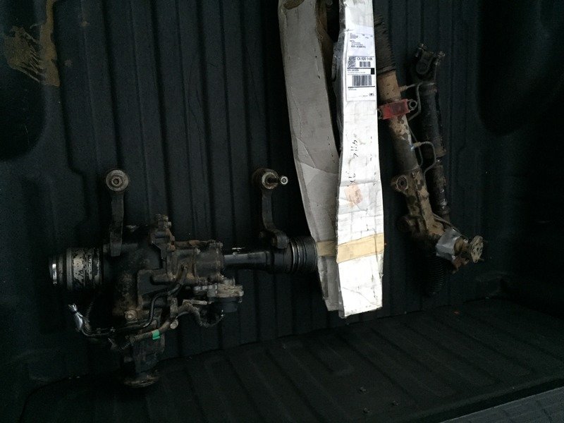

    5.29 geared front diff, driveshaft and 2 steering racks from jonsangel.
    9E437146-1EFD-4F09-AC2C-64A2565939CE_zps_b1b3290ddeb7dbde95fdb2dd2760b3285330db33.jpg

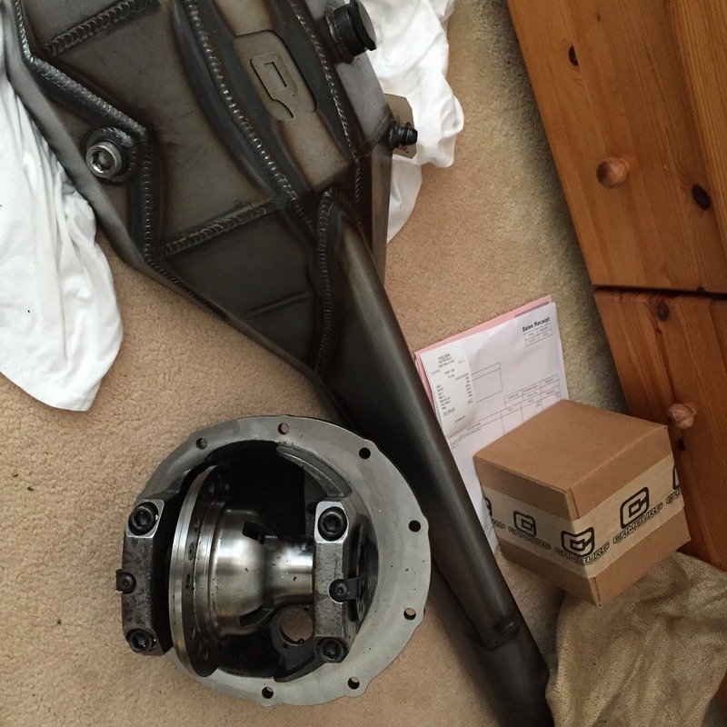

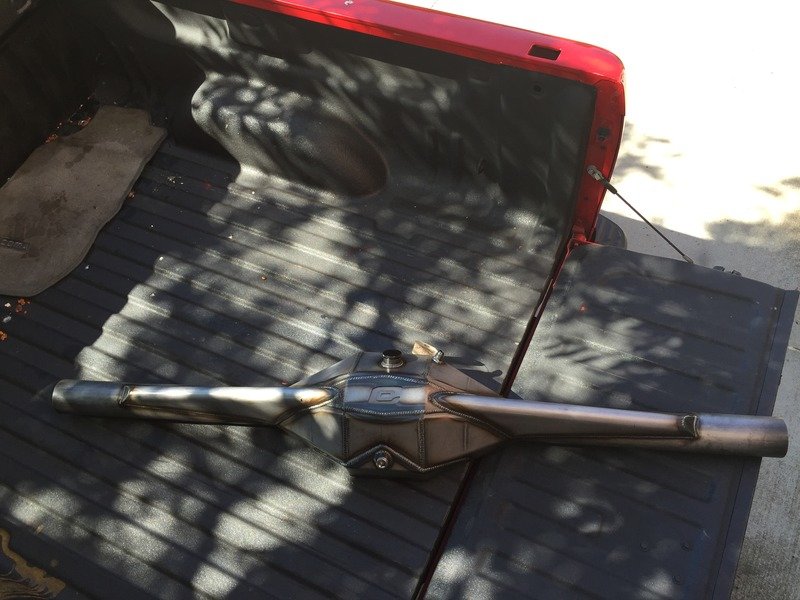

    Threw down money on a Camburg housing, it's getting built. Gonna piece together the rest of the parts as deals come up. Goal is to build a housing that can be compatible with links if I choose, locker, disc brakes, and strong.

    Carlos at Camburg helped me up the gnar factor.
    A1187DF1-9C6B-4C4A-89D4-51DF6115C234_zps_04876e3f4e47df459ea2a94a4fc39db2a47f3847.jpg

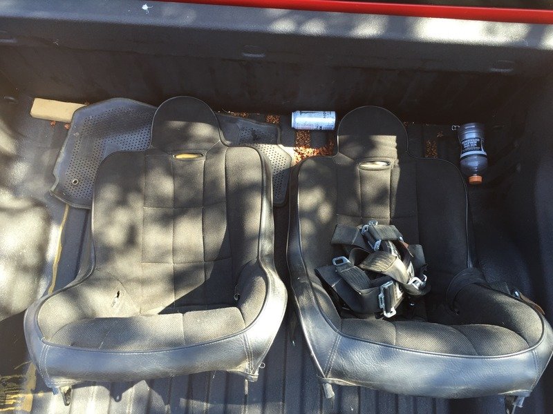

    Got some seats and 4 points from a buddy building a ranger. Gonna get all 4 seats reupholstered to match.

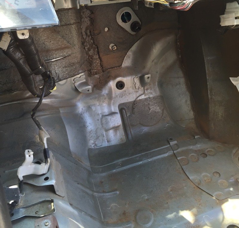

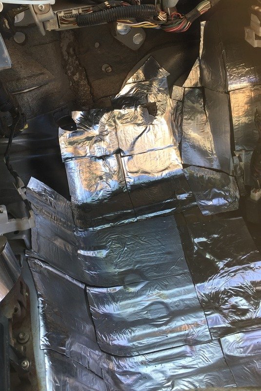

    Also sealed up some holes on the passenger side firewall using aluminized tape, flex seal sprayed over it on the outside. I also sprayed the outside of the wheel well tubs where the welds are, used marine sealant on the inside, sprayed flex seal on the inside over that, then laid down a layer of peel n seal over a good majority of the floor board. Once the rest of the fabrication is done on the inside I'll buy some real sound deadener and new carpet.
    This:
    D5392CF0-793F-49FD-9D2C-788364136B50_zps_14cbe7f0c8514f460df0ae48e7db92ace52b9ce5.jpg
    To this:
    FA6E1284-70F4-4573-86A2-5B08BA95F094_zps_4b9fa0421e95ce02cd867040ce674e1b57b206d0.jpg
