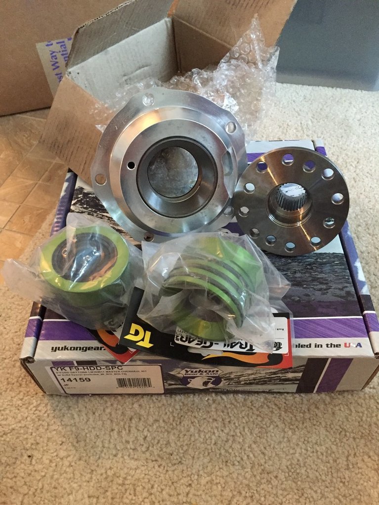

    Tommy at Poly Performance got me taken care of again. Correct master build kit for my diff, Daytona pinion support, Trail Gear flange from 9" to Toyota drive shaft, and Trail Gear inner housing seals. Fast shipping too, the order was placed yesterday.
    Just gotta find someone in the OC area to build the diff, open to suggestions. I should have all the parts necessary now.

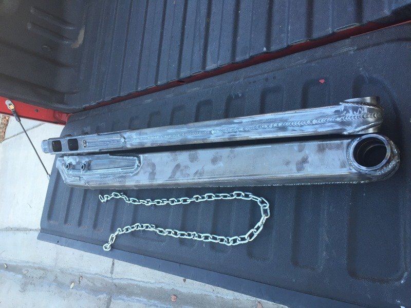

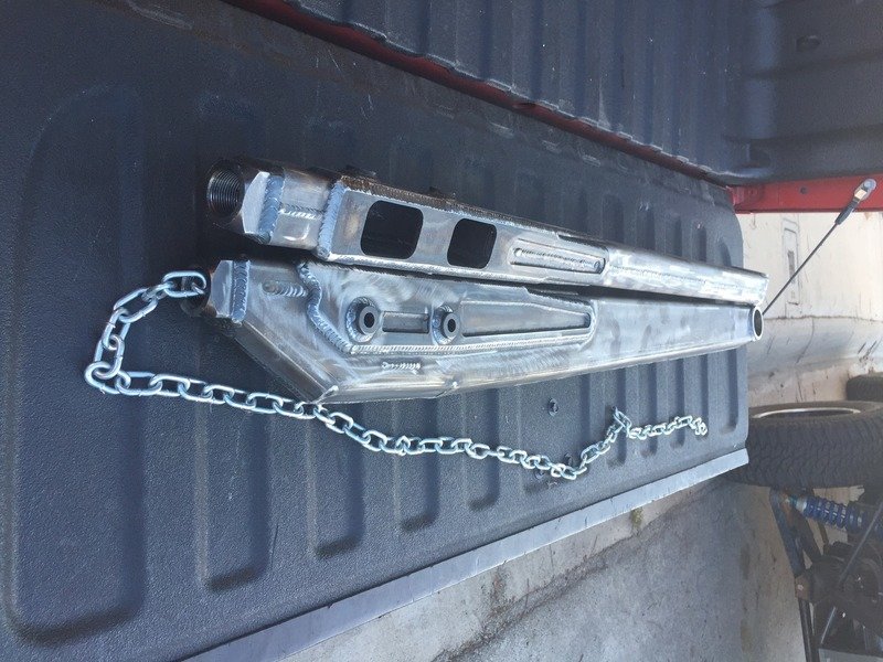

    7C7C7486-28F0-4D98-A95E-E27F9E5C1125_zps_fba29844ee04751db46489bd97967753abd57310.jpg
    02964057-2CD4-4E9F-B8A7-955B82EB2A2E_zps_0e8ec1b0e39769de3383462a136bc47d81c95541.jpg

    Leafs are for trees.
    Wait.
    Hurry up and get it done.

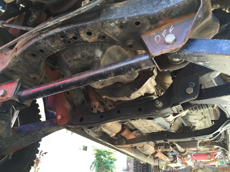

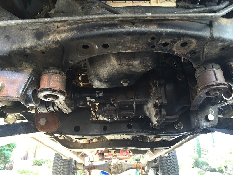

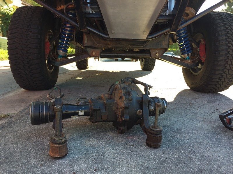

    Got tired of kicking this thing in my garage, so I put it in. Had to cut out my lower arm crossmember, but other than that it went in smoothly. I removed the ADD crap and locked it so the diff is engaged. Plan is to run manual locking hubs anyways.
    95CBA6D8-1F37-4A6D-A99C-C3A5C7A89136_zps_0256173d3e279983f1dda8824a7d32c7ec4b7720.jpg
    It's home
    52611190-2FAD-47B9-8139-026F97327F08_zps_5e6e127ffe70552bbad942c08df2d1c87d21f12d.jpg
    All tucked in.

    4wd LT all day. Are your hubs going to work for that? They looked a tad interesting from your pictures, like they were modded or something? How are those links coming? Are you doing all the work yourself or having it done? I recall something about "dropping it off at the shop."
  9. Nov 15, 2015 at 5:26 PM
    #89
    doyouquaxu
    doyouquaxu [OP] Well-Known Member
    Dec 6, 2014
    #143779
    864
    I'm gonna get a new kit, what's on the truck now doesn't suit my needs. It uses a stock spindle that has been modified in several ways for proper steering geometry, and to use uniball pivots, but those modifications put a big bolt right where an axle needs to go. Solo Motorsports makes a very nice bolt on long travel kit that is next after the links. It uses manual locking Dana 44 hubs.

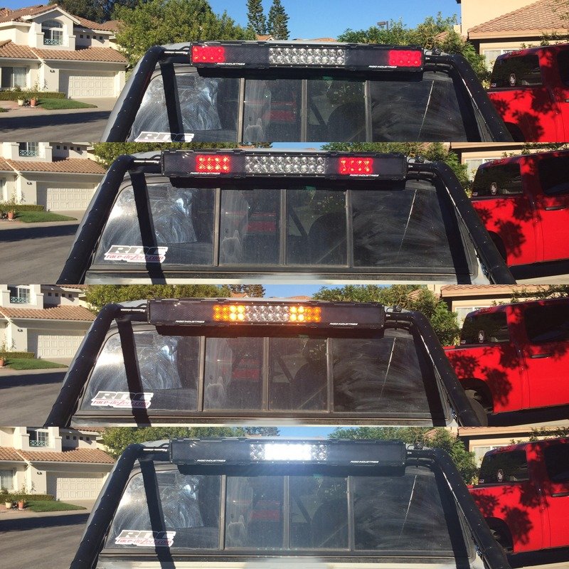

    Big update: ran the last wire to hook up the running lights in the top picture. Getting crazy with the progress! Haha

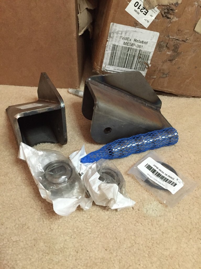

    Got lower link mounts that mount under the frame, uniballs and misalignments for the front of the links thanks to Tommy at Poly Performance.

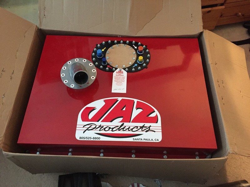

    Dez and the guys at Nexgen Offroad got me taken care of with a Jaz Jeepspeed fuel cell
