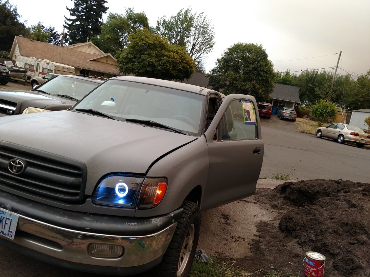

    Yeah got it done few weeks ago but had it all torn apart so took some reassembling. Now ive got the front end apart doing lift and such but will get it out for proper pics soon.
    Here's a preview pic from day after. I believe the look has improved since, darkened a little and some.dirt and dust levels out the gloss and hides imperfections.
    This is 3 coats, all trim/gaskets, side windows, and box pulled to do behind cab and jambs. Really happy overall and considering doing the tacoma after I finish the cage and am ready for a repaint.
    Undoubtedly better than the paint job that was on it. I bought this truck cheap with plans to fix it up when I pulled my Tacoma off road as my DD so this was a perfect solution. Add to that i got hit and had a sweet insurance payout that payed for it and its hard not to smile.
